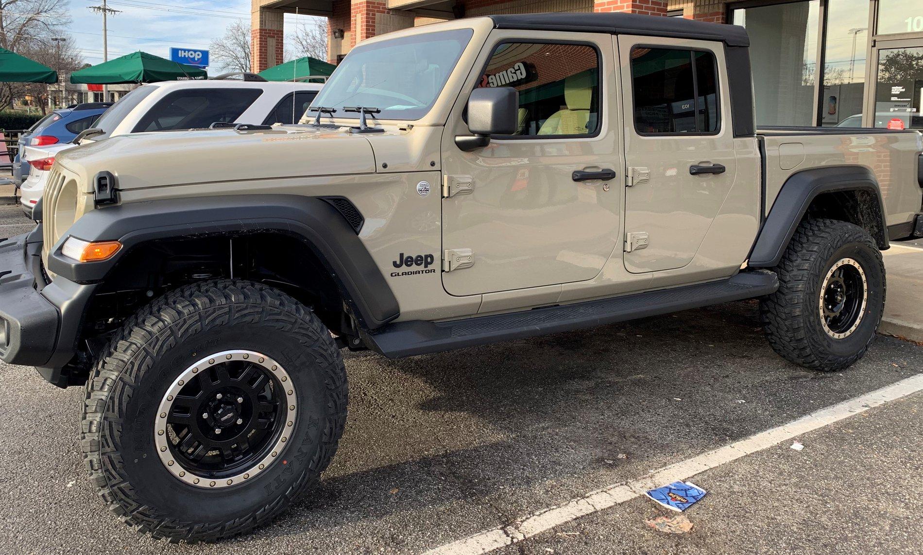

May I suggest a Rough Country spacer lift? Its about 1/2 the price of putting in the springs but like you, it was more important to me to have the factory ride than hard 4 wheeling. However, if you are going to do a lot of 4 wheeling, I would go with the Springs. Here's mine with a 3.5 inch lift and 35" tires and it rides really well.
