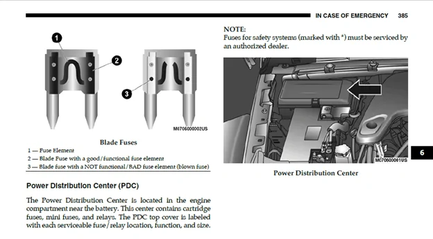

This happen to me too. Same thing, brakes and turn signals were fine but no running lights. I had blown one of the fuses in the main fuse box under the hood. It is in the owner's manual. I don't have it in front of me right now. I will look for it online.
LANGeek
Sep 24, 2019
124
181
MD
2020 Jeep Galdiator Rubicon
Fuse info starts on page 384

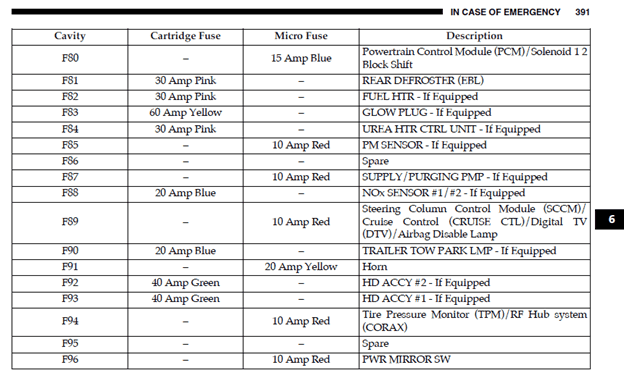

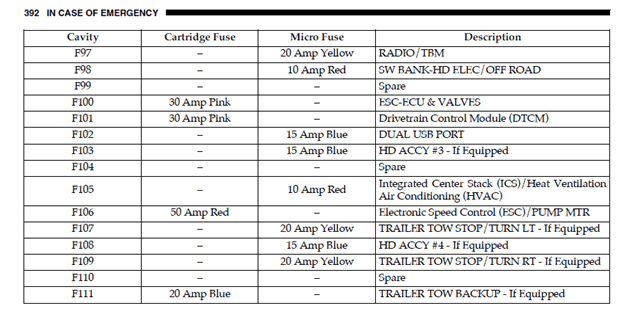

Looks like fuses F90, F107, F109, and F111 are related to the trailer lights with the tow package.
Fuse box
