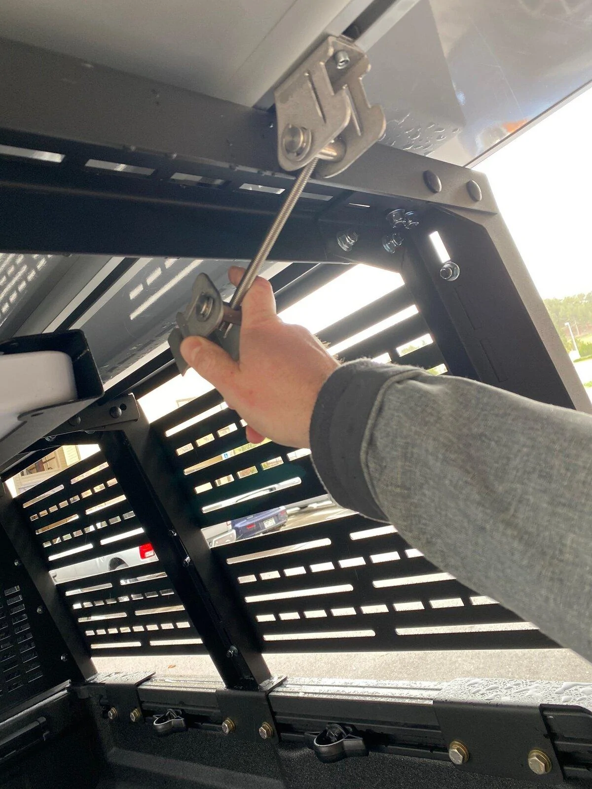

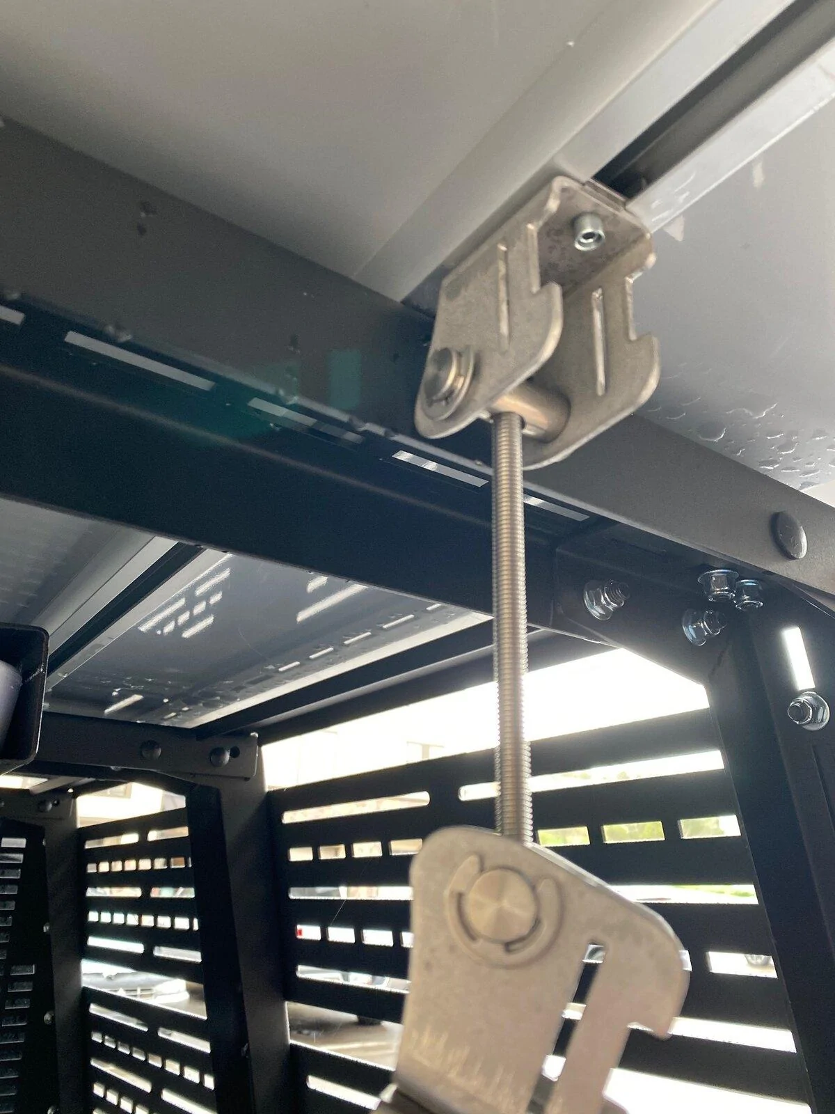

I recently purchased and installed a awesome rack by @RebelOffRoad a Full Size XPLOR Rack to hold my iKamper skycamp 2.0 Rack. Unfortunately trying to install it last night I found that the supplied mounting Brackets by iKamper did not work. The Size of the cross brace in larger than the height of the brackets. I could always get a longer bolt but I would prefer not to drill a hole though the cross brace to make the bracket work. I have attached some photos. My Current thought is to get a plate/bolt in the T-slot and bolt though the slot in the cross brace. Attaching photos of the issue below.

Thank you Taylor and Rebel Off Road for reaching out so quickly their Reco is Channel Nut, Bolt and washer.

I purchased a half rack from @RebelOffRoad and am waiting for the iKamper mini to be delivered. Looking at this I’m thinking I’m going to have the same issue.
What is their Reco Channel Nut bolt and washer…
Can you please provide your solution and possibly show some pics?
