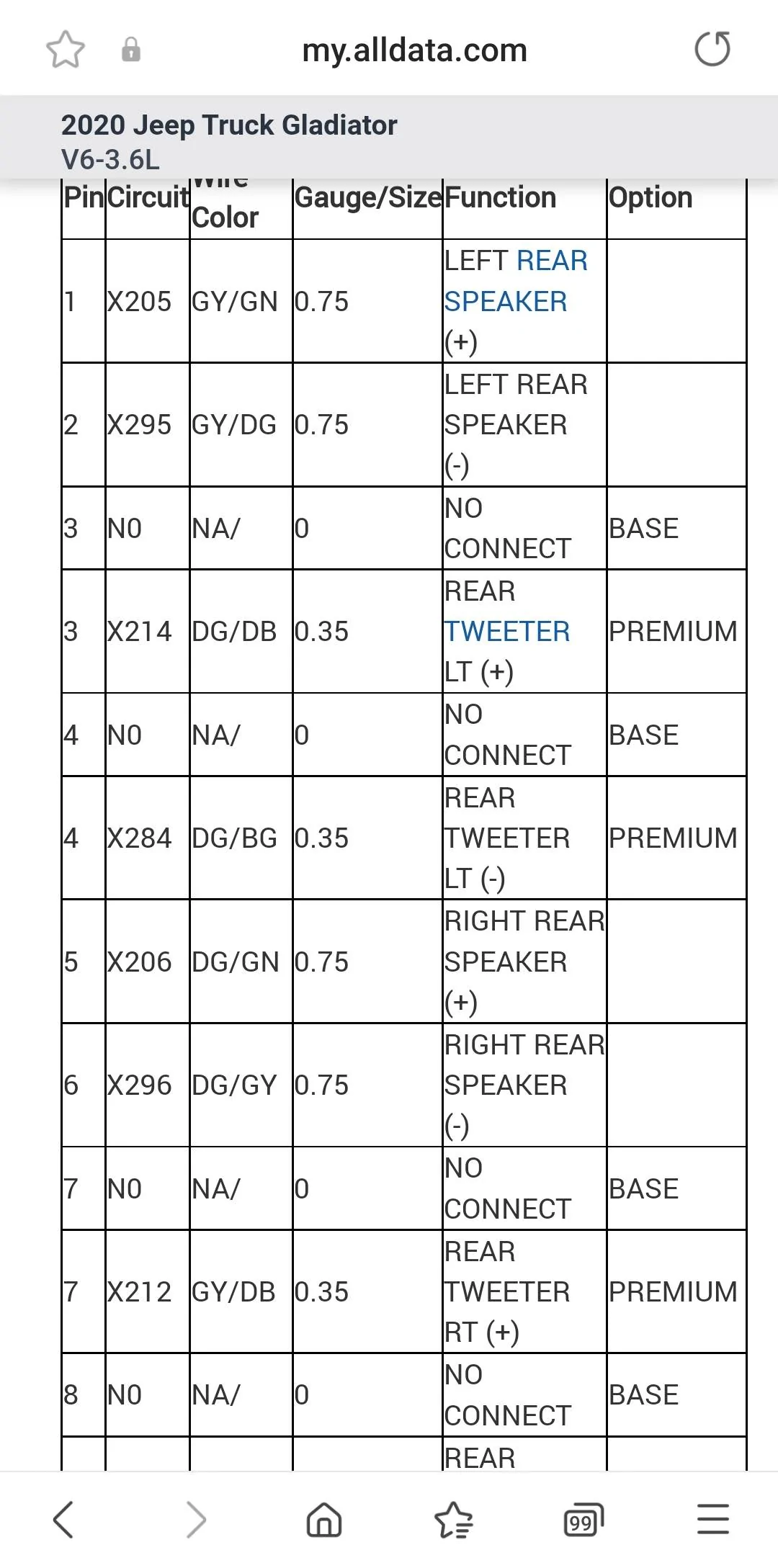

Are the signal wires in the b pillar green/yellow and green/grey? I don’t seem to be getting any signal from those?
cranbiz
Bob
Jun 28, 2023
690
1,025
Wentworth, NC
Left + is Grey/Green
Left - is Grey/ Dark Green
Right + is Dark Green/Green
Right - is Dark Green/Grey

Thanks! I’ll take a look and see if I can find them.
