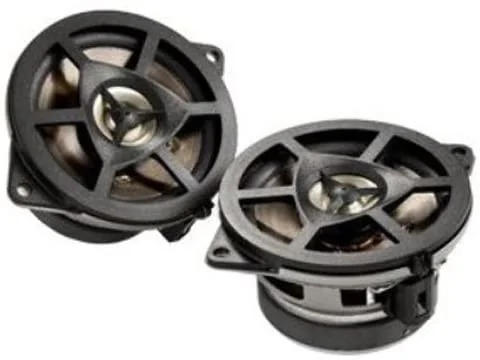

I had this same Alpine upgrade in our JLU. The power pack amplifier really does bring out the dash and sound bar speakers. Plus, the powered sub under the seat balances out the lows. I kept the factory 4" dash and sound bar speakers, but traded out the 3" tweeters with 2 sets of the Kicker 3" speaker upgrade. They sounded pretty good compared to the factory tweeters. Check out Mopar 77kick25ab and the will directly replace the dash/ sound bar tweets.

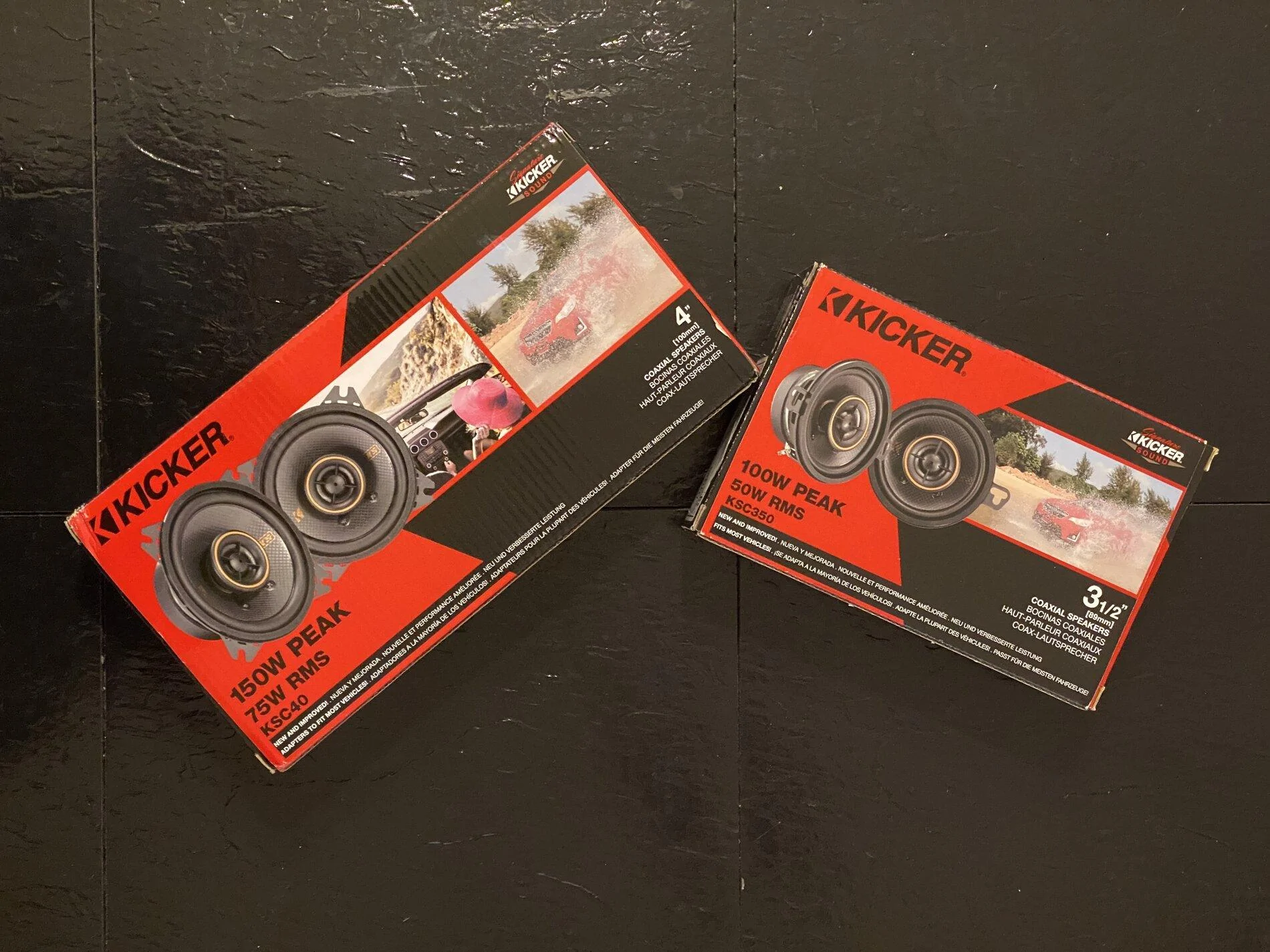

Xraytech
Kickers
47KSC3504 $62.96/pair
47KSC404 $80.96/pair
Note on the 404s, you do have to dremel out the stock speaker pods in the knee panels and sound bar. The holes are just a bit small.
