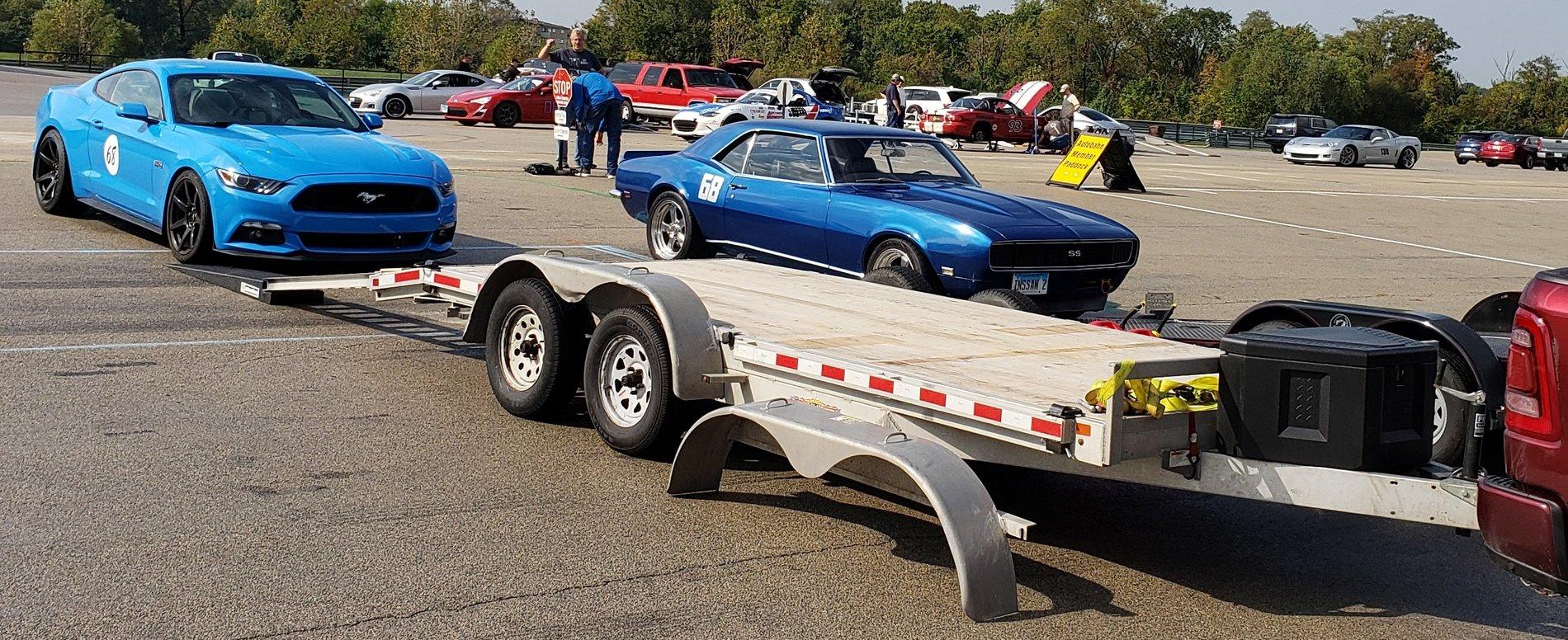

I plan to do just that, so I guess we will find out. Not sure if it is 5000lbs but it will be my race car on a trailer. Mine is the ford. The Camaro is my best friend's.
My guess, 5,000 and some change. The trailer empty is likely over 2,000. It's at least an 18 footer?
Curb weight of the Camaro new is over 3K Not sure of the 'stang. Some were 4 as I recall.

My trailer is 1208, it is aluminum. The car 3605 with tools and straps almost 5k. If I have to I will address cooling. I had to on my 2003 Sierra Denali when I supercharged it back in the day:)
