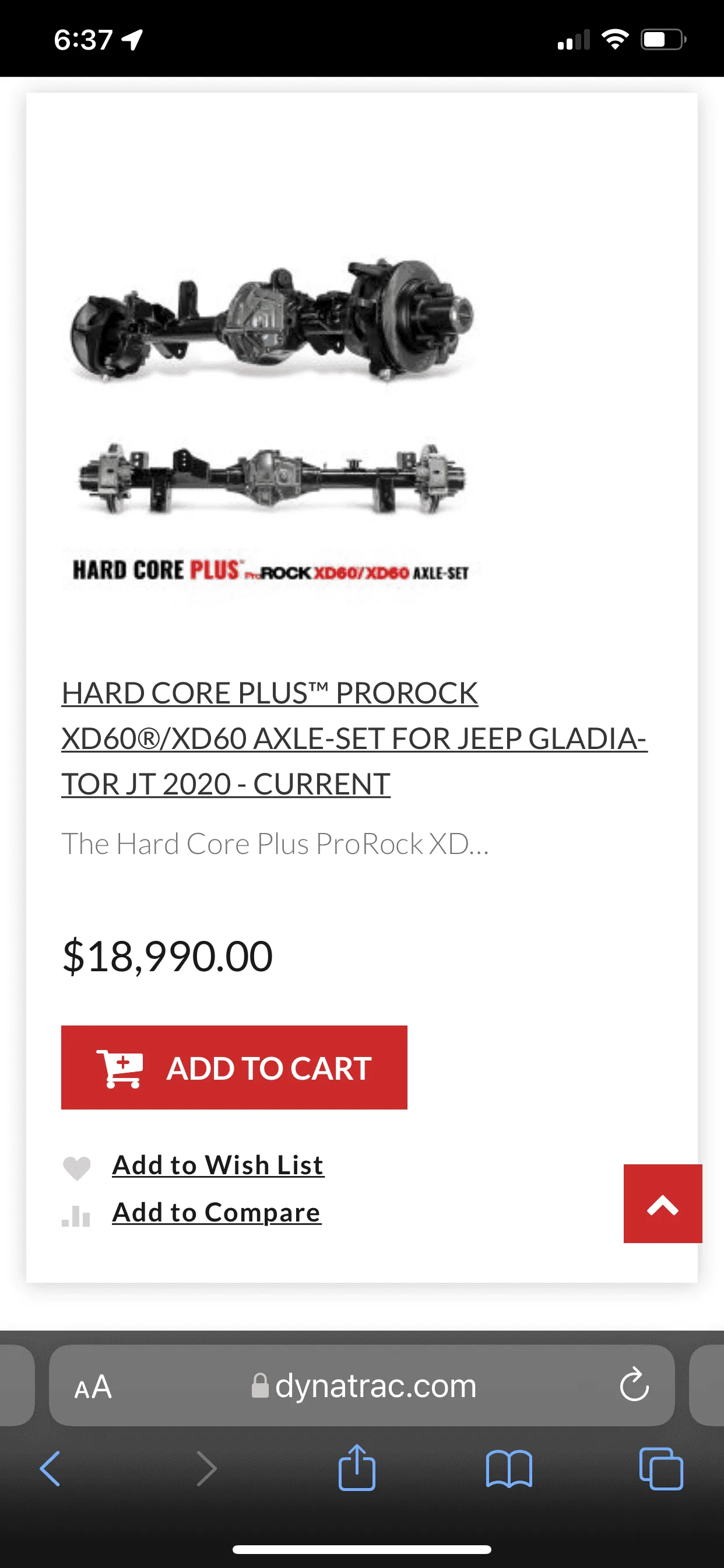

Now I imagine it's still gonna sell somewhat high for a written off truck, and I don't mind paying the price, I also don't mind paying good money for a 6.2 SC/ 392 pallet , my issue.....axles...or the price of them. 20k for built Dana 60s???

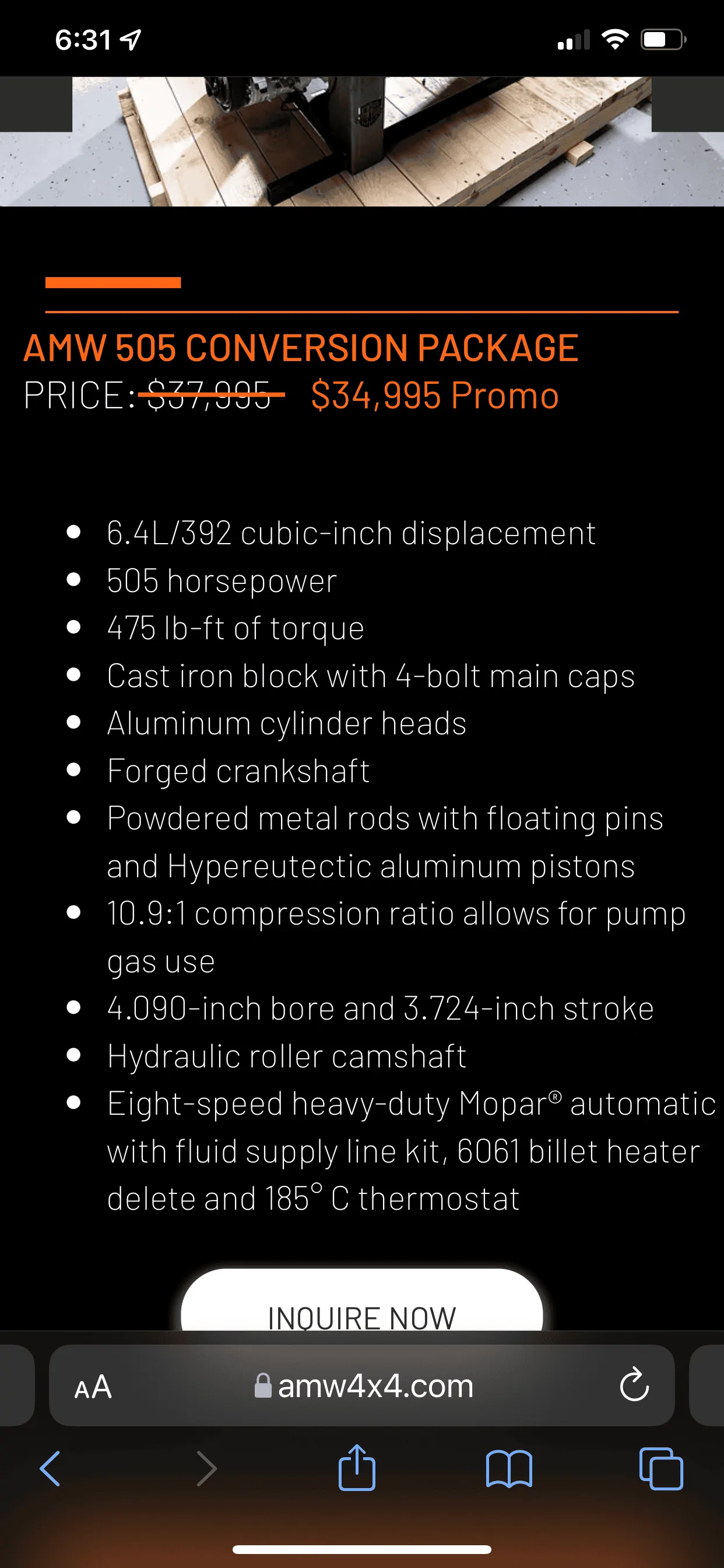

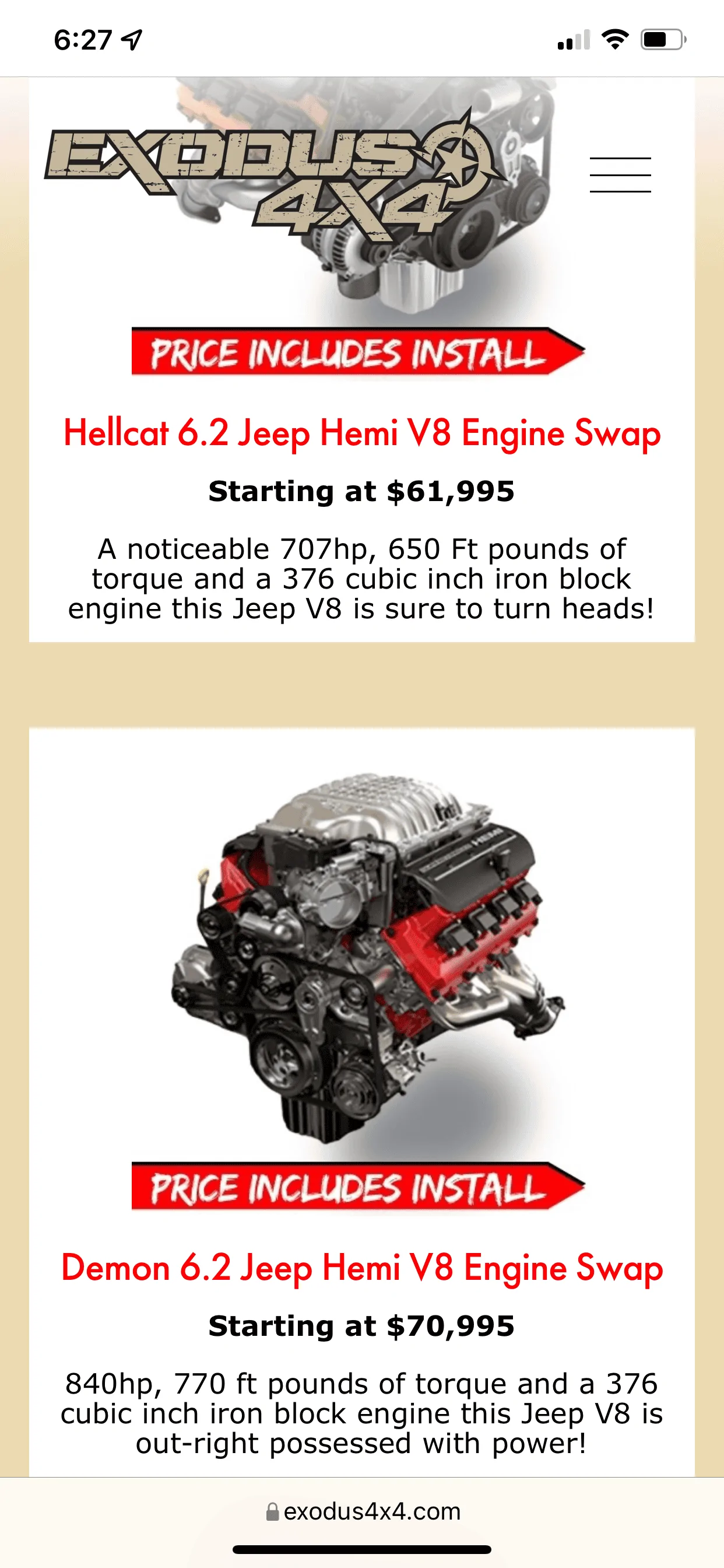

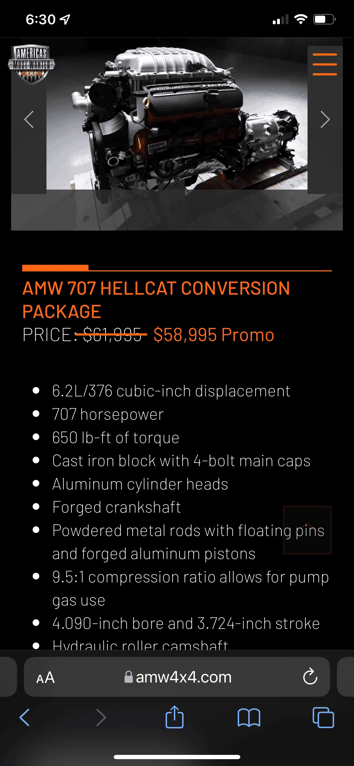

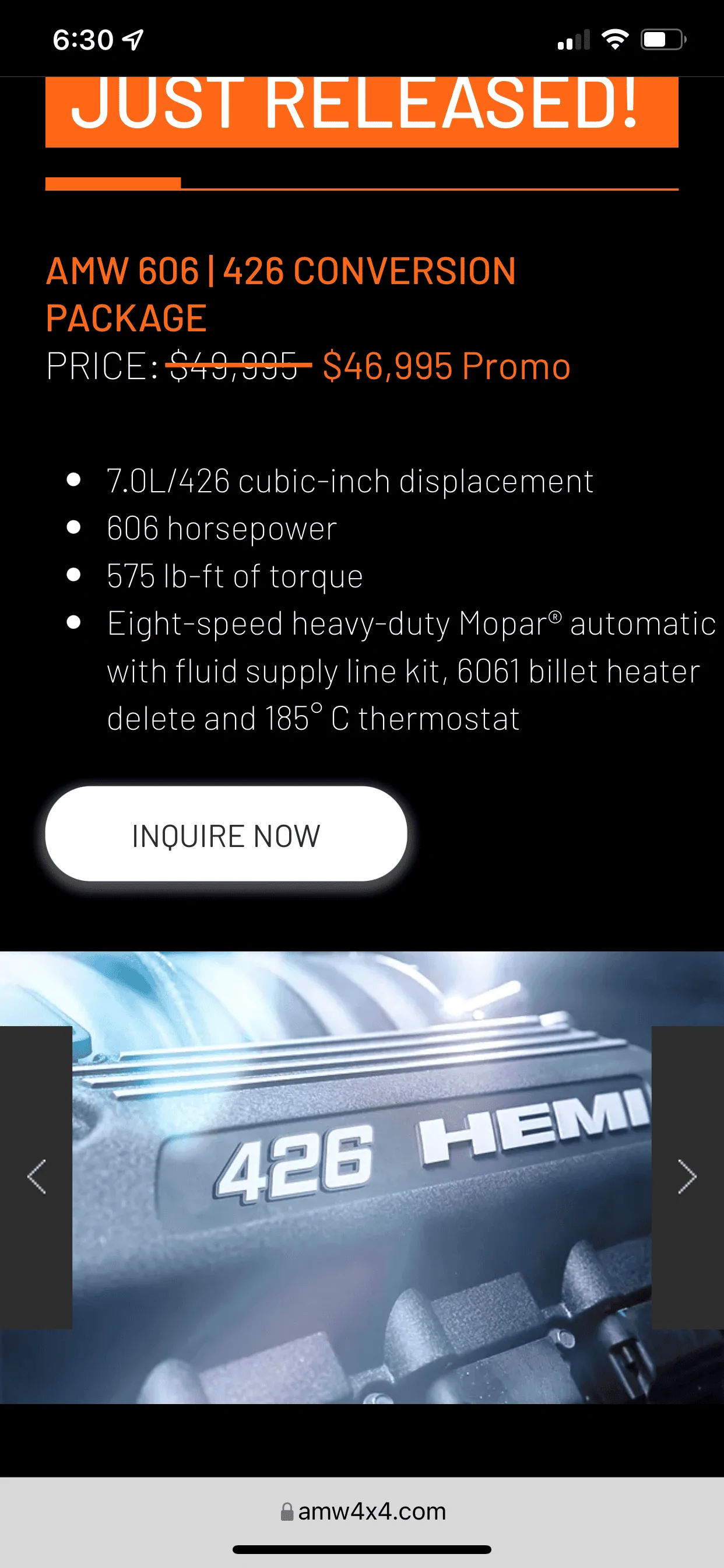

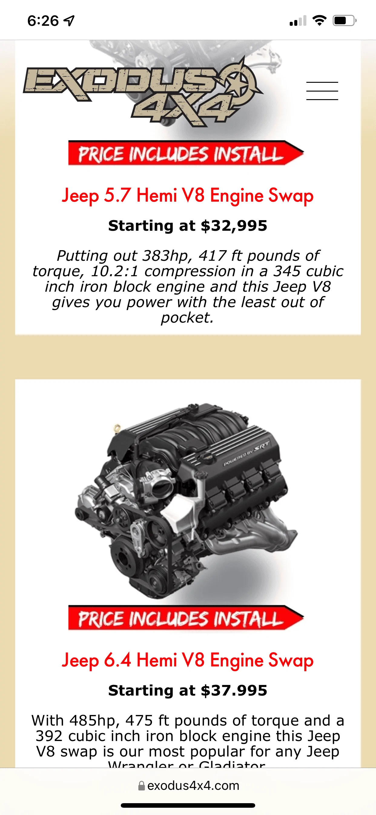

Not sure what you’re thinking a Hemi swap is going to run, but after dealing with the motor and transmission and any other subsequent systems involved in the swap including computer you’re probably looking at $30-$40,000 for the swap. Whats another 18 to 20k for axles?
https://www.dynatrac.com/axle-assem...dynatrac-axle-sets-for-jeep-jt-gladiator.html

All the AMW is expensive because they use new hardware and the labour cost is expensive. Now they are probably the best in the business and create the most "factory" like swap on the market but with some time and patience I'm sure I can have similar results for much cheaper as I'm doing it myself.
392 pallets from SRT Jeeps/Challengers/Chargers regularly go for about 7-10,000$
8 speed from a ram 3000$
Plug and play harness 1500$
Driveshafts 2500$
And that covers the heavy lifting. Everything else is relatively easy.
Plus sell factory engine and trans for 5-7k.
I don't think it'll cost me more than 20.
