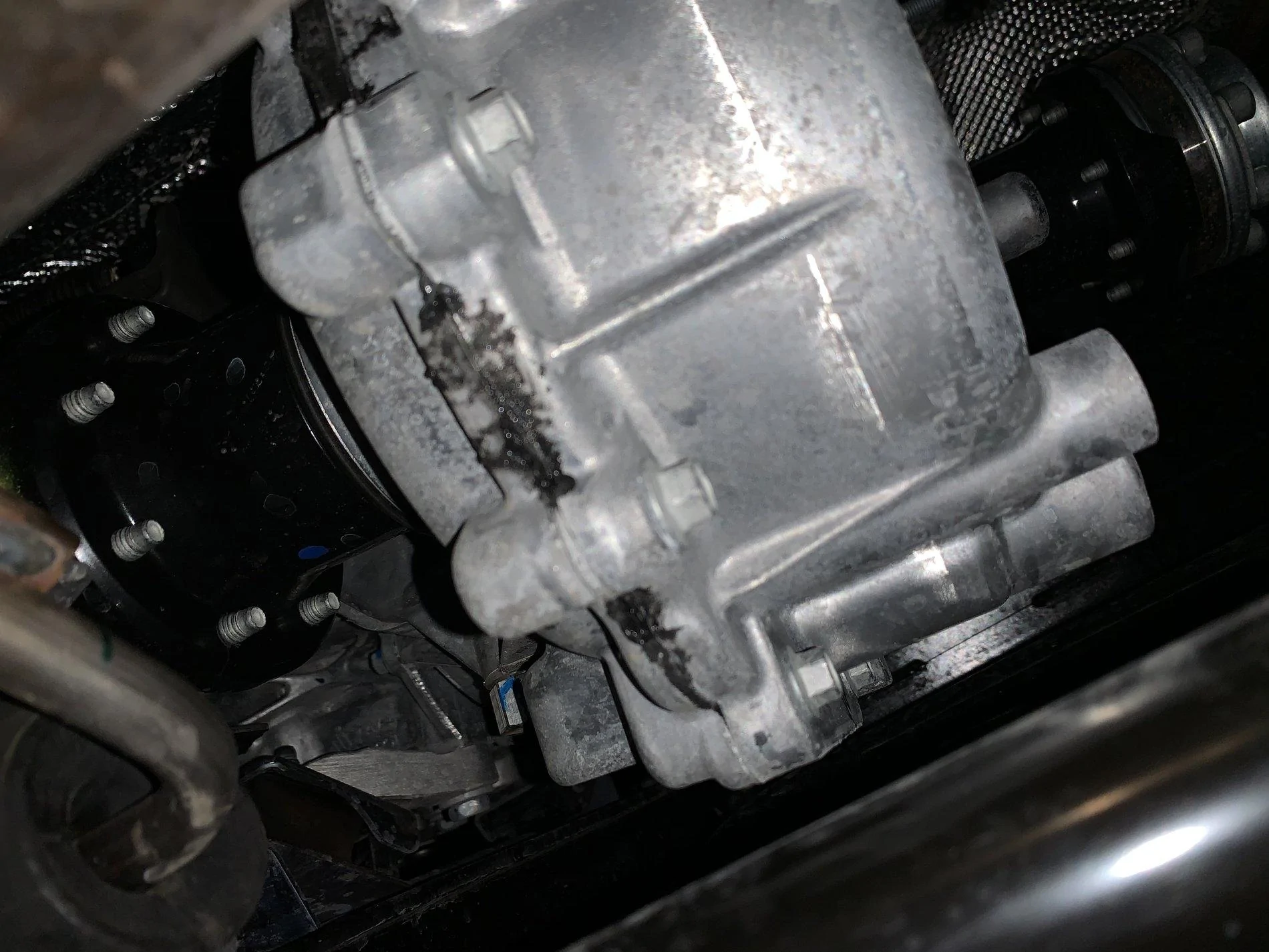

Think I found the problem... Transfer case seems to be leaking.
Doesn't matter if you have any other problems, noises, rattles, whatever - THAT is not good no matter what.
Yeah taking to the dealer first thing in the morning. Hoping itā€™s not a long fix and also solves my issue.
