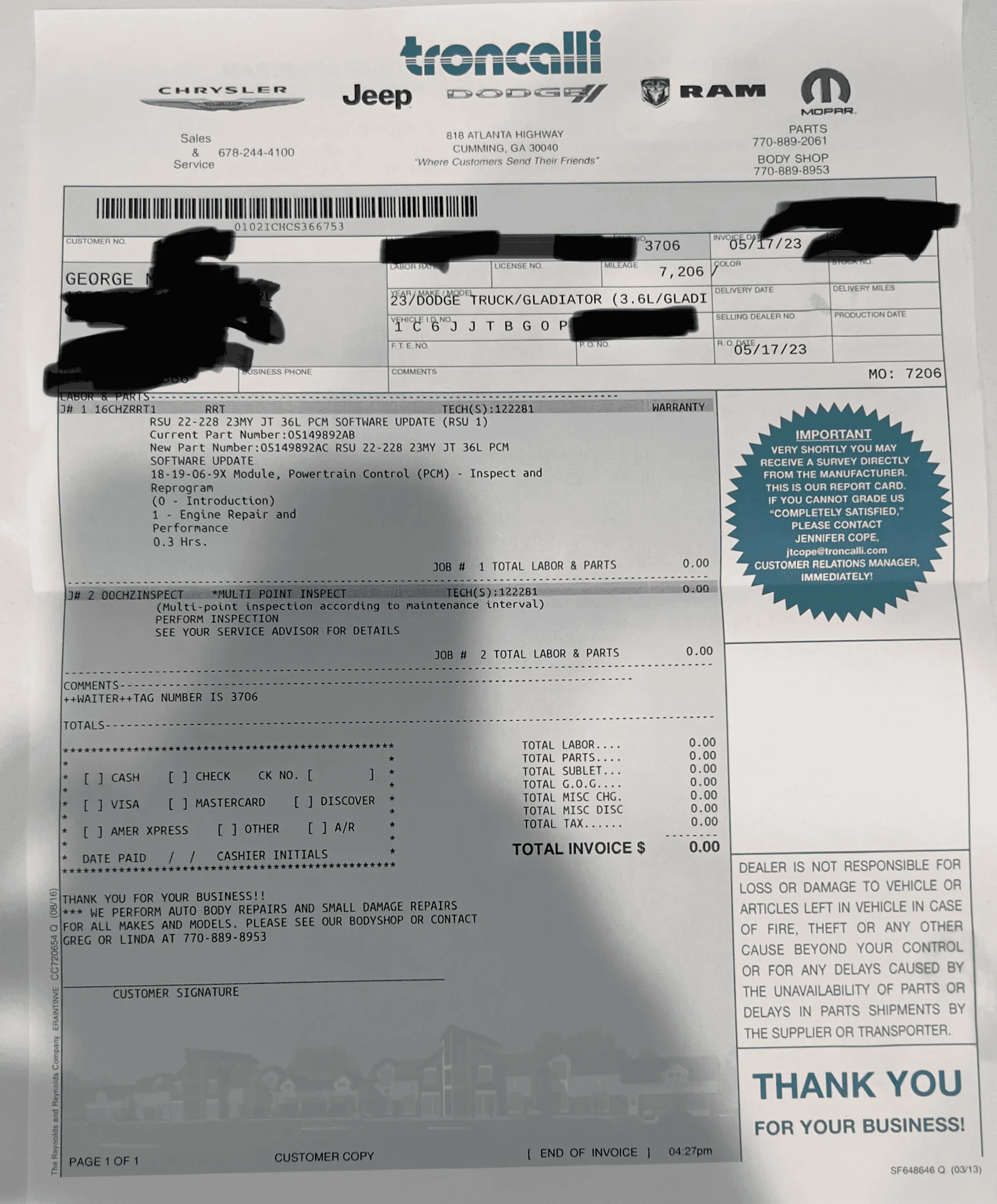

Just had a RRT which I suppose is a manufacturer elected update for systems. This one affected the PCM.
Quick background, took the jeep back in 6 weeks ago to have them check the hesitation. They noted that a trans tech would be 3 weeks out, but my SA said he would see what he could do. They resets the learning curve on the transmission and off I went. Hesitation was still there but not as bad.
Fast forward to today, the RRT was a PCM update, and so far, no hesitations that I can feel. Tomorrow AM will be a better indicator.

Adding more here, the RRT allegedly dealt with the charge temperature sensors; there is two part numbers listed on the work order. I have further noticed that it does not seem like the transmission is slamming itself into lower gears when slowing down. I experienced this during 3-1 shifts in Auto mode, making braking modulation difficult. It now seems that it lets the engine wind down from 3-1 without using the transmission to slow the jeep down, a welcome change.
Granted, this could all be a placebo, but so far, knock on wood, zero hesitation this morning on my drive where I would have normally had 2-3 moments of hesitation.

Any idea what the rrt number is or when it was released? I have the same symptoms, they flashed the pcm back in January but curious if this is a newer one.

I believe it is relatively new. My hesitttion is back and i have an appt on the 19th to get it checked out.
Jeep Gladiator Hesitation in 3rd Gear at 2k RPM 1686575790125

Thanks, bummer.. thought I’d finally have a fix. My dealer just tells me it’s shifting as expected
