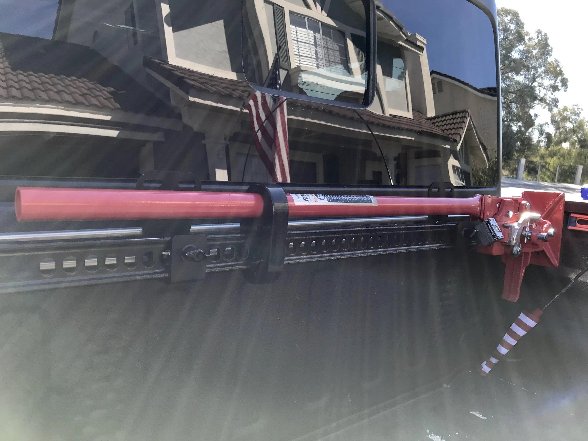

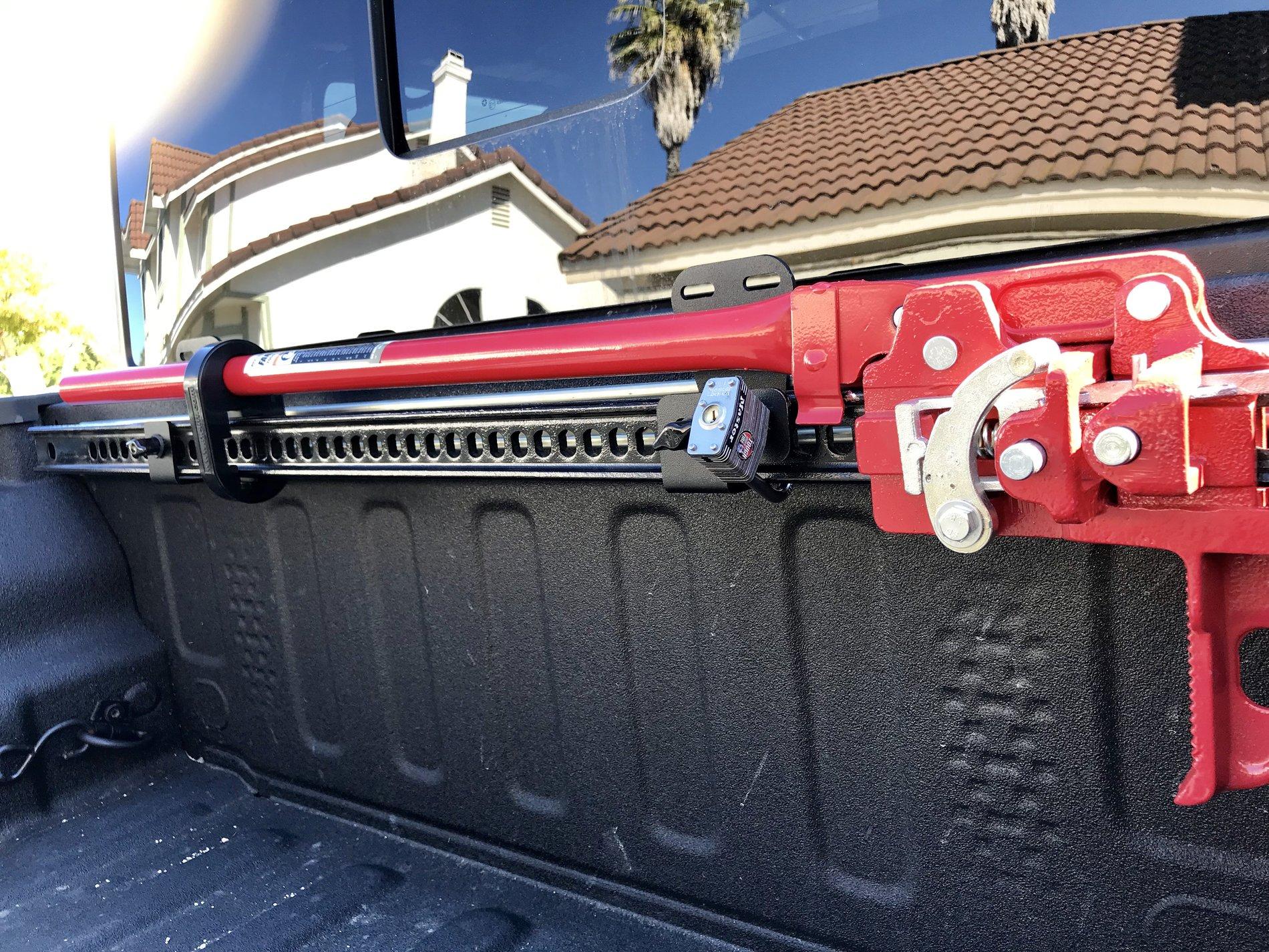

I used the hood mounts, but attached them to my bed-rail, I’ll likely lower it to sit below
the bedrail soon, simple adjustment.
These jacks are heavy, wouldnt take much to mis-handle and do some serious damage to your hood, especially if your lifted.
The reflection threw me off for a second...thought it was on the tailgate lol. Nice install!

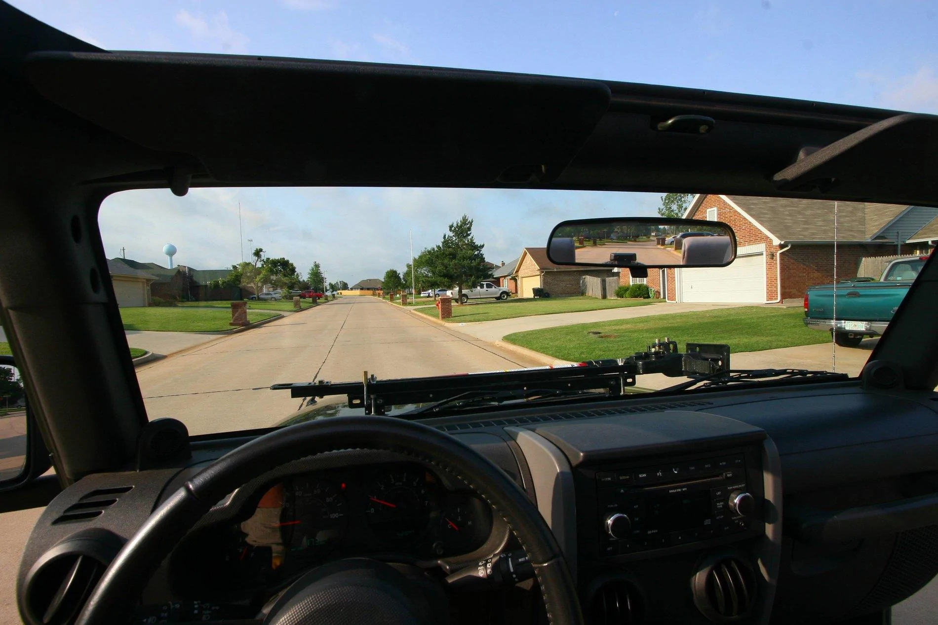

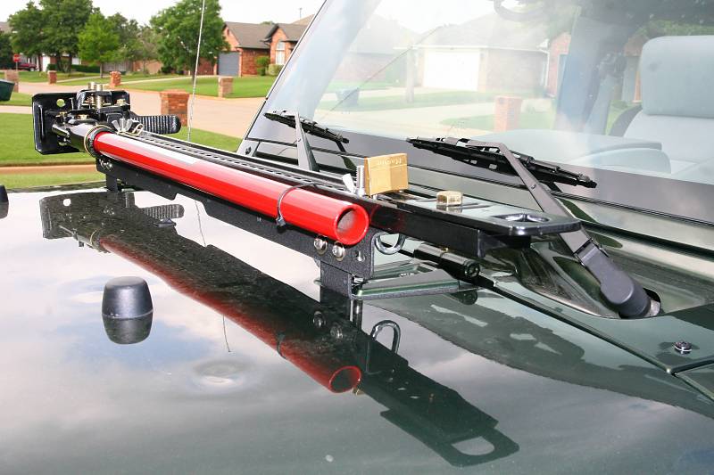

I have experience at this. On my JK, the hood mount does not interfere with the windshield sprayer. The crossmember has a notch in it to clear the spray. My JK is an '07 with a single sprayer--not sure if they've adapted those notches or whatever for dual sprayers, but ask the manufacturer. In the event there was interference, the manufacturer of mine (ToughStuff) provided small stainless steel washers to shim out the mount. I didn't need them, and they say it's very rare to need them.
On my JK and on other Jeeps where I've removed the hood, amazingly that paint has never broken such as to leave open spots for rust to develop. You can't even tell my hood has ever been removed. It looks perfectly factory, and there is no rust--on a thirteen year old Jeep that is always parked outside. Of course, my door hinges have no rust either, and I cannot explain that.
As for interference with the view, it's pretty mild.
I'm about 5'7" or so (and getting shorter at my age of 70). That is what I'd see if the jack was still there. But now I see the shovel and axe that replaced the jack (ToughStuff gave me parts for either configuration).
