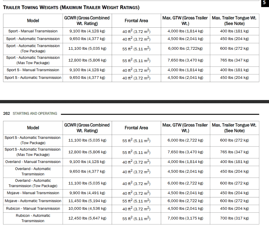

The hitch I intalled is the factory hitch capable of towing 7600lbs. As far as I know the Rubicon can tow 7000lbs. This should be more than substantial.

The tow package is not just the hitch. The vehicle gets upgraded cooling as well as alternator iirc. Be careful what you tow in what conditions as overheating could well be an issue for you without the cooling upgrades.
Damn I was afraid of that. I will look into it more. I was told the Rubicon can tow 7K lbs as is.

According to the manual the Rubicon is the only model that doesn't have different tow ratings for with and without the tow package so perhaps you're ok. The only tow rating change on the Rubicon is manual vs automatic transmission.

The extra engineering may make it better at the fringes of capacity but you would not notice it in most cases. Your real issue is the door sticker does not match what it probably can do with the upgraded hitch. That could be an issue with your insurance company if you ever get into an accident. (Less likely but still possible, law enforcement)
