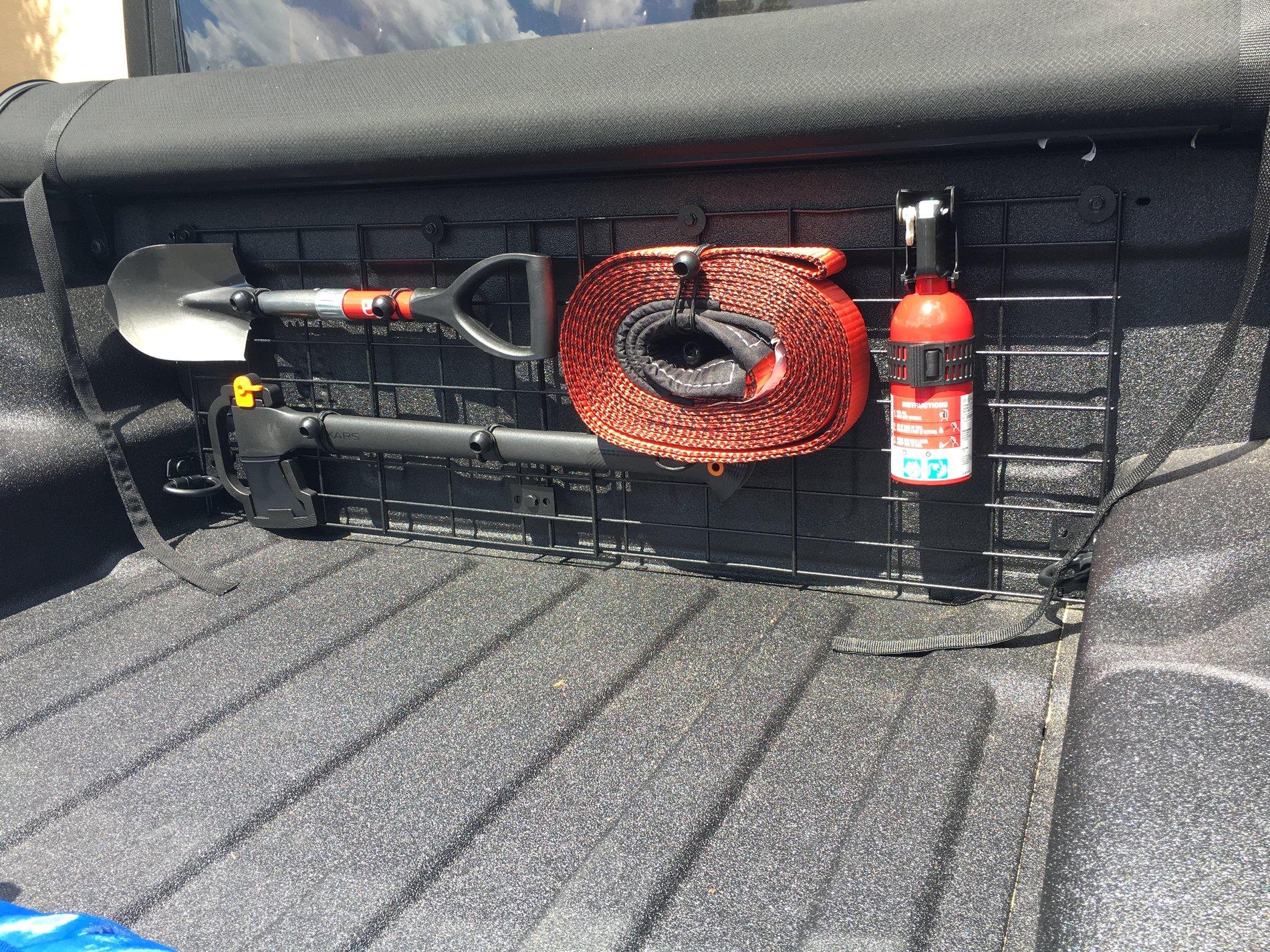

Well, I actually like it! Can you post more details of the mounting?

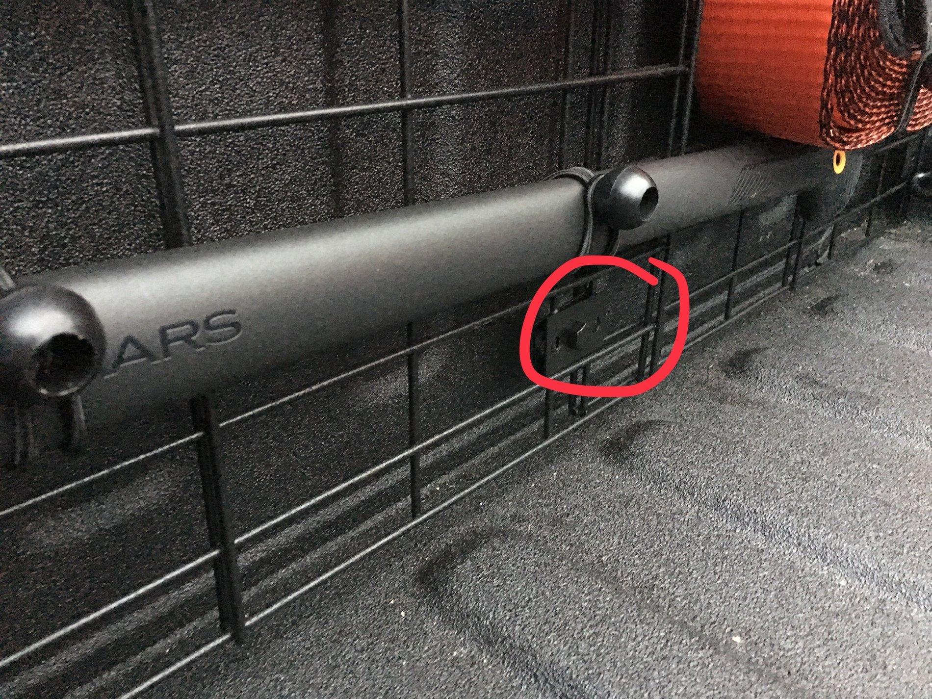

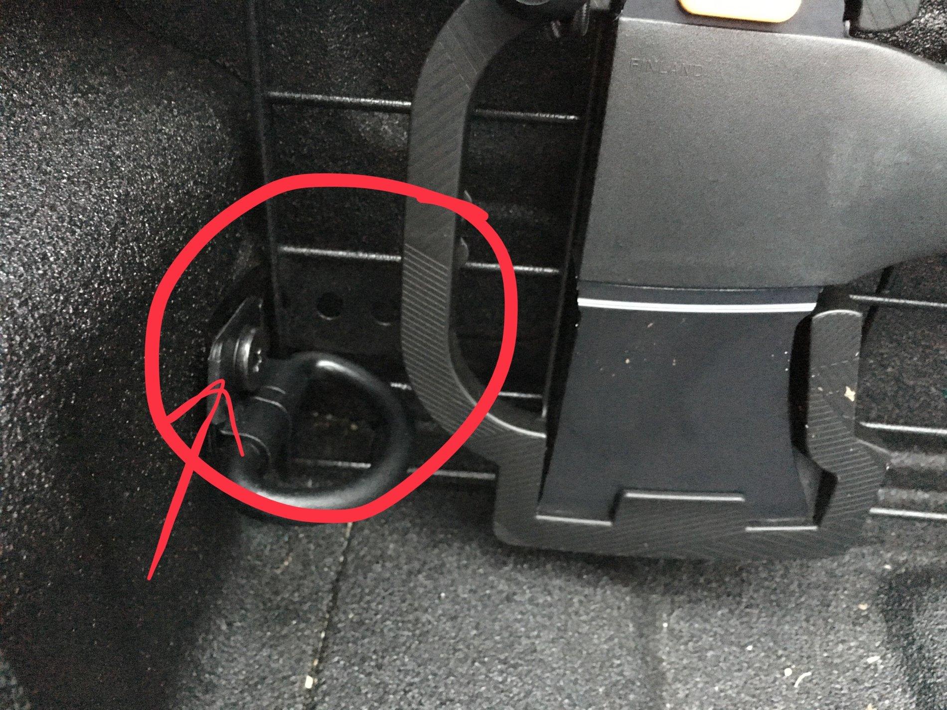

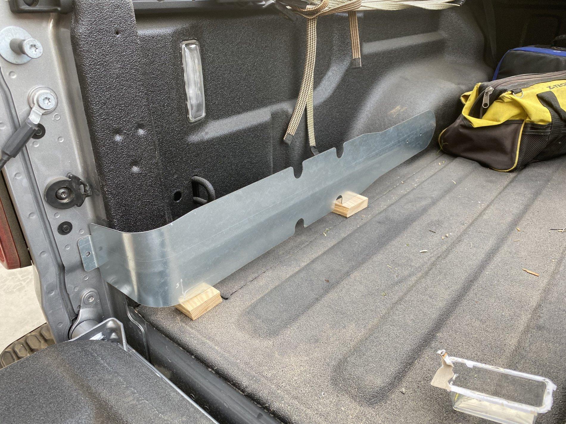

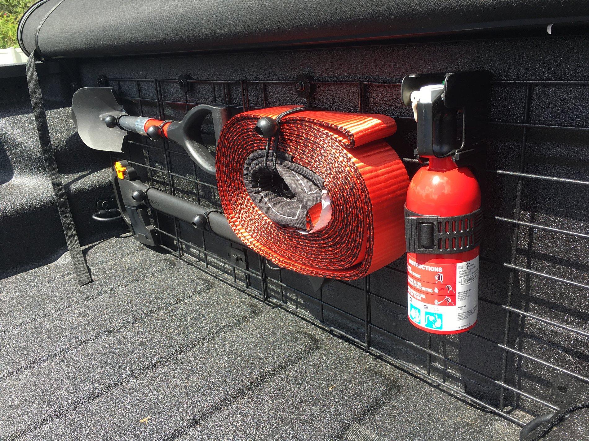

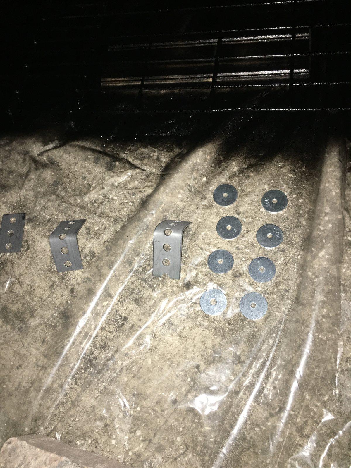

Had to explain, maybe I’ll make a quick video.

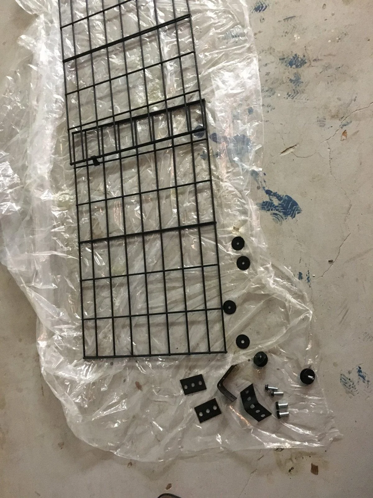

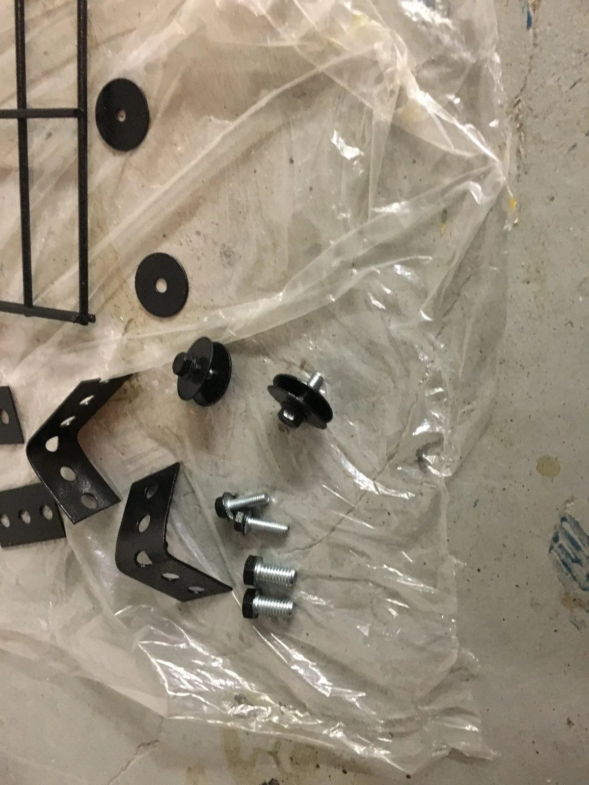

I bent a metal strip into a L shape, one hole goes where the factor tie down bolt goes. The other part goes between the grate to keep it from moving around.
I bolted two strips in the middle to tie the two panels together

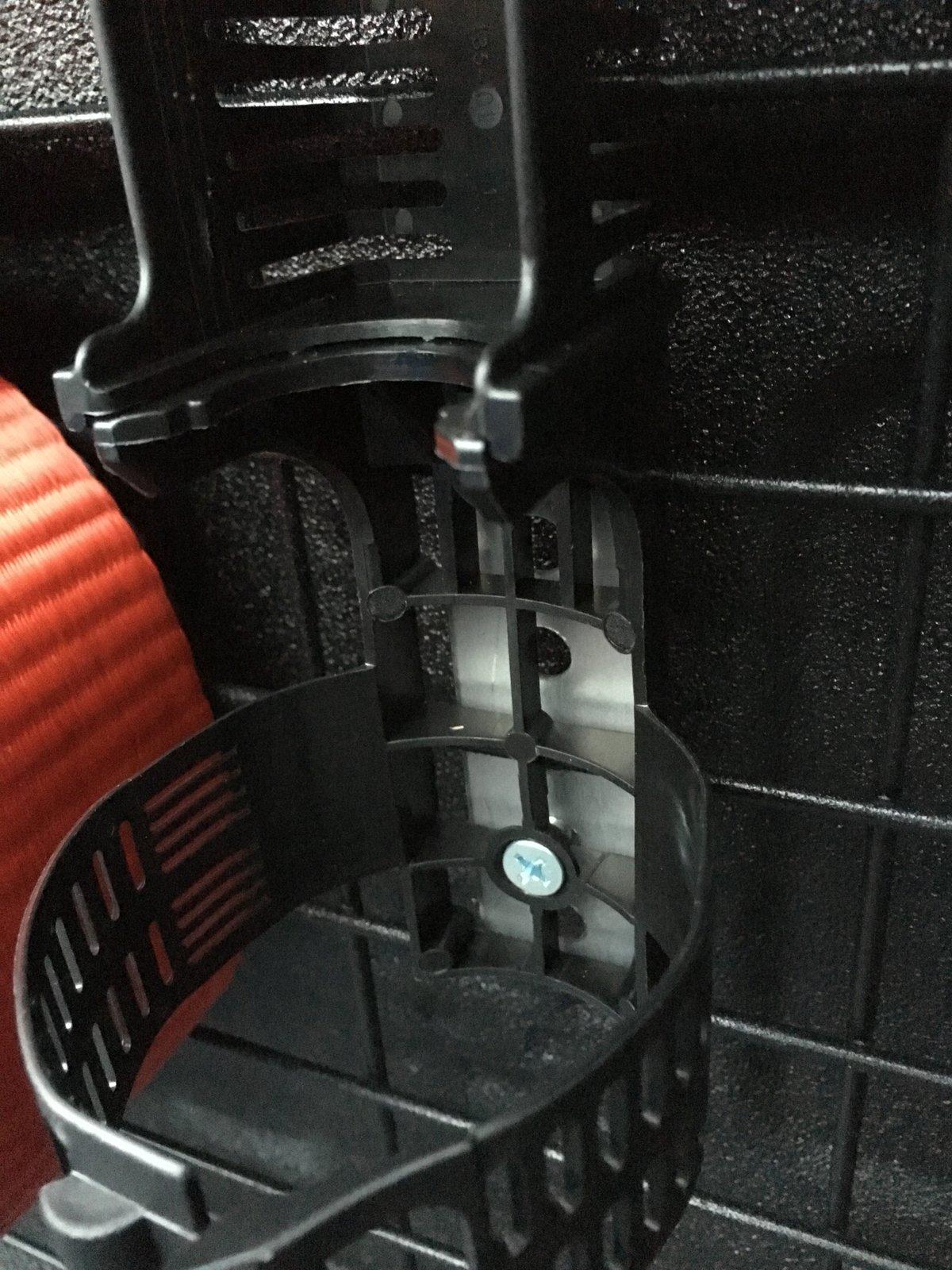

Used a strip to mount the fire extinguisher holder

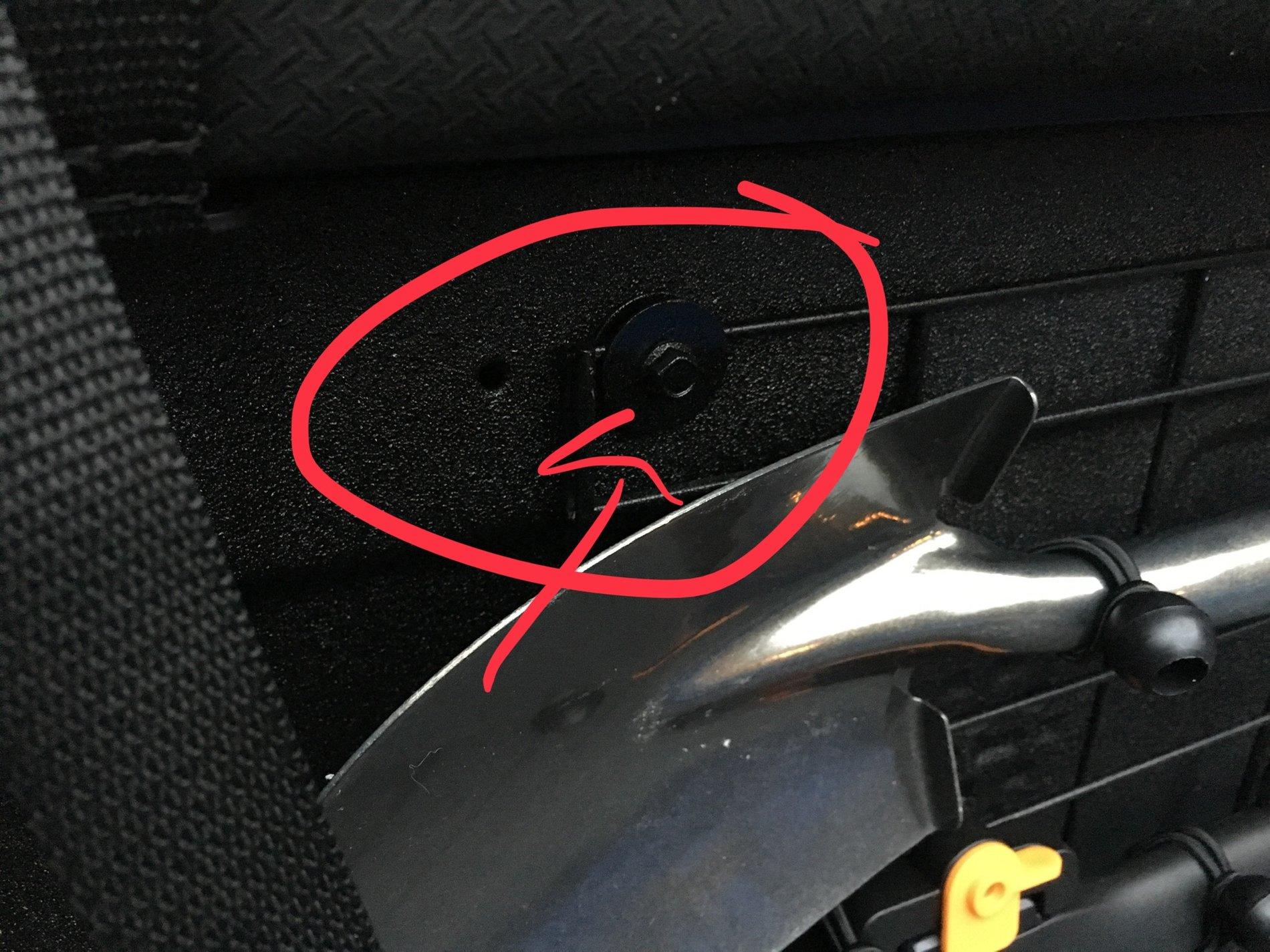

The shelving rests on the bolts. Four m6 bolts go into the factory holes for the trail rail. I used washer to hold the grate between

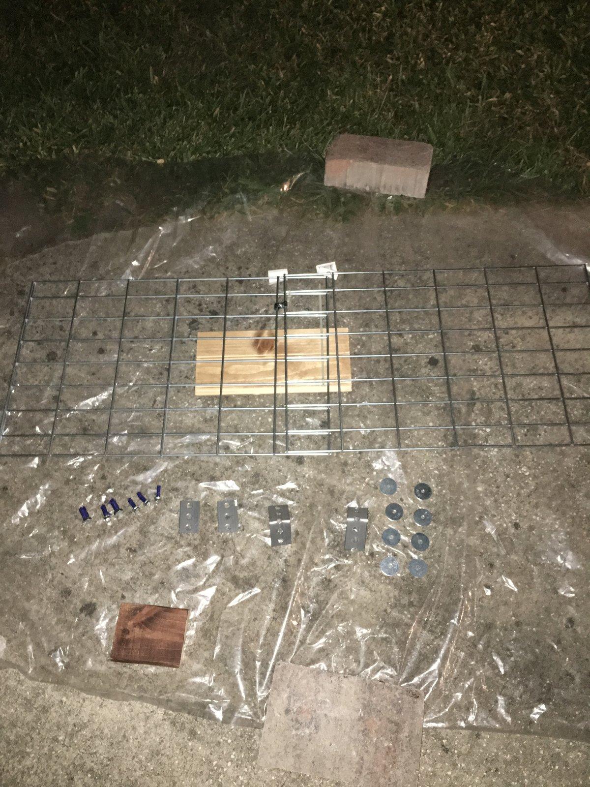

Here’s the shelving I bought, Home Depot 24” x 15” wire shelf
