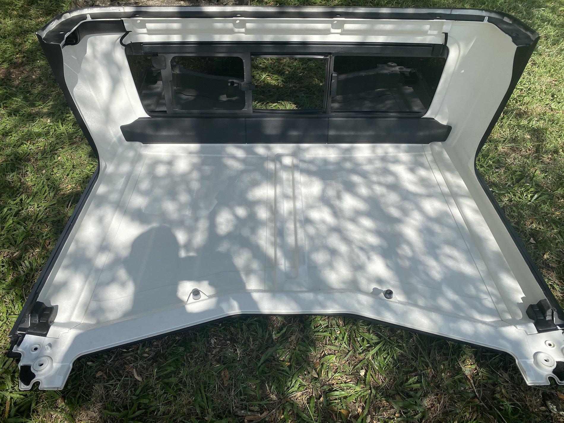

did you end up scuffing up the interior side of your roof panels or just stuck em on the way it was. i heard people said the panels fell after a couple months because they didnt use teh sand paper

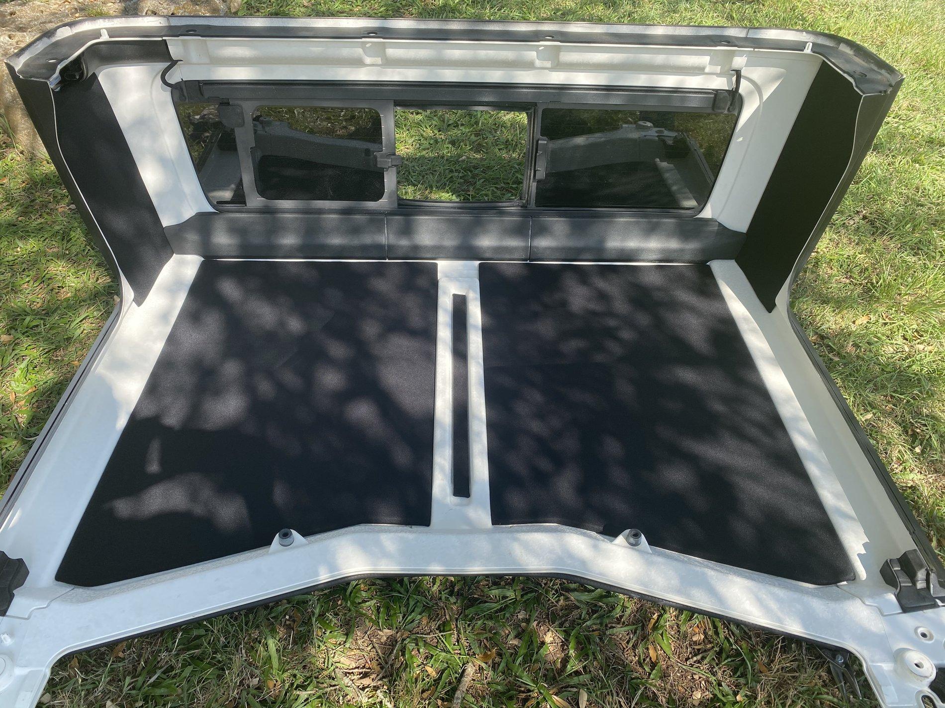

Did it exactly as the directions called for. Honestly after the small amount of sanding you couldn’t really tell it was sanded. It’s just to flatten out the textured finish.

sanding is apart of the HH instructions?
Yes, a couple of passes of light sanding where the adhesive would apply. It's very little effort, and that sanding, followed by wiping down with acetone, allows the headliners to really adhere to the surface.

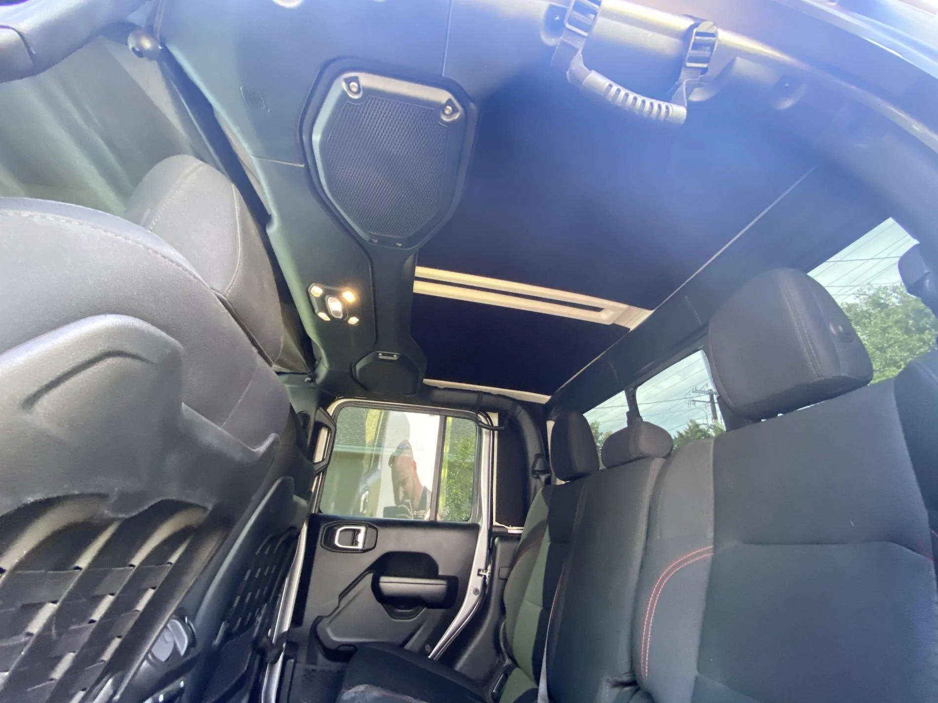

Now that its getting hot outside is there a large difference in the amount of heat in the truck? Is the truck quieter too? no echo?? Thanks
I've had the HH (side panels & sound assassins) for about a month now and although it's hard to quantify, I feel that:
A: The parts with the liners are nowhere near as hot as the exposed panels (my kids always ask why I touch the roof when we get in)​
B: The interior is quieter​
C: The stereo does sound better​
What I can't tell is if that translate into faster cabin cool down or not. But with the results above it doesn't matter. Best $$$ spent yet.
Just my $0.02.
