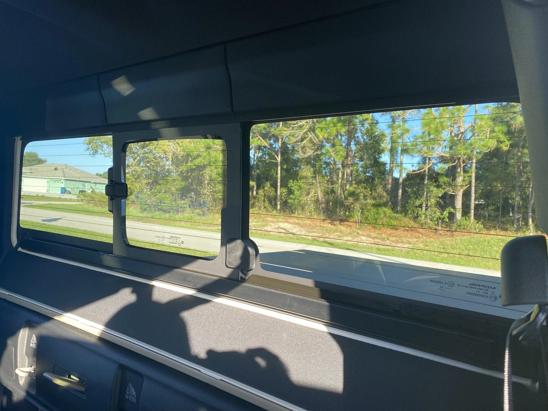

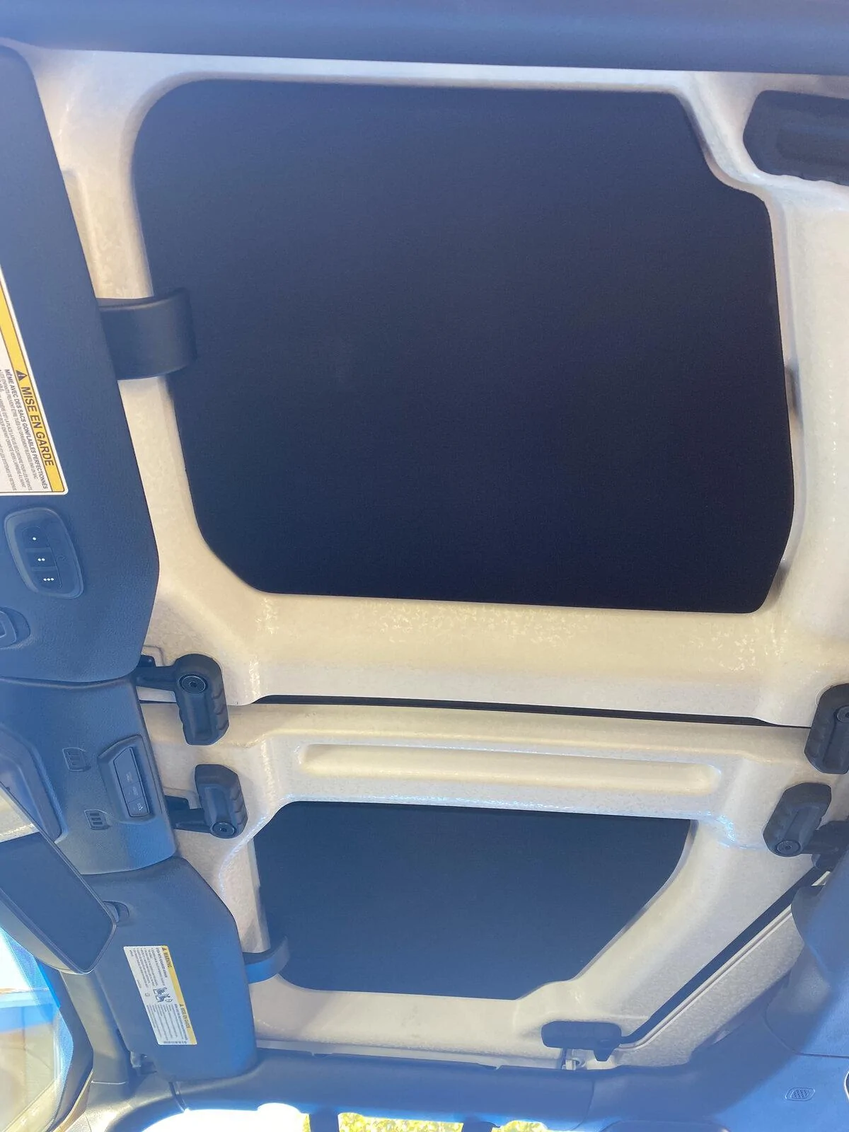

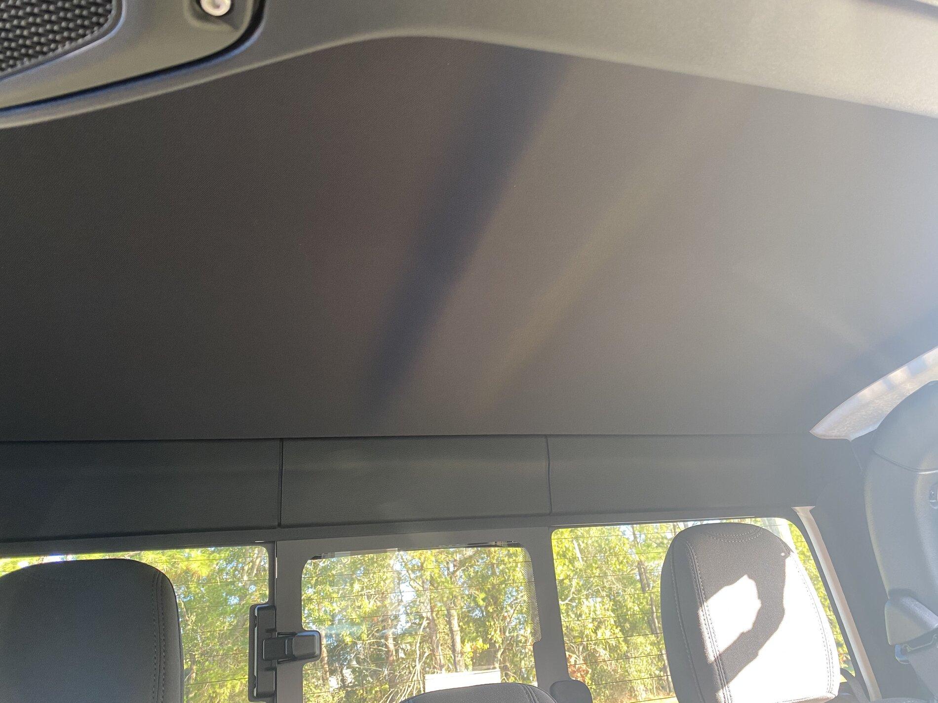

I went with the Mopar headliner. I got a good deal from my dealer as they run discounts on accessories. I found vast improvement in the radio/stereo sound and improvements in road noise as well.
Plus, IMO, the Mopar setup looks a bit cleaner/more finished than the aftermarket ones. VERY simple to install (I took the top off) and no sanding required (but vigorous cleaning is).
