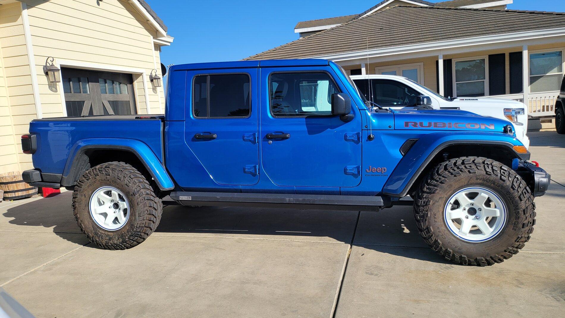

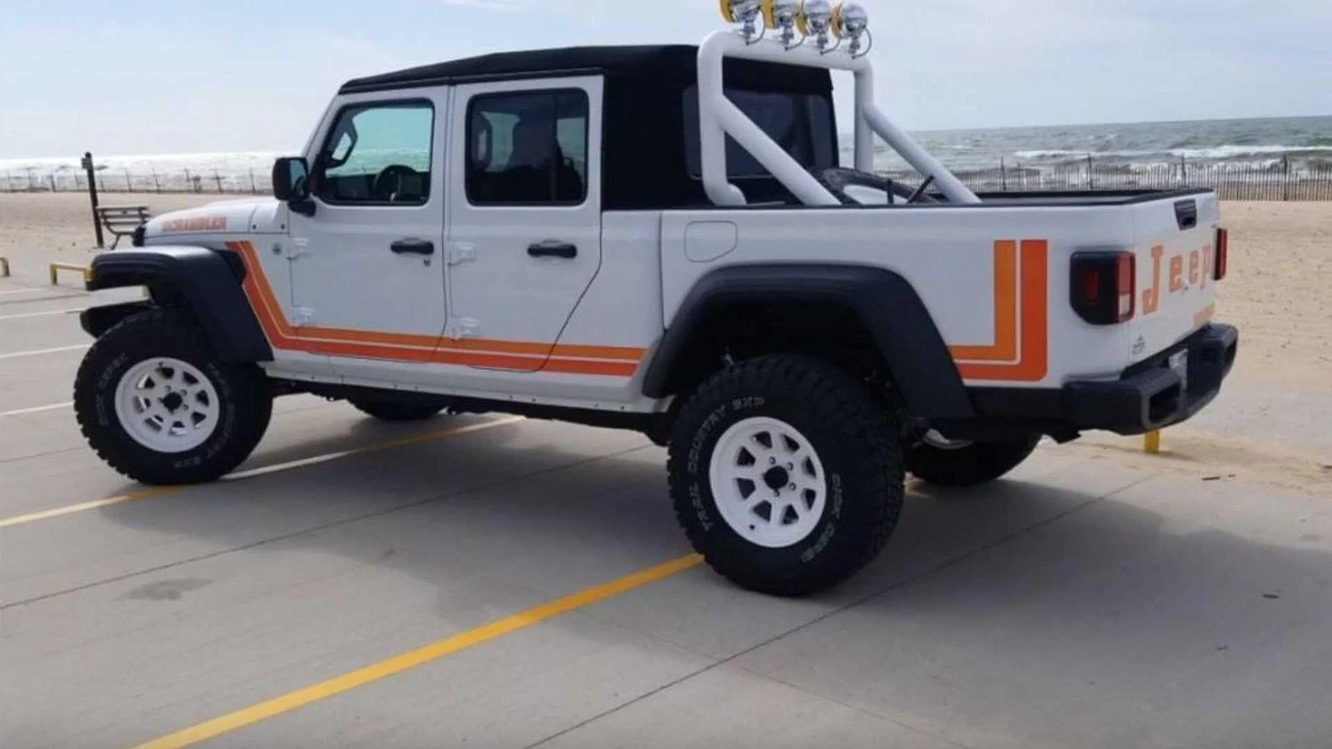

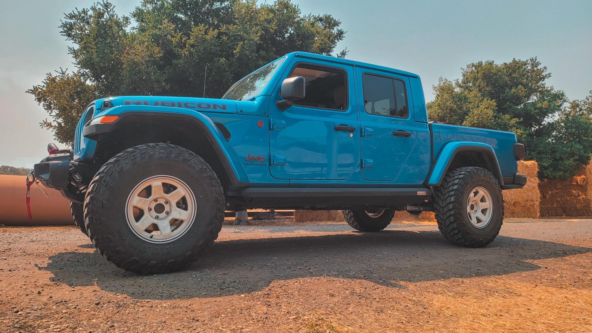

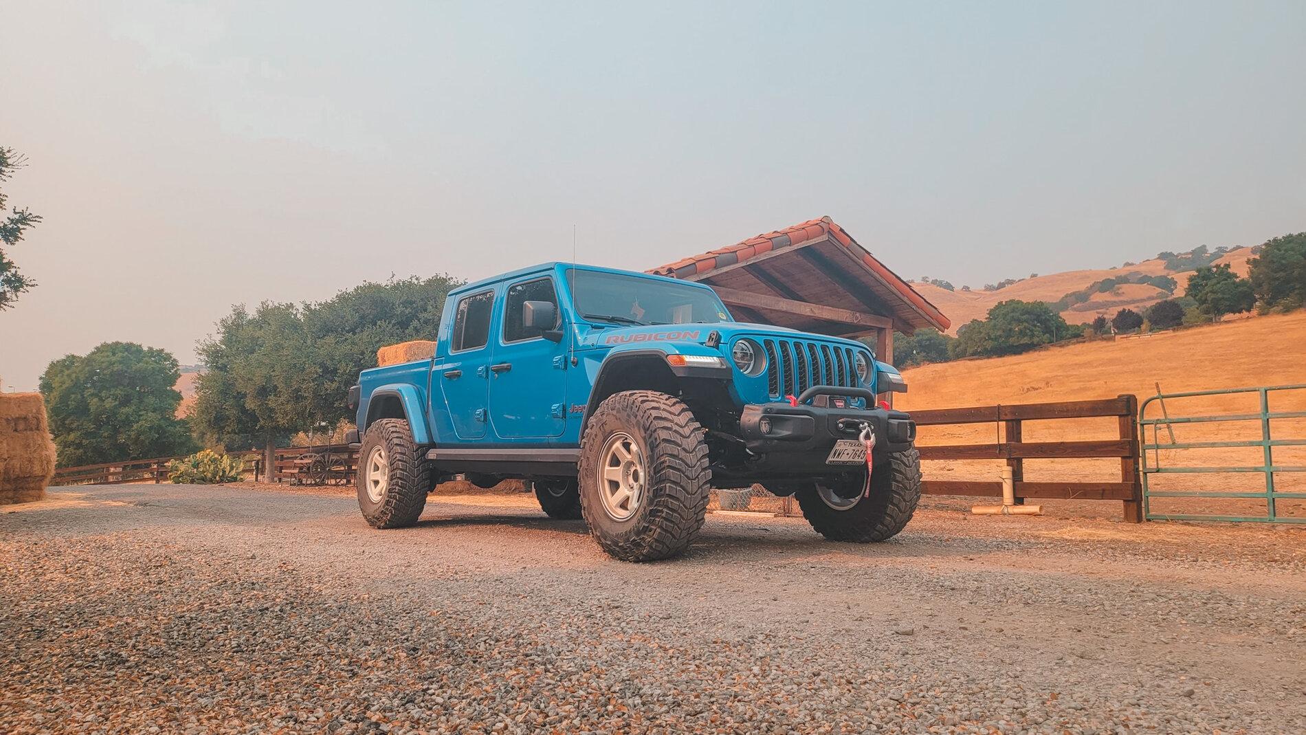

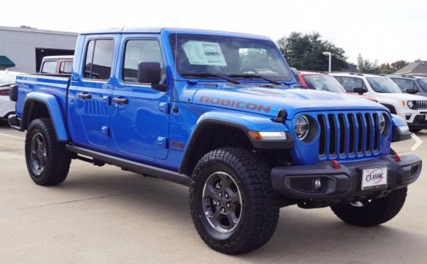

So glad to have a Jeep back in the driveway to enjoy adventuring in with the family on the weekend. We have them at the ranches but don't get out to them enough to really enjoy them for just good off road wheeling. Have been really excited and chomping at the bit to get one of these EcoDiesels in a Jeep for a long time. My nephew had one in a Ram and absolutely loved it. We plan on going with a retro style with modern high performance components.
Icon Stage 7 2.5"
17" Black Rhino Roku Powder Coated White
37" DC Extreme Country
Yellow Bee Design Retro Stripes

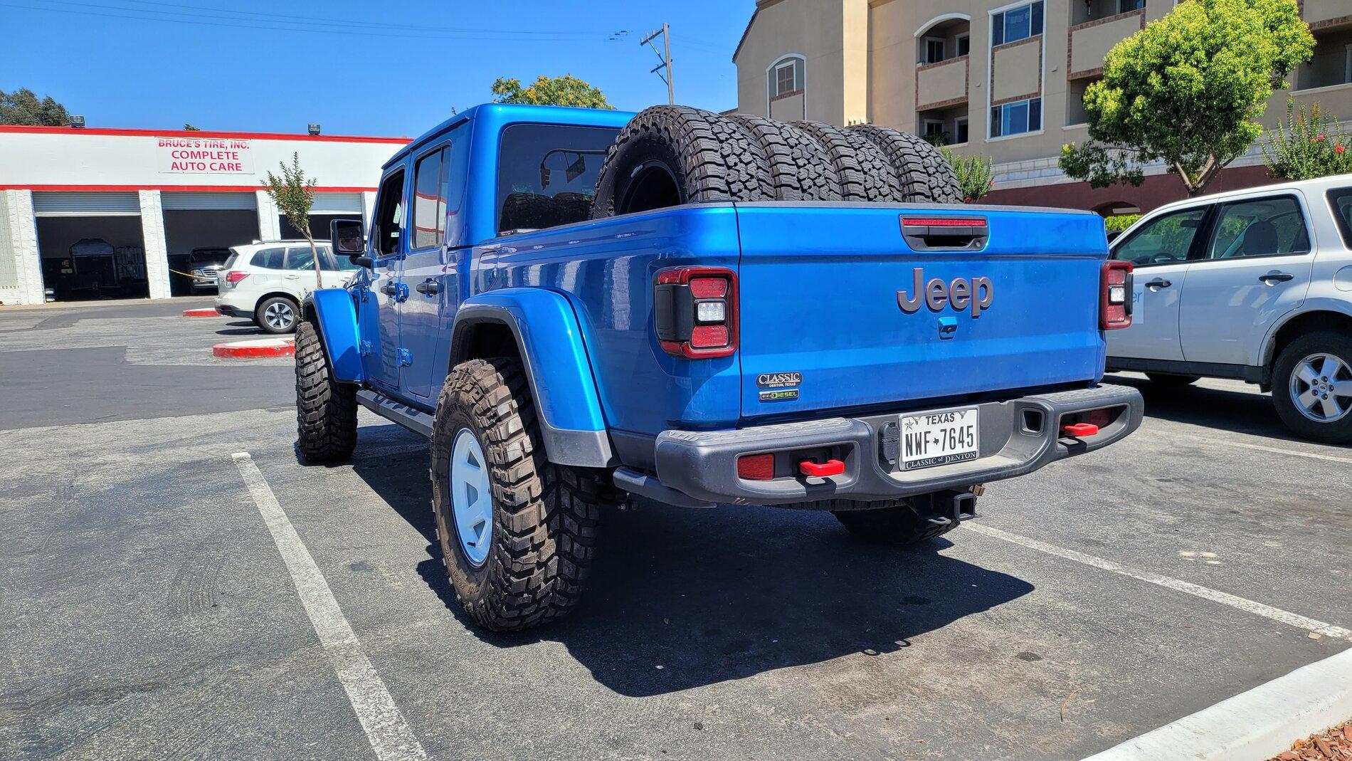

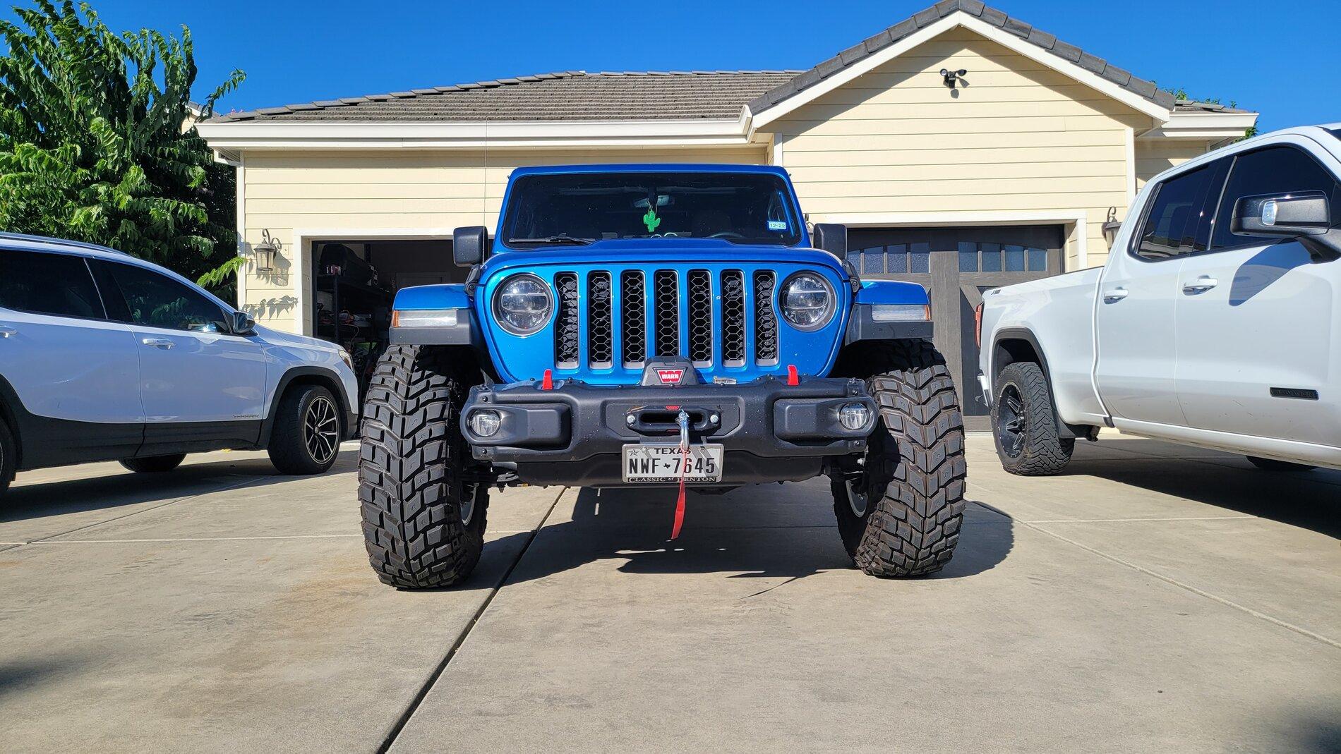

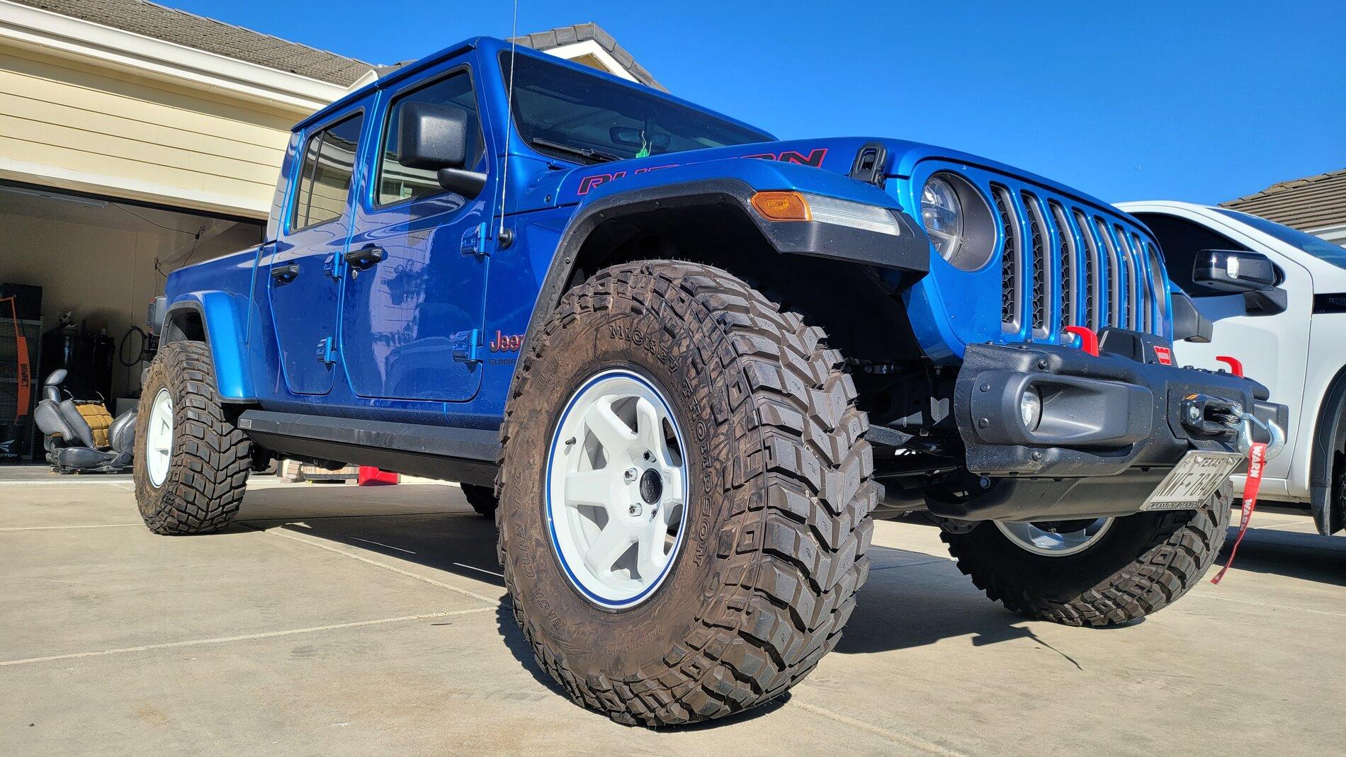

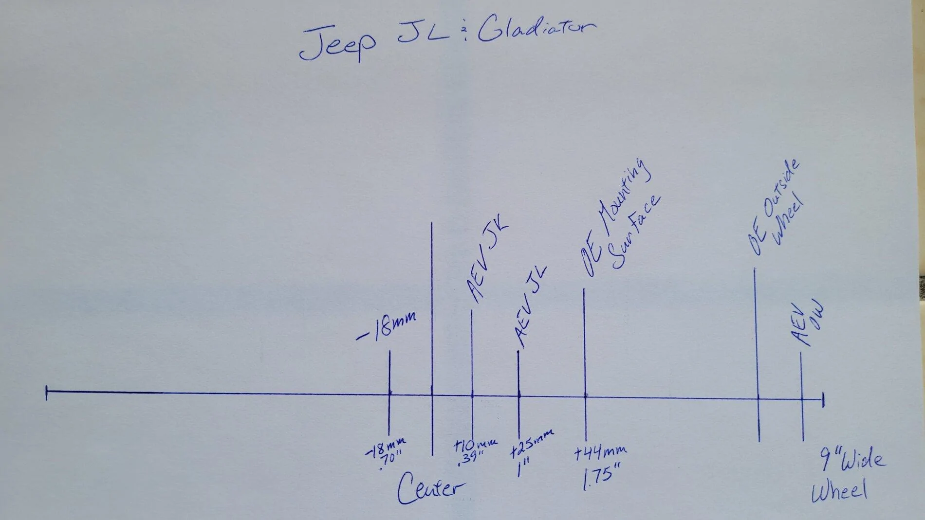

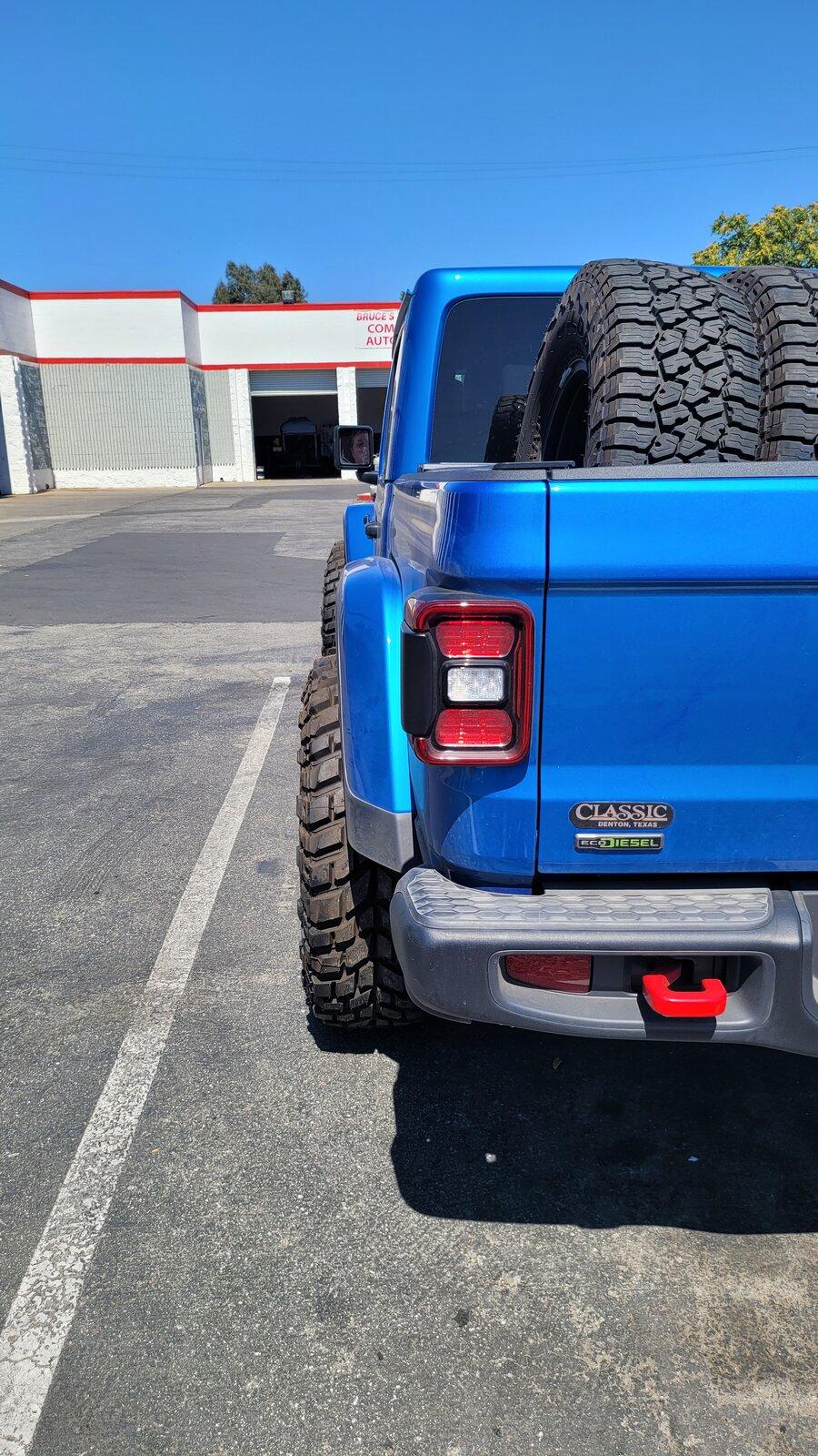

Well I goofed up on the offset IMO. Didn't properly research and realize that the offset was so extreme on the JL/Gladiator platform and tires stick out more than I like. I might swap out to AEV Pintler down the road powder coated white. As far as the white wall wheels I am absolutely in love with how that came out and looks. Now just gotta find someone to install the Icon Stage 6 lift. But no rubbing in normal driving conditions though I'm sure if we took it to our ranch or Hollister Hills they would rip into the fenders. For the record -18 comes out to +2.25" outward not including the added width of the wheel.
I also made and attached an offset chart I made up after realizing my error and lack of research before I ordered wheels for our 392.

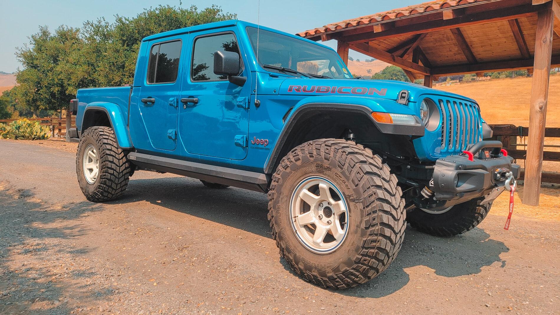

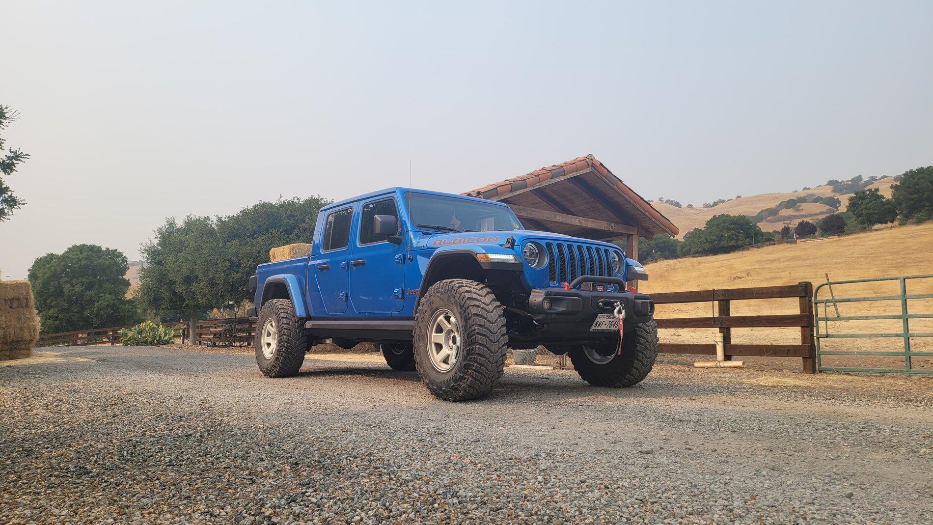

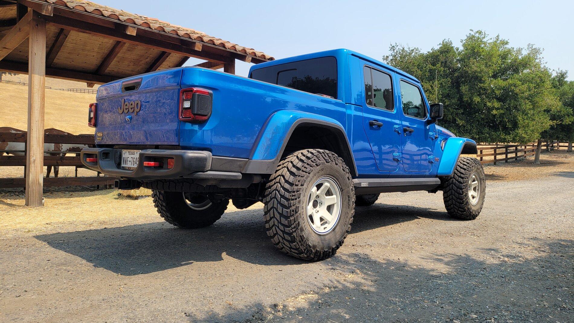

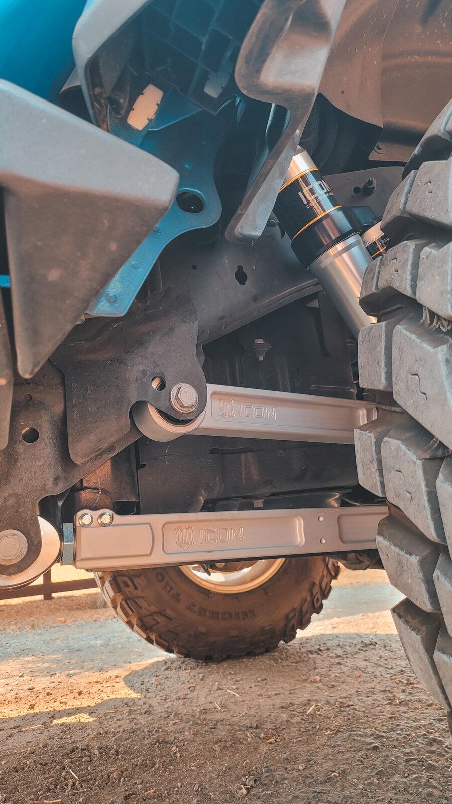

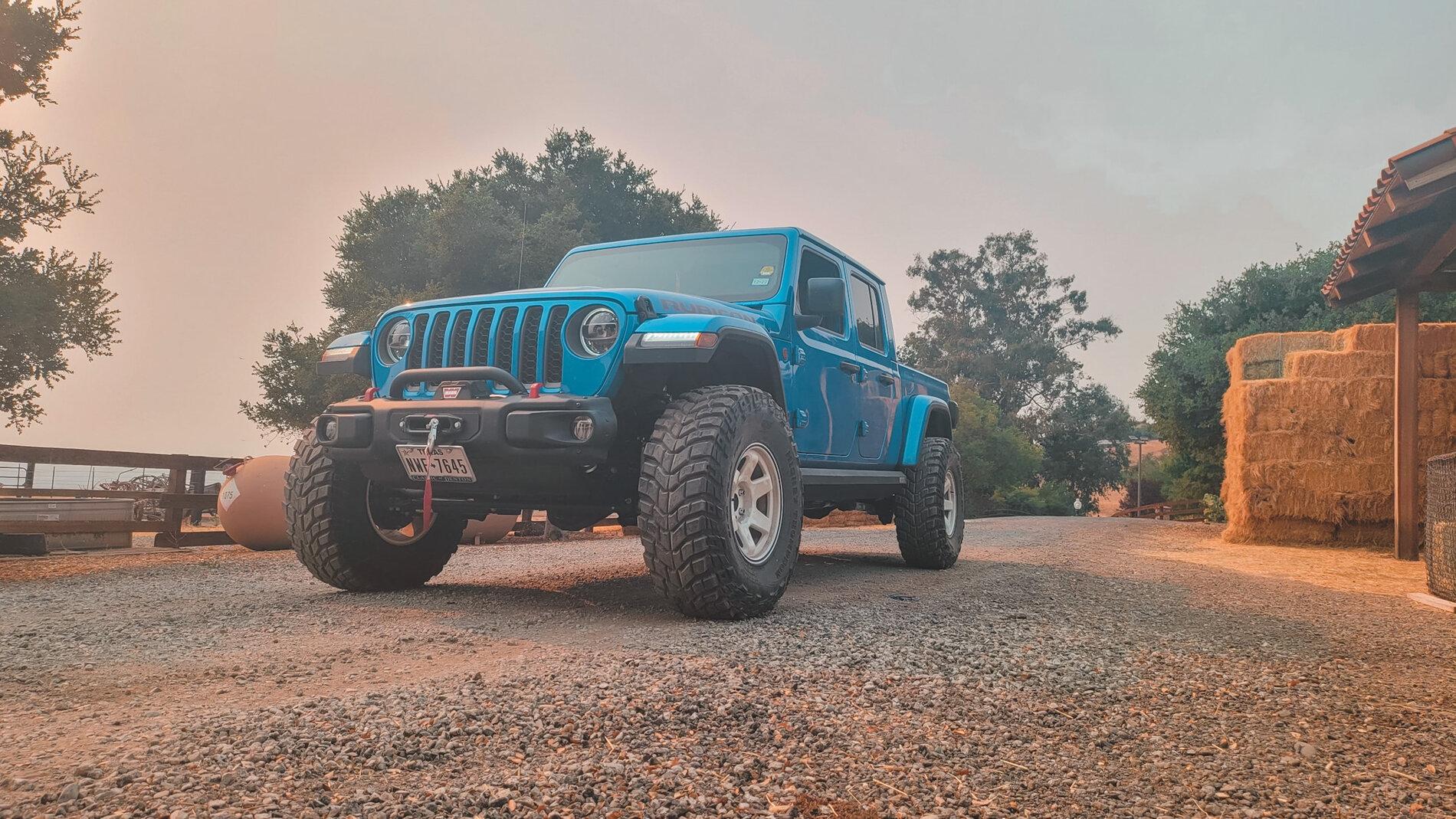

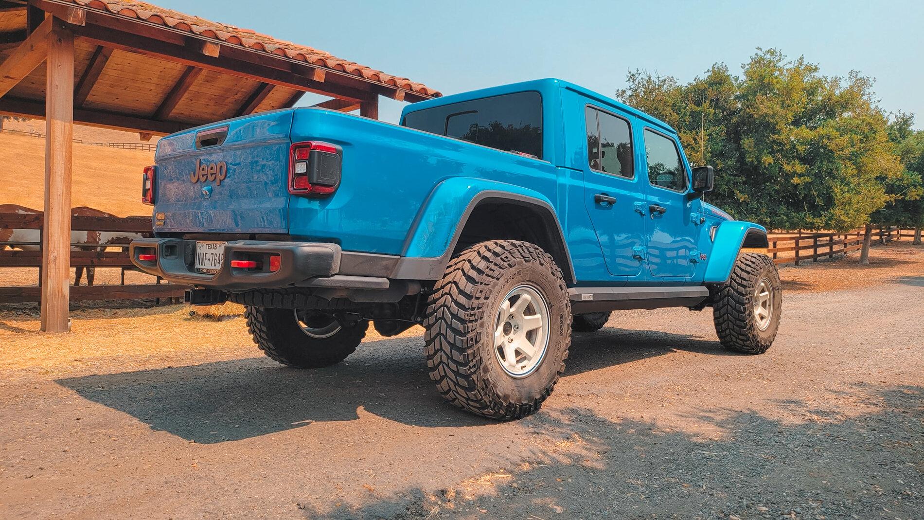

Well thanks to Arabia's Overkill for installing the Icon Stage 7 system on our Glad. As always am absolutely impressed as hell with the system that Icon has engineered for the Gladiator/JL platform.
This thing rides like a Cadillac now on the road. Haven't had it through the curves yet or off road but on road this is hands down these are the best systems made imo. Soaks up the biggest pot holes and speed bumps like they aren't even there. Also completely settled down the feedback we were getting through the steering wheel from the Mickey Thompson Baja Claws. Worse than normal due to the tire shop that mounted them not being able to properly balance them and just throwing in bags. Have an appointment to get the bags removed and them properly balanced next week.
Look forward to giving more feed back after some trips to the ranch for deer season or maybe to Hollister Hills if I get a chance to break away and run down there.

Oh and I've experienced little to no drop off in performance what so ever as far as the 37"s. These things are so much more fun with the EcoDiesel torque. Not a 392 by any means but actually gets with it unlike the base V6 gasser we have been stuck with forever.

Nice looking rig. What caught my attention is the Icon lift. I recall as they told me that none of their lifts were diesel specific? Also gonna be a long ass run to Hollister Hills from Central Texas. It was my backyard literally down the road up until I moved out of town.
