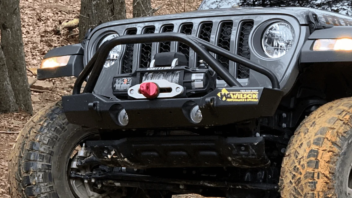

The general answer is, yes, a JK bumper will work. You may have to drill out a couple of the holes on your JT frame, but most bumpers will fit. You might also come across some which are deeper than the JK frame-to-grill clearance will allow. As far as the fog lights go, you can reuse your JT wiring harness, but you have to remove it from the stock bumper. Here's mine:
whats the name of the bumper?
looks outstanding
