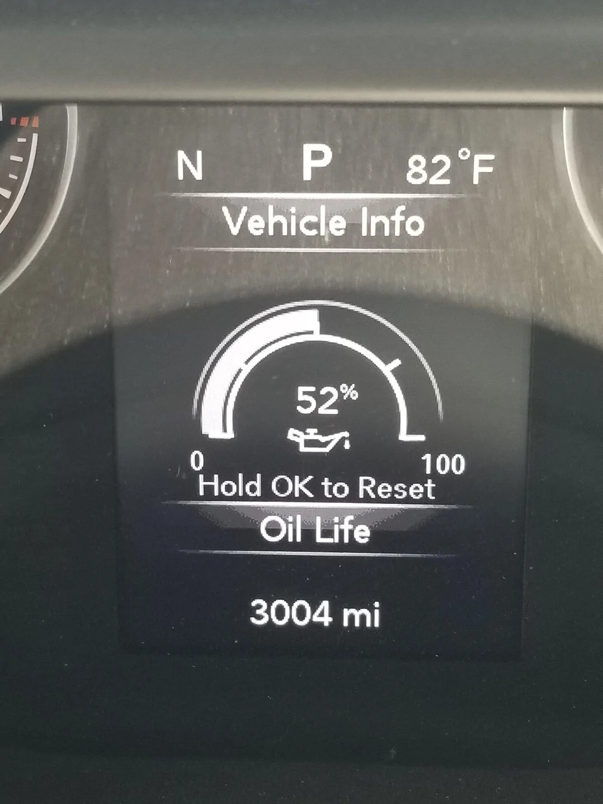

Anyway, sure I'd like get the freebies! My driving habits(short drives to work and towing 1-2 times/month at least) call for frequent oil change. I'm at 3k miles and the minder says 52%. Hopefully I can get a dealer appt for the free oc and tire rotations. My last warranty work appt was around 5 weeks wait.

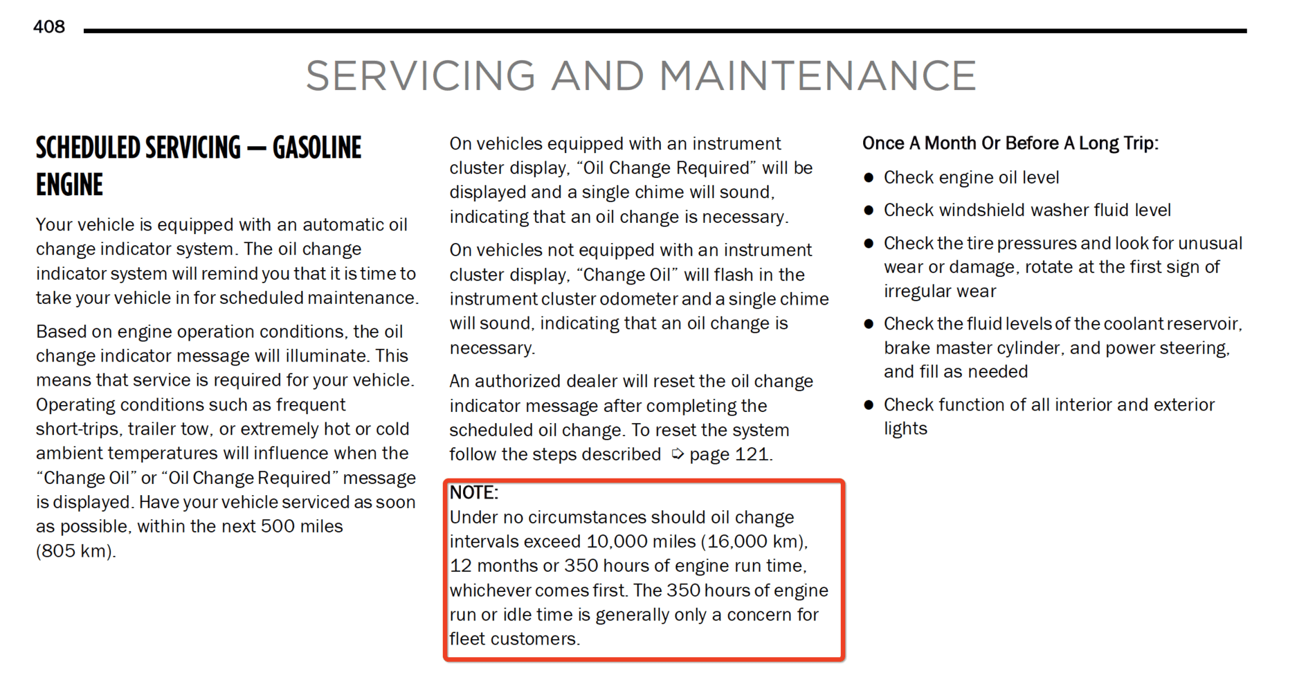

Oil change is not to exceed 10K miles. Ideally to do the first oil change around 4-5K miles.
From the owner's manual:

Damn, gotta change my underwear more often. Otherwise the G brainbox might tell me to do the oil change in 2 years. Hahaha.

Dang that was milage of my first month and half of ownership, 4 oil changes down in 14 months of having mine. 😲 I've got about the rest of this month to decide on getting the extended warranty before I hit the base milage warranty.😣
Now back to the subject, the vehicle computer probably tracks miles, duty cycle, driving habits temperature and start stop cycling. From the oil testing on mine it tracks with the oil life monitor built-in. I'll probably be pulling a sample to get tested on mine again it cost about $30 but it's interesting to monitor and see if anything changes, I've been getting it tested at about half way point of oil life by "OLM"
I typically drive to push for best MPG AKA" driving Ms. Dasiy" but if you drive over hundred miles to commute to and from work you might do that too.
