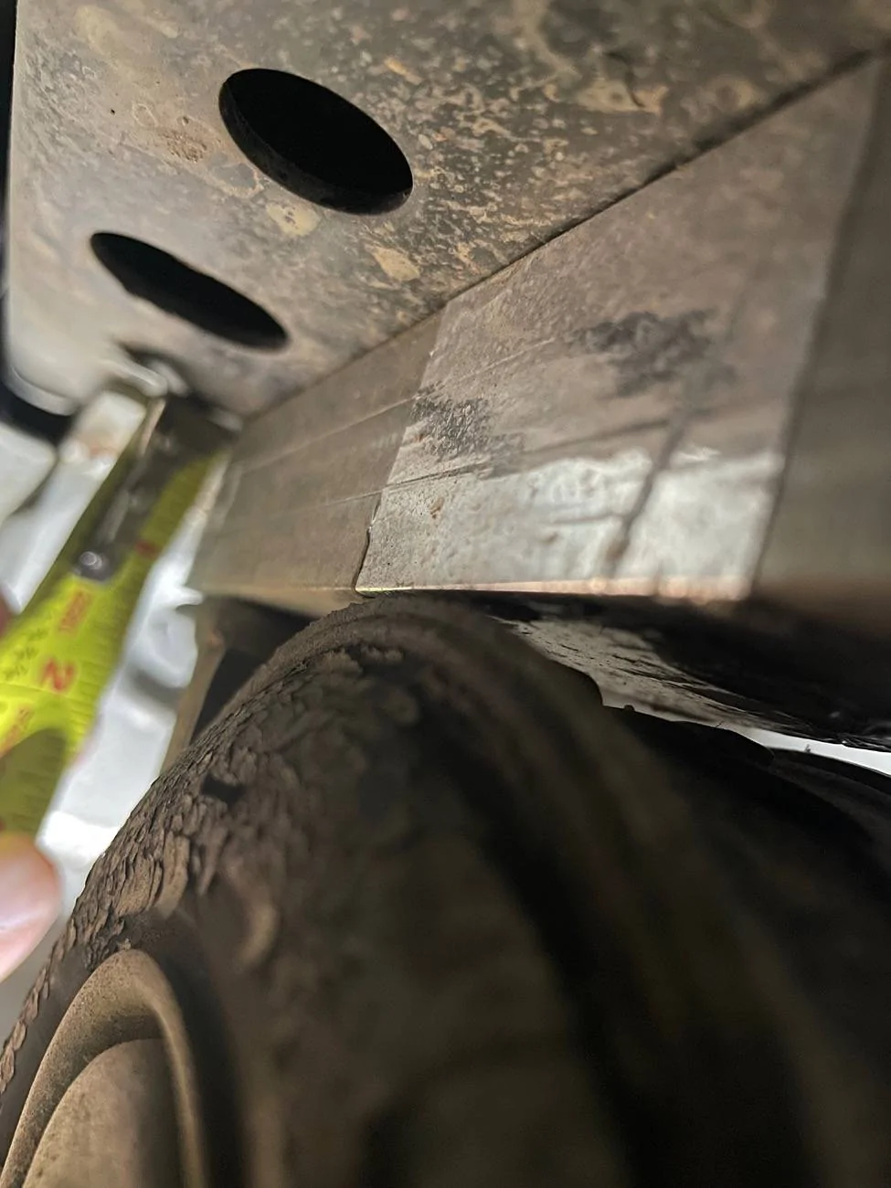

I have the AEV full suspension upgrade with about a 3” lift. I went this route because everything was designed to go together.
The kit included 3 shims which amounted to about 1, 1/8” total
