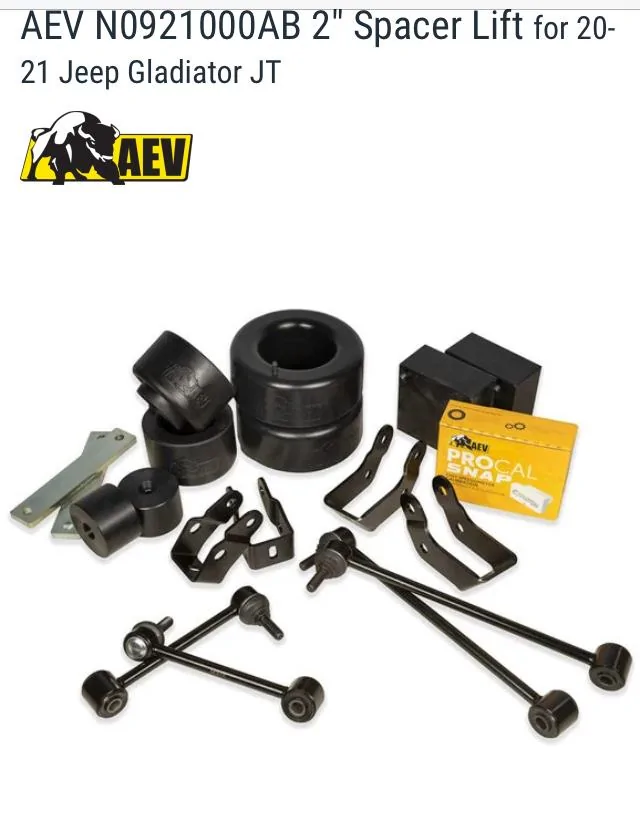

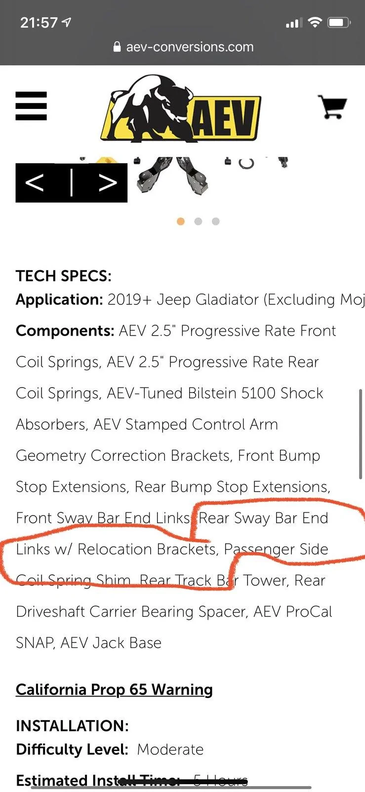

i was looking at the aev lift and it says it includes “sway bar links and relocation brackets”

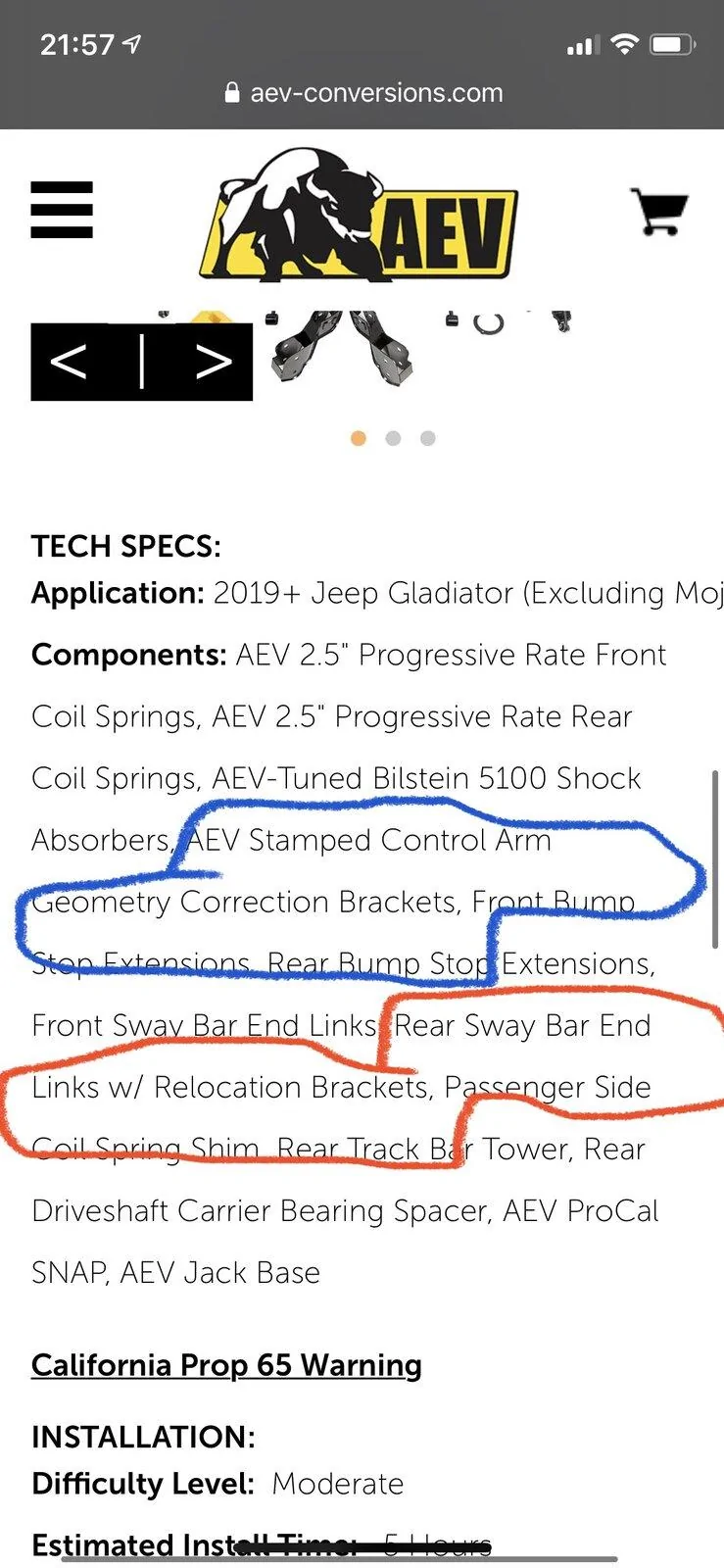

That’s the 2.5. It has front control arm relocation brackets to correct geometry.

so, there are relocation brackets for the rear sway bar. Im trying to understand the “why” of including both new sway links as well as sway brackets for the rear. My only guess is that they need to correct sway alignment because they dont recenter the axle and they lift a bit more than 2.5”. But thats pure speculation on my part.
