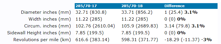

Rubicon is 285/70/17 so your tires are an inch bigger.
178
29,091
34,572
285/75/17 vs 285/70/18 is something like 2 revs per mile different.
No concern. A curving winding road is more difference.

New comparison based on Bobby's statement of tire size (and he is of course right on the 1" diameter, but the thing I look for is difference in revolutions)
Roughly 18 revs per mile difference, I'd not worry over a short term. One can also use the spare on the front and move a front tire back so both rears are the same. It will pull, handle weird, but if you are concerned about the difference on LSD, it's a solution.
Driving mountain roads would likely give you that much difference on switchback roads.
LSDs usually "engage" or grip based on a larger speed or torque difference between axles. A slow difference of 18 revs/mile isn't horrible.

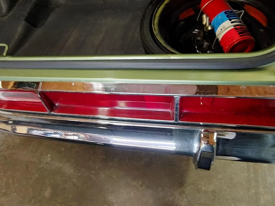

Old language: Most people have forgotten what used to be called a donut...the spare that was way smaller than your regular tires until they came up with the useless canister of gunk solution to get rid of spares. Many of those cars had limited slip.
Use the “donut” tire rule at of course your own risk….If the spare is smaller, due to difference in rotation speed, it should not be used more than 50 mph and not farther than is necessary to get a full size replacement (no more than 50 miles). Keep it in 2wd
178
29,091
34,572
Old language: donut tire. Many car spares are smaller size or used to be until they came up with the useless canister of gunk solution. Most of those cars had limited slip.
I wouldn't say most had limited slip. That was an option and not often ordered. It wasn't standard. I've had a number of those cars......... and still own two of them (4 if you count one I'm parting and one I'm trying to give away)
I'd actually bet less than 25% had LSD
In fact, there are those who track numbers and a Pontiac forum says less than 20% in 65, so it's doubtful there were even 25% sold with it in the mid 70s. You might hit 20-25% in the 80s but I strongly doubt it. No 1980s car I owned had it.
A quote from Pontiac people:
19.2 % if you are asking about 1965. Limited slip were under very few cars.
And they were talking about performance cars - the GTO, etc.
One of mine ->
