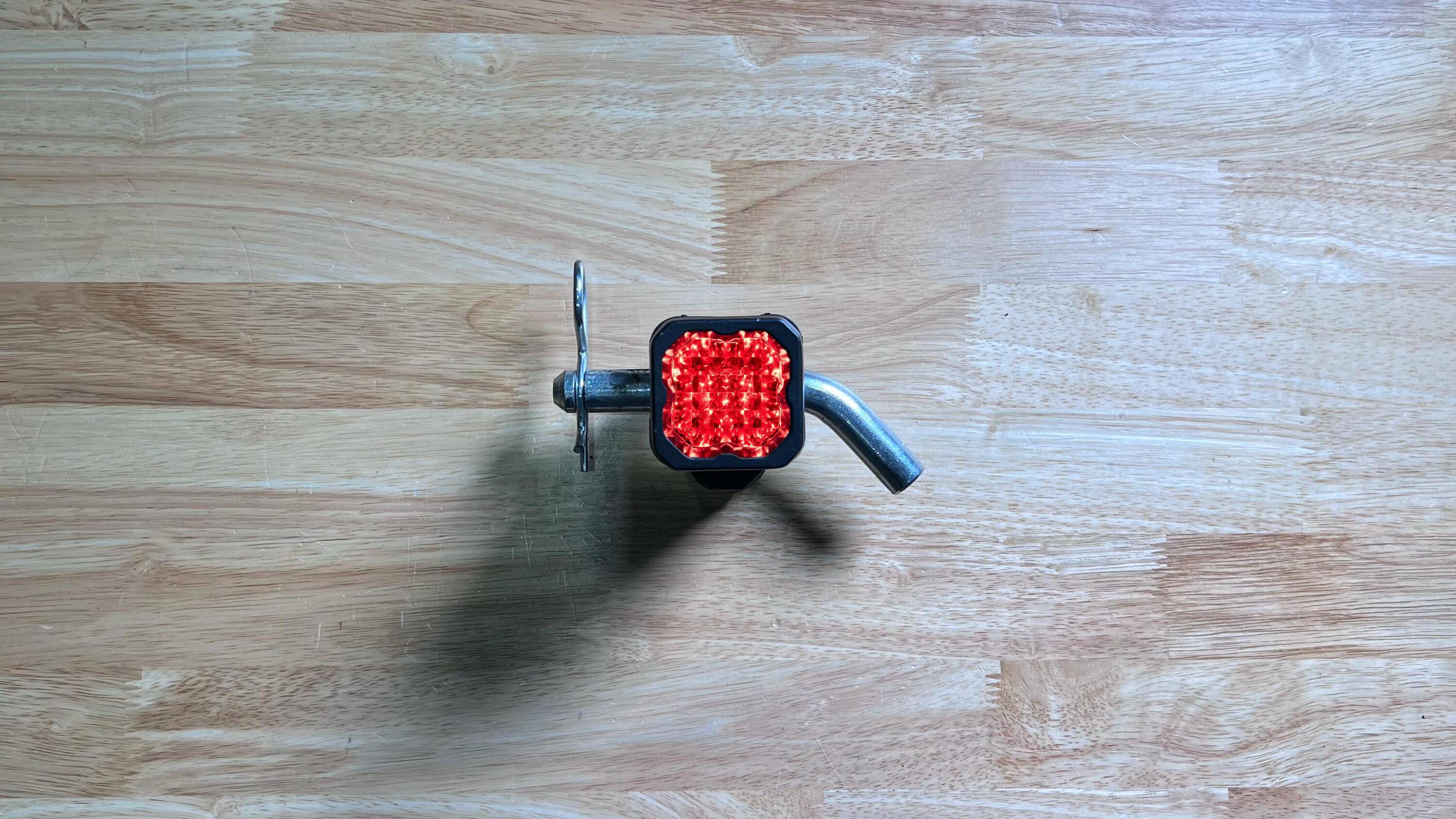

If you're concerned about theft of your HitchMount LED Pod, then this simple modification can be performed in just a couple of minutes to save your investment!​

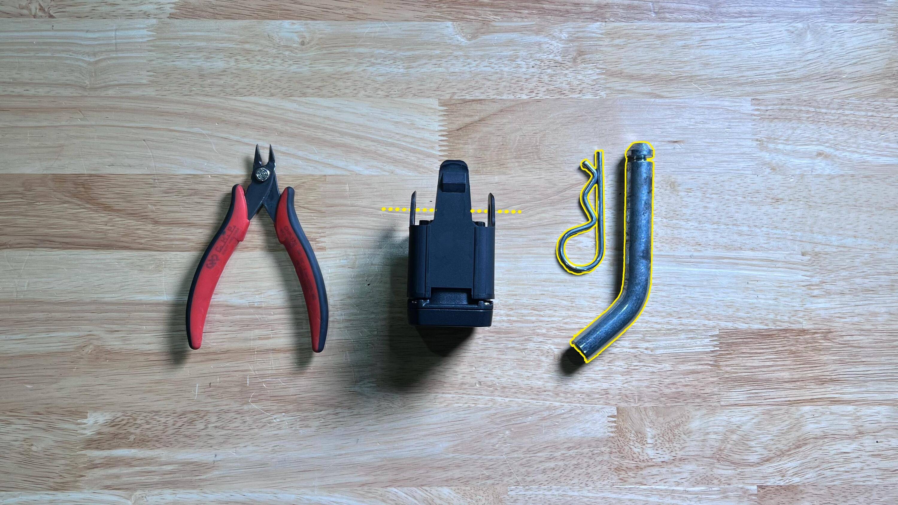

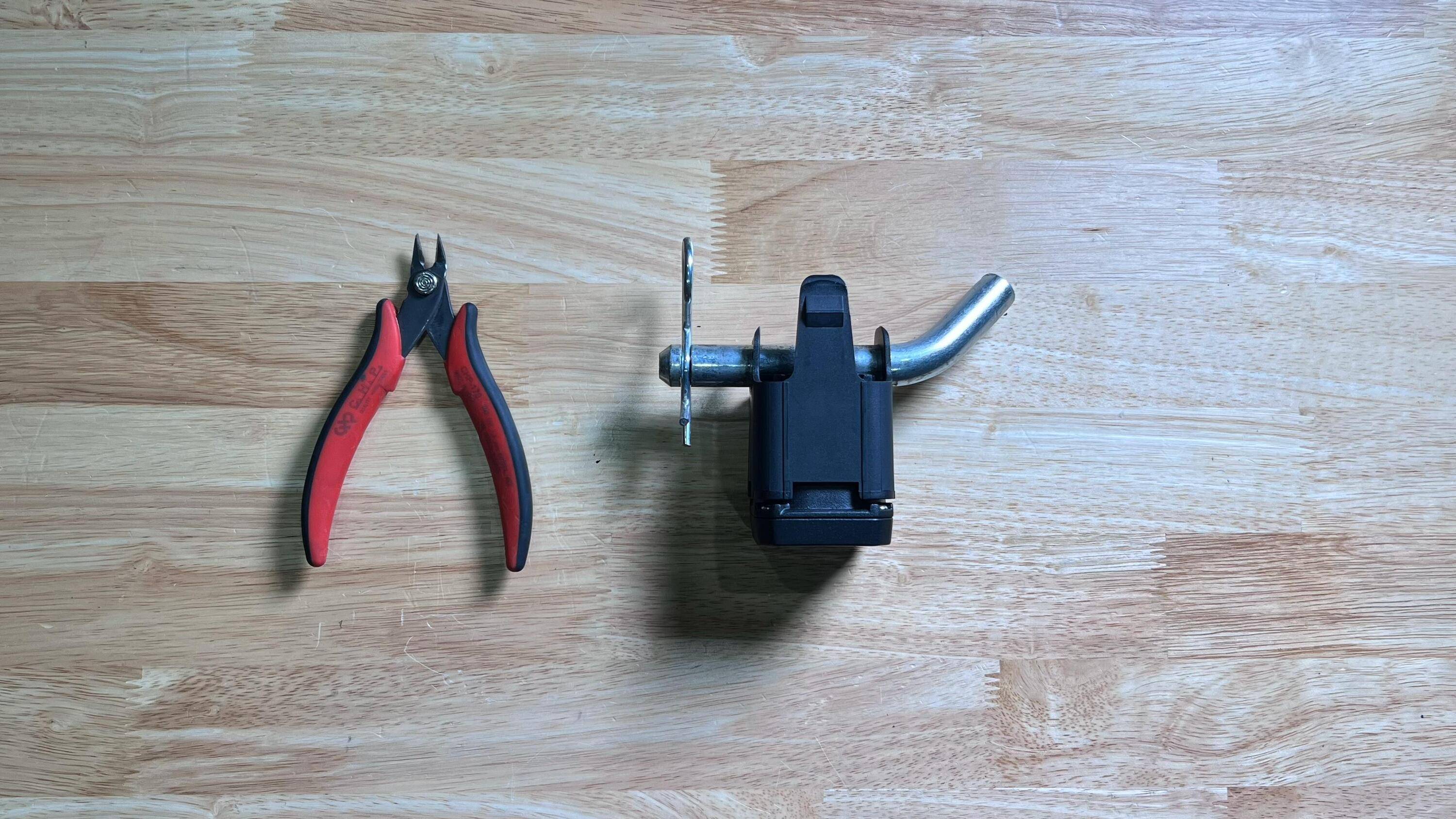

Requirements:
C1/C1R HitchMount LED Pod
Cutting Pliers
Locking Pin
Jeep Gladiator How-To: HitchMount LED Pod Trailer Pin Modification | Diode Dynamics ybUnwRw
Cutting Pliers | HitchMount LED Pod | Locking Pin
Jeep Gladiator How-To: HitchMount LED Pod Trailer Pin Modification | Diode Dynamics VtSDybo

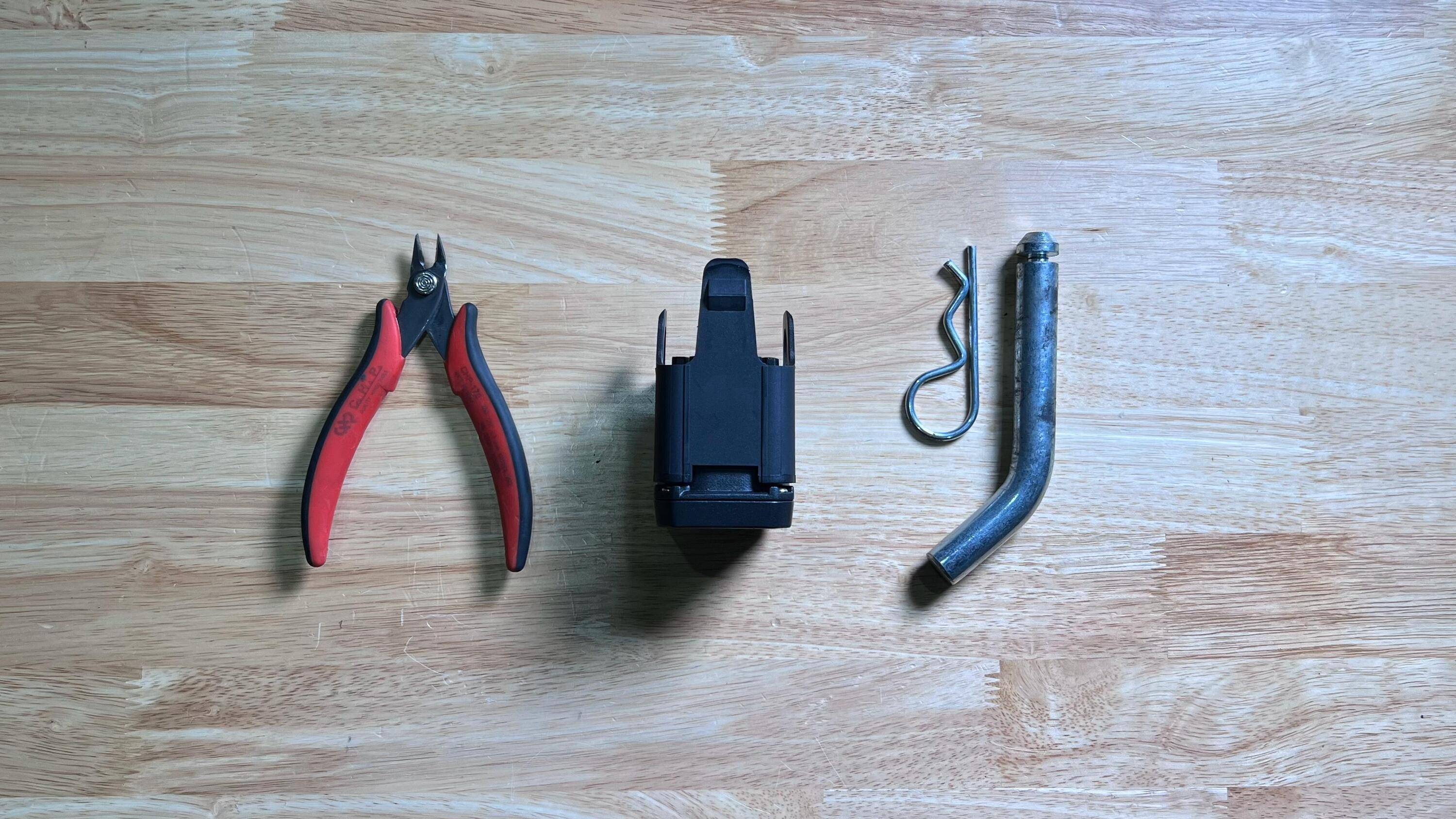

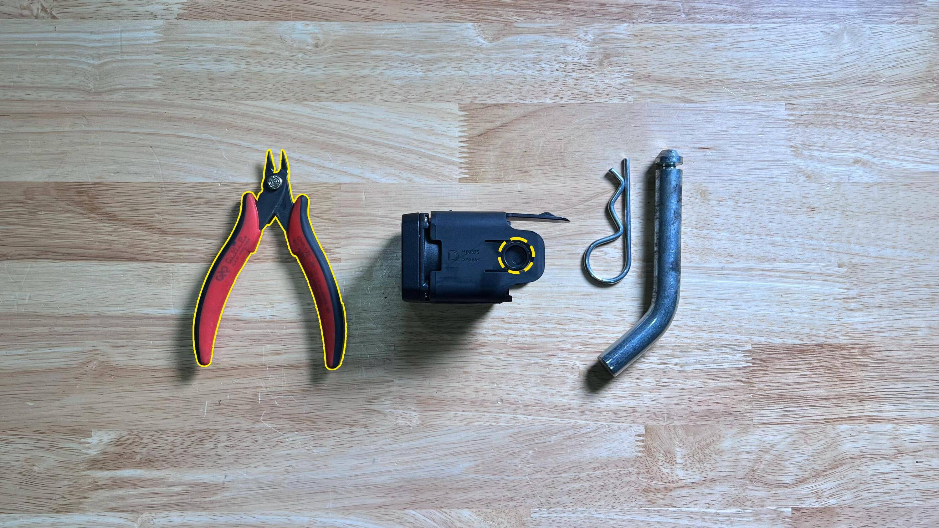

Use the cutting tool of your choice to remove the retention tabs on our snap-fit housing
Jeep Gladiator How-To: HitchMount LED Pod Trailer Pin Modification | Diode Dynamics bFWjipo

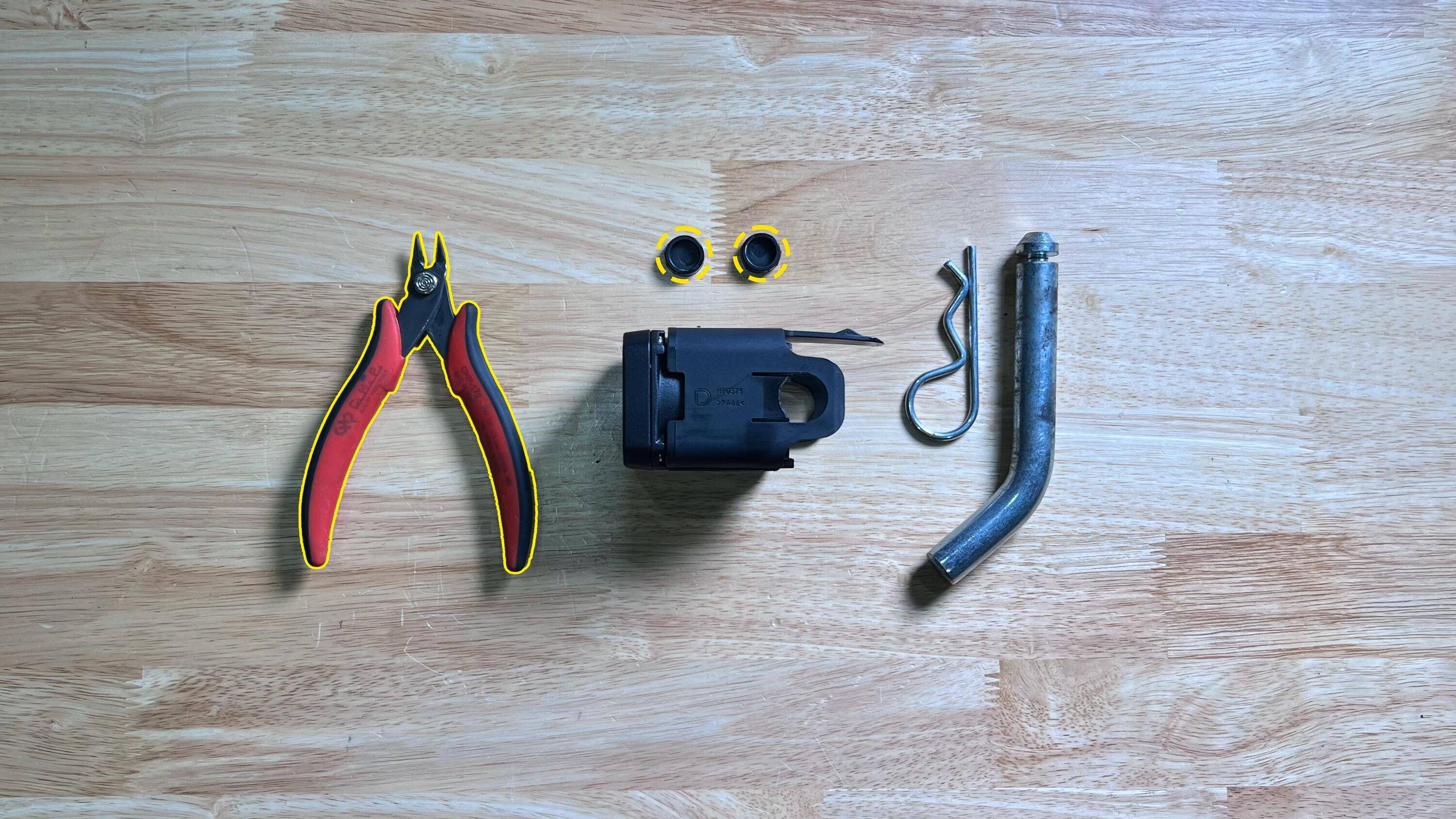

Retention tabs have been cut from both sides of the housing successfully
Jeep Gladiator How-To: HitchMount LED Pod Trailer Pin Modification | Diode Dynamics P9c4b77
With the snap-fit housing retention tabs removed, you can now prepare your locking pin
Jeep Gladiator How-To: HitchMount LED Pod Trailer Pin Modification | Diode Dynamics g0jbEKU
Your locking pin of choice can now slide through the vehicle receiver and HitchMount housing

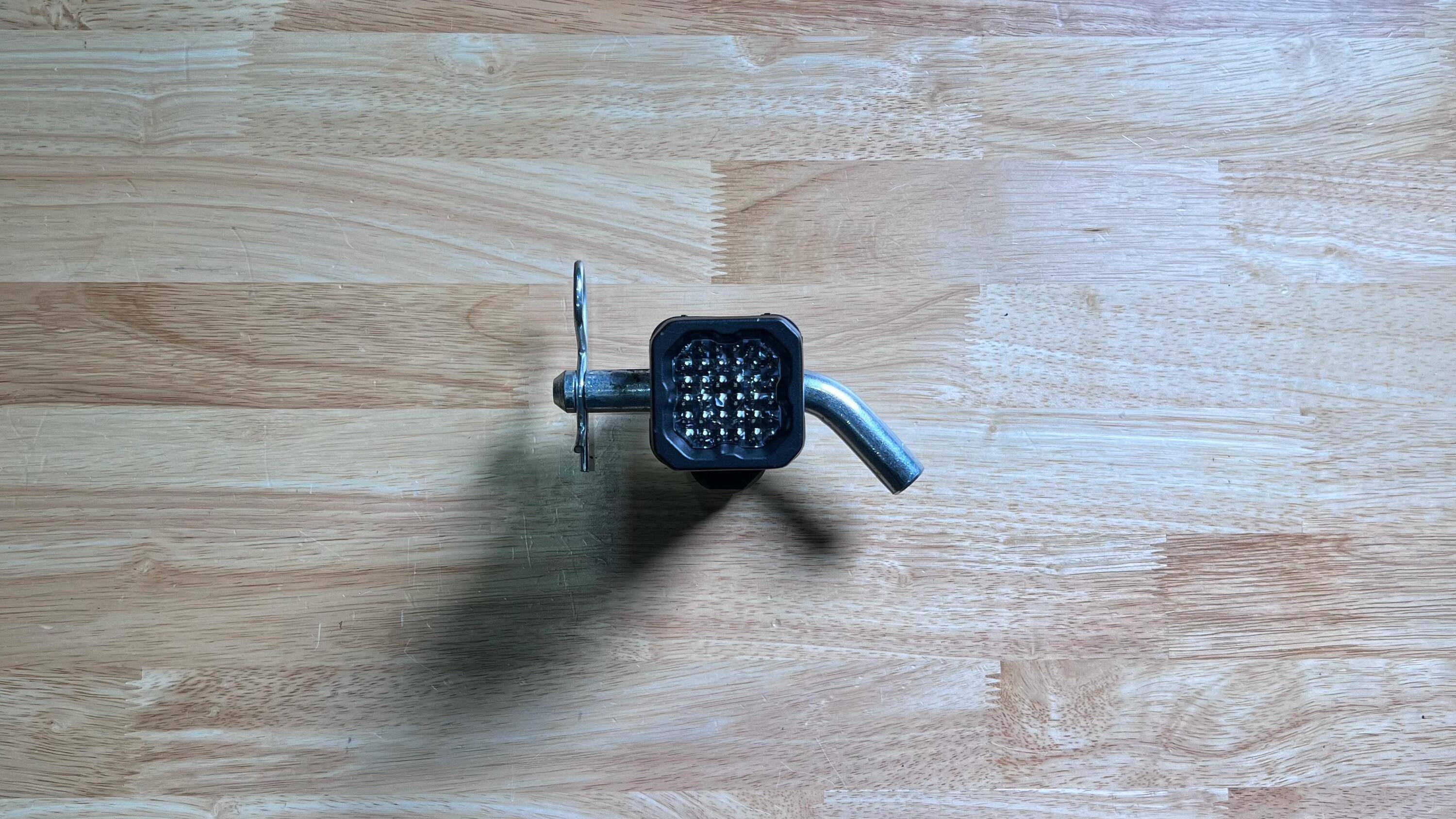

Security has been added to protect your HitchMount LED pod

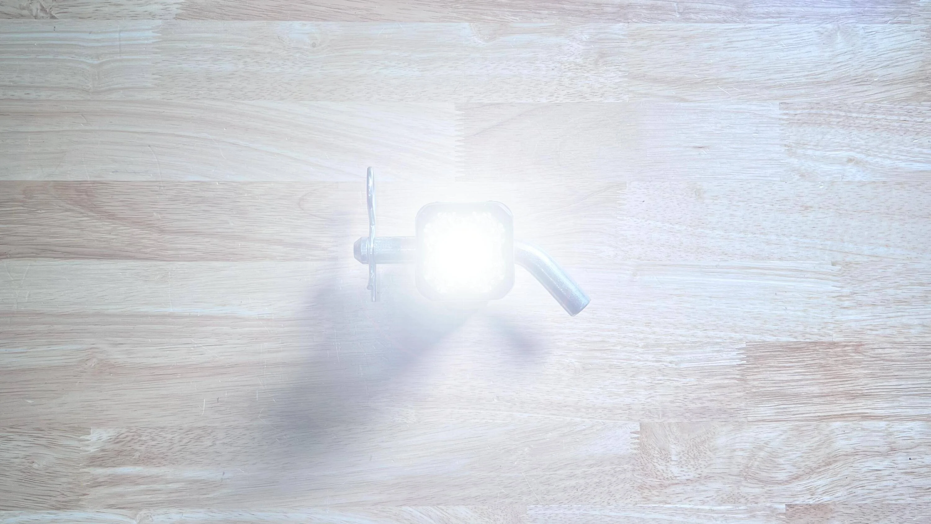

High Power White Reverse Light included with C1/C1 HitchMount LED Pod
