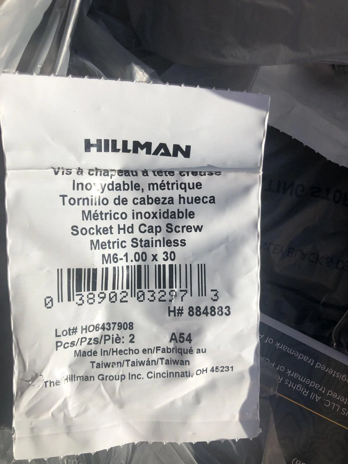

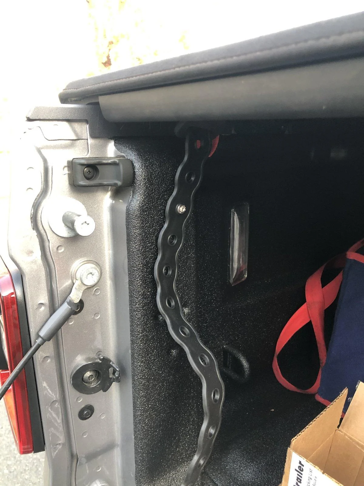

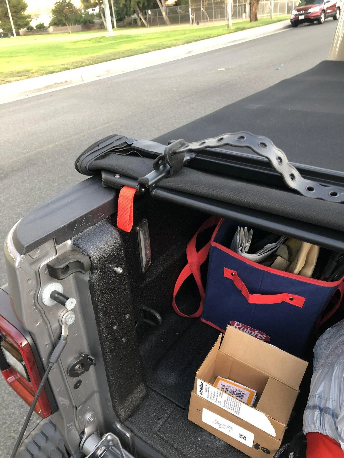

How to lock your Jeep Gladiator soft tonneau cover for under $15:
Things you’ll need: two M6x30 bolts and one 2-pack of bike-rack straps.
ETrailers has the straps for about $10 plus shipping. See link: https://www.etrailer.com/p-SR26543.html
Lowe’s/Home Depot has the bolts (see pic).
Put the bolts in the existing holes in the sides of the bed (see pic)
Loop the straps around the tonneau cover frame and through themselves.
When you close the cover, hook the straps over the bolts. Done. You can stretch them a little to get an extremely tight ‘lock’ or use the next hole down and it still holds but has a little wiggle.
If you want, you can cut the extra length of the strap off too.

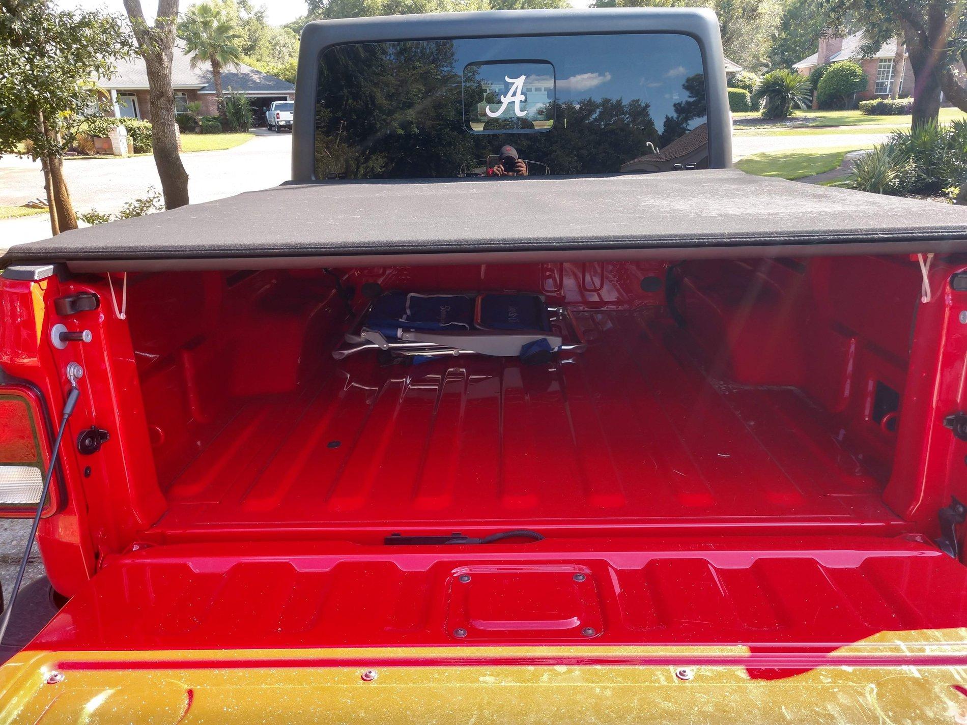

Great idea! These buckles work pretty well too. $1.98 each on the camping section in wal-mart.

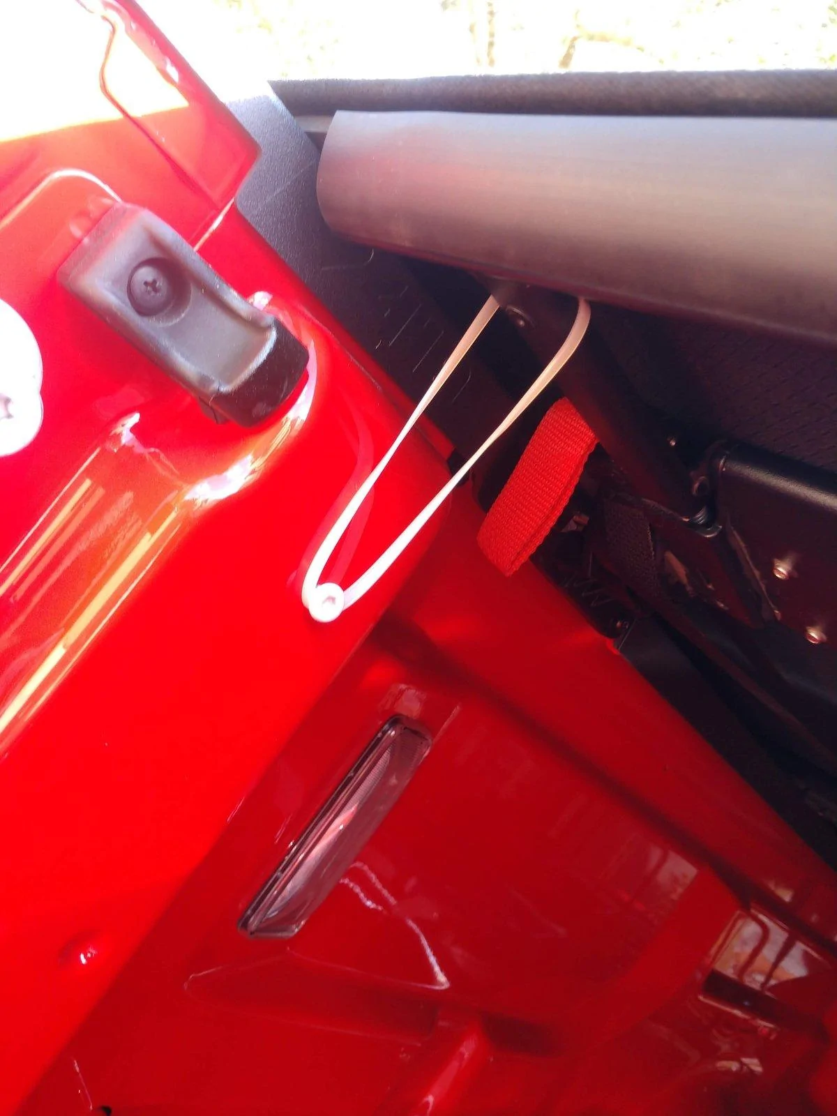

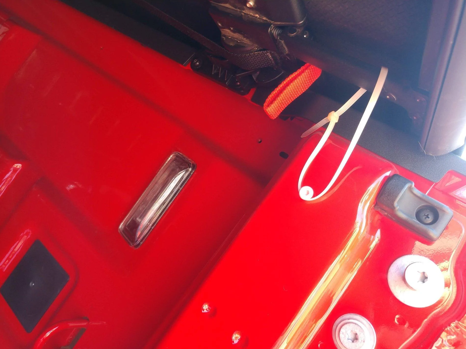

My free solution. Rando bolts from the garage and zip ties!

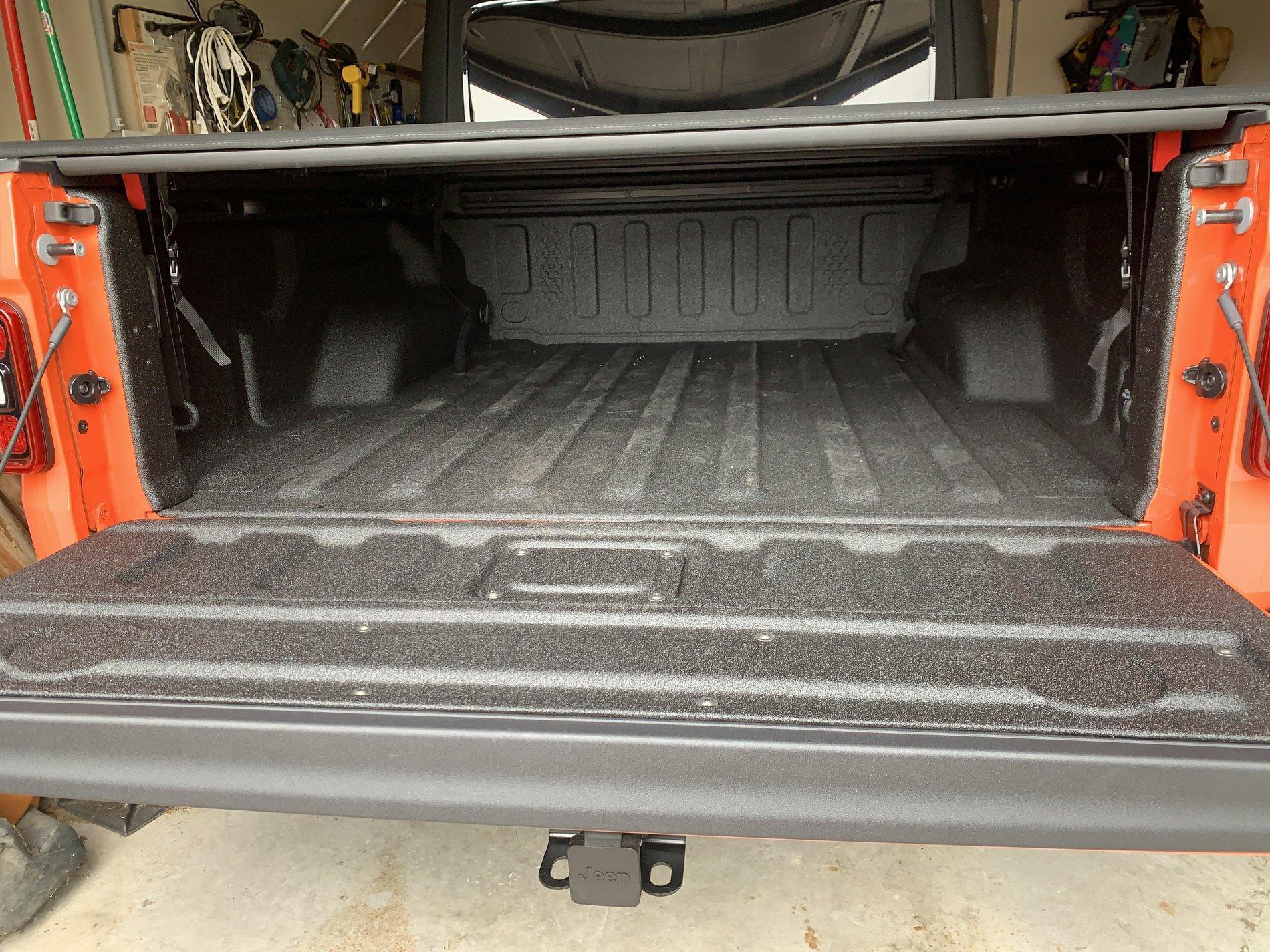

Question...the hole that you show here on my Jeep is almost fully covered with bed liner. Any ideas on how to clean this out so I can get a bolt in there?

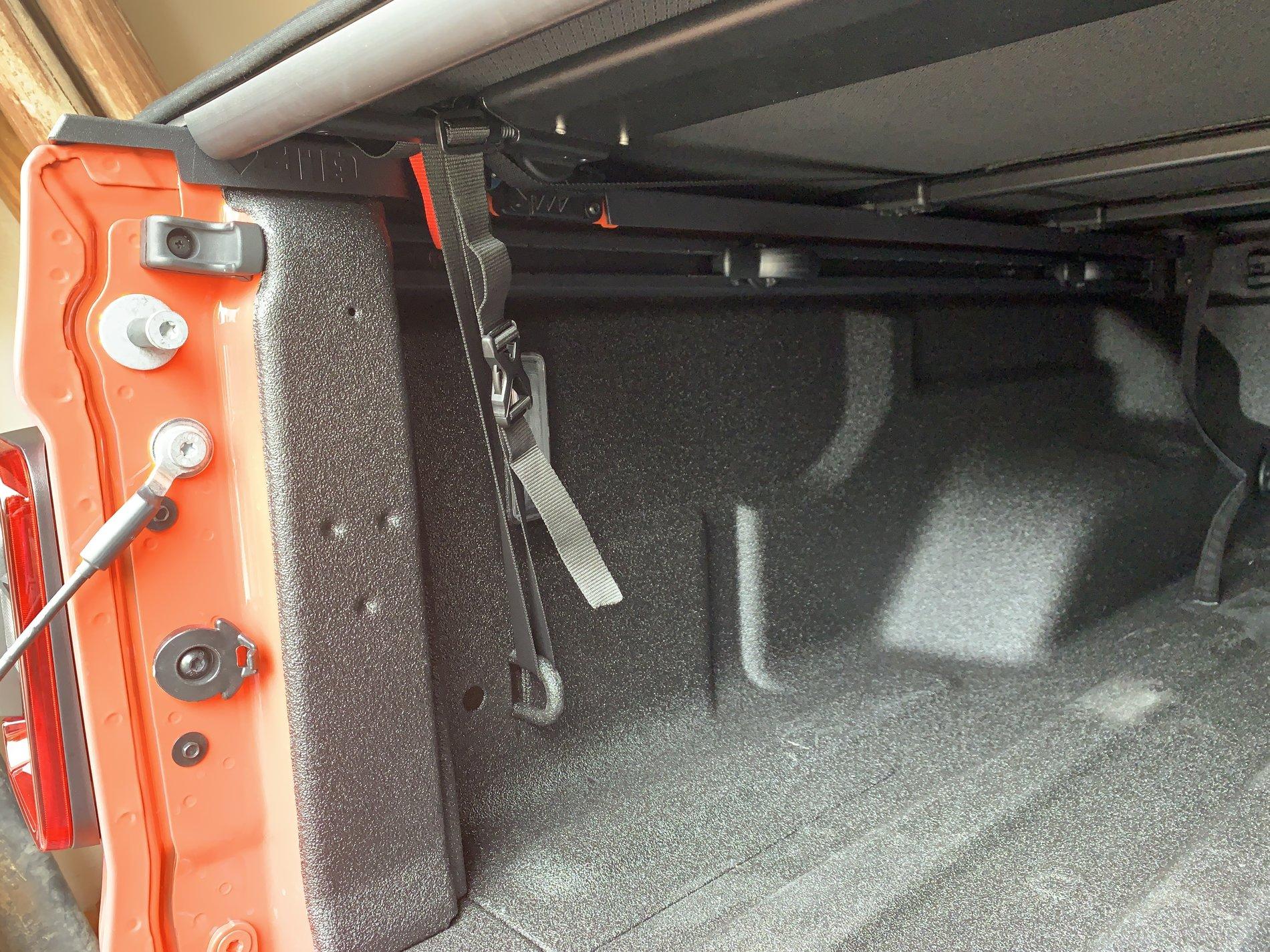

i have seen some people use a tap to add threads to the hole. I would thing you could drill and tap. or maybe just use a self tapping machine screw of appropriate size
i cut the bedliner away with my pocket knife. A small pointed blade will do. I did find the 6mm bolts noted above did not really fit. They were too loose to be a decent anchor point.i tried a 1/4” and had no luck.
I just went with a strap to the anchor loop near the floor of the bed.
