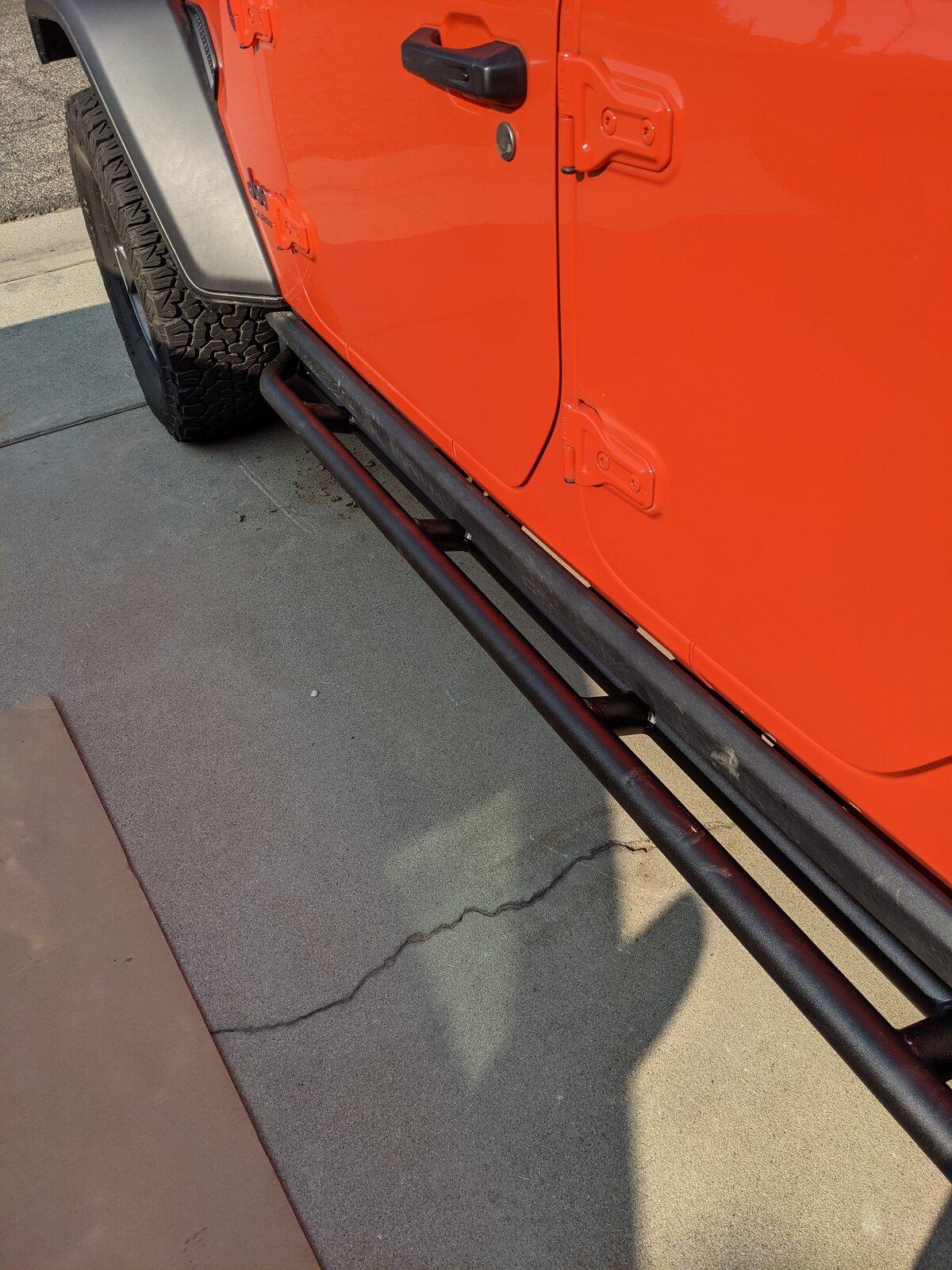

Curvature:

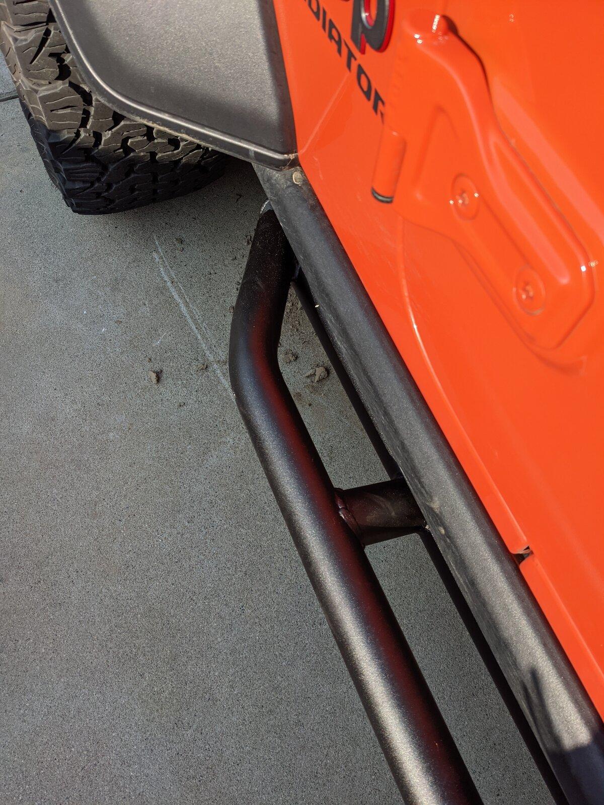

Step space:

The curvature of the factory rails to give a bit of a waist to the truck are apparent when you look at the straight ACE rails, but it's not an issue for me. My wife noticed immediately and dismissed it. Two big thumbs up from me, and two big thumbs up and a big smile from my wife!

Step space:
