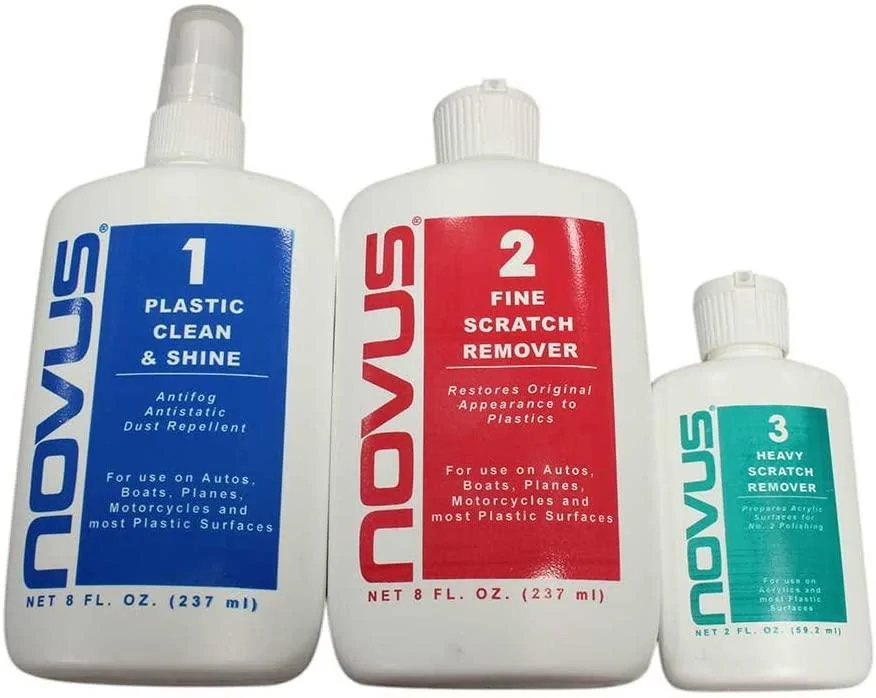

use a light car polish, not a compound but some thing for light work
i also forgot I have sone of this I use on my pinball machine
