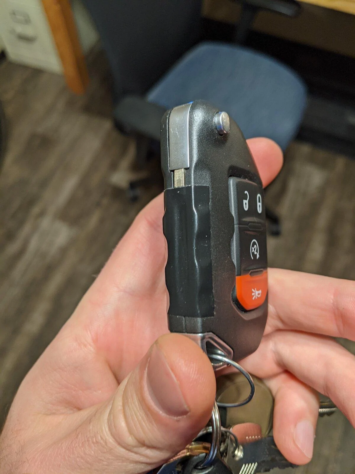

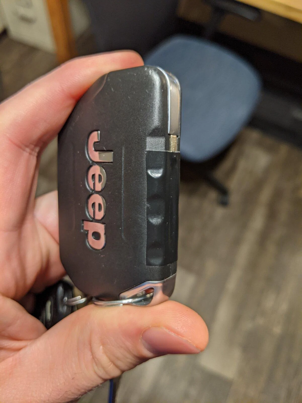

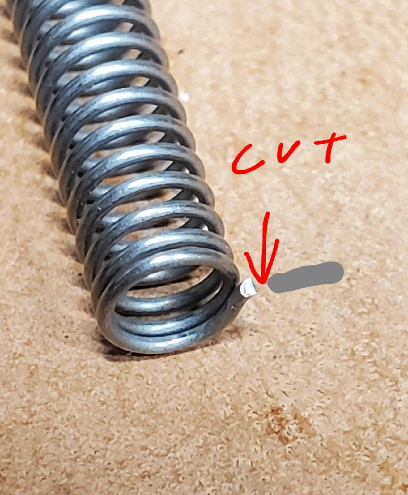

Pop off the back cover on the fob then take out the four little torx screws so you can remove the key and spring assembly. Simply snip off the little "tail" on the spring and reassemble the whole thing.
Now, the key release button will still hold the key in open or close position but will not pop open by itself.
