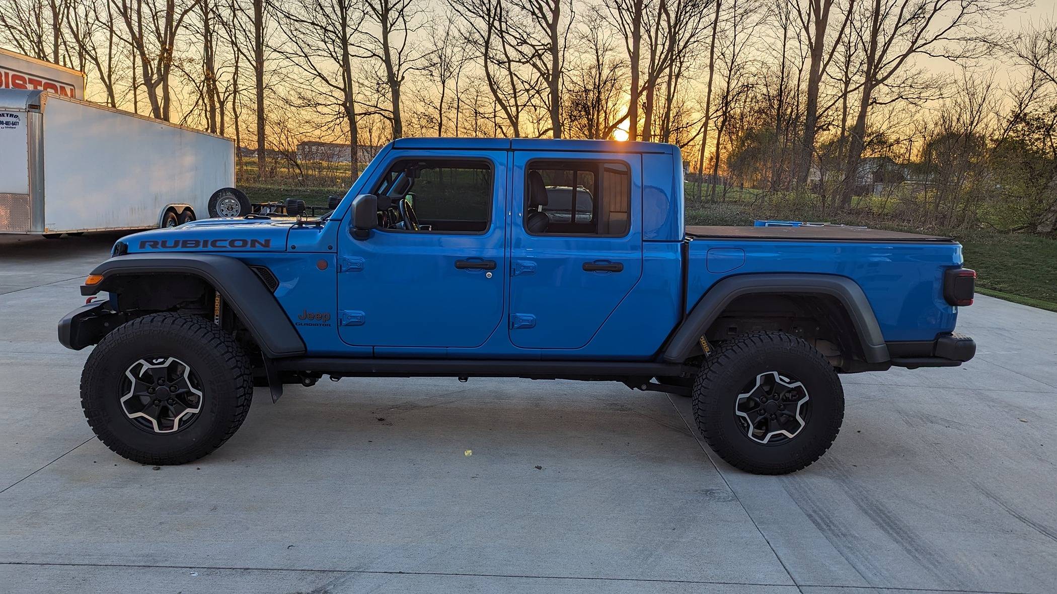

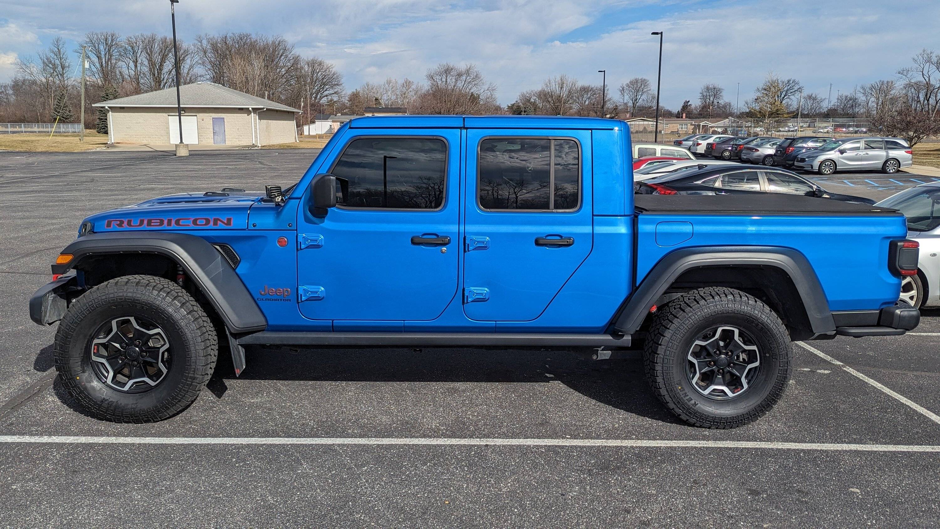

I started my build, but not in the order of things that I had anticipated. I had a flat on one of the stock Wildpeaks and had to throw my 35's on before the lift. It actually looks better than 35's did on my JLUR before it was lifted. The Gladiator has better proportions for the 35's with no lift, in my opinion. Anyway, I initially had them on the JLUR's back-up rims. So I threw it on there, then put the 33's and JT wheels in the bed and took it to @Discount Tire where they swapped it all out and did a fast and good job.
So here it is with the JLUR rims....
Jeep Gladiator Hydro Blue Build has Begun! PXL_20240208_131103103.MP
And then those 35's were swapped over to the Gladiator rims.....
Jeep Gladiator Hydro Blue Build has Begun! PXL_20240208_161918904.MP
I also had them put black lug nuts on it. Finally, I installed the Tazer Mini and calibrated the speedo.
The Tazer is acting strangely, though. The front speakers sound muffled. It comes and goes. But only with the Tazer. So I may have to reach out to Zauto about that. It did clear up but then did it again when I had to adjust the tire size and rebooted.
Next up will be new Auxbeam spot lights on the cowling. I also then will install an Artec FAD skid plate and a hitch skid plate. And when my buddies are free, we will install the AEV Dualsport 2.5" lift that is sitting in my garage.

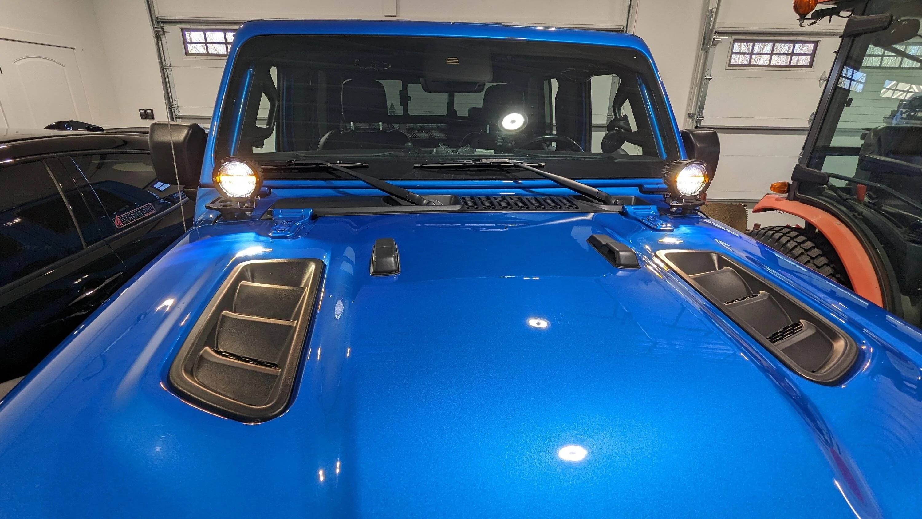

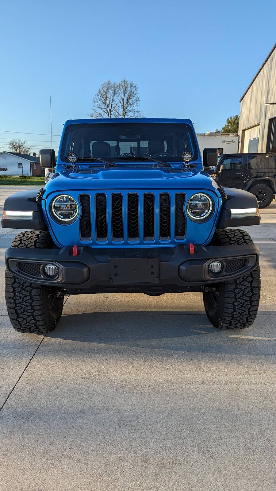

Small thing....Added Auxbeam lights to the A-pillar area. I'm pointing the Auxbeams to the front and sending Rigid D-series cube flood lights back to Rigid to be refurbished. The previous owner installed them, but they both took rocks in the glass and have some water intrusion. Rigid will restore them for free!
So I have brackets that allow for two lights on each side. We'll see if this setup lives up to the hope I have for it.
I'll get a closeup of the mounts soon. They are off Amazon. I have to see it with all 4 lights mounted before I pass judgement. But it has potential for great lighting. Eventually, there will be two Baja Designs LP 6 lights on the front bumper for long-range work. (And turning night to day!) My JL has them and they are just incredible.

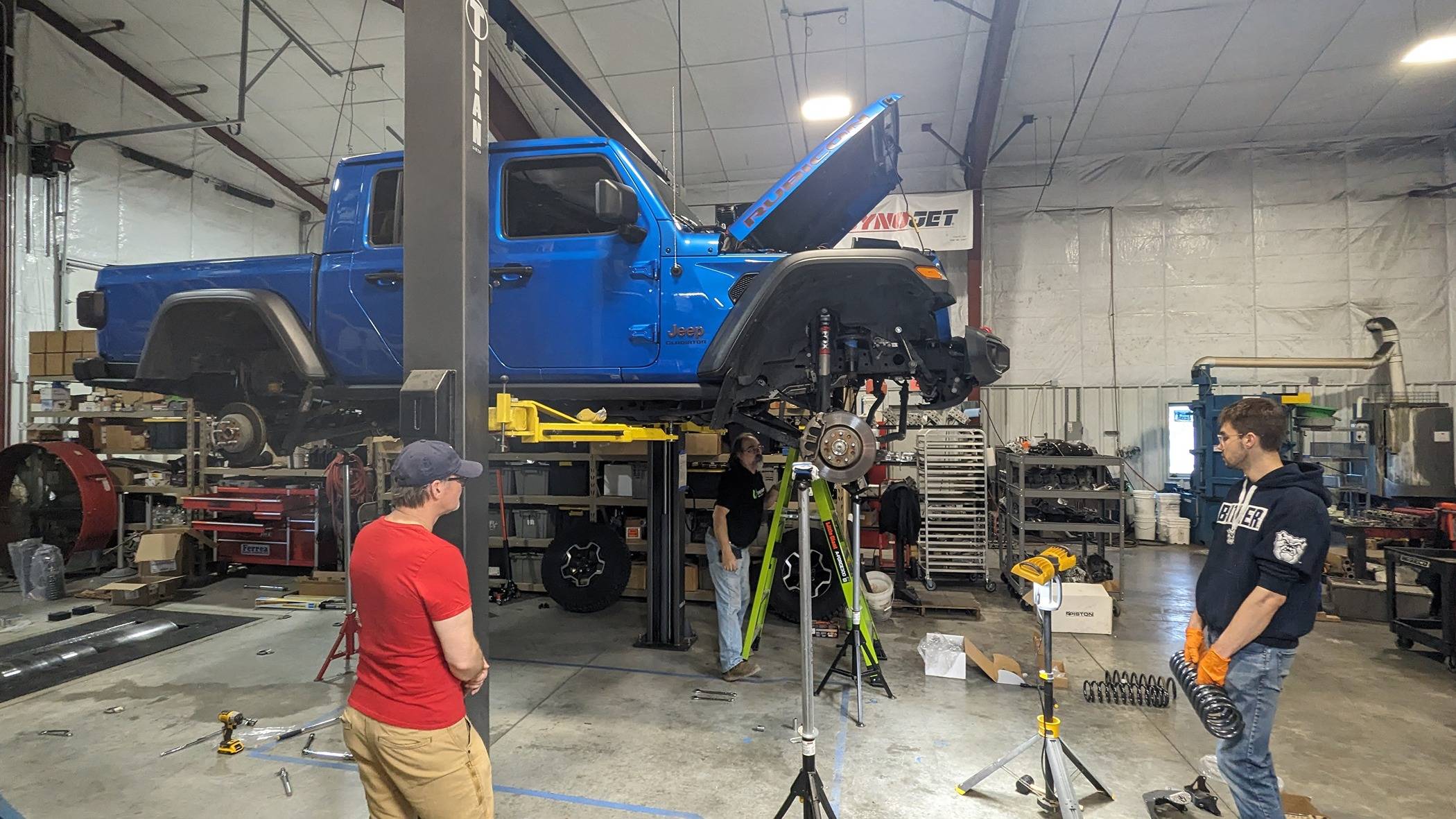

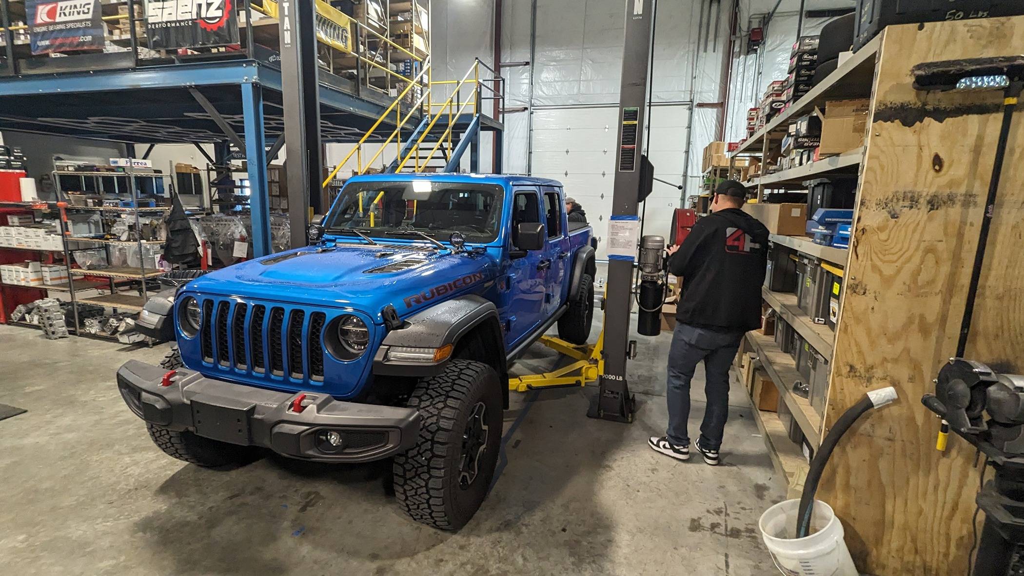

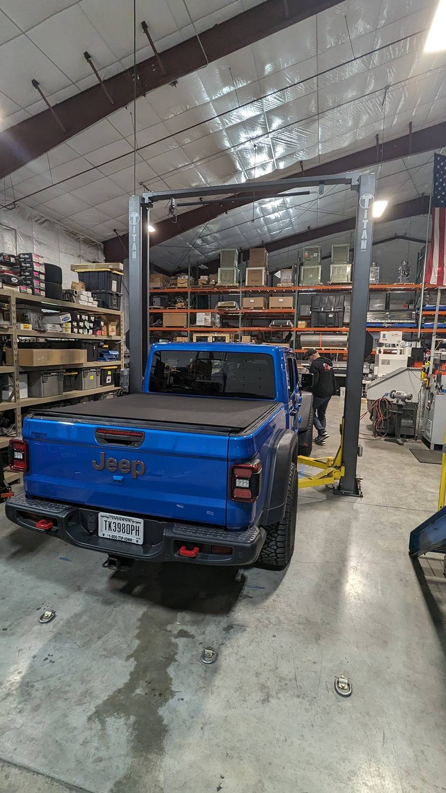

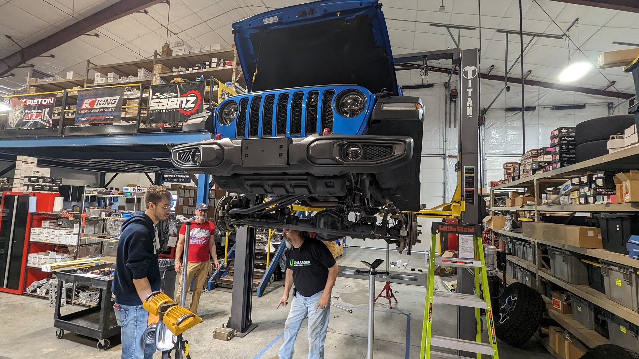

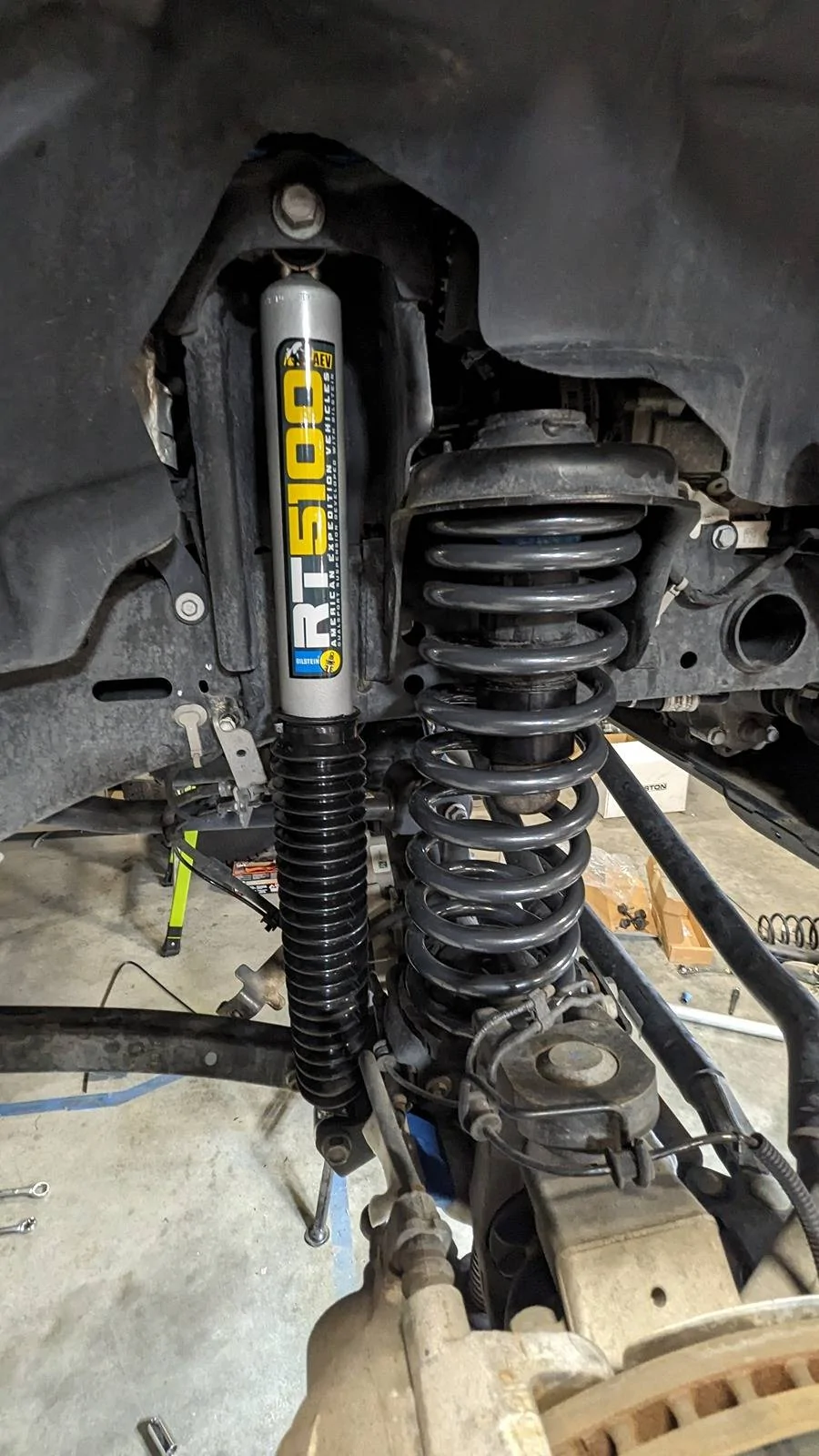

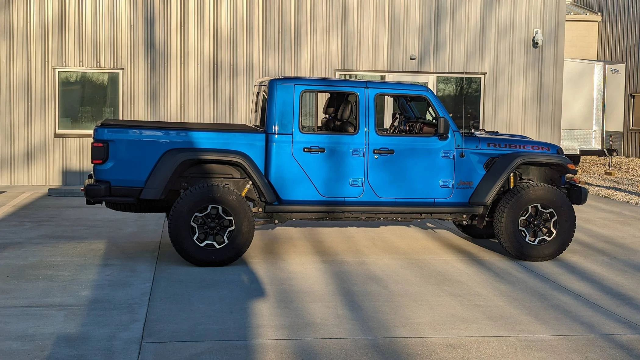

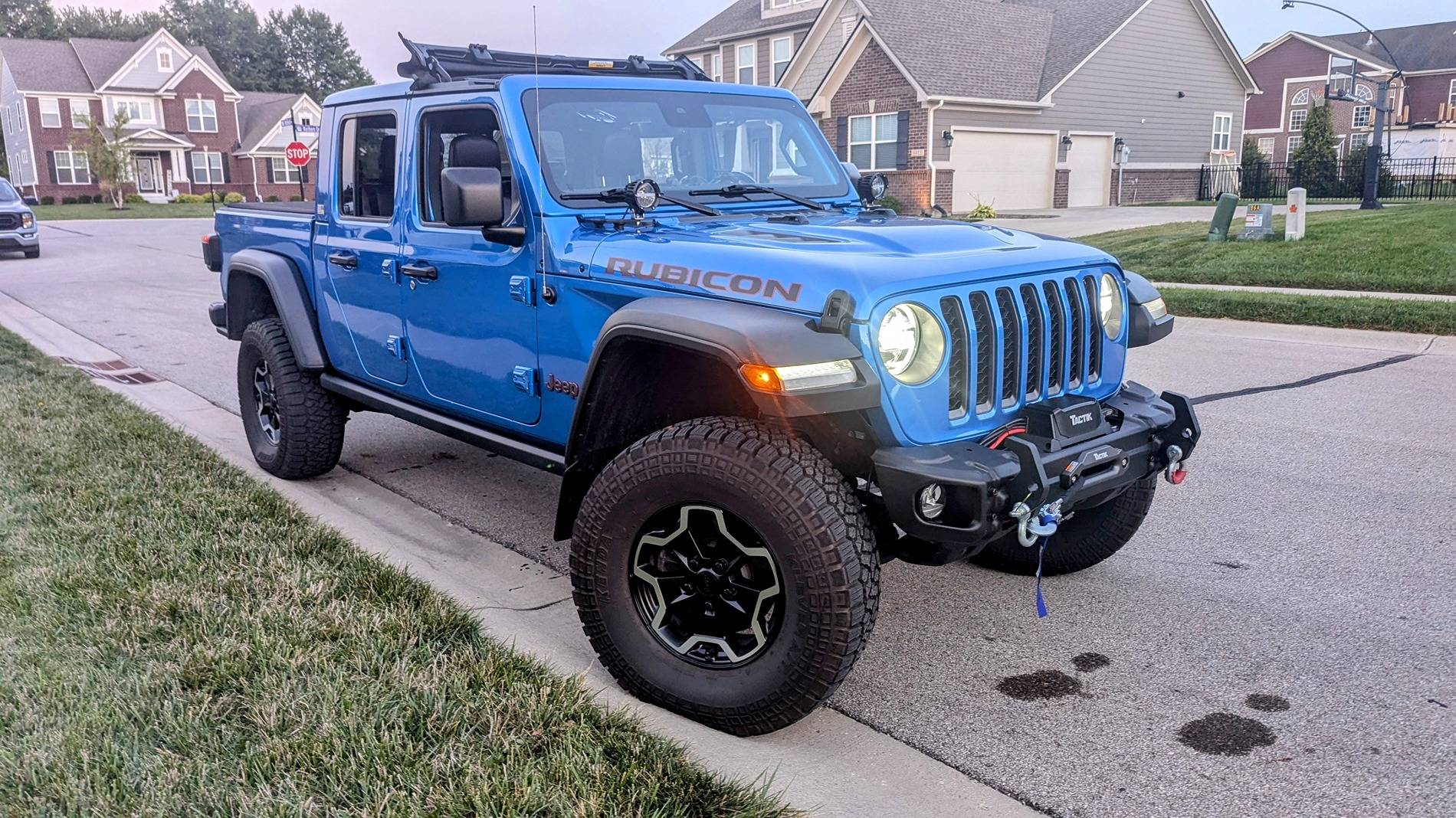

Installed the AEV Dualsport 2.5 inch lift yesterday, with the help of my best friend, my future son-in-law, and his Dad. Also thanks to 4Piston Racing and my nephew (president of the company) for letting me use his shop, lift, and tools.
Here are the before and after pics and some shots along the way. I will post up more of a road report later, but my initial impression is WOW! It tightened up the suspension beautifully but still rides very nicely! It handles MUCH better than before with less nose dive on braking and no mush. Yet potholes are not jarring, either. I love the stance and yes, the rake. I am also very glad it came with the lower control arm relocation brackets. I know those are controversial, but there is no shimmy, certainly no sign of death wobble, and the thing tracks and drives amazingly well. It just feels great. I think those brackets work very well with the lift (first impression) and they nailed the caster angle just right.
I have a Rough Country forged adjustable track bar on the way to center the axle. I will also straighten out the steering wheel today and then once the new front track bar is on, I will do an alignment.
Next after that will either be a snorkel or Rhino Liner in the bed. I also have a power outlet to install in the bed. For a winch, I am thinking about using a hitch-mount cradle with a Badlands winch from Harbor Freight, instead of one built into the front bumper. Then I don´t have to haul it around when commuting. I don´t know. Maybe I will do a bumper mount if someone wants to sell me the factory steel bumper for a low price. We shall see, but I am in no rush for that. I will probably finish up the cowl lighting, first.

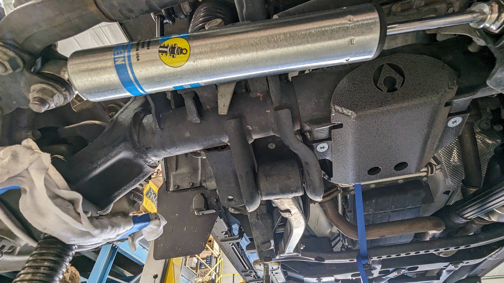

Here is the Artec FAD skid plate and Bilstein 5100 steering stabilizer. Yep, it pulls a little to the right, but I may live with that. Others have said it loosens up with time and gets a little better. I can also compensate with a pound or two less psi in the left front tire. I had this left over from my Wrangler when I was trying to cure a shimmy under certain conditions. It did not help much. But it feels great so far on the JT. We shall see how it goes. There was nothing wrong with the stock unit. So if this one doesn´t loosen up and stop pulling, I´ll go back to stock. But it really didn´t feel that bad yesterday. Not as much pull as I felt on the Wrangler.
The @Artec FAD skid saved my JL´s bacon in Vermont a few years ago. I got stuck, big time, on some boulders and that skid plate had most of the weight of the entire front of the Jeep on it. It took a beating and shrugged it off. Such a small thing but I think it is a critical piece of protection on a vulnerable spot. The factory skid isn´t bad, but it just pales in comparison to the strength and design of this one.

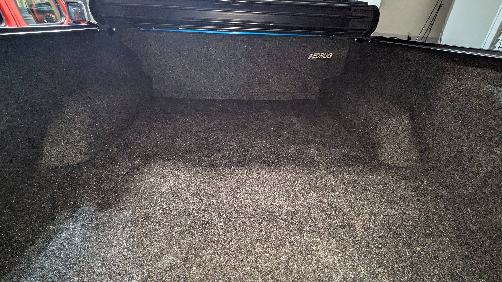

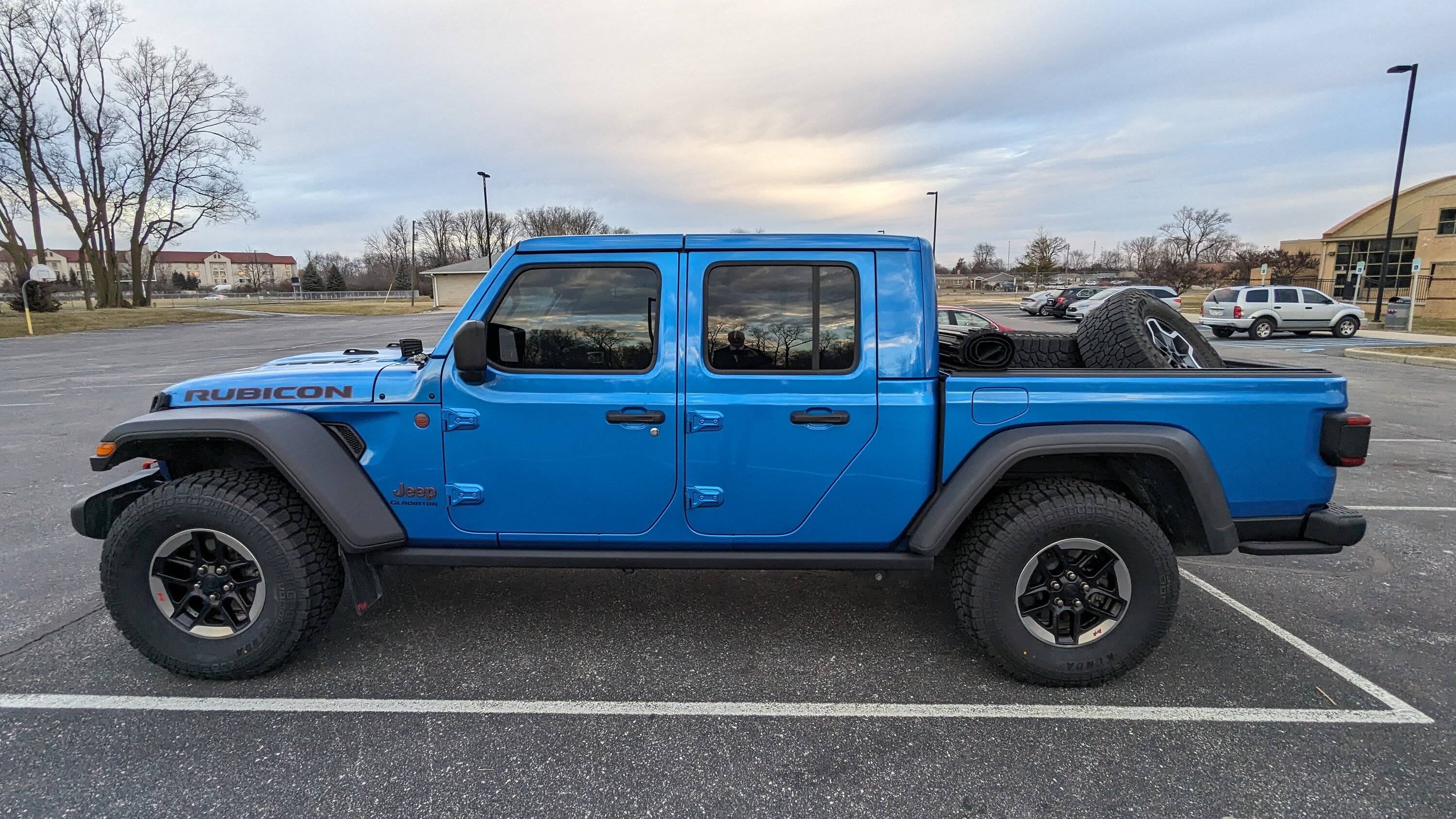

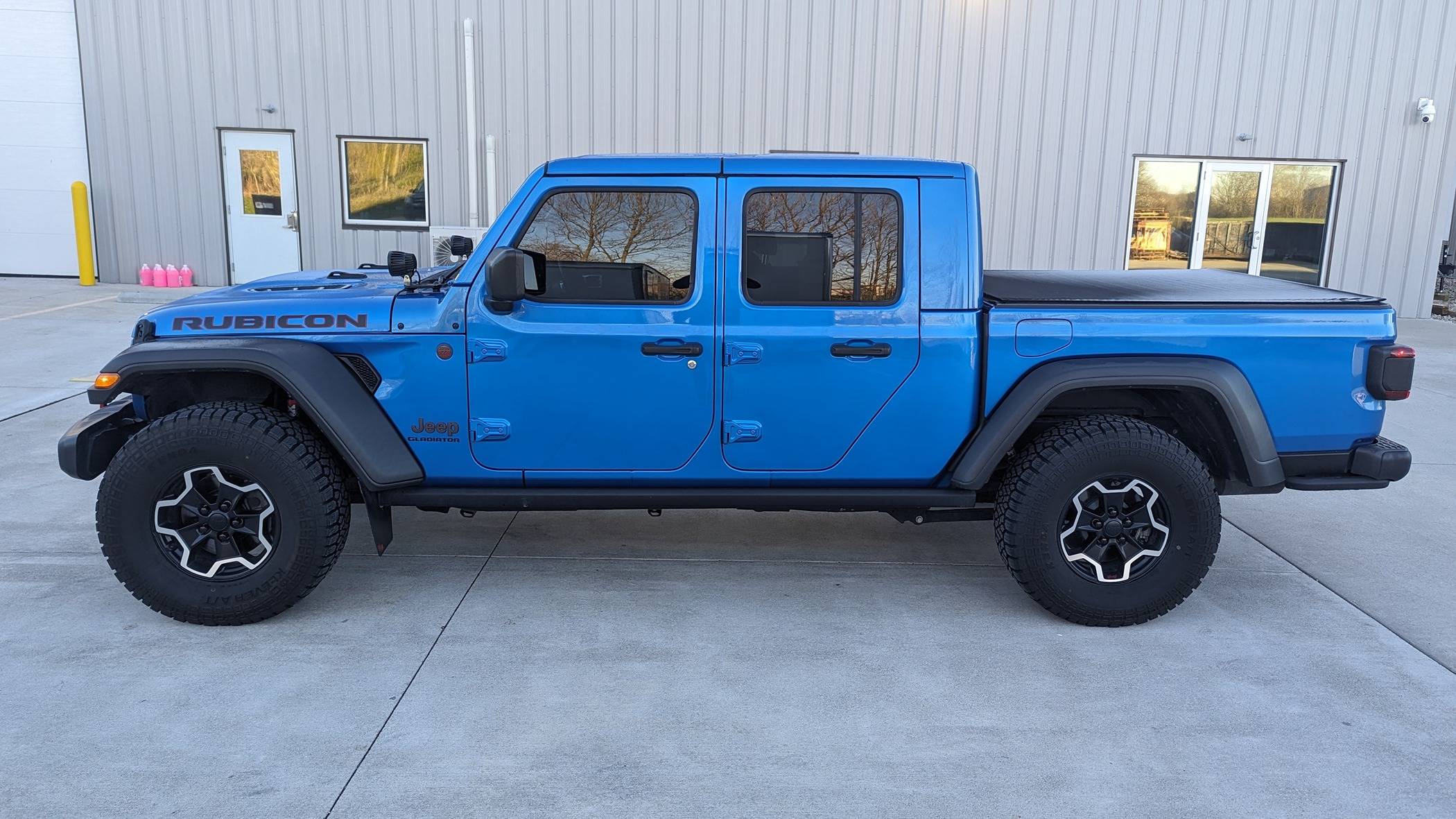

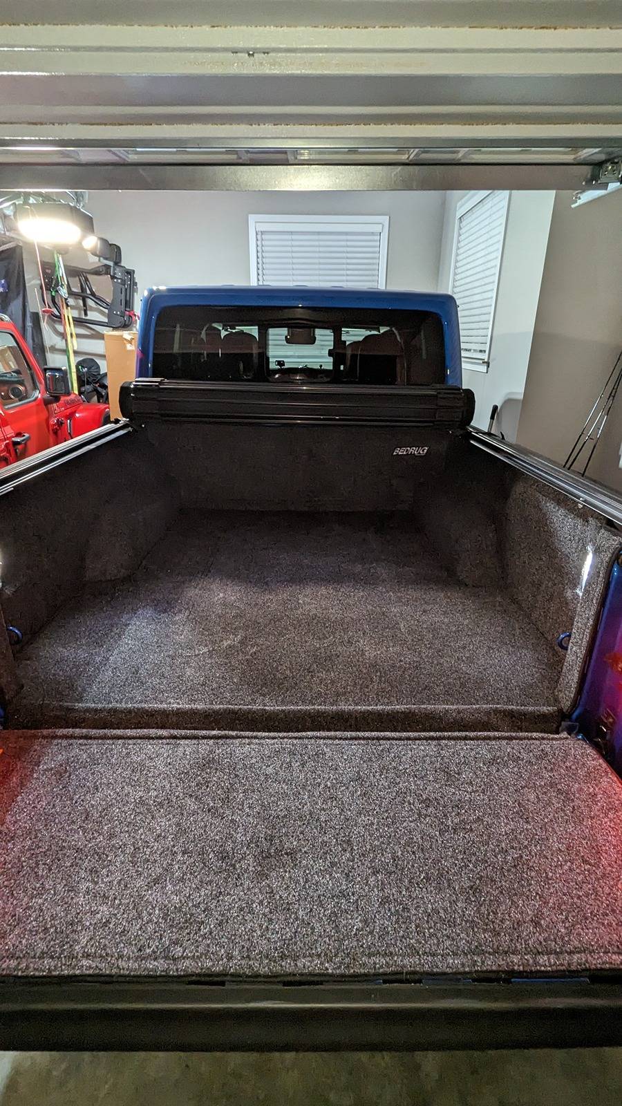

Ok, took care of some detail work on the build this week.
First, I moved my Sunrider for Hard top from my Wrangler to the JT. I purchased and added the retractable sunshade. What a nice feature! I don't need the intense sun. Pics will come soon.
Secondly, I added a Bedrug. LOVE this thing! I still have to make a cutout for when I rig a power outlet and I have to re-install the tie downs closest to the cab, but that's it. My kids are looking forward to sitting back there at a drive-in movie!
I have to say I really like the bed rug too, unless you plan on hauling loose dirt or rebarb, it's quiet, safe for furniture, and really for what it is, very durable.

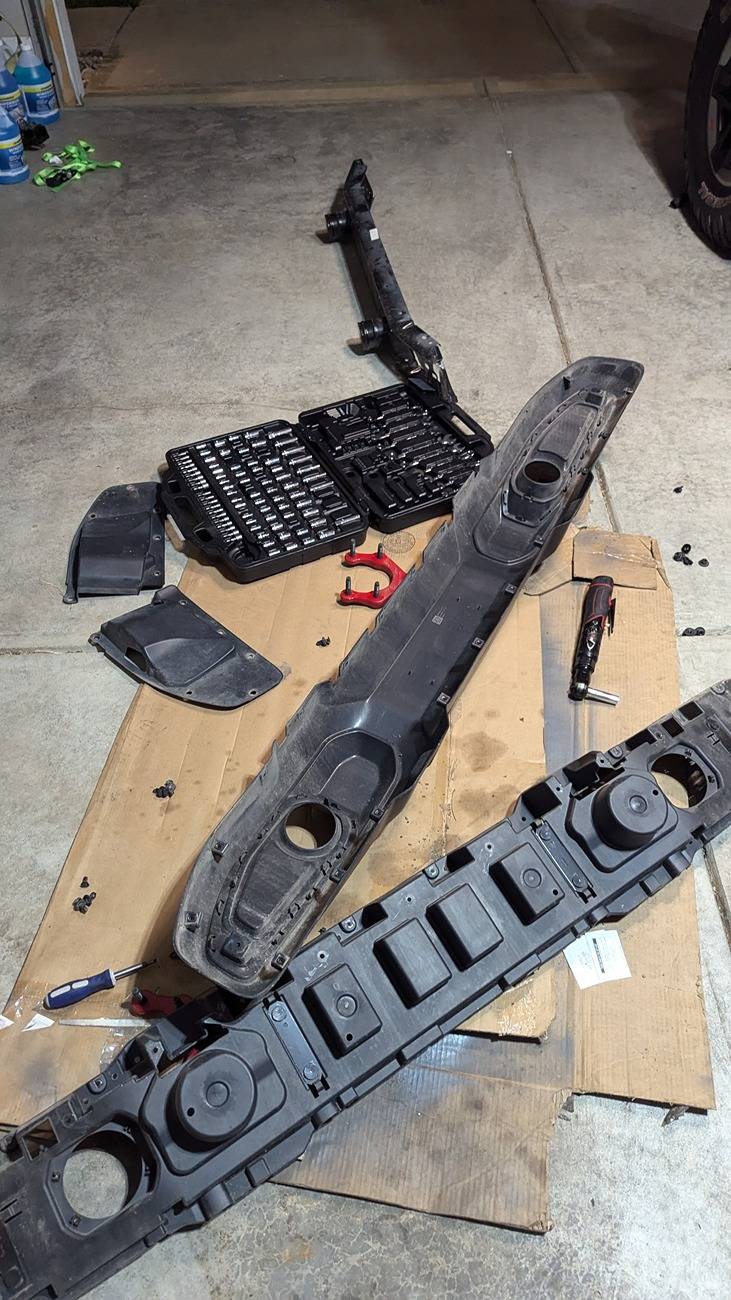

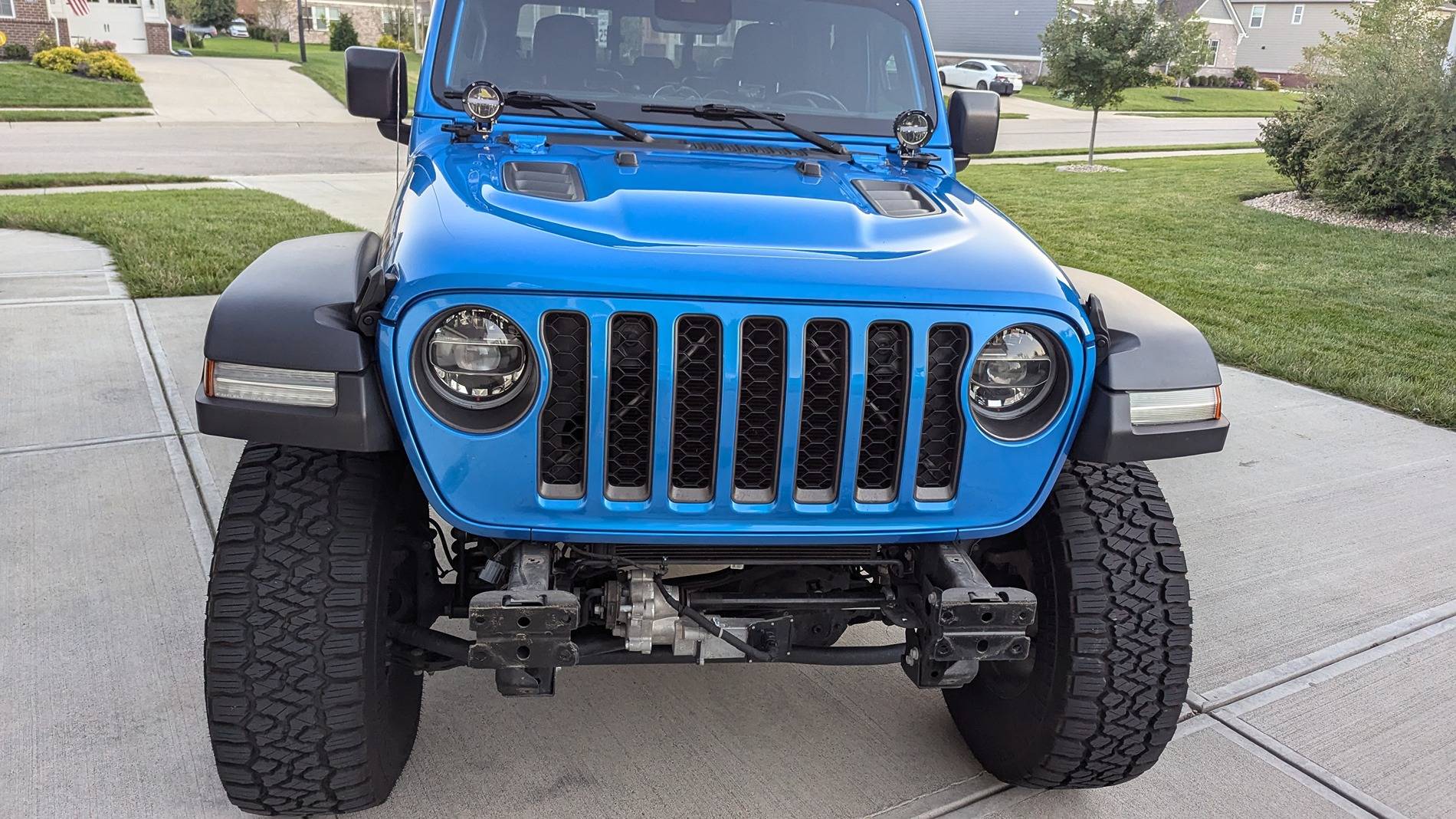

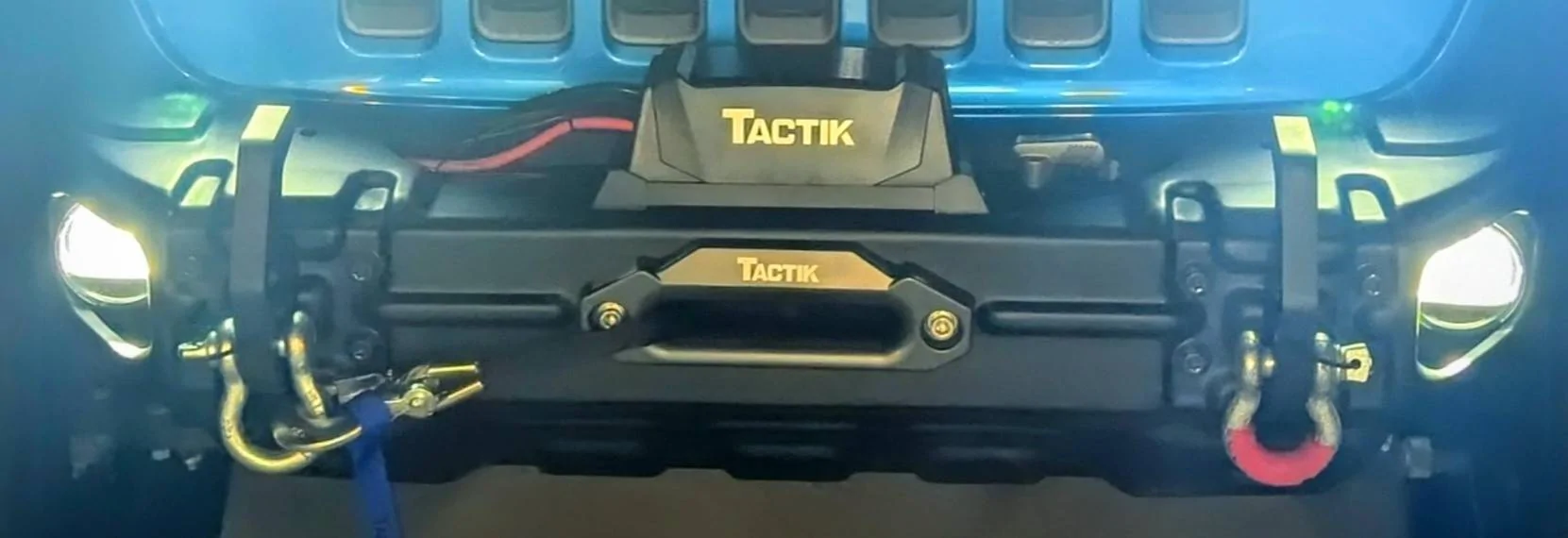

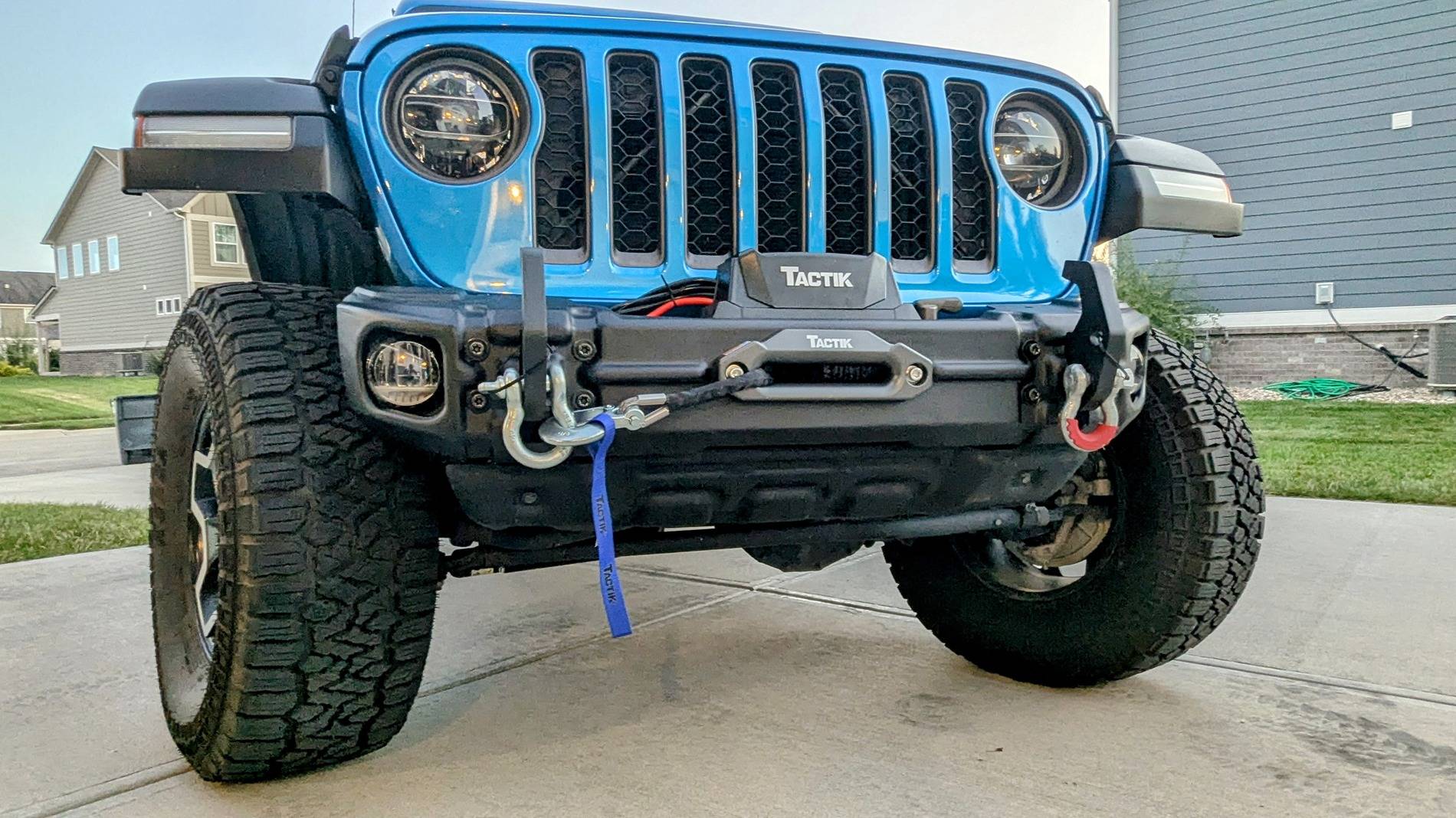

Finally back to the build after a pause...I'm getting this beast ready to do what it was born to do....hit the trails! So I picked up a Rugged Ridge Arcus front bumper and a Tactik winch. The good folks @Northridge gave me a great deal on the bumper with rewards from the AEV lift purchase and @Quadratec had a smokin deal on the winch. So here we go.....

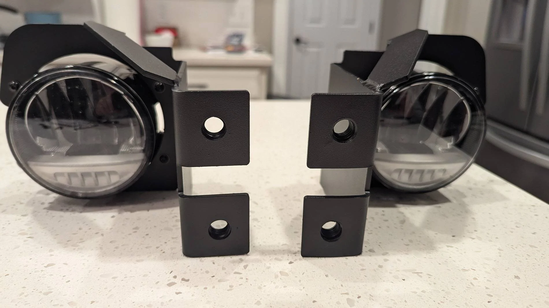

Last night, I took the stock skid plate and plastic bumper off, removed the fog lights, mounted them in the Arcus brackets, and disassembled the factory bumper to extract the fog light wiring harness.
Tonight, the winch plate goes on, and hopefully, the winch.
Pics coming soon.....
Why the Arcus? I had one on my JK. It is super light weight, looks great, has holes in the hooks for two different sized shackles (Hooks are made of BEEF!) and the winch plate is well designed and strong. I had this bumper on my JK and LOVED it. It also has a great spot to put a pair of big lights, which will be coming soon.
I'll put some updates in this evening!

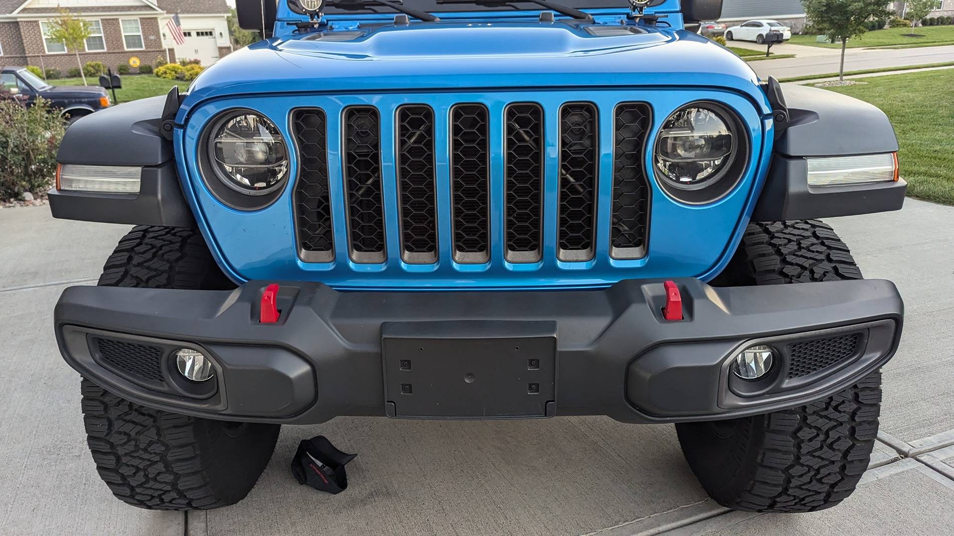

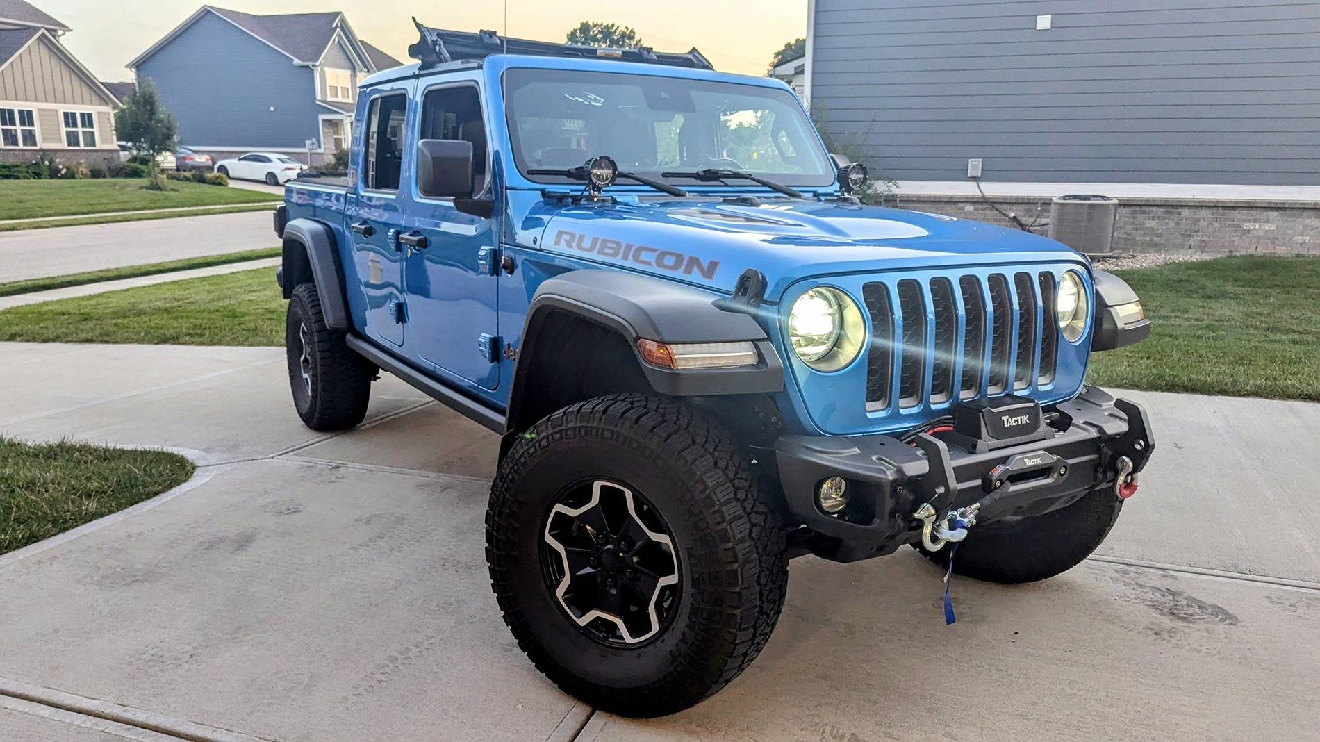

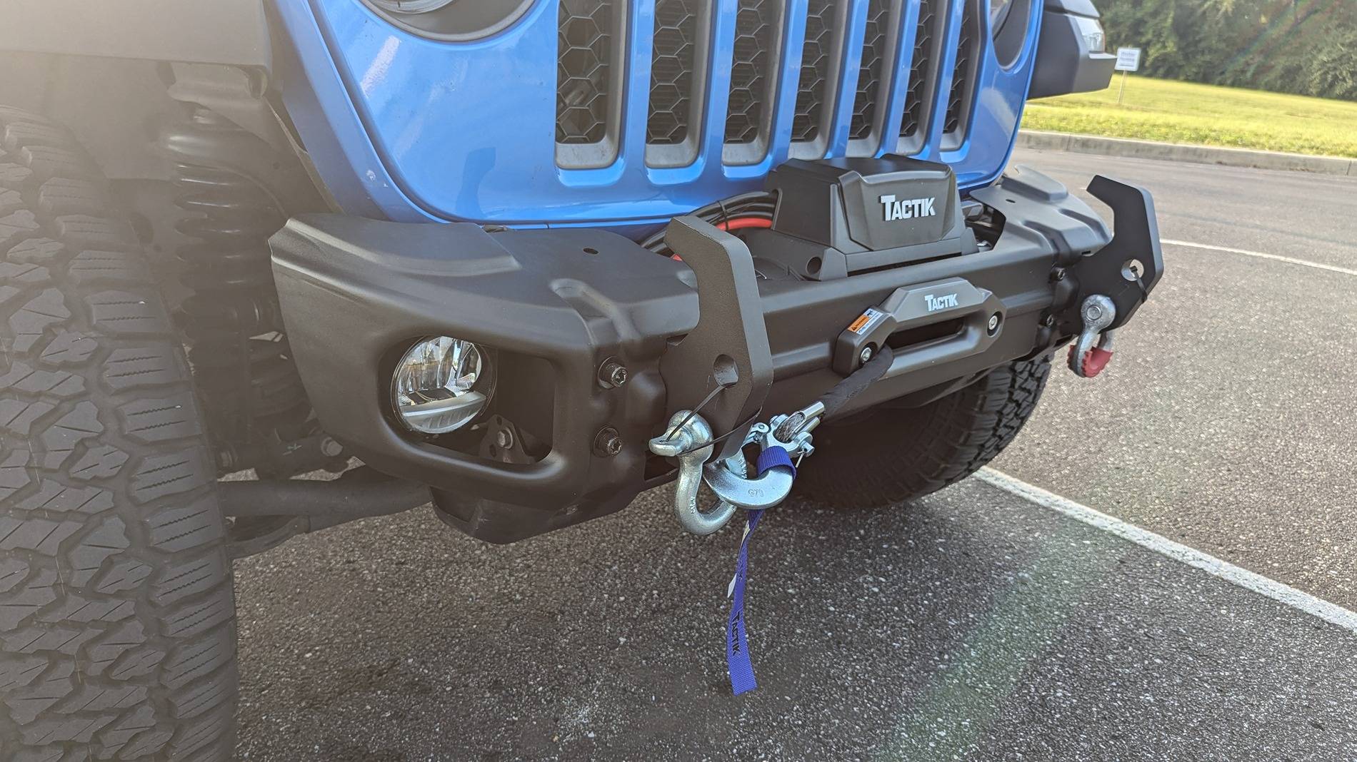

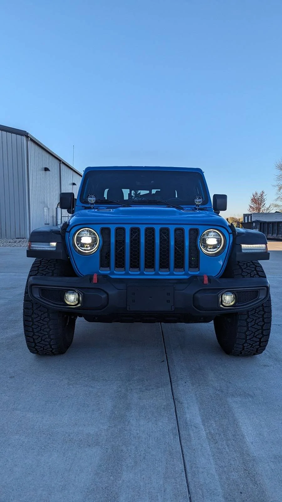

Bumper is installed! I now have a Harbor Freight device (I can't remember what we call those things) and need to get black rubber isolators for the hooks. (There is a red one in the port side hook) The isolators keep the hooks from bagning around. I'm going with the silver shackles instead of red. The red has run its course. Every dumb ice cream SUV on the road has hijacked the red Rubicon hooks. I'm even considering taking off my Rubicon stickers to get rid of the red outlines, but they don't show too much.
Anyway, I now have to adjust the fog lights. Washers will be necessary for that because there is no adjustment built into the mounts. The washers should work just fine.
And more good news....The factory front suspension skid plate bolted right back on. No need to purchase the $200 Rugged Ridge skid plate, although the RR is thicker and stronger. The factory plate covers more, thoughl I've never done more than scratch the front factory plate on my JL, so I can live without the added thickness and strength.
