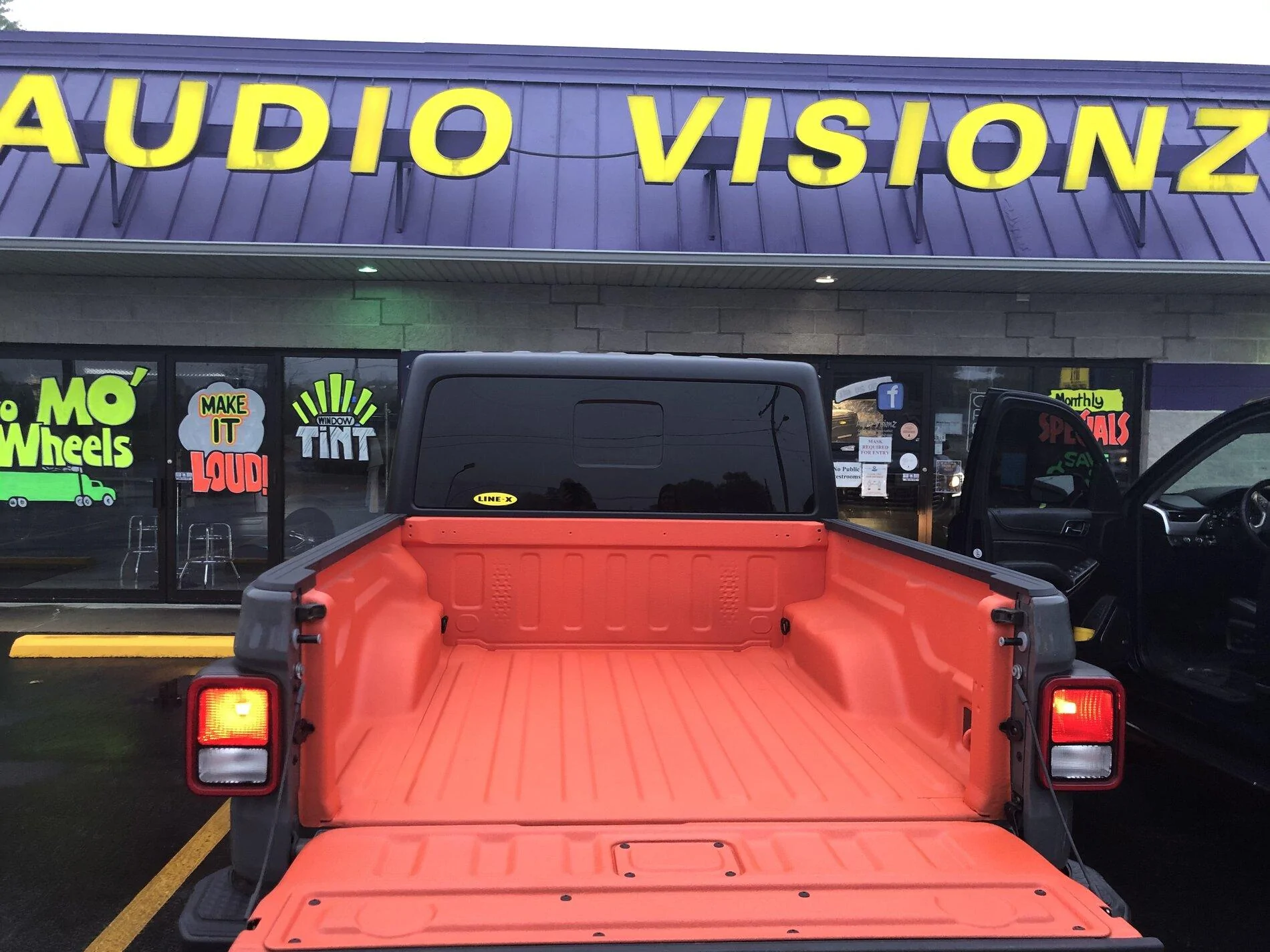

Line X orange sprayed in bedliner
I did not know you could get Line-X in any color other than black! AWESOME idea with the Mohave! I will have to borrow that when I get mine. Did they have to order anything special to do that color?

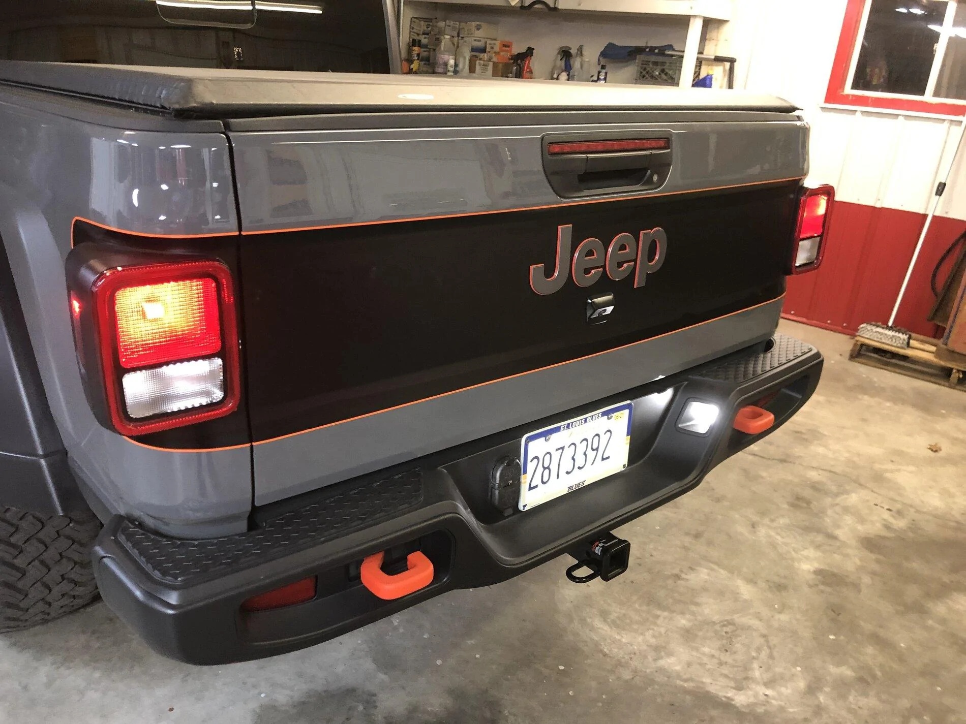

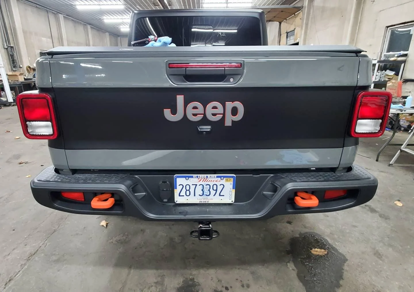

Can you give a little more info on the blacked out tailgate? I’m looking to do just that, but don’t want to muck it up....professionally done or DIY? If DIY, How’d you remove and then reinstall accurately the JEEP logo? How’d you line up the vinyl so it’s not wonky?....Also, where’d you buy the vinyl from?
Thanks!
I was going to do it myself because I install window tint and have done this kind of work before but when I got the ceramic coating reapplied (due to the company that sprayed in the bedliner got overspray all over the Jeep!!!! :( and I wasn't going to take the time to reapply it) I had the shop that took the overspray off and apply the ceramic coating put the piece on the tailgate. But far as putting the Jeep emblem back on there is a company called https://www.adhesivetemplates.com/product-detail/?itemID=13961&categoryID=2
where you can purchase the outline and put the name plate back on.
But I do know that you can purchase the black car wrap off Amazon or just do a search on google for it and it is very forgiving to apply. I think if you just take your time you can do it. Good luck.
I own a body shop and I took them the paint they needed. But they did have to order in a Neutral spay for the liner. They just need paint mixed with no harder or binder in it.
Nice. Thanks for the information.

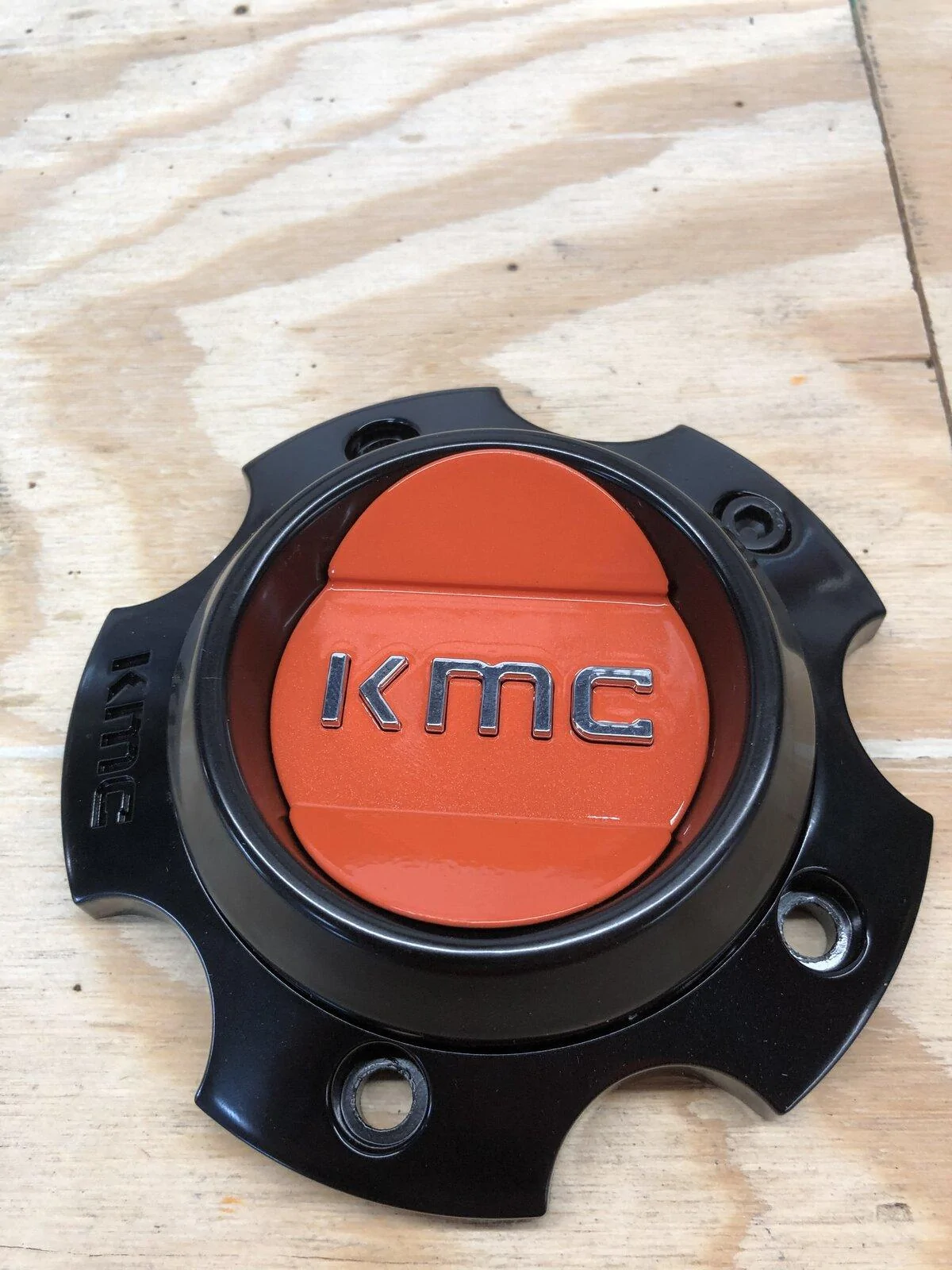

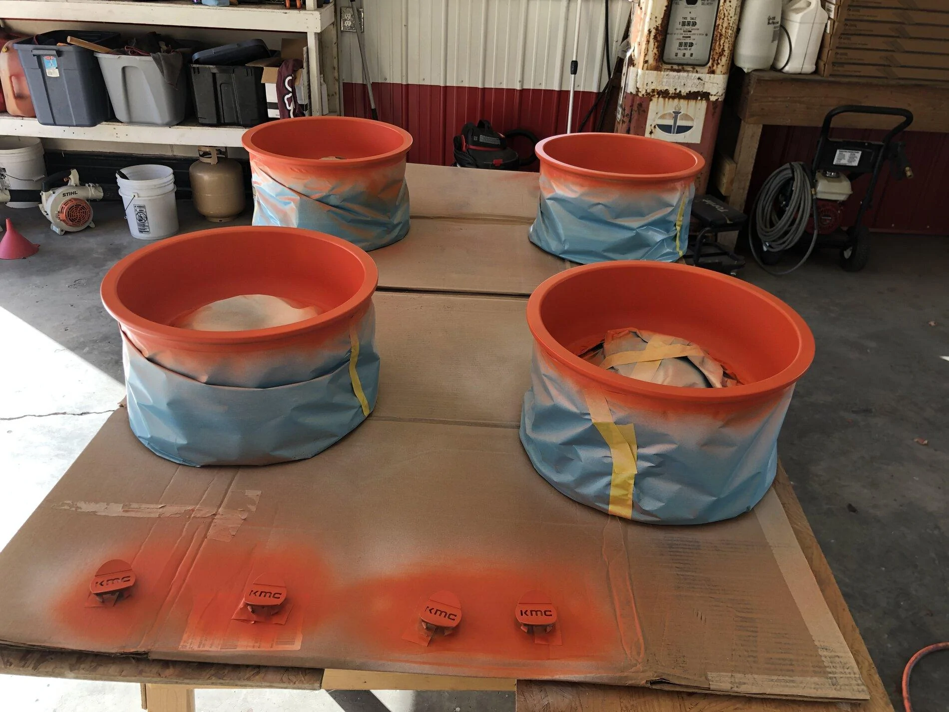

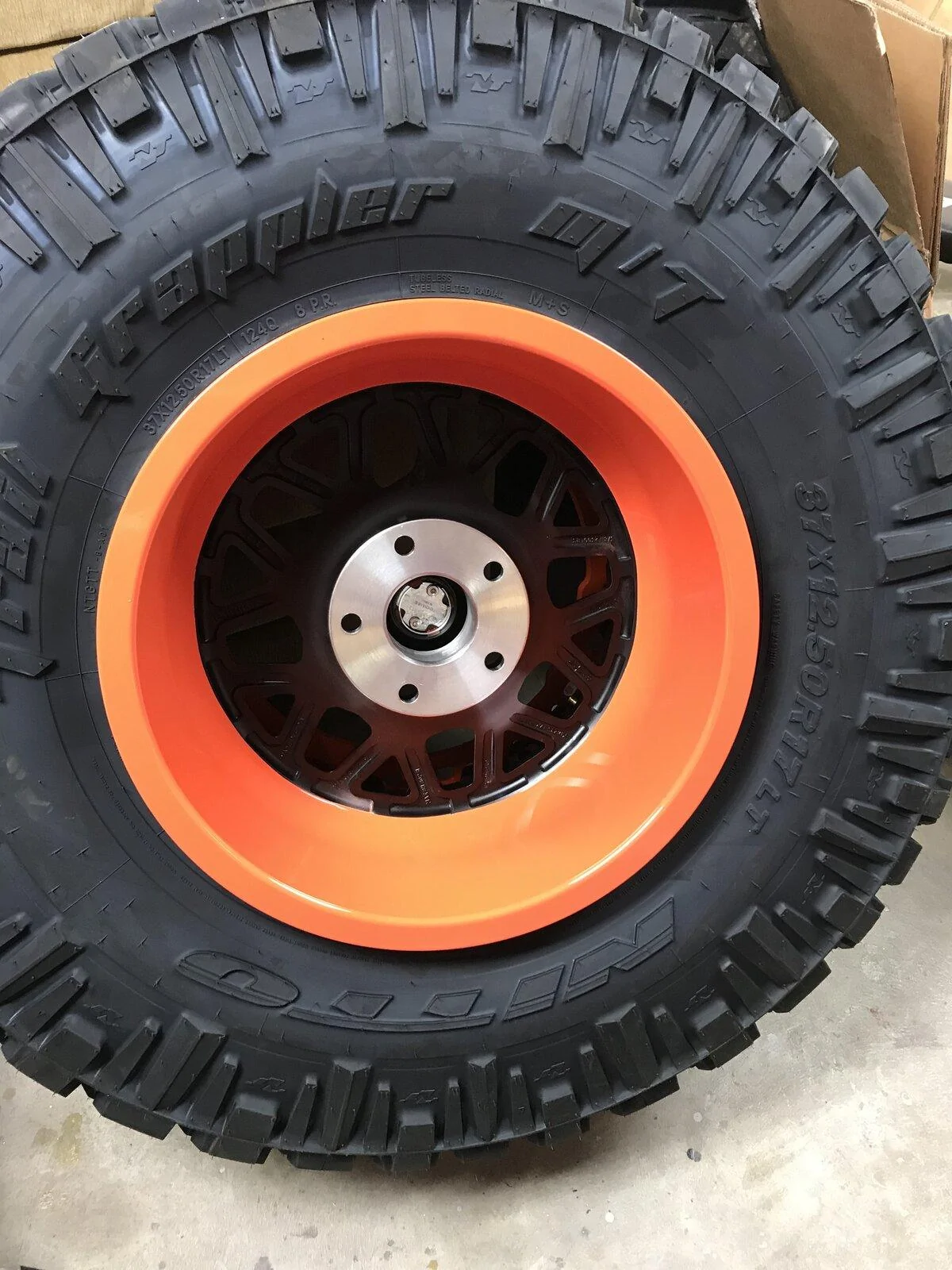

Is that a pic of wheels painted orange? If so, please send pics. I've been wanting to paint the stock steel wheels that came on my Sting Gray JT but have not found a great orange yet. I've been looking for a flat orange but no luck so far.
I actually just painted the back side in an orange because I wanted to powder coat the complete wheel orange but the wife and kids wheren’t to sure they wanted that much orange. So I have done this before to other Jeeps!
Thanks!
I got mine here, and did it myself. Not too hard, just take your time and make sure it's warm. I got mine in two colors/layers so it looks like it's surrounded by a pin stripe. They can get you almost any color you want...
https://www.etsy.com/listing/875288...ckout-tailgate-decal?ref=hp_rv-1&frs=1&bes=1#
I saw that too. And thought about it. I bought some black wrap and tried blacking out in between the windows on the doors and just that area took me forever so when I had the Ceramic coating done the shop also does wraps so they charged me $200 I told them to do it especially behind the tail lights!
I will tell you after taking the taillights out after putting them back in CHECK your tail lights. After picking it up and getting about 10 miles down the road my wife noticed I didn’t have tail lights?? So we turned back around and went back to their shop. And they had to replace both bulbs? Don’t know why but they where both bad!

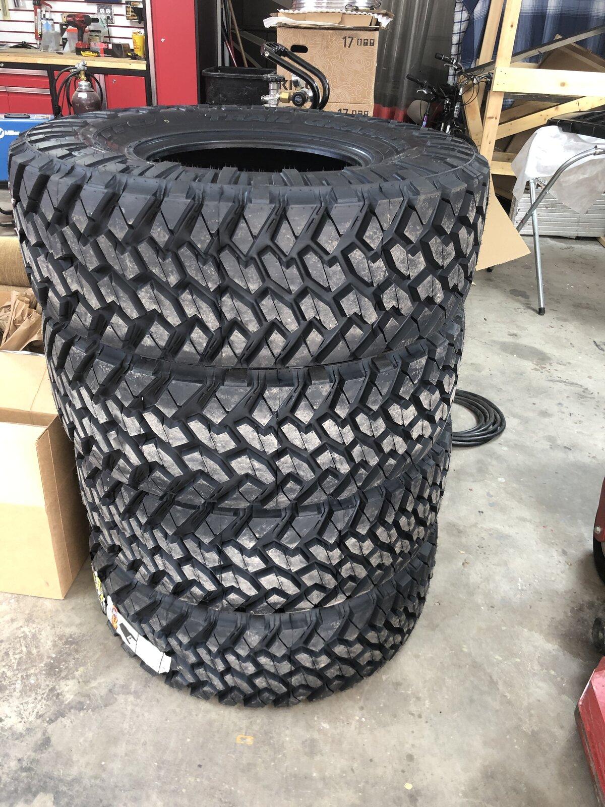

How did you balance the tires?
