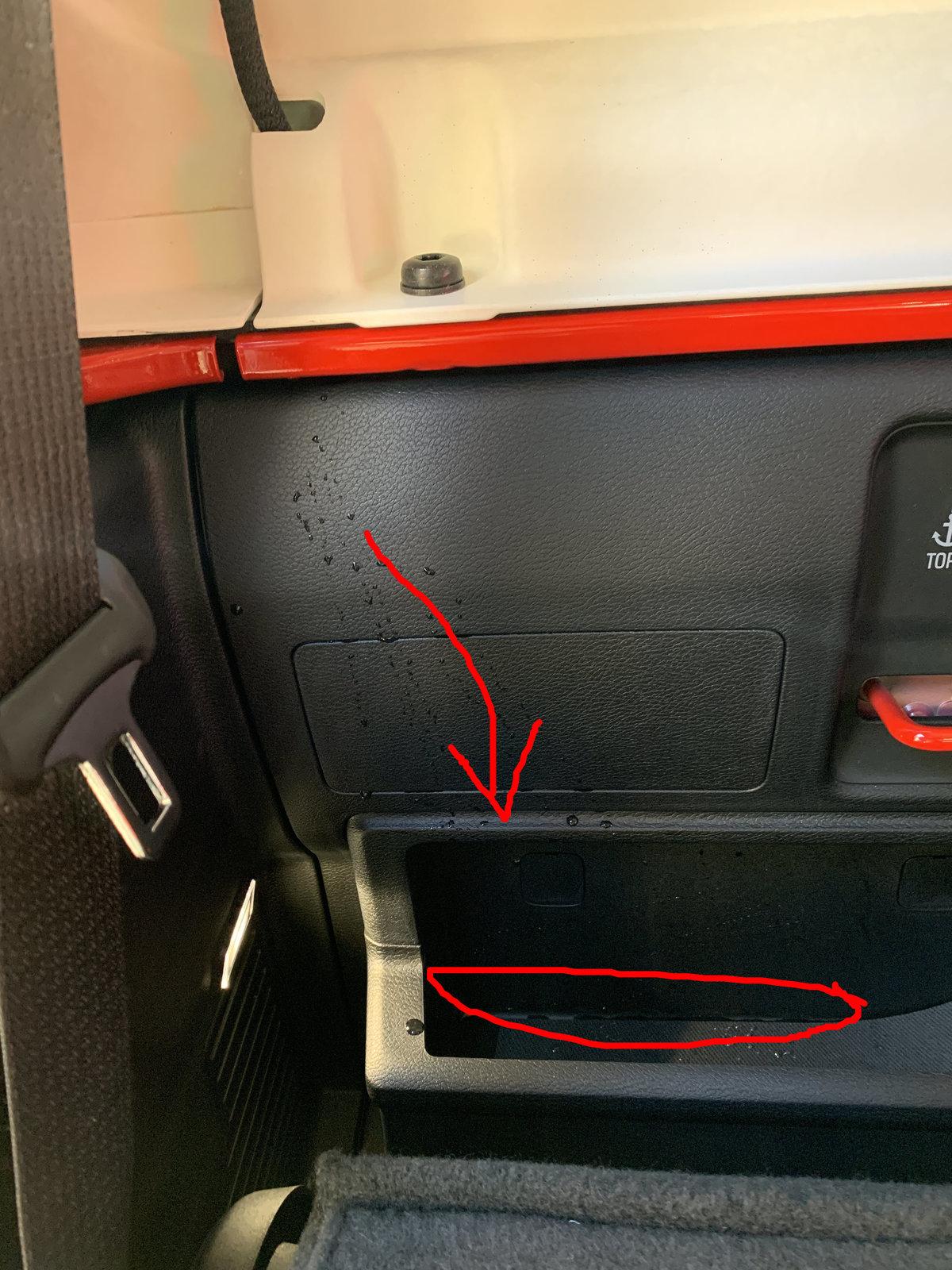

You can see in this pic the water was dripping down here into that little storage compartment (this is the right side) -
Jeep Gladiator I Keep Hearing Water Sloshing Around In The Back Seat Area & Can't Find It 20200817_211554523_iOS
The compartment on the left side had a little water in it too, so I dried both of those.
There was no water in the rear under the seat storage bin, or the rear passenger floorboards.

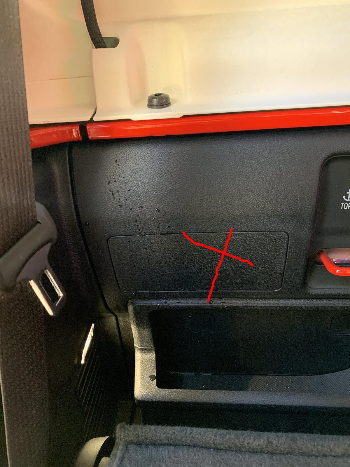

@wyodirt - The carpet is totally dry at the passenger floorboards. I drove it around this morning and still hear the water moving around. Thanks for the suggestion though!
I popped open this cover and took a peek in there and didn't see any water-
It just sounds like the water is in the back somewhere.

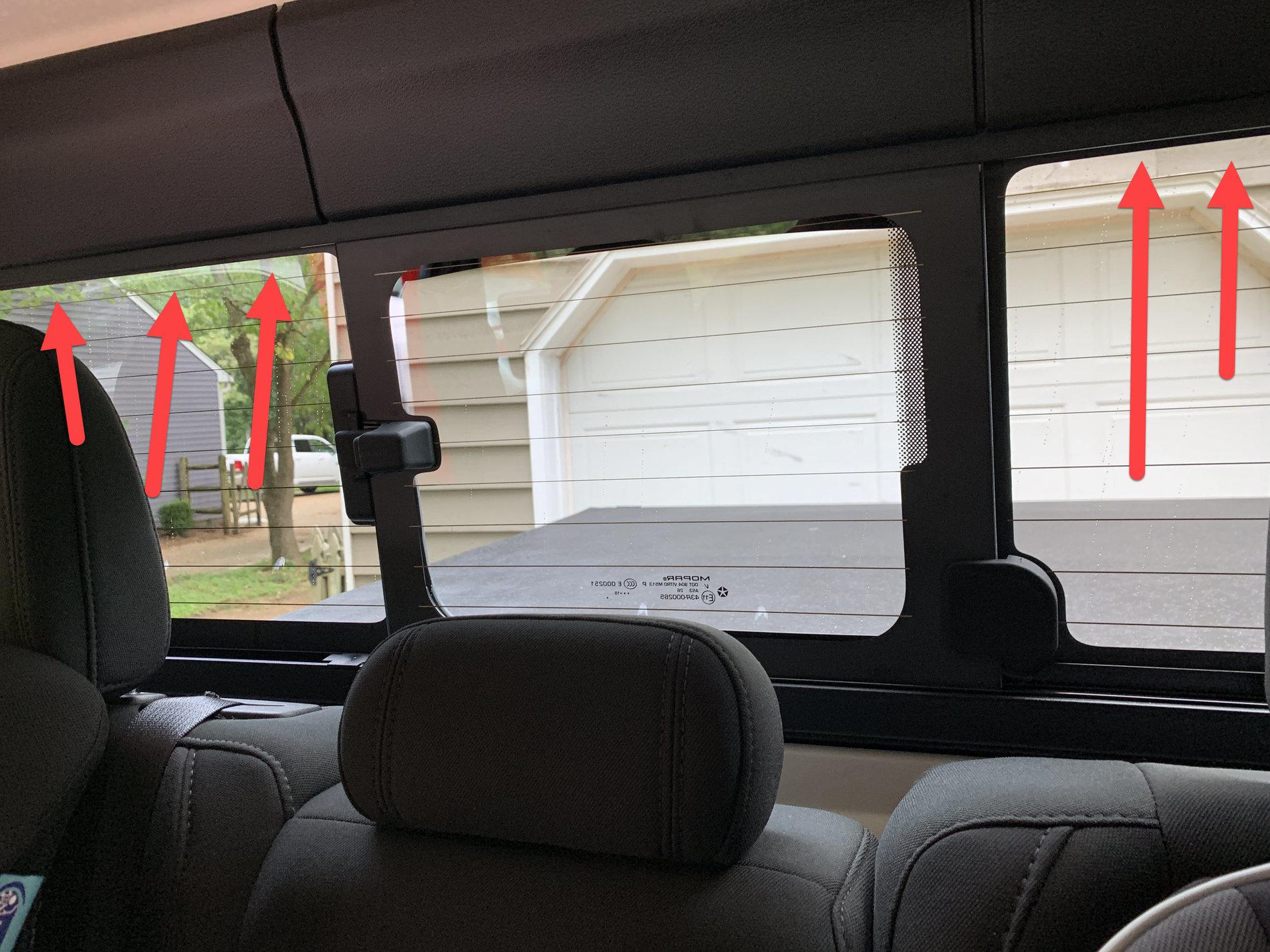

@Shootist - When it rains, I've been getting water leaking in at the top of the back window in multiple places as seen here-
Jeep Gladiator I Keep Hearing Water Sloshing Around In The Back Seat Area & Can't Find It 20200821_171420614_iOS
We had a ton of rain so it dripped down and somehow found it's way inside the hard top below the window.
I have an appointment with the glass people at the dealership to fix it on Sept 1st. Evidently it's a common issue so you may want to keep an eye on yours when you get a hard downpour of rain...
