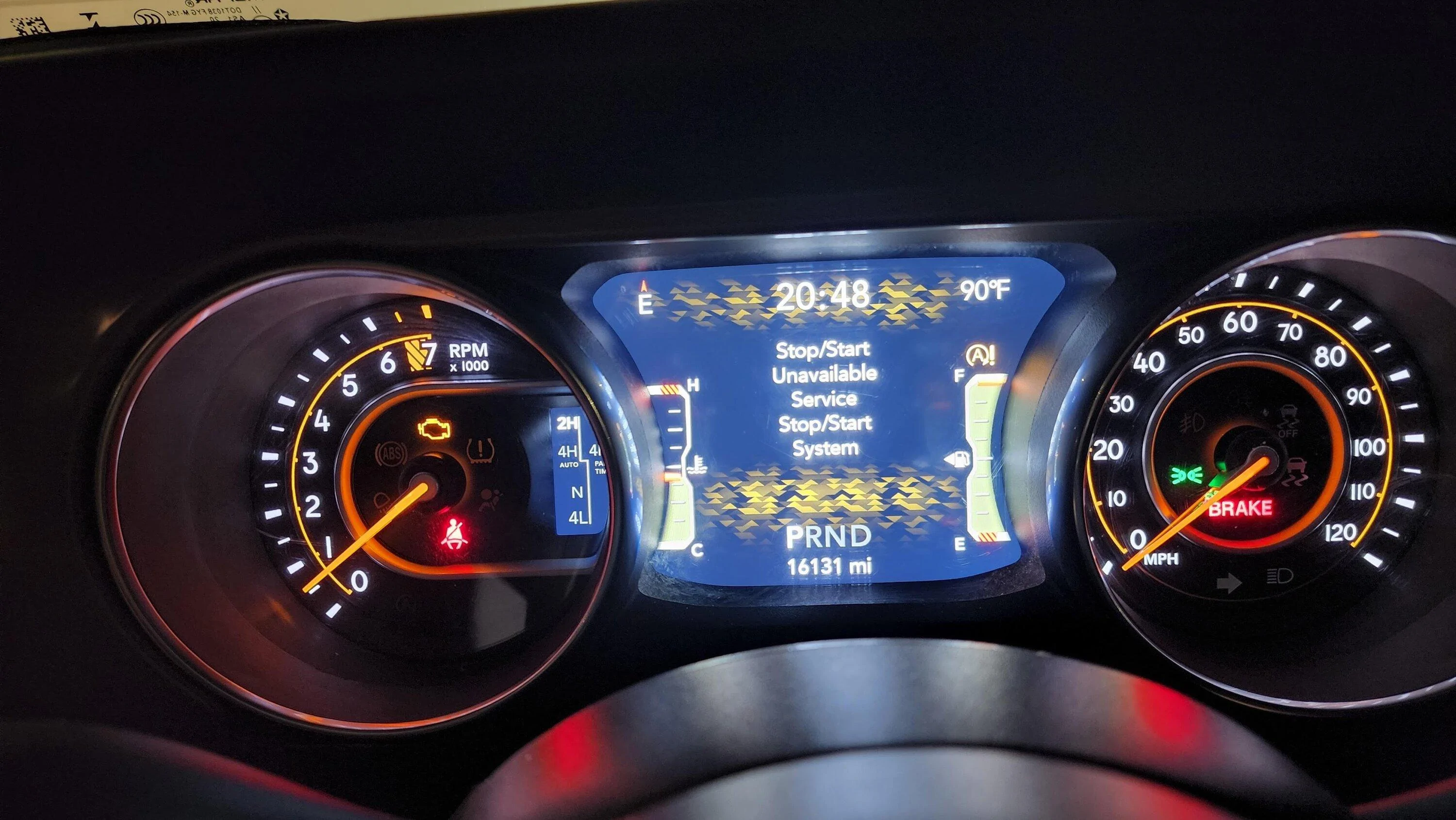

Yesterday I took the doors off as we are expecting to have a rare clear sky's for a full week here in Houston.
This morning, when I tried to start my Gladiator, it did something funny. It went through the motions of turning on, that is, everything except the engine. Then, it took the weirdness to a new level as when I tried to turn it off, it stated that I must be in park, but I was. all the lights on the floor shifter were illuminated.
I unplugged the battery and later in the day I finally managed to get it jump started. But now the check engine light is on and the start stop light is displaying on the top right.
The truck starts right up now but I have no idea why it would have done this in the first place. It's just over a year old with low miles and the original battery. And while I would typically use such an event as an excuse to run off and get an Optima battery, I would much rather know there is nothing wrong with my truck.
it does get humid here, could that have something to do with it (exposed)? My JK used to go months topless with no errors.
I've added a lot of aftermarket accessories, is there a means of seeing if there is a drain when the engine is off? Did I cross some wire somewhere?

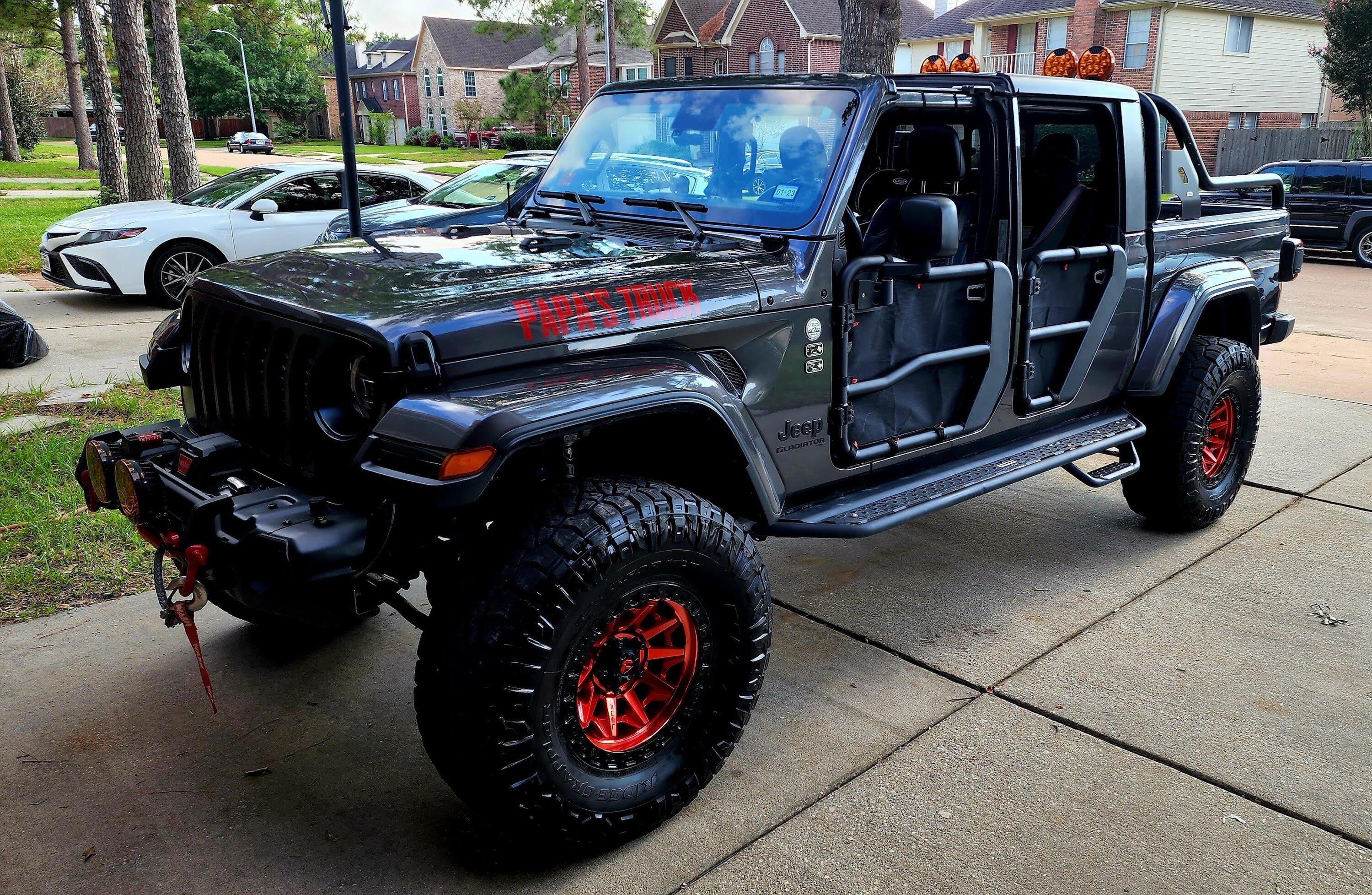

added a second pic because it's so damn sexy, you can all understand my frustration.

The dreaded death of the Aux battery.
Pull fuse F42 until you can get it fixed.
If it's out of warranty jump into the batteries section and start reading for options.
You can replace, delete, upgrade as whatever best fits your needs.
Thanks for pointing me int he right direction. Is that second battery typically covered under warranty?

Check for bent pins in the door connectors.
There is a constant drain from the computers and alarm system. Also from the head unit, if you have the 8.4 Uconnect.
It could be a failing battery, either the main or the ess battery, or both. If the truck is not driven regularly, it is more likely discharged batteries.
Depending on how good your dealer is, you may get resistance on warranty replacement. If the batteries don't fail on their tester, they can only charge them up and send you on your way.
