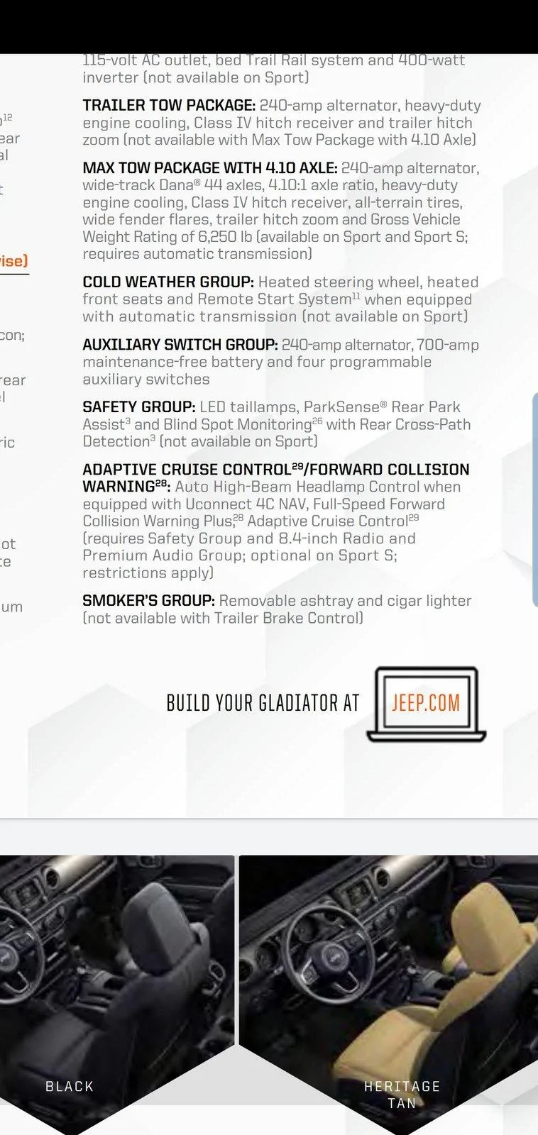

I know it's an older post but look at Adaptive Cruise Control notes
I was sure this was going to happen since the JL already had this feature.
Although my auto low beams are doing their job seamlessly without error.
Neither the 400+ page PDF owners manual, or the 600+ page V2 PDF owners manual mention auto high beams. The only reference is to the auto position in the headlight on/off switch. I have the ACC/FCW package, with the 8.4" uConnect and NAV system, and high beams have to be manually engaged. Maybe it is something they will offer for the JT in the future.

180
29,541
35,144
These do not have it.
I also have the ACC/FCW and the 8.4 uconnect with nav and v3 of the owner manual in PDF and a partridge in a peartree.
My son's Compass has auto-dim headlights and he LOVES IT. My wife bought her Grand Cherokee about the same time and wasn't happy that her GC does not have this but my son's Compass does. Where we live you have to keep a hand on the dimmer at all times - windy, curvy roads, grass and trees up to the roads, creeks and the Des Moines river, fields, all perfect for DEER and other critters. So you want high beam on as much as possible, but are constantly changing back and forth. I've ridden with my son, I have driven his Jeep several times and can say I absolutely love that feature and was VERY disappointed that I could not get that in the JT. It's just not there, the dealer who went to training on the JT and features and how to sell said nope, not there.
It may be in the GC at another level than ours, but it's not on my wife's and she also has the ACC/FCW and LANE DEPARTURE which I also love.
Here's the thing - we know Jeep was wrong about payload, their docs had mistakes and they screwed up including a 150 pound driver. I am betting that those documents shown above came out and then reality hit - they weren't able to include it.
I've seen this in the past - documents come out, problems in production, the feature doesn't get put in, documents aren't changed, etc. I can point to this on other vehicles. I collect owner manuals and service bulletins and service manuals - it's amazing the difference between documents and reality when things go to production.
