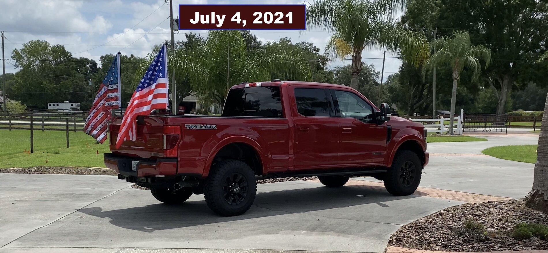

I placed a factory order for an F250 Tremor in Feb....
it arrived 4 weeks later...great Truck
I sold my Polaris turbo s 1000 last week and decided
to replace it with Jeep Gladiator.
I placed a factory order last Monday for a
Jeep Gladiator Rubicon...
Those Tremor package 250s are somethin serious. Thatā€™s my dream retirement truck (Iā€™m 26 unfortunately šŸ˜‚).
Edit: And I say ā€œunfortunatelyā€ because these cool trucks probably wonā€™t be around anymore when I retire.
