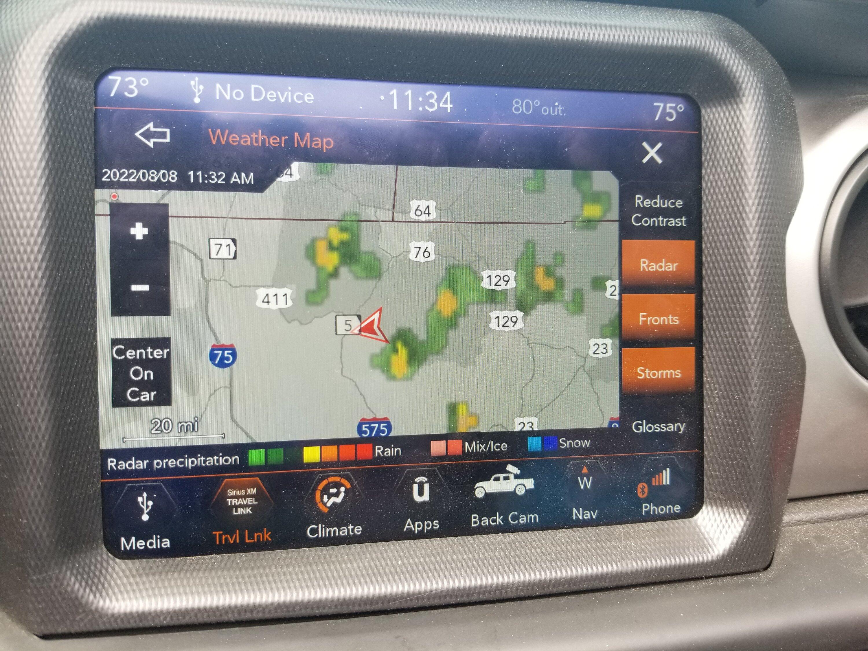

If you have any of the Sirius XM Travelink stuff, just be careful. All Jeeps come with 60 months (yes, 5 years) of Travelink for free. This give you weather, traffic on the nav, sports scores, gas prices, etc.
Twice now, once with my 2018 JL and again with my 2022 JT, when I called to "not" renew my music package, they also canceled my Travelink. A few phone calls with supervisors in both cases got it added back but it was a pain in my @ss.
Do I use them enough to really worry about it? No... especially with Android Auto and all the nav/weather/gas apps already on there - but for me it was the principal of it! They gave me 5 years, dammit and I wanted them back.
I dont care for the Music/Radio, but I really like the travel link.
Guardian was "neat" but NOT worth the money to me.
I run with the roof open as much as possible and having the radar view on the screen is great.
Haven't figured out how to get anything close to that on Android Auto.
Find the fuel cost and regular weather info on travel link pretty useful and easy to use too.
I cant figure out how to bring up gas buddy or similar on Android Auto either.
If I didn't KNOW where the storms really were, I would have closed up the roof based on how it looked outside.
