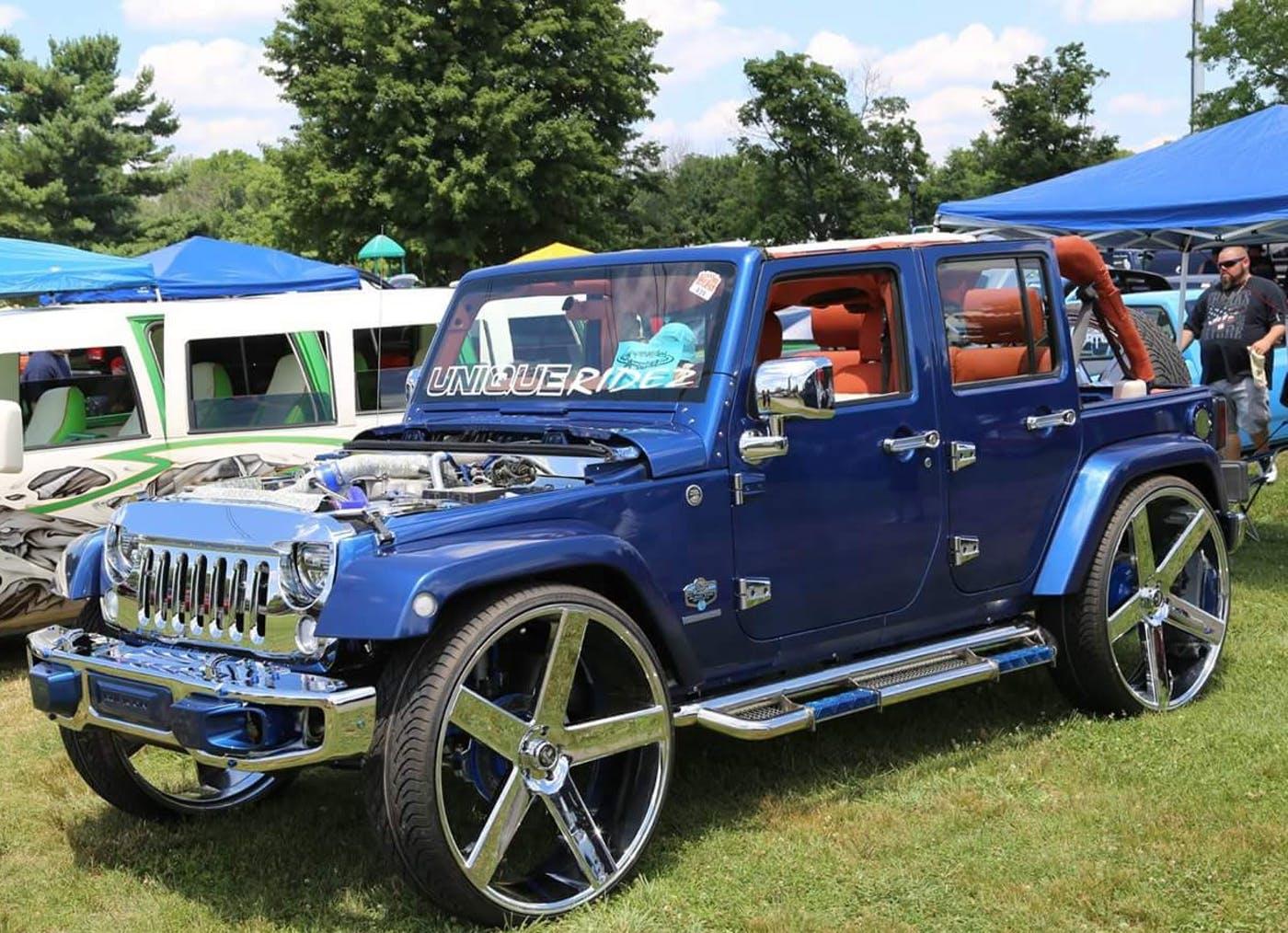

Cocaine Cowboy special?
Must make a hell of a noise on the trail as all the bling drags and scratches.

just dont hit a pothole
200 years from now . . . after the Earths Frozen Landscape has thawed sufficiently for Extraterrestrials to "visit" -- though I don't know why they would -- They may come across "THIS" Contraption (as they would describe it) and wonder . . . WHAT WERE THEY THINKING ? They'll "turn around" ( that's "space talk" for Rapid Ascent ) and head back to their own Planet . . . laughing all the way . I know it's true I saw it in my crystal ball .
That thing is crazy looking. Like if a skeleton had a car. No not Maria Shriver, a real one.

Hey @ACAD_Cowboy love to know who makes these step bars. Thanks
It looks a little home made, to my eyes I see some corrugated metal deck painted blue and some plate and tube chromed. What I don’t see is any triangulation to resist front to back smash damage. I moved my step bars back about 2” on each side and never even noticed it happening.
