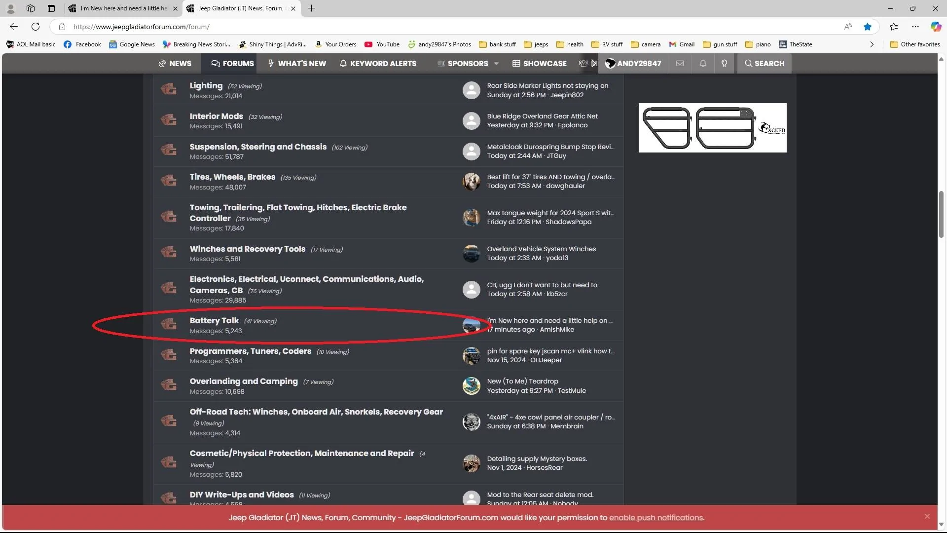

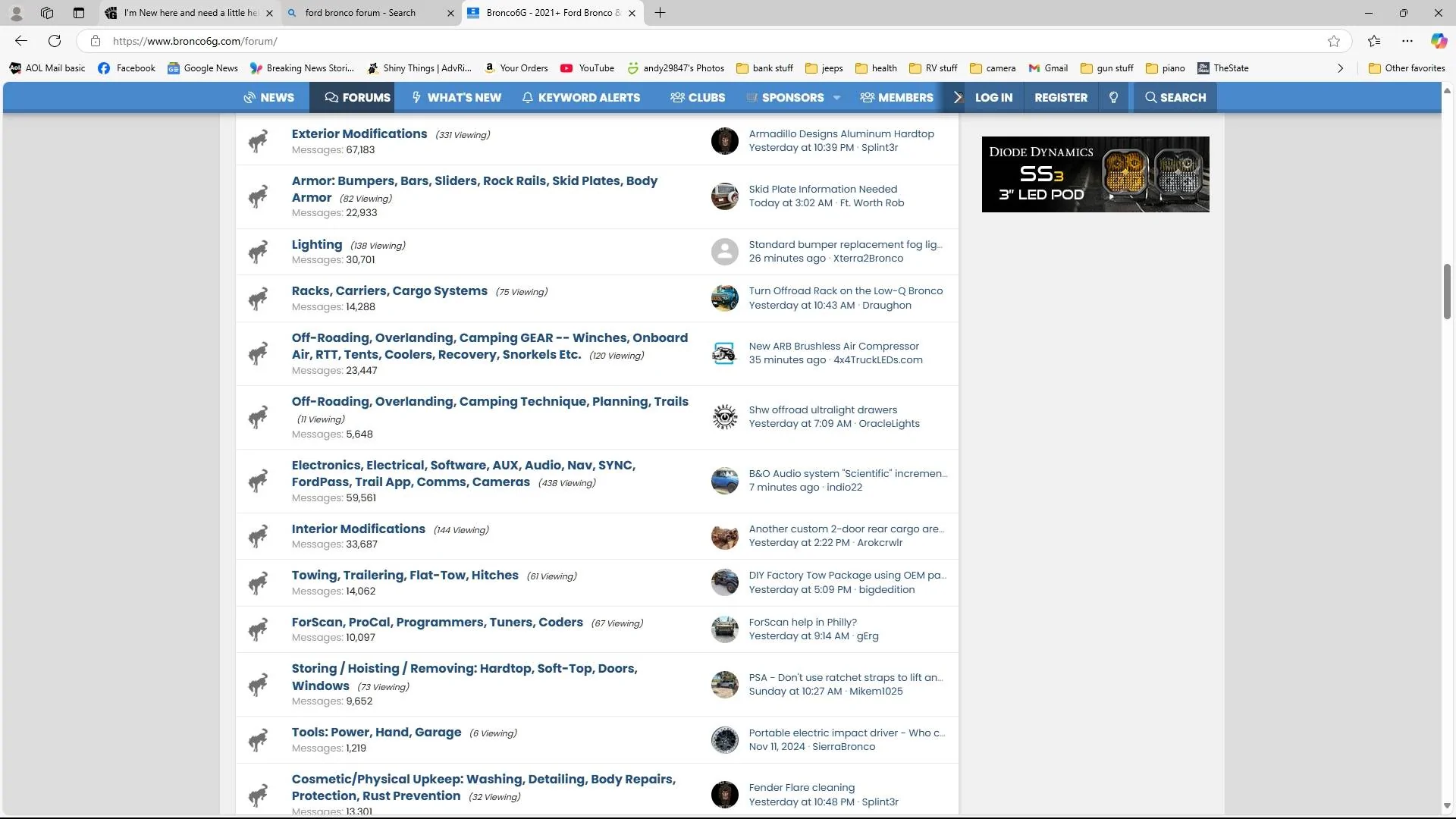

Youse guys rationalizing away the issues with Jeep's battery design are making my day. I love my Jeeps. That doesn't mean they are perfect.
Gladiator forum
Jeep Gladiator I'm New here and need a little help on my Battery. gladiator%20forum
Bronco forum
Jeep Gladiator I'm New here and need a little help on my Battery. bronco%20forum
