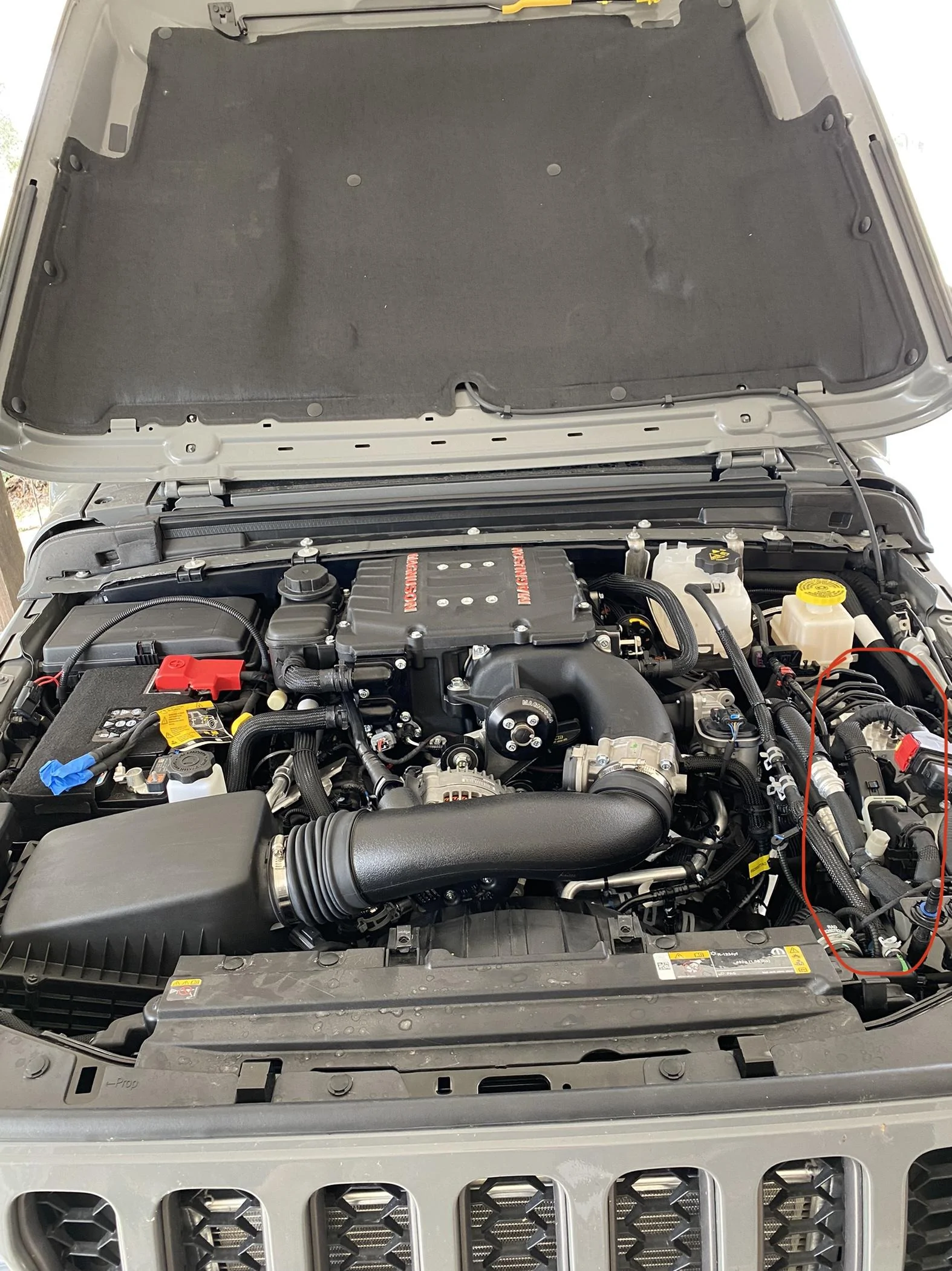

If you are thinking about a tune or forced induction, you need to check your ECM first. The one in the right of the picture, currently HAS NO TUNING SUPPORT.
The change is seen on late 21 models and not communicated or well documented. The dealer parts system does not even show this change has taken place..
Be nice if the mods made this a sticky😉

Oh no :crying:
I wonder if you could replace the harness and go with the prior iteration?
Ouch, that wouldn't be fun.
After removing and re-installing mine a few times, I get why they may have made the change. Those connectors are delicate and connecting and disconnecting them where they were located was tricky. I have had to repair both of my connectors. When I did my first removal one of them already was coming apart. The new design location looks easier to get to.
Any idea how long it will take HP Tuners to buy one and figure out where the chip they replace is located?
