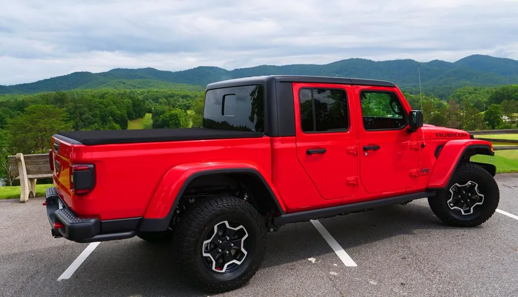

Hello Pickup Owners,
I'm an owner of a Jeep Gladiator and I thought my video would be of interest to a lot of you guys since like me you guys spend a lot of time in the woods. This video is on upgrading a standard battery camper to lithium. I know a lot of you guys stay out for a while so this might be of interest. Linda and I decided document our own independent installation and share it with other guys who might be considering a lithium upgrade to their jeep or camper.
While there are many different levels of installations, our film shows a total conversion from flooded batteries in a camper to a state of the art advanced lithium system. The film includes an overview of 12 & 110 volt wiring. It also covers our five different charging sources and most important, having the right RV appliances with a lithium coach.
A few of the key components are a pair of Lithionics Battery 400ah lithium packs (800AH) providing over 10 kilowatts of lithium power. The packs are regulated by a Lithionics advanced Bluetooth BMS module. The secondary component is Xantrex’s Freedom 3012, 3 kw inverter, with its 150 amp lithium protocol charger, SCP panel and Combox wireless system, connected to our MoFi 4500G 4G cell router, allowing monitoring and making changes to the system from any location.
The system also includes a Mastervolt’s Charge Mate Pro for charging from the stock Transit alternator, and Victon’s solar controller and 400 watts of roof panels. The film also includes installation of a Ring 4G alarm system with cameras and a lithium heating system.
Enjoy - Mike Mas
