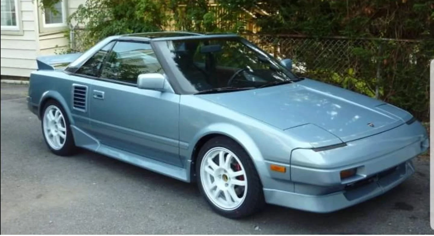

Off topic but here's my old MR2 just for fun... miss her but oddly the JT gives me the same feeling. Very excite!
Jeep Gladiator Install amplifier on aux switch? Screenshot_20200416-001304_Chrome(1)

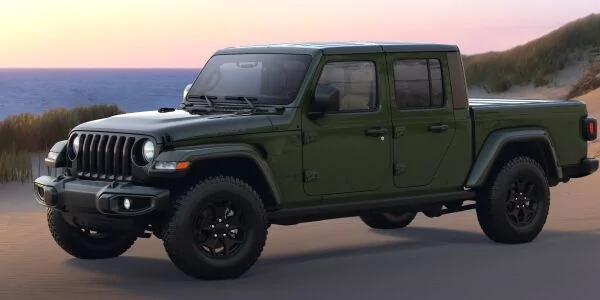

And Jeeps render of my Willys...
Jeep Gladiator Install amplifier on aux switch? iris
Will be the first "fun" ride I've had in a long time.
