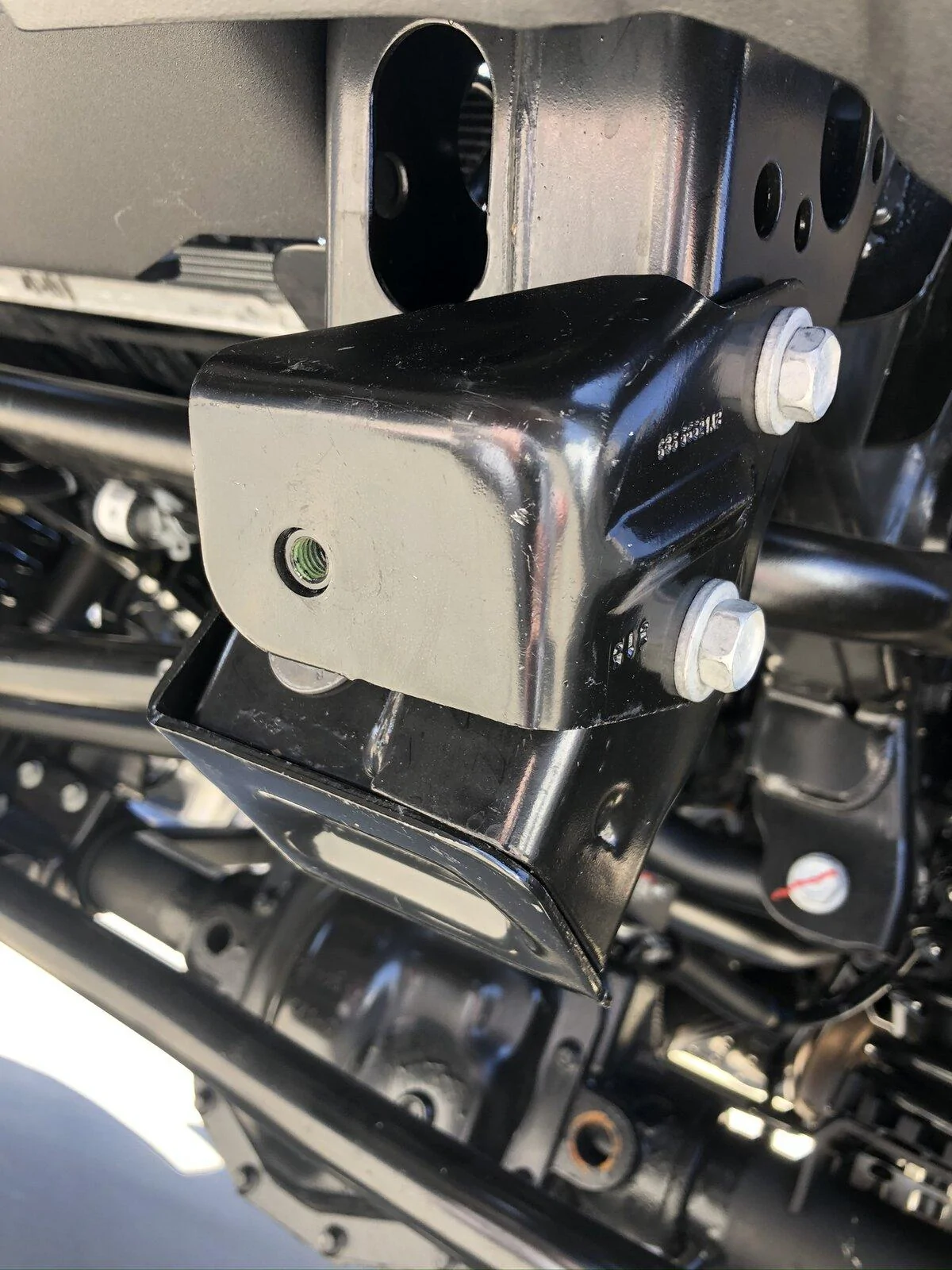

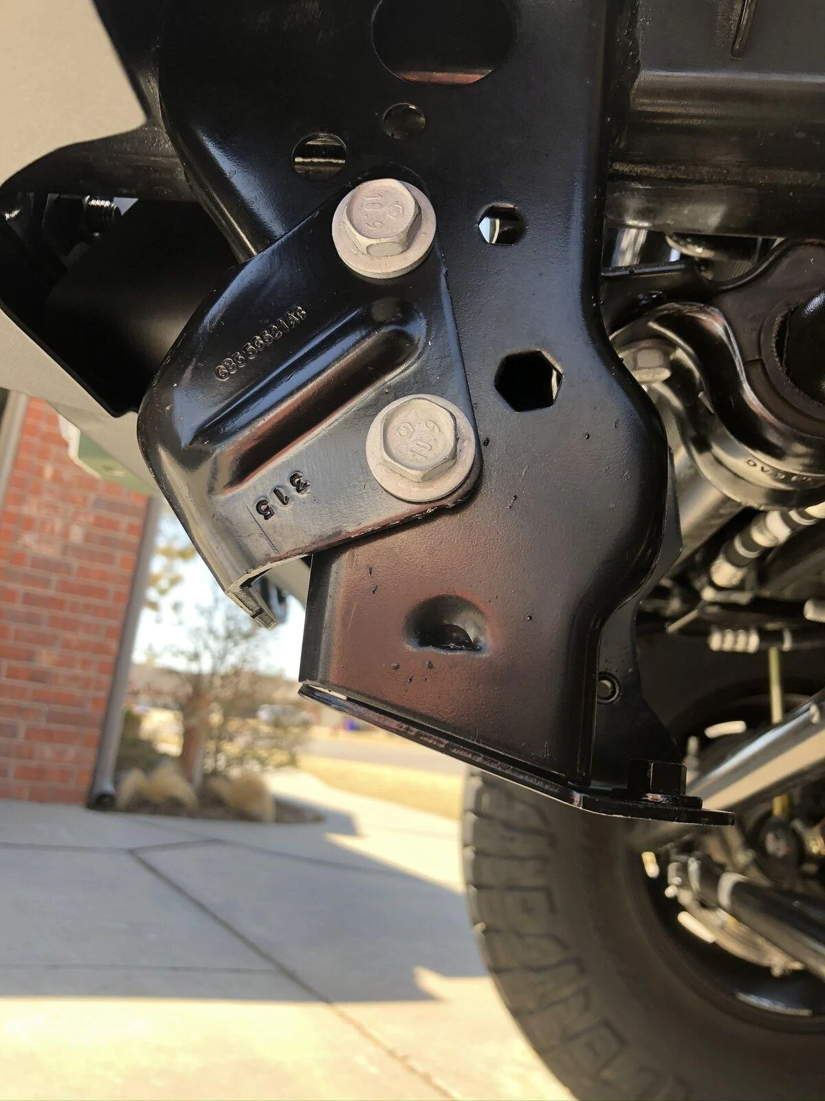

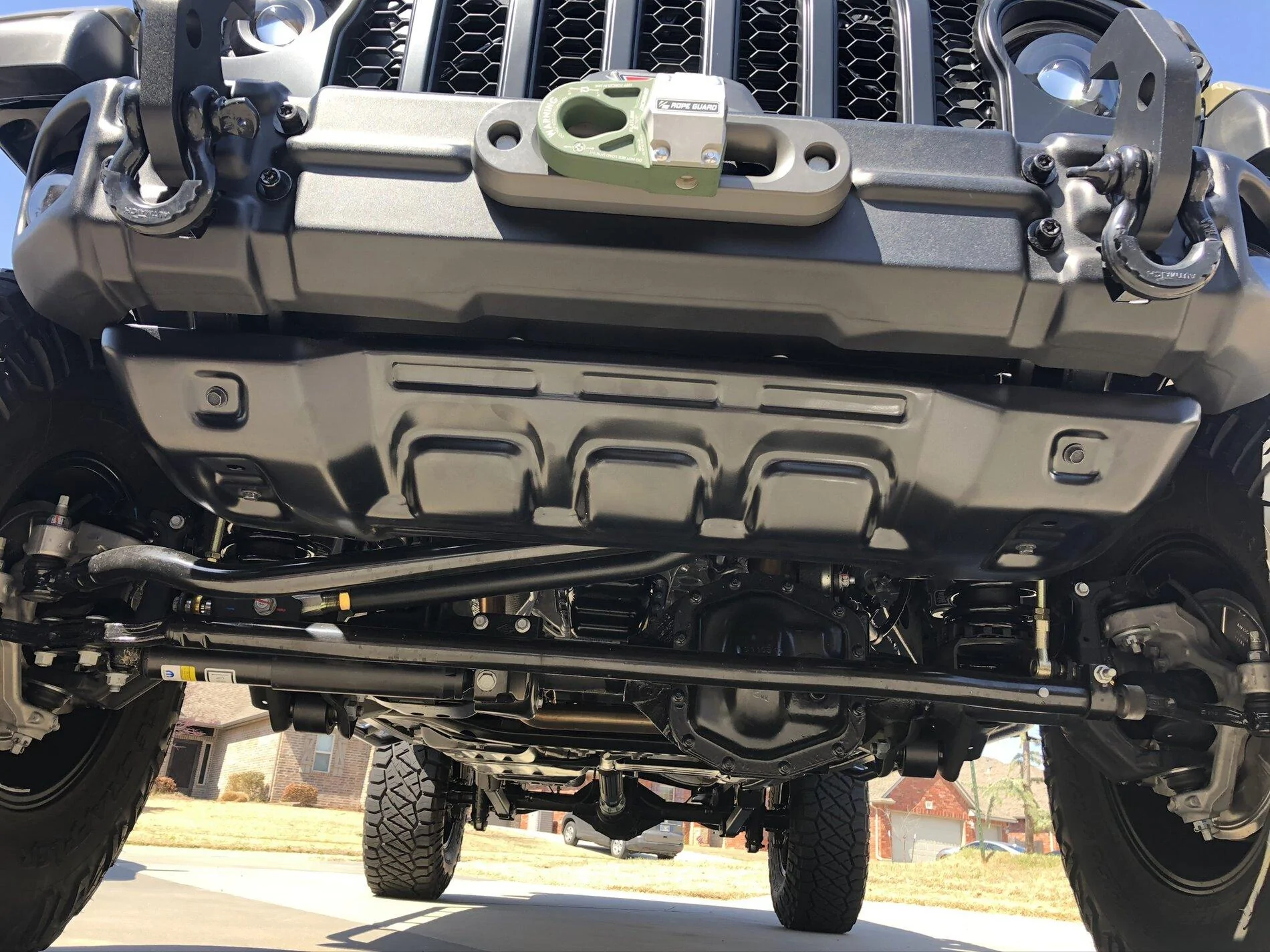

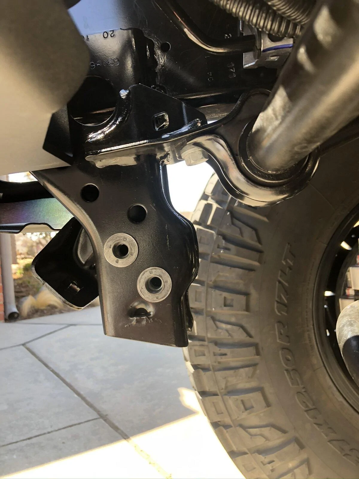

Did it on mine. Posted pics here somewhere. 4 brackets needed (2 each side) 8 nutserts and hardware.

Hey buddy. Looks very nice any chance you can list the P/n for the brackets?? I can get a correct number from the pic.

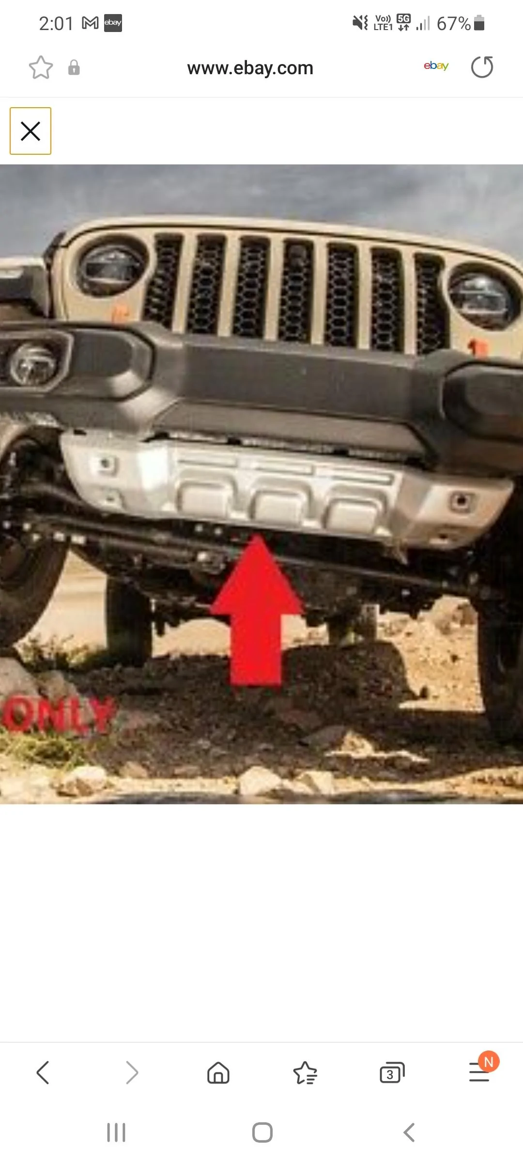

Il just upload a pic of the skid plate ive got, just want to compare is it the same as yours?
