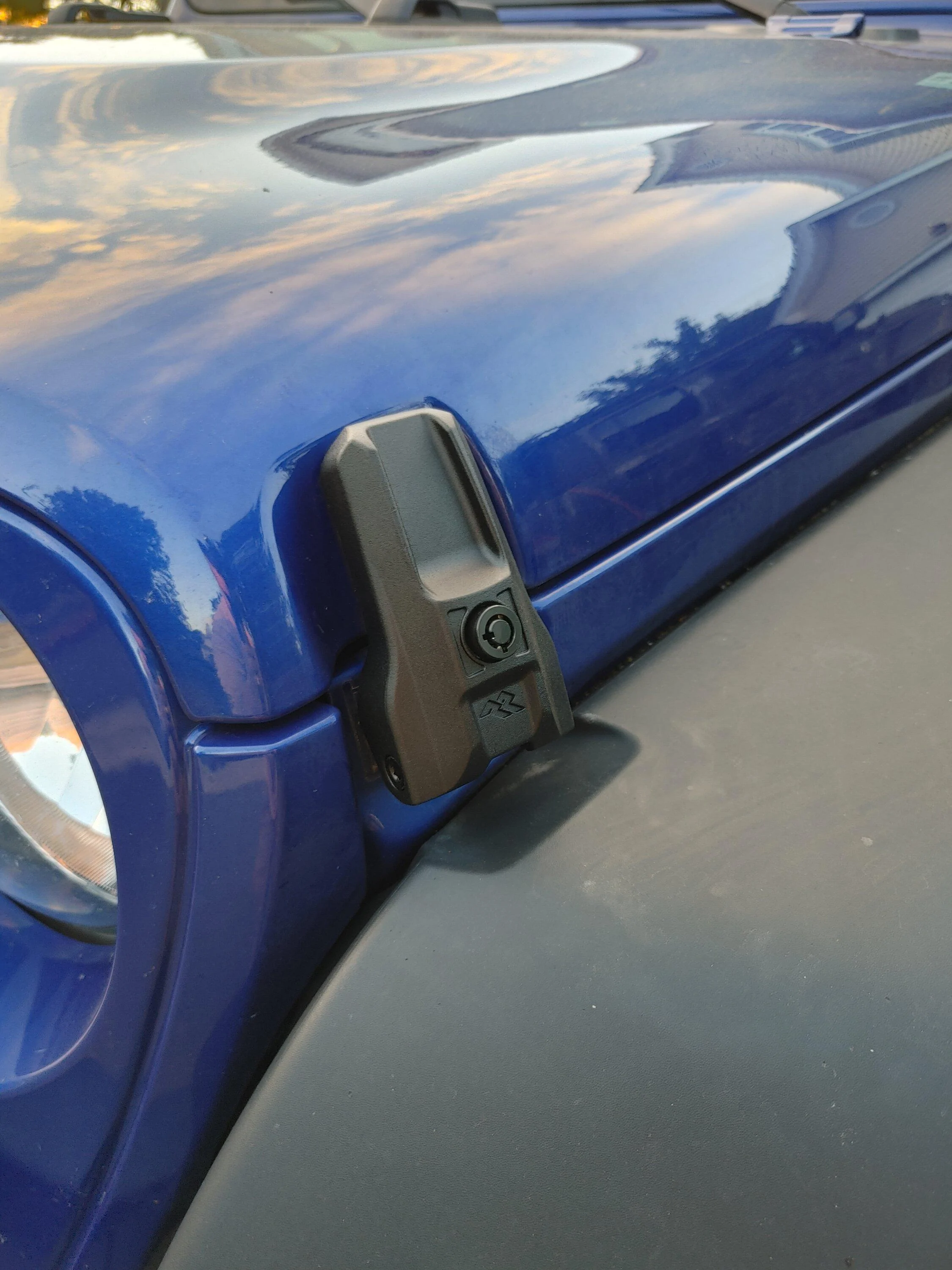

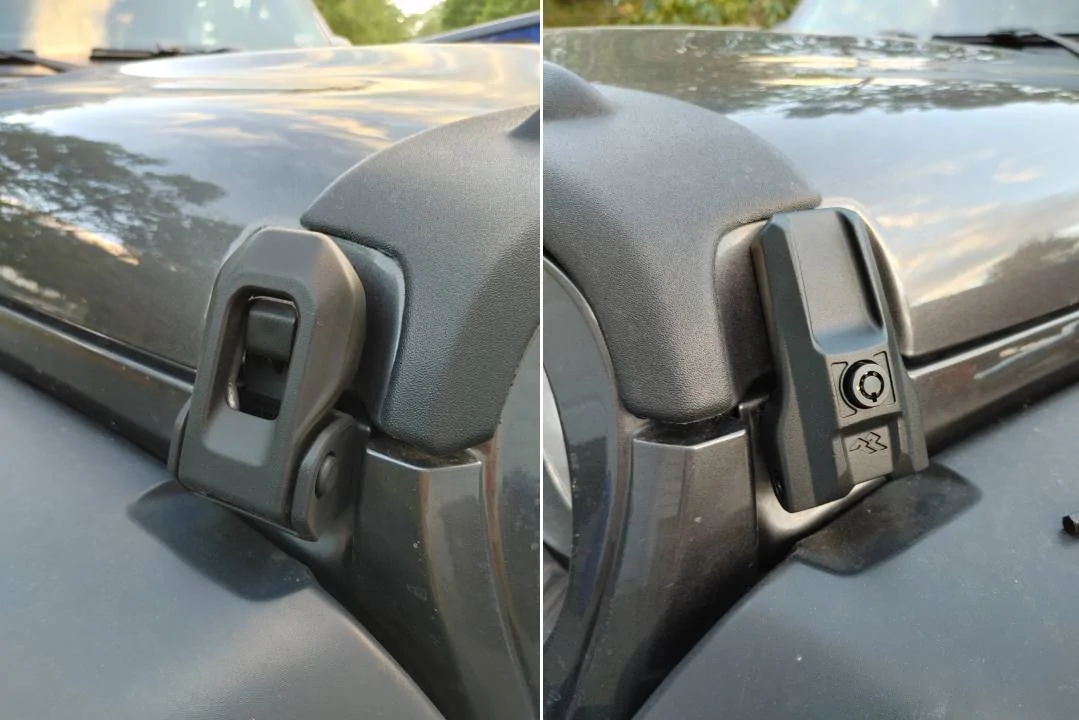

Jeep Gladiator Installation and Review: Rugged Ridge Locking Hood Catch New Project
[Side by side view of the stock hood latch and the Rugged Ridge locking latch.]
The install was quick and painless, the stocks are held in by a single bolt on the fender and 2 small bolts on the hood. The same goes for the Rugged Ridge pair. Including photos, the entire process was about 20 minutes. Instructions were good, but honestly this could have been figured out without them anyway. I used a size 10 socket for the hood and a 1/2" wrench for the fender where the room to work is sparce. Everything popped loose with little effort and removed by hand. You will need two hex wrenches but sorry I didn't mark down which size I used.

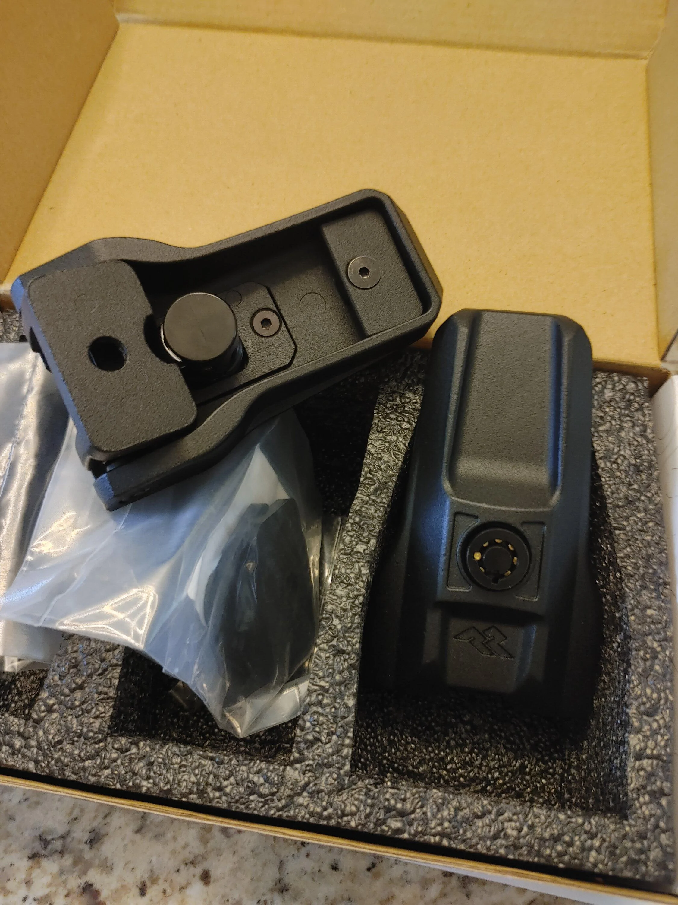

Jeep Gladiator Installation and Review: Rugged Ridge Locking Hood Catch 0618221851_HDR
[Everything shipped and packaged nicely with instructions and labeled bags, the latch was completely put together already.]

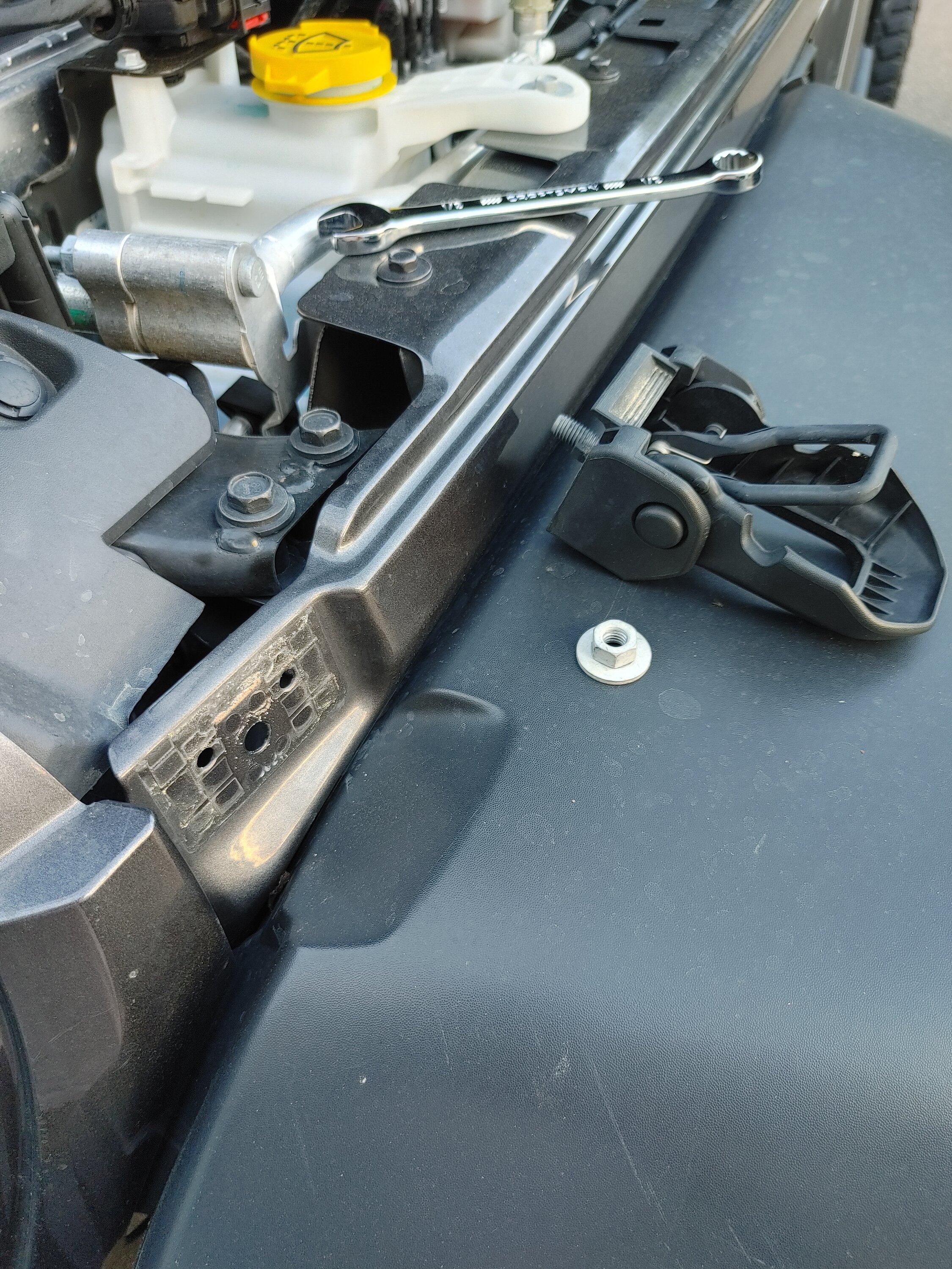

Jeep Gladiator Installation and Review: Rugged Ridge Locking Hood Catch 0618221931_HDR
[Removal of the stock fender mount.]

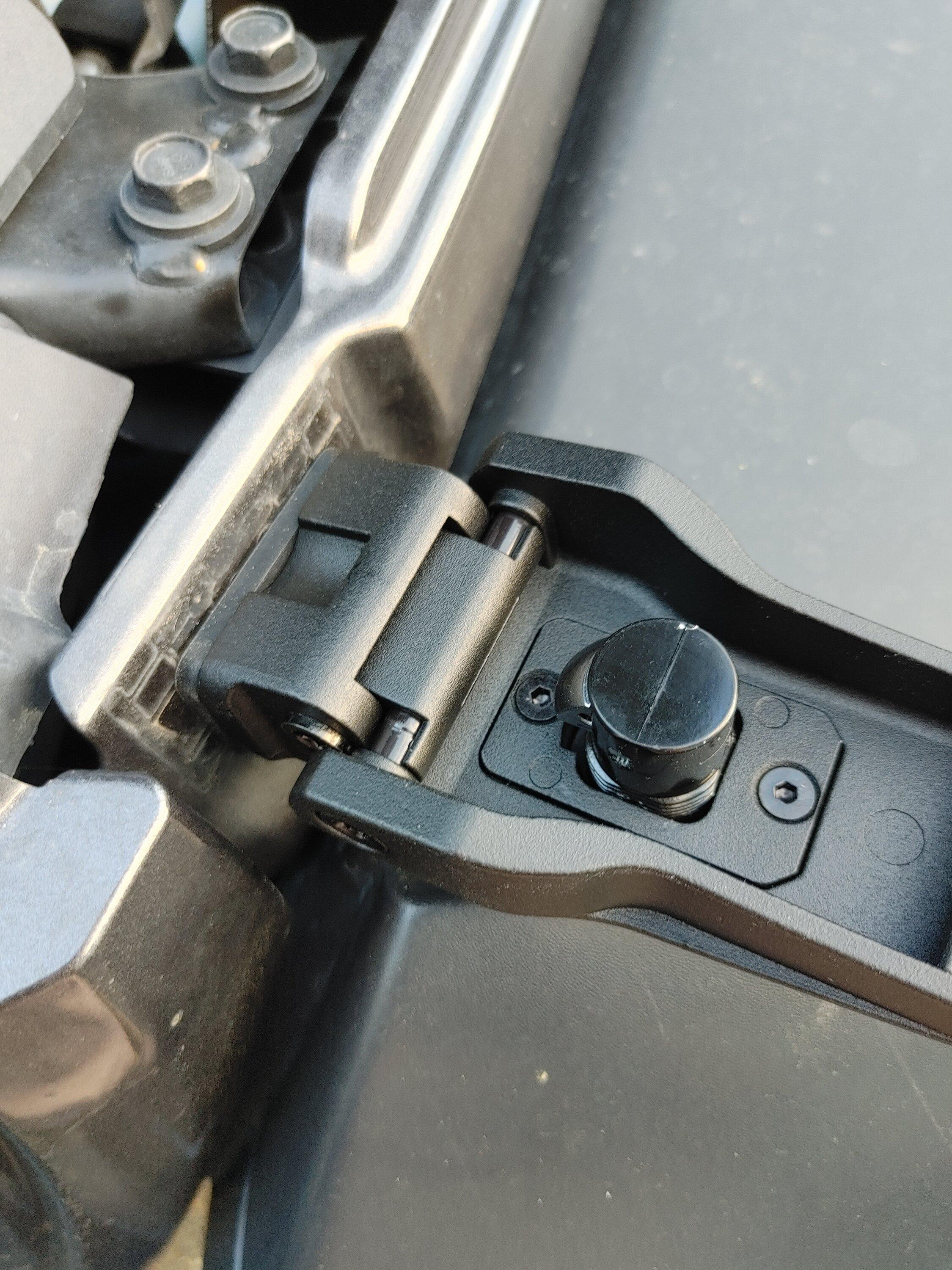

Jeep Gladiator Installation and Review: Rugged Ridge Locking Hood Catch 0618221936a_HDR
[An underneath view of one hex bolt.]

My plan was to use this one 2-pack to lock both hoods of my JT and JL, after seeing how closely they appear to each other and not like a "sore thumb" that's exactly what I did. Here it is pictured on my wife's Wrangler, the process was identical.
Jeep Gladiator Installation and Review: Rugged Ridge Locking Hood Catch 0618221958_HDR
Overall I am extremely happy with the build quality and I think it will work as intended to keep the hood closed and safely locked away. Hope this helps!

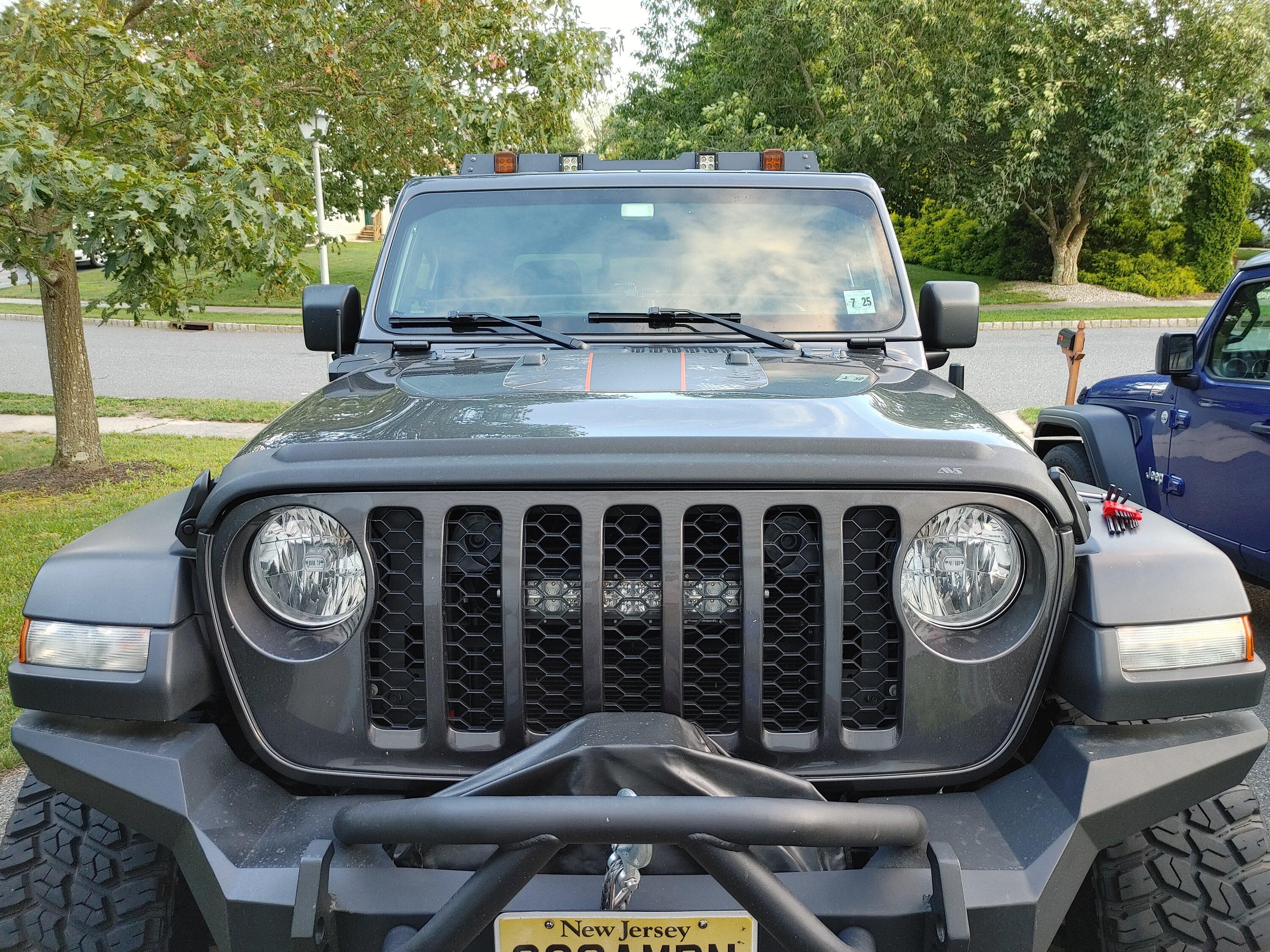

Exactly what I have, solid product! Just like their bumpers, love the HD Shorty
Jeep Gladiator Installation and Review: Rugged Ridge Locking Hood Catch 1655603410732

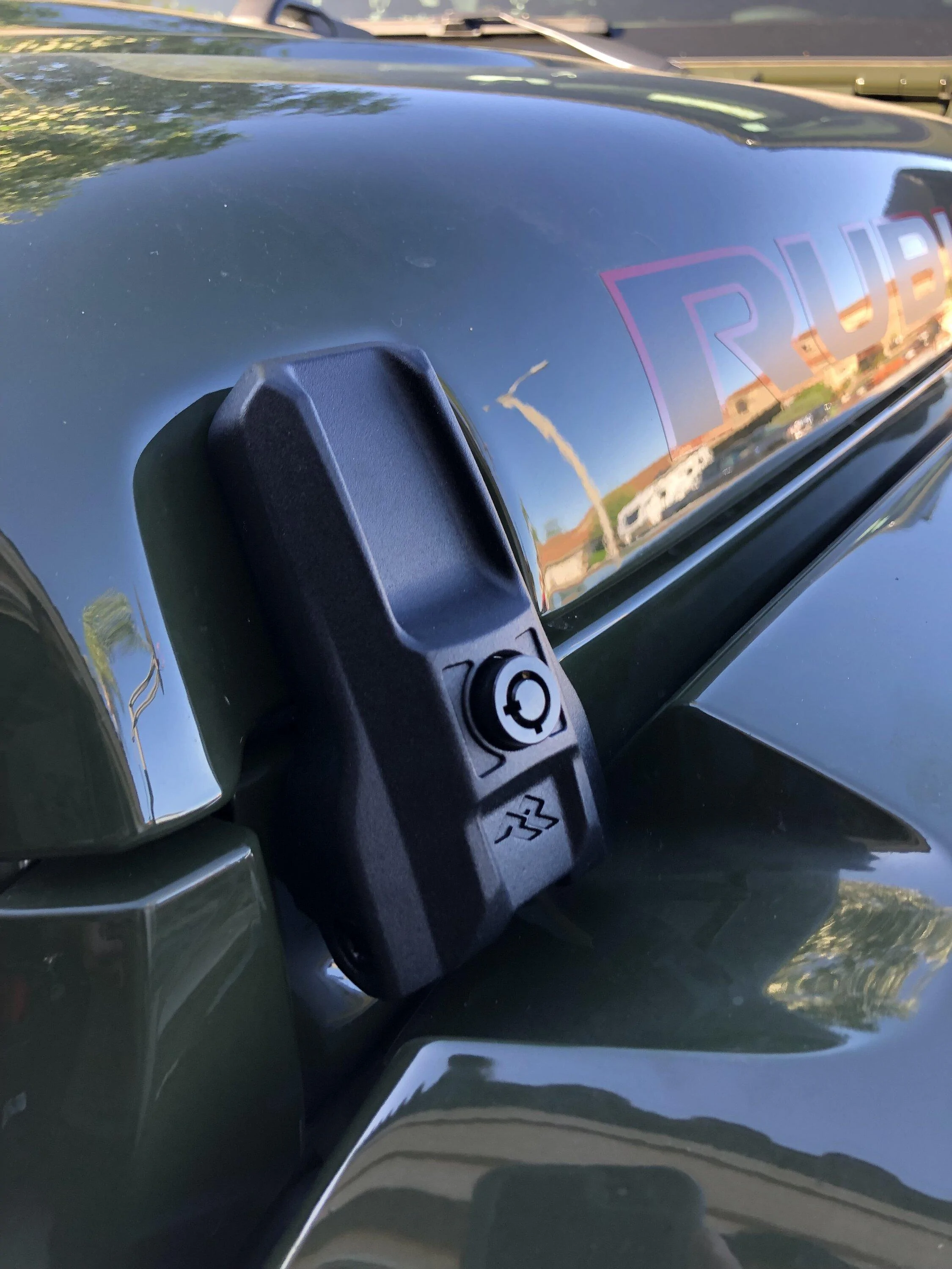

Yep, Rugged Ridge clearly uses the same powdercoat for everything. Which is perfect for keeping a uniform look.

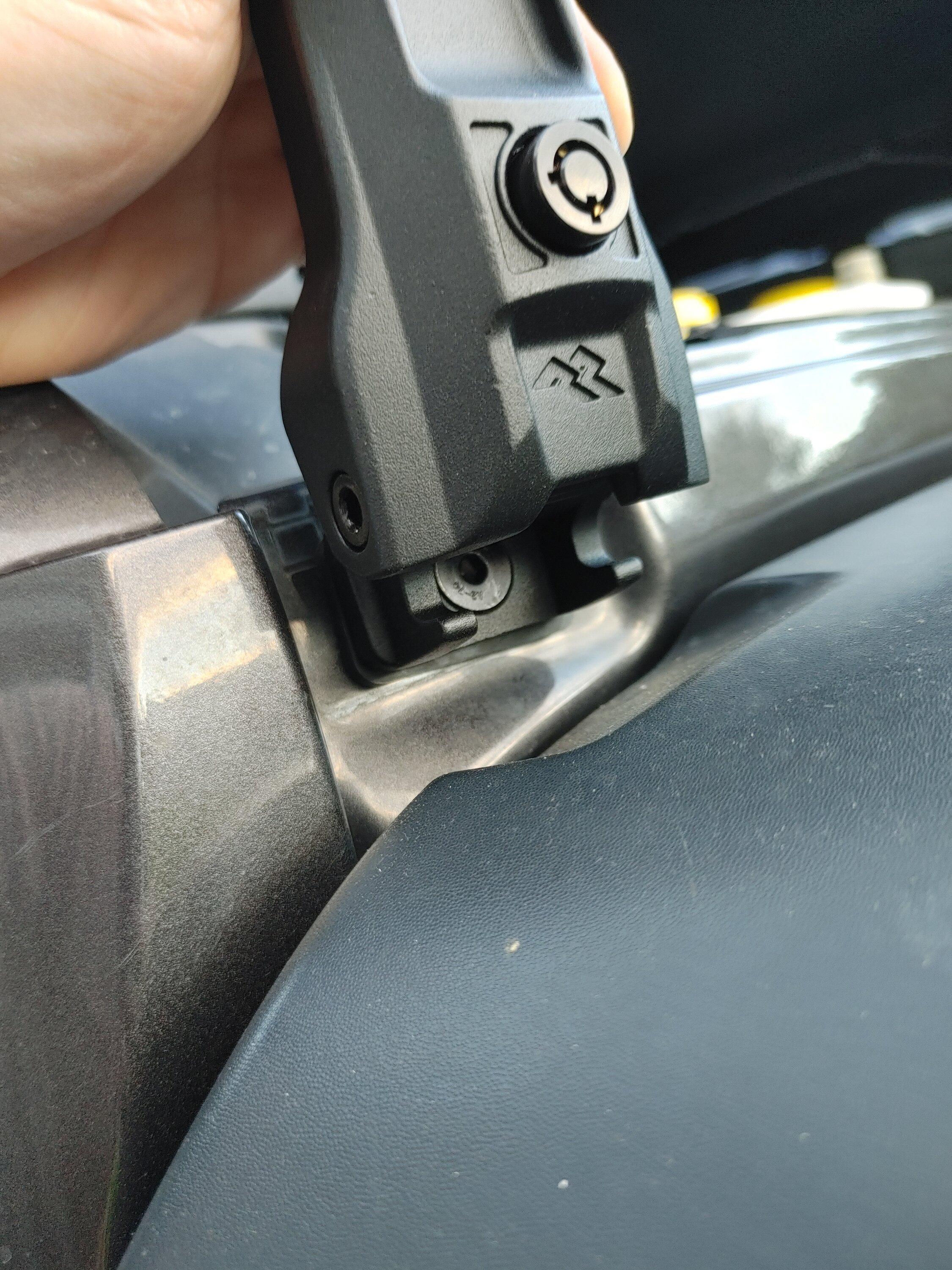

You just have to get used to pressing the release button (unlocked of course) to swing the latch up to release the hood catch.
True haha, I was just outside explaining it to my wife. It took me a second to get it because you want to move it like the stock ones.

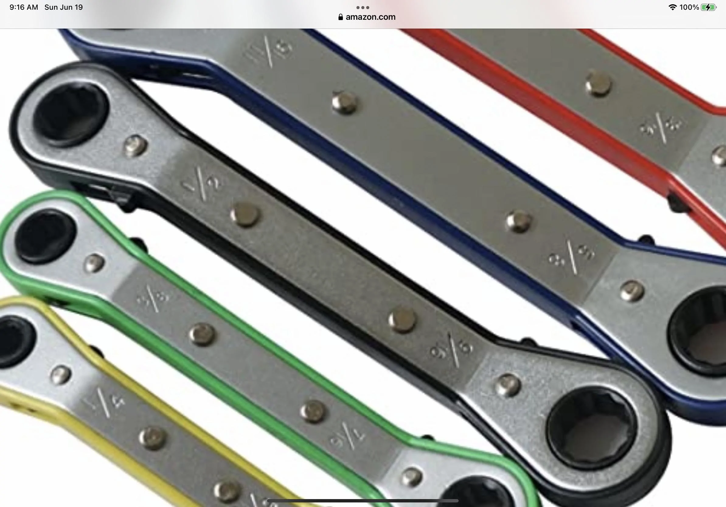

My straight wrench actually worked perfectly fine. But, I have an update!
