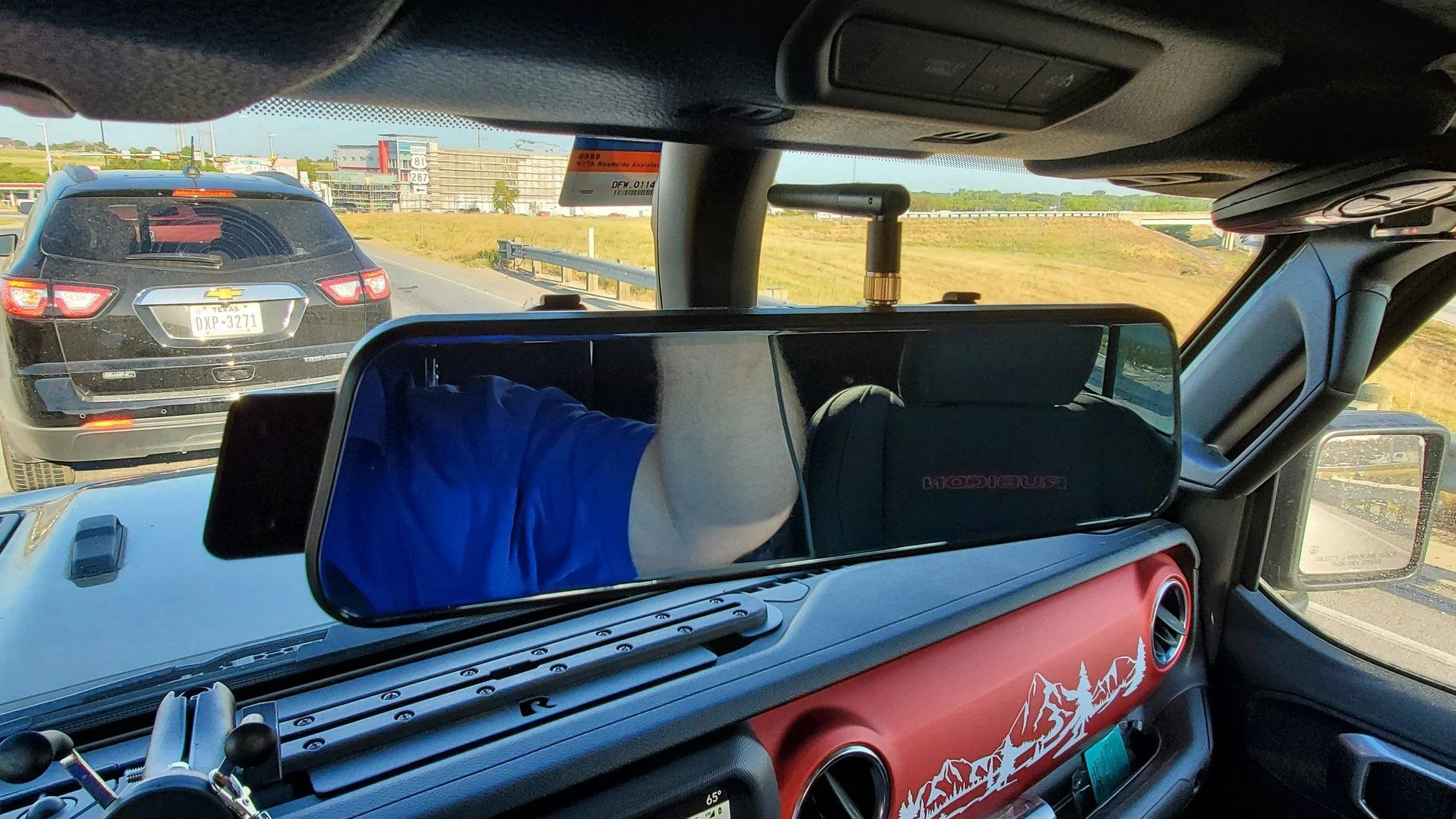

Wanted to show you guys an alternative trailer backup cam that I just picked up. I had been trying to figure out a way to add a backup camera to the trailer to display on the head unit. I don't have the front trail cam, which means I don't have the video processor either to tap into. The OEM backup camera uses Fakra connections so finding adapters that work is not easy. I contemplated buying the Z Auto front cam and using the video input with a splitter but ultimately decided to buy a Haloview camera setup. It's an add on screen that goes over the factory rear view mirror and has a single wifi camera and a front dash cam. The whole install took about 30 minutes. On my trailer I have Furrion pre-wire mounting plate and power, so the camera mounts to that, it and the wifi transmitter is powered by the furrion adapter. The mirror comes with a cigarette lighter adapter but I am eventually going to tap into the overhead power for a cleaner setup. Here are some pictures of the setup.

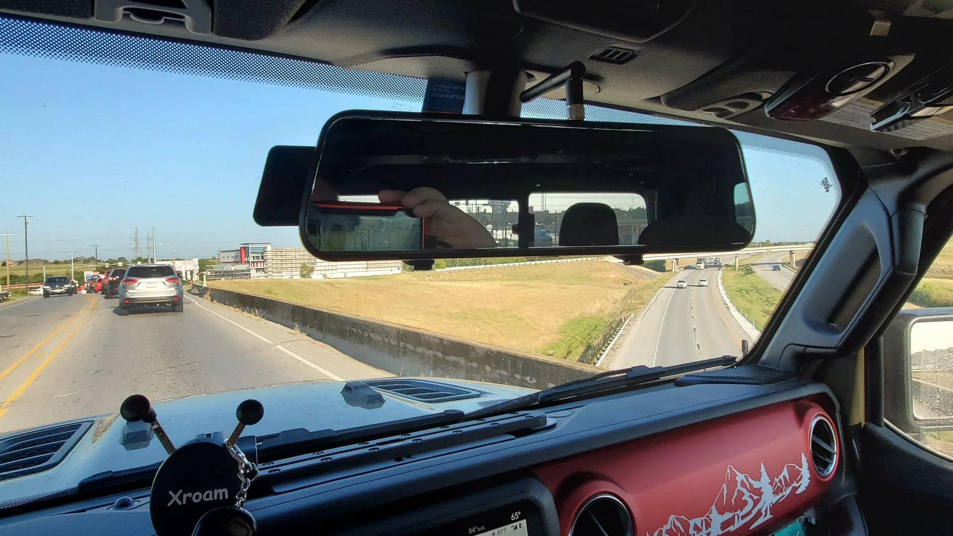

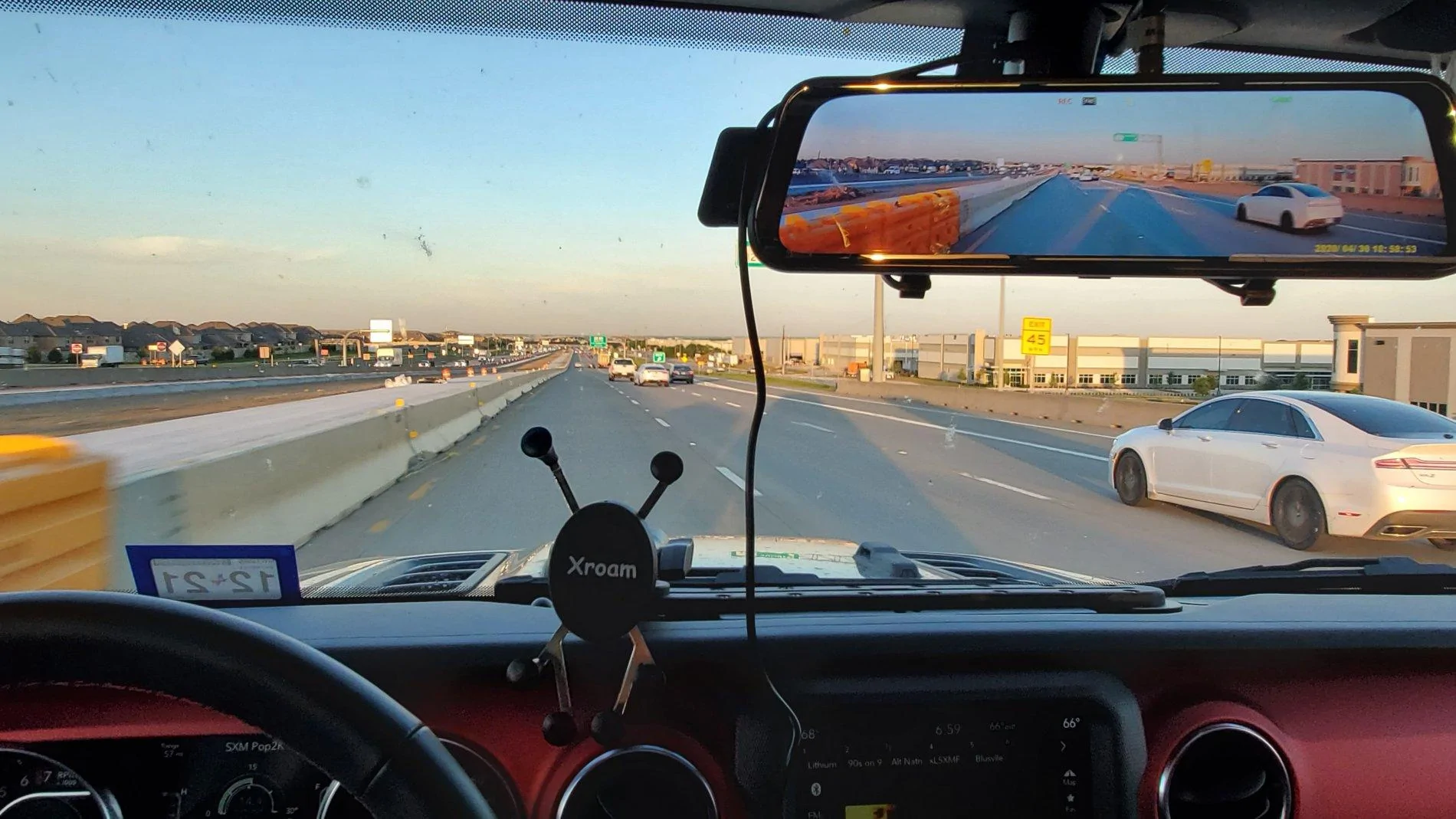

Driving to work this morning with the dash cam function.

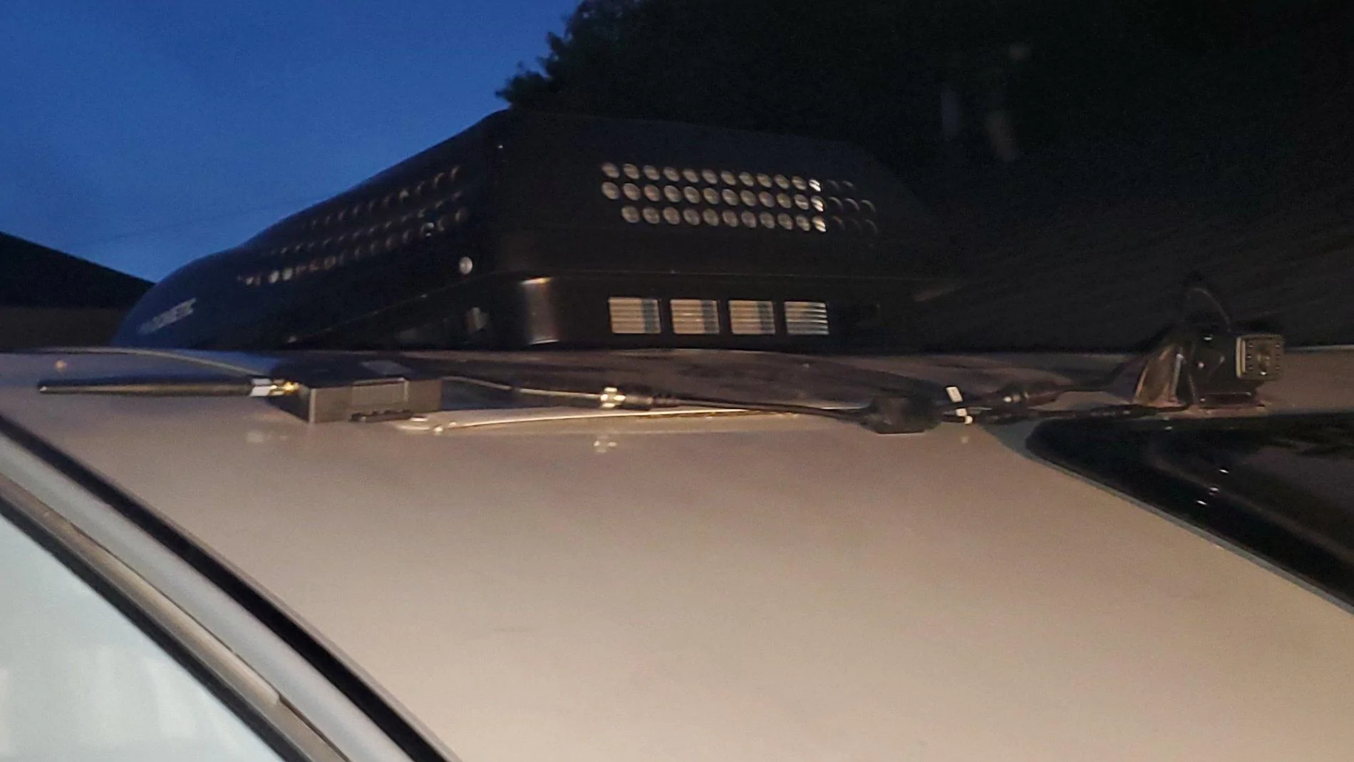

The transmitter and camera mounted to my furrion prewire.

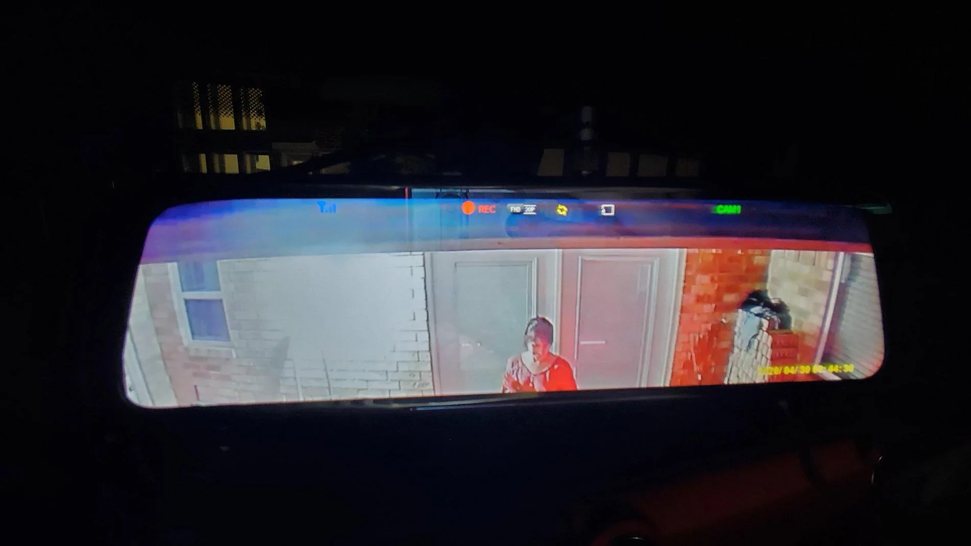

Sorry for the poor picture, I backed my truck up and plugged in to give the camera power and test. My trailer is about 5 feet from the back door.

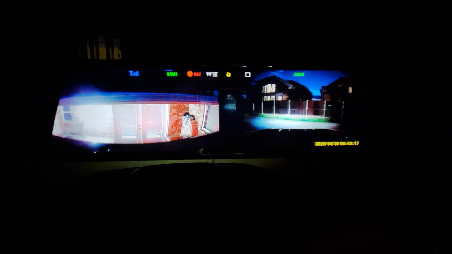

Here is the dual cam function. It also records front and rear cam apparently.

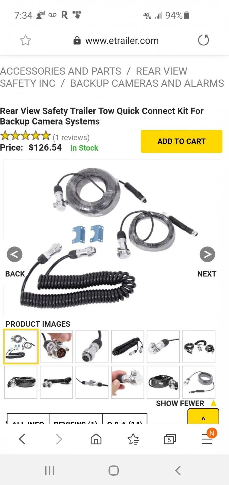

The tazer front cam utilizes the low def cargo cam input, which is not the same as the hd oem input. If you bought fromt cam from the factory there is a video processor mounted behind the rear seat, maybe could split that but im not sure since i dont have it to inspect. As it is my setup without front cam the backup cam plugs directly into the rear of the head unit. I found fakra to rca adapters but they dont seem to work. There are specfic type of fakra plugs and i cant seem to find the video (type E? I dont remember) to rca. I had bought this other wiring setup but couldnt tie it in without getting z auto front cam wiring which is why i went with haloview. 30 minute install for a decent solution.

yes it has some rubber straps and mounts over the existing review mirror.
It has a forward facing camera/dash cam, so it will either record and project forward image or there is a button to turn off the screen and it will act as a regular rear view mirror. press the button again and it turns the monitor back on.
I've seen several systems with monitors, the other haloview products included, but with as little windshield space as is and already having my phone mount I didn't want more obstructions. I tried connecting to the OEM 8.4 but without the Z-auto front cam that wasn't an option either because the Fakra connections make it difficult.
It was about $330 or so, and so far I am really happy. They have other systems (regular monitor not the rear view monitor) that can utilize 4 cameras and that would be nice in this set up using this monitor.
The only thing I dont like is the mount itself, since I have a teardrop I've realized while using it the angle of the furrion and the bracket I can't actually see the trailer's bumper and know where it is exactly, so its more of a general backup cam. I may make a new bracket that projects the camera out and down a little more so I can have better rear view but thats specific to my trailer.

This looks cool, do you have a pic of it with the cameras off, just the mirror?
