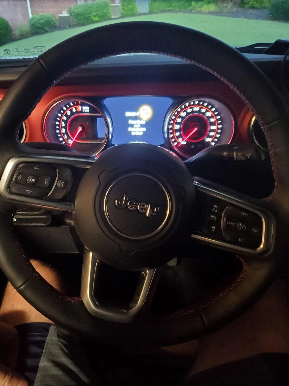

Installed Clayton 3.5" and my steering wheel is so far off center

No amount of adjusting the drag link is re-centering it. I adjusted all my track bars and control arms to the recommended lengths. Will it be more centered after a proper alignment or do I need to unbolt the steering wheel to center it? :LOL:

This is as straight as I can get it. And the service stability light are all still on.

What you are showing in the picture is the drag link is too short. Did you replace it with a longer adjustable drag link? I don’t know if this lift height requires this or not. So, try this:
Pay no attention to the steering wheel for a moment and focus on the position of the front wheels. Straighten the front wheels. Use the track bar adjuster to center the front axle. Start the engine and turn the steering wheel to the left or right until you hit the steering stop. Now turn it all the way to the other stop, carefully counting the number of turns lock to lock including any fractions of a turn. Turn the steering wheel back the other way exactly one half of the turns you counted. The steering wheel should be centered, but the wheels off to the left or right. Can’t say which as I don’t know how much adjustment you made previously.
Observe your front wheel position. If they are turned to the left, the drag link is too short. If to the right, the drag link is too long. Now center the steering wheel and adjust the drag link. If you run out of adjustment and the drag link is still to short, replace it. If you don’t, your steering box will not be centered while driving straight and it will wear out much faster. Good luck!

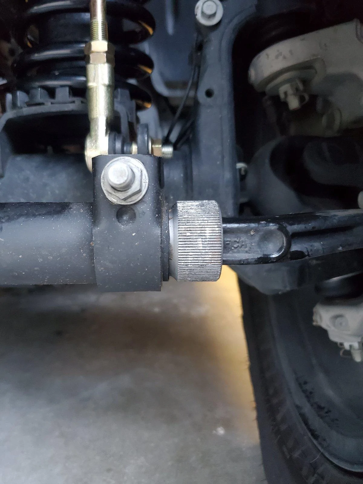

wow...thanks
I was adjusting the tie rod, not the drag link...ugggggg:facepalm:
Dont feel bad... Adjusting the wrong this is the best possible outcome as it means no more $ outa pocket for the project.
