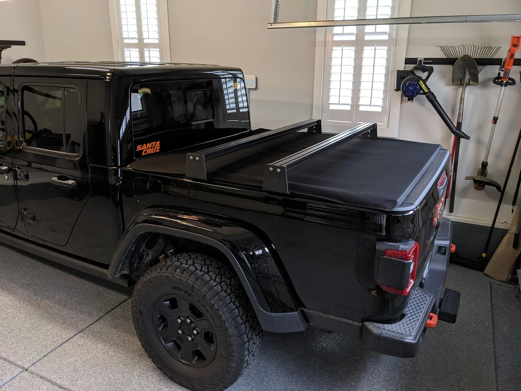

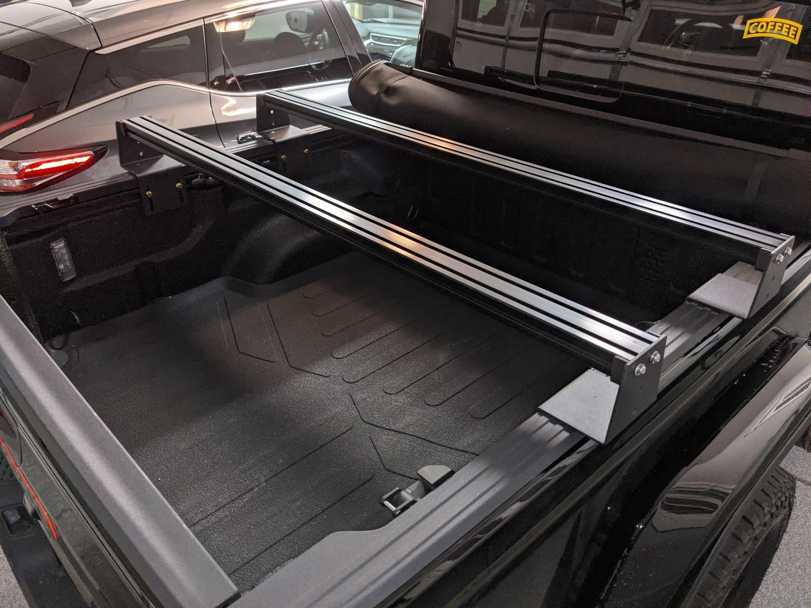

We wanted to cover the (easy) steps to install the billiebars to our 2021 Mojave with a rolling Mopar tonneau cover. We do not have an affiliation but their product is great. Install time is about 20 minutes (if you have the proper security bit).
NOTE: We have the cargo management system on our jeep

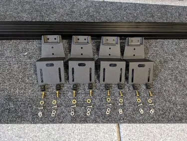

STUFF YOU GET:

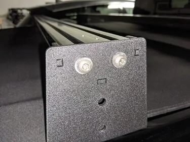

  1. crossbars (2) with hardware (requires a TT40 security bit for your drill/ratchet)
  2. Rises (4) with mounting hardware
Jeep Gladiator Installing Billiebars on 2021 Mojave with Mopar Tonneau Rolling cover 125997-24fab6915ea9b51f4499497ac24bdf02
STUFF YOU NEED:
  1. TT40 Hex security Bit
  2. wrench or other drill to tighten risers

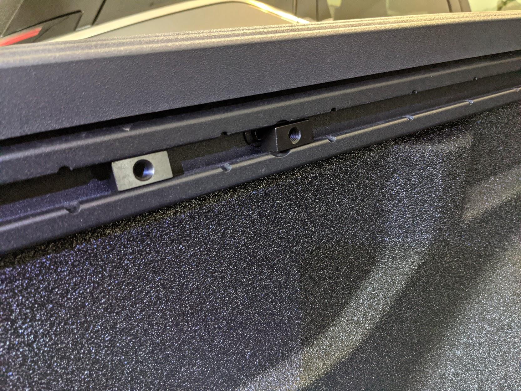

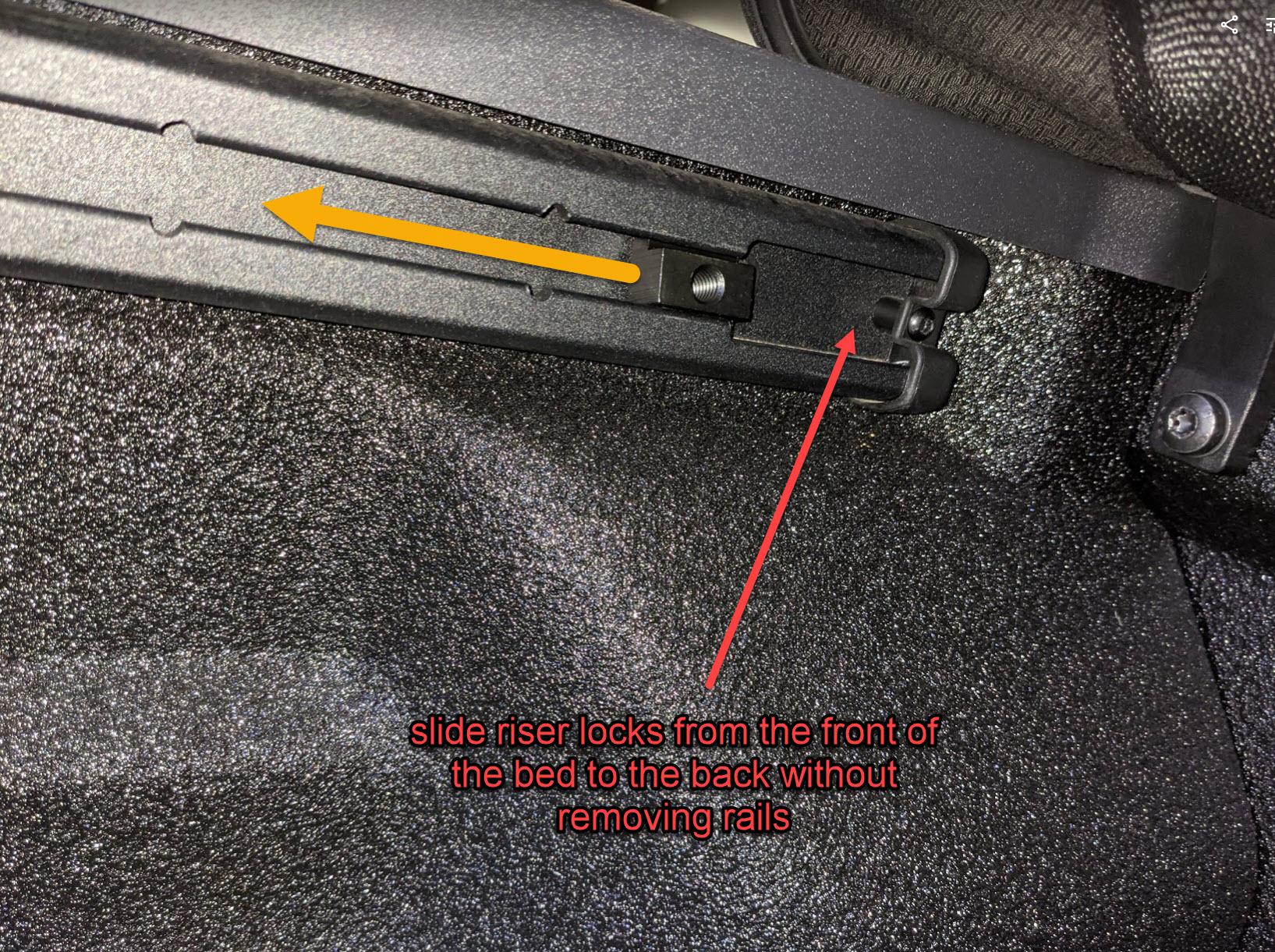

Remove the cargo holders if you need to realign and slide in the riser guides to the rail system (if required). At the front of the rail system (closest to the cabin) you can slide these out without removing the rail :)

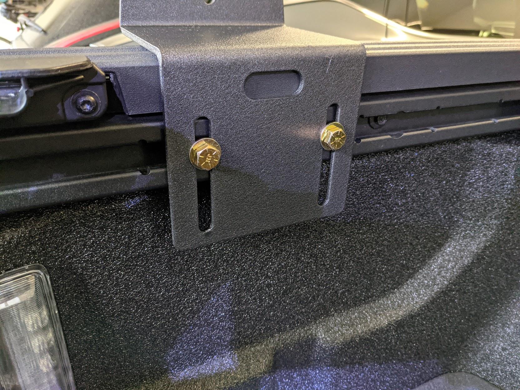

Once they're slide in, line-up risers and install bolts - do not tighten until both sides are aligned (use the rail system notches)
Jeep Gladiator Installing Billiebars on 2021 Mojave with Mopar Tonneau Rolling cover 125995-6513ffcbd9ef8c483e1b83743c65f621

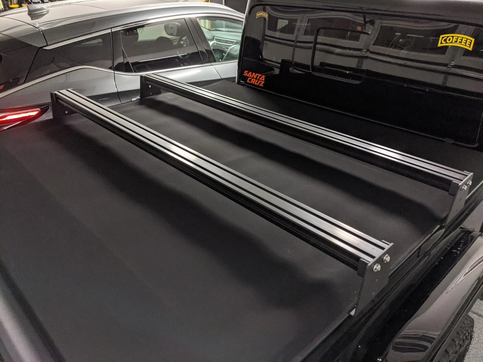

Once the rails are aligned, add the cross beams and tighten the security screws and lock washers

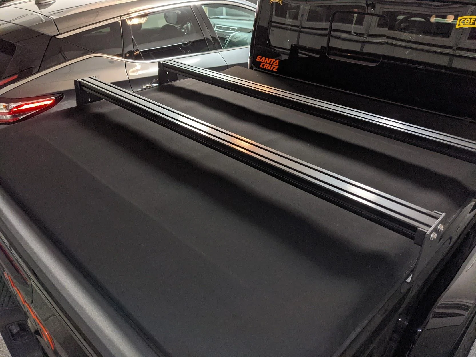

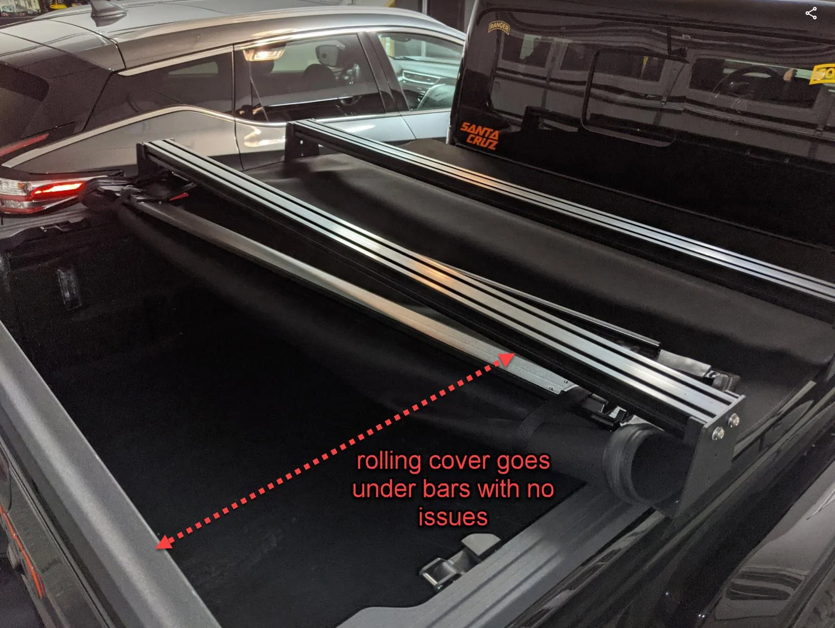

Below is our Mopar Tonneau cover - we can open it without removing the rail system but keep the socket in the jeep to slide and reset rails to other locations as required. Note the cover is new so it's a little tight down the sides but we haven't seen water in the bed yet even with the smaller gaps since there is no velcro and the rubber seal overhangs the edges (which is why we went with the mopar top instead of a 3rd party).

I have been looking at the Kb Voodoo and the Billiebars. This helps answer a lot of questions I have had about them.
Thank you for the post!

No problem - I think maybe the KB VooDoo is less expensive but the Billiebars are heavy duty - You can probably check the stress limits on their site but I think there are few videos of guys standing on theirs with no issues (not that it is a real test) but at least for a tent with 2 people seems good to go.
