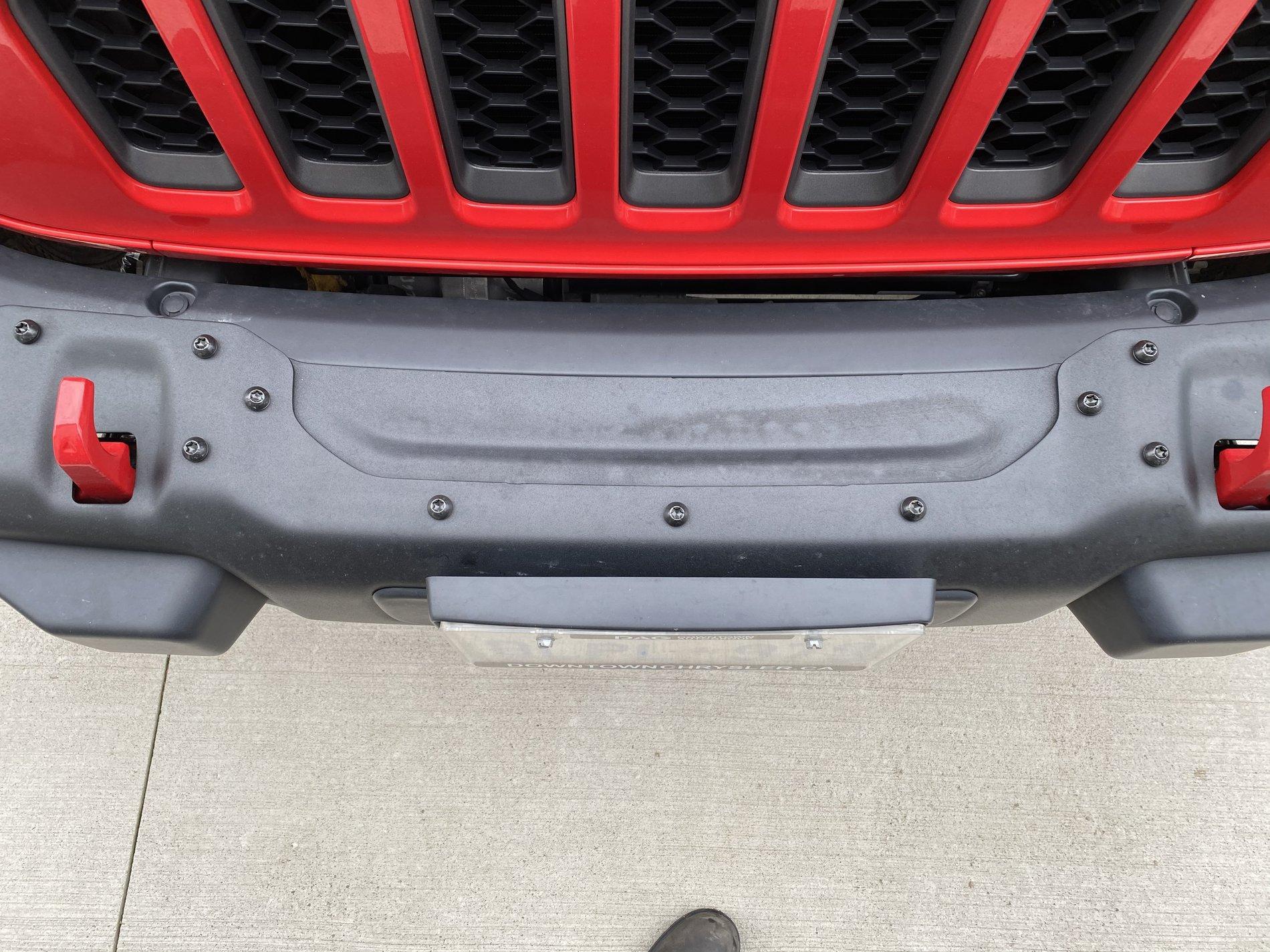

Before I installed it I noticed my bumper has an extra bolt on either side inside of the mounting points:
Has anyone installed on of these?
Do those bolts simply rest inside the “hole” of the bar?

The instructions do not show the other bolts, the mount flange and tube goes over them.

Also grab some nuts for the 3 bolts that go in the front of the bumper where the plate comes off..
Reinstall the bolts with nuts....
Looks much cleaner than 3 open holes..

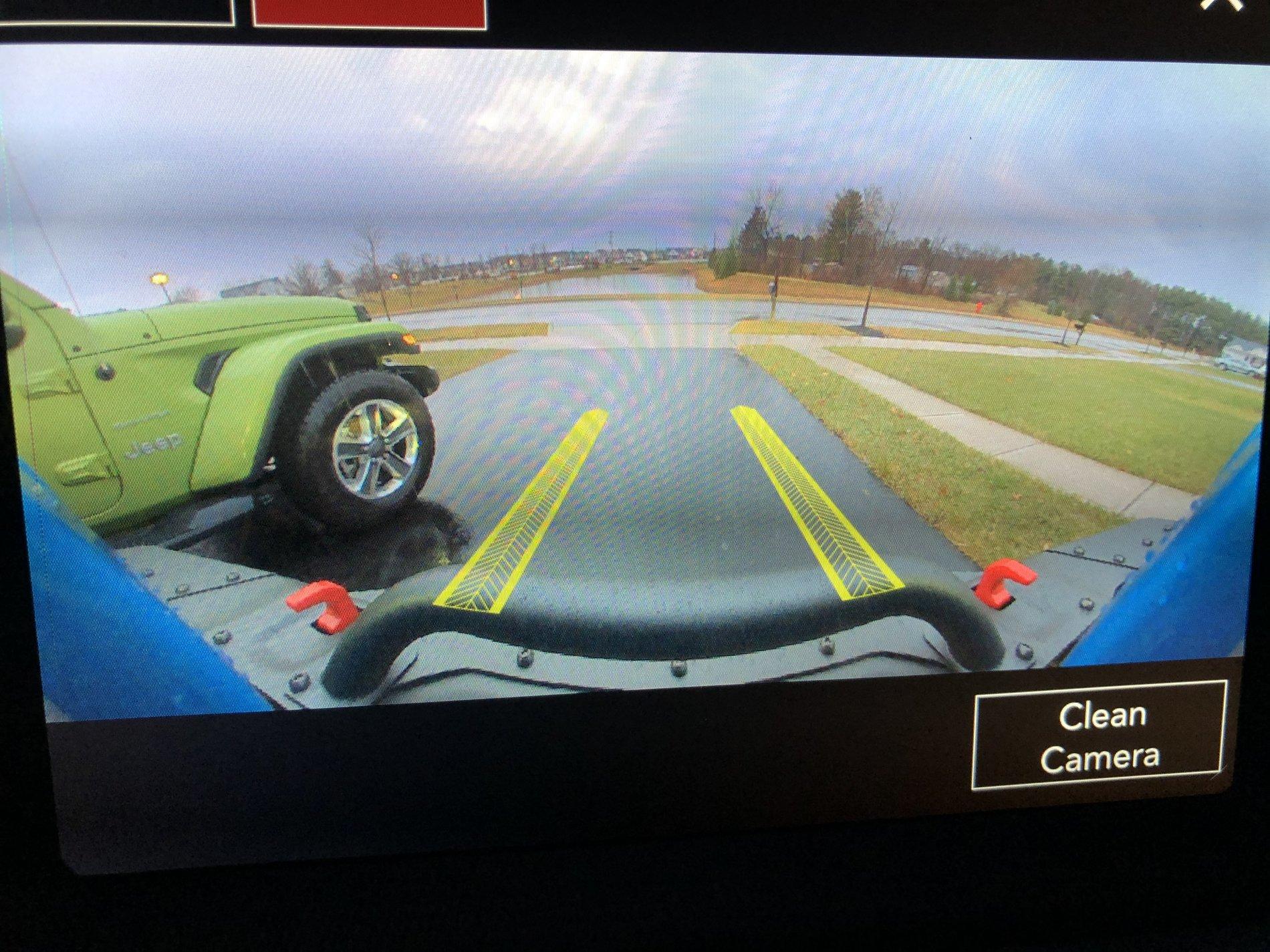

Has anyone with the front camera installed one of these? I really like the grille/winch guards, but I want the camera to function for off-roading. It seems like the view would be blocked

Yes, here is a photo with the Mopar guard.
