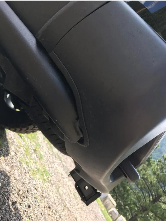

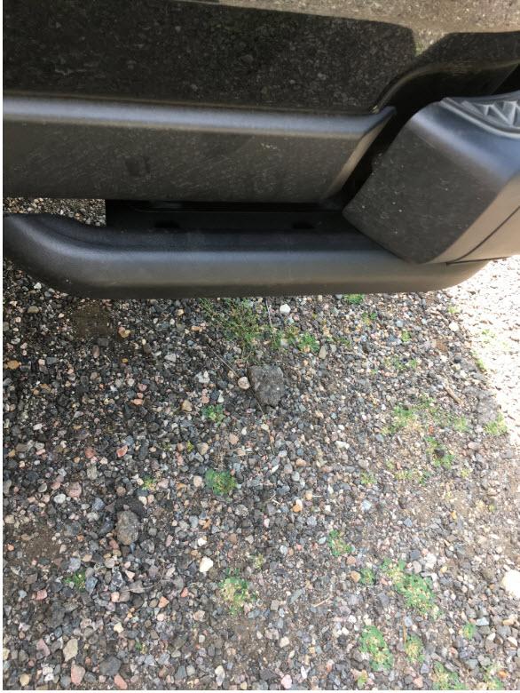

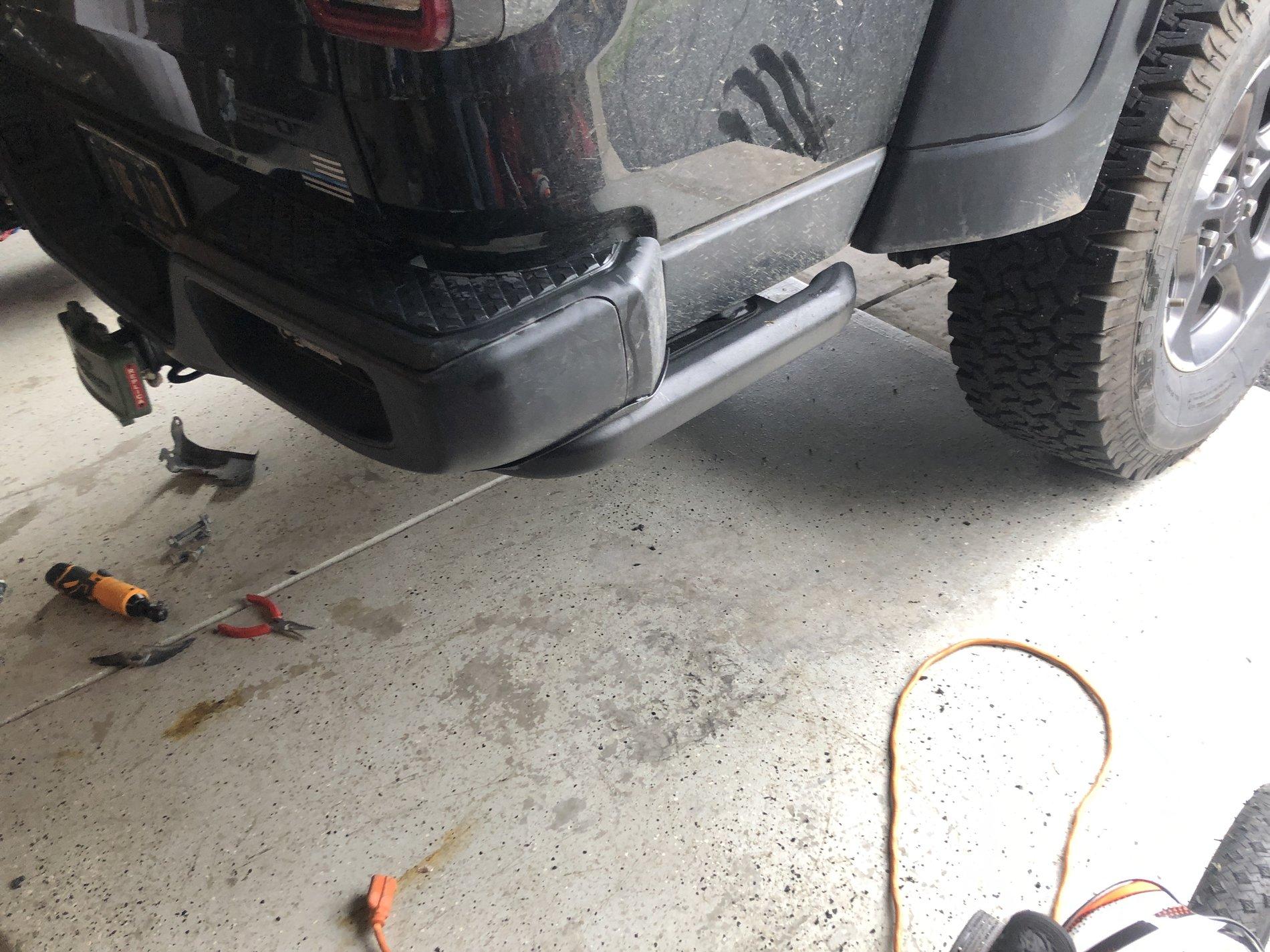

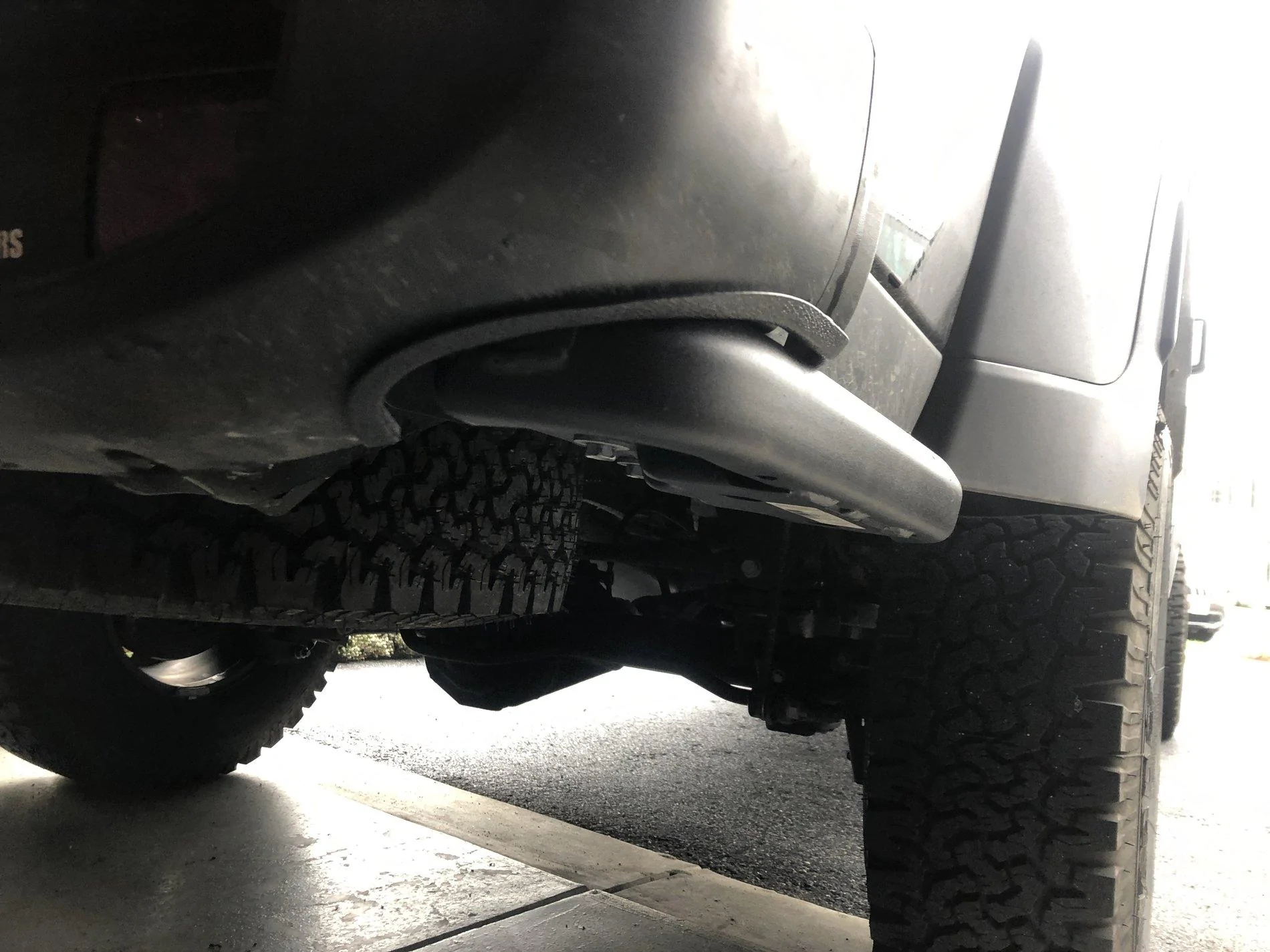

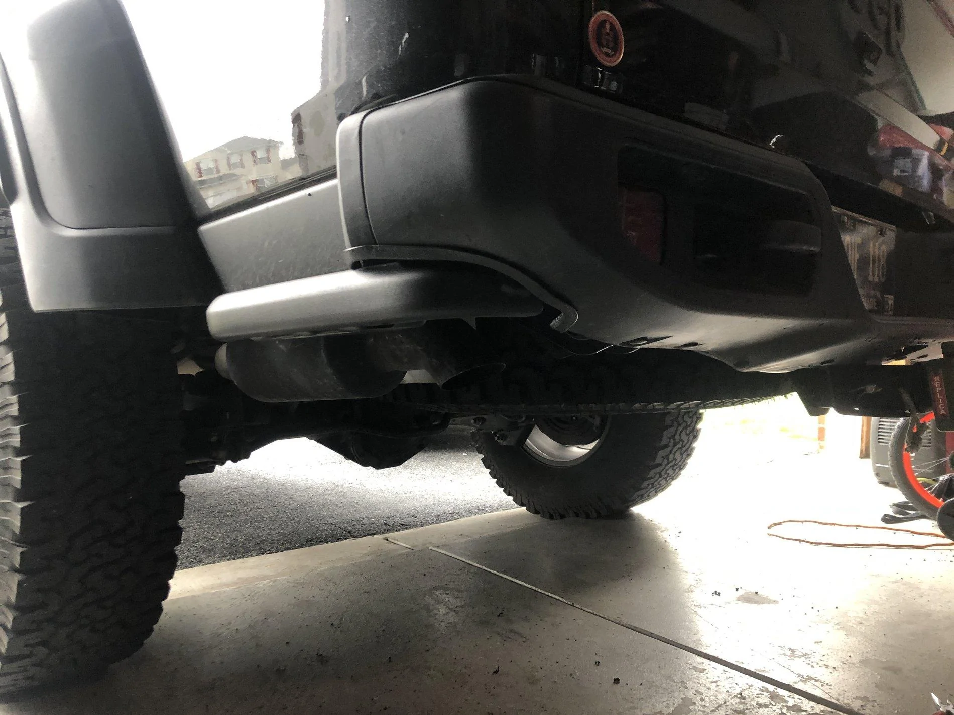

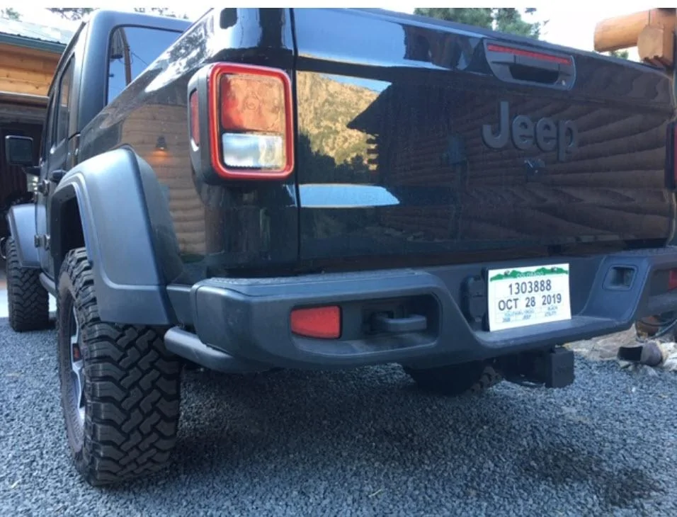

If anyone is wondering if the Mopar Jeep Rear Bed Rock Rails will fit the Sport and Overland Models, they will with a little work..

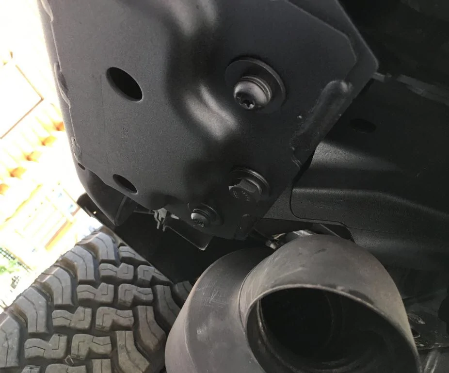

There are 4 pieces to the rails, 1 frame bracket that attaches to the frame with 3 bolts and the Rock Rails themselves attach to the bumper with 2 bolts and 3 bolts to attach to the frame brackets.
The frame brackets were easy to find, the actual Rock Rails not so easyā¦
They obviously donāt come with any bolts or instructions.

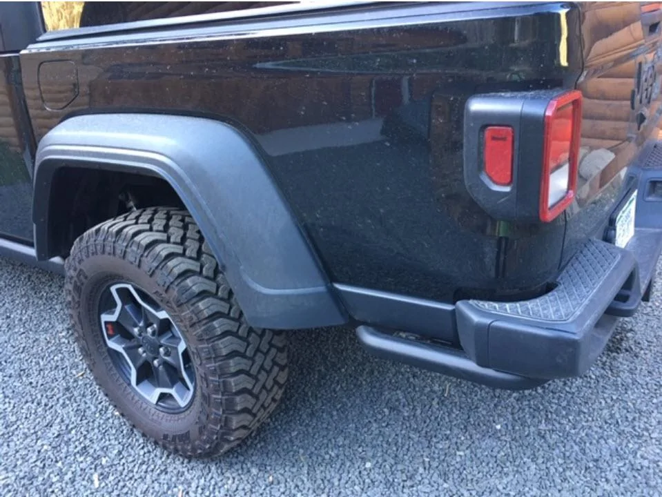

I wanted the rails for some protection, but primarily wanted to fill in some of the Gap at the back of the Bed.
I always liked the look the Rails give the JT.
My guess is most after market rear bumpers will fill in the area the Rock Rails use now, and probably incorporate some type of step. *Rubicon owners in some cases might have to remove them if they go to an aftermarket Bumper.
I plan on staying with the stock bumper for now, so this was my best option. *Just about $400 for everything, which is a expensive for what it isā¦*

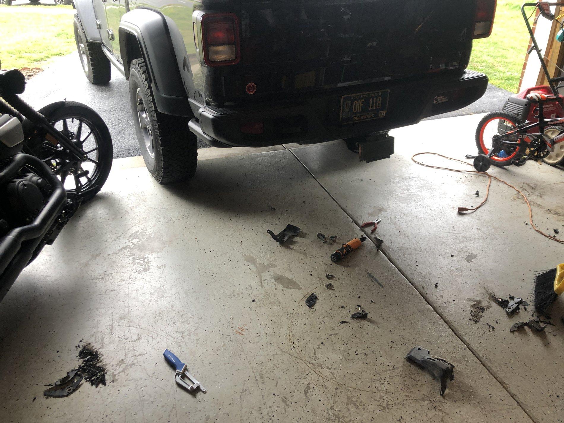

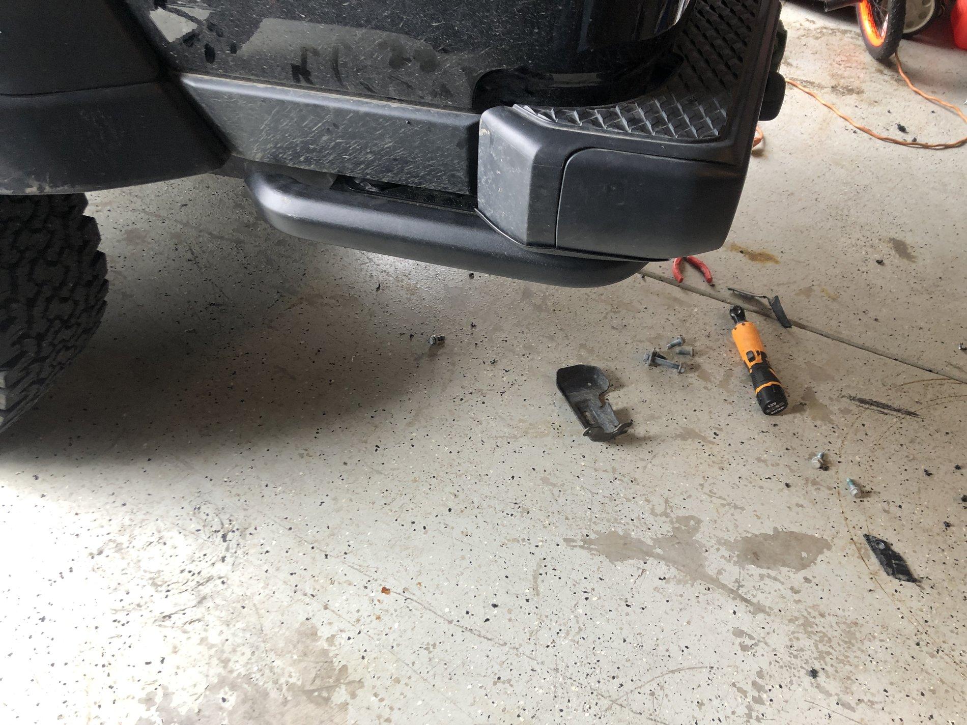

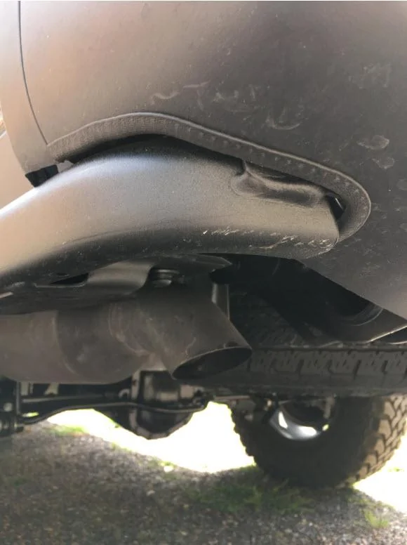

The one difficult part is trimming the bumper to accommodate the Rock Rail. You have to trim off about 3 inches in the pattern of the Rock Rail.
You also have to remove 2 brackets, 1 metal and one Plastic, on each side of the bumper for the Rock Rail to attach. The Rock Rail replaces these brackets.
If anyone else decides to do this here are a few suggestions.

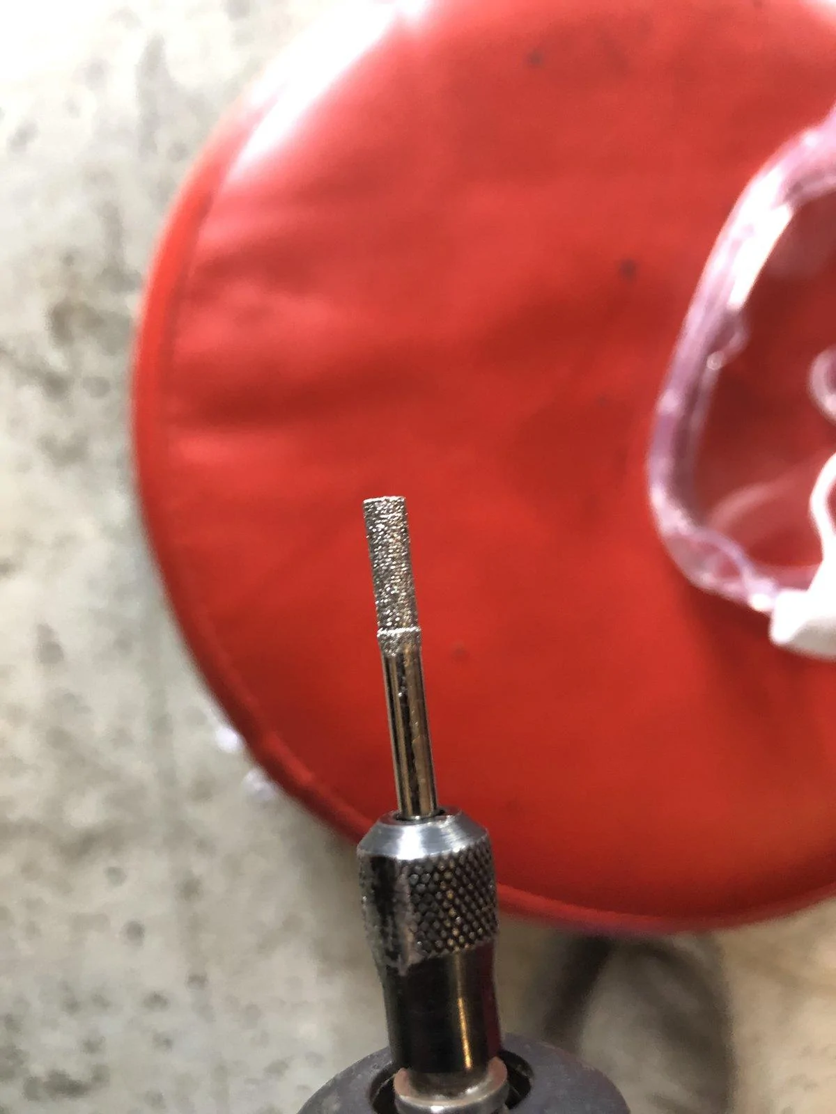

- Donāt remove the bumper to trim it for the Rock Rail.
- Leave it in place and take your time to trim it out.
- How you trim/cut the bumper is very visible, so go slow and steady.
- I trimmed the bumper with a razor and then filed it to Rock Rail.
- I also used 1/8 edging trim to give it a better finished look.
