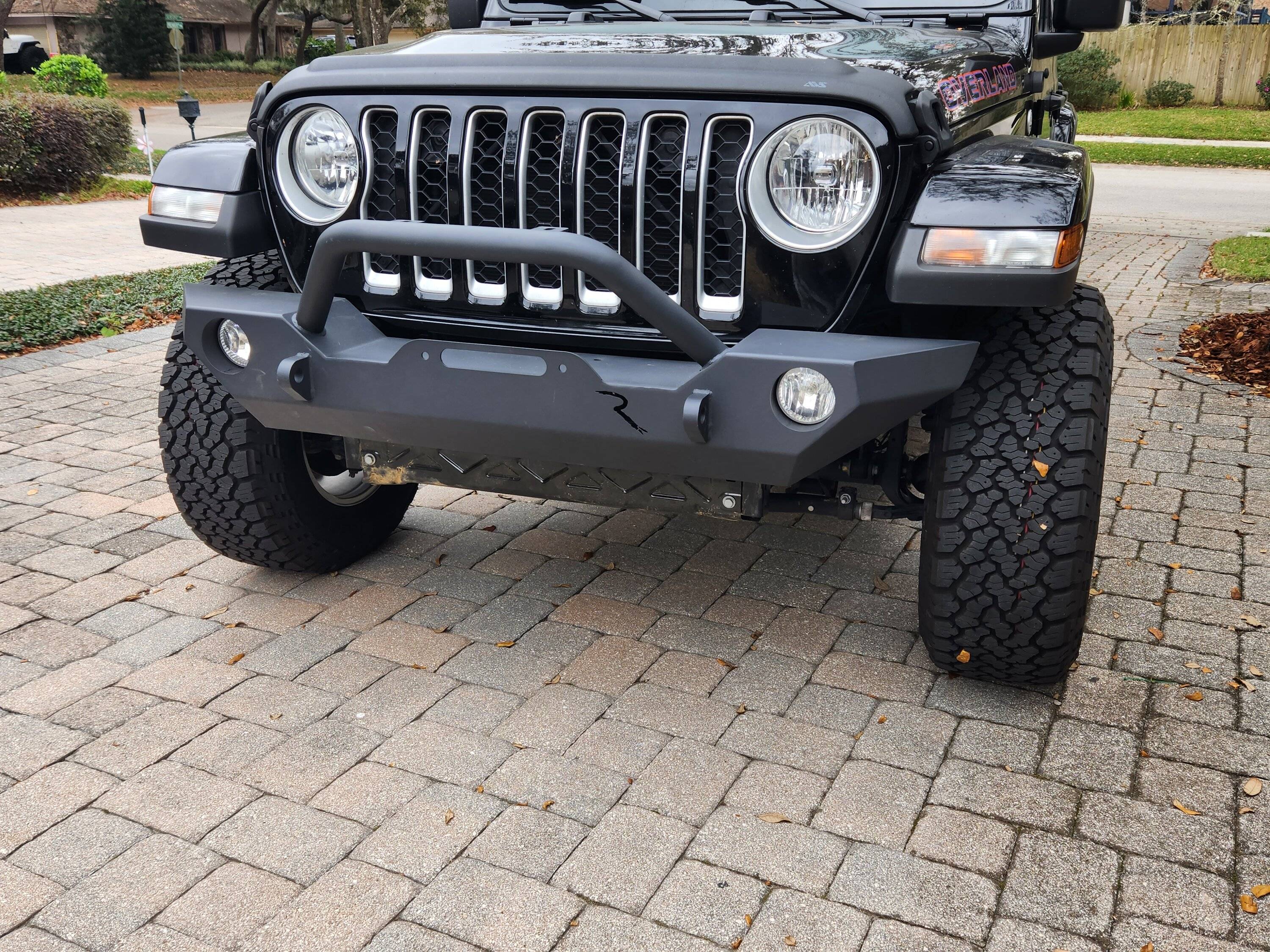

Howdy all, in my continuing effort to piss away all my disposable income, I've purchased a Rock Rage front bumper for my Overland. How tough of a task is it to remove the existing plastic bumper and replace with the new, including swapping out the OEM fog lights? From doing some web research today, reading instructions and watching videos, from what I see:
Remove OEM Bumper
1. Remove plastic trim tab between bumper and grill
2. Remove skid plate
3. Unplug fog lights from harness and unplug harness from body
4. Remove nuts securing 8 bolts securing bumper and remove it
5. Disassemble bumper to remove fog light harness
Install New Bumper
1. Install fog lights on new bumper
2. Mount fog light harness on body (saw one video where he ran removed grill and ran it back behind hood)
3. Install new bumper, secure 8 bolts
4. Replug fog lights and harness
5. Reinstall skid plate
Am I missing anything? Toughest thing I saw in videos I watched was disassembling the OEM bumper to remove the light harness and getting underneath to get at nuts/bolts (don't have a lift or ramps). Seems pretty straightforward. Any advice/thoughts appreciated. Would rather do myself than pay a shop.

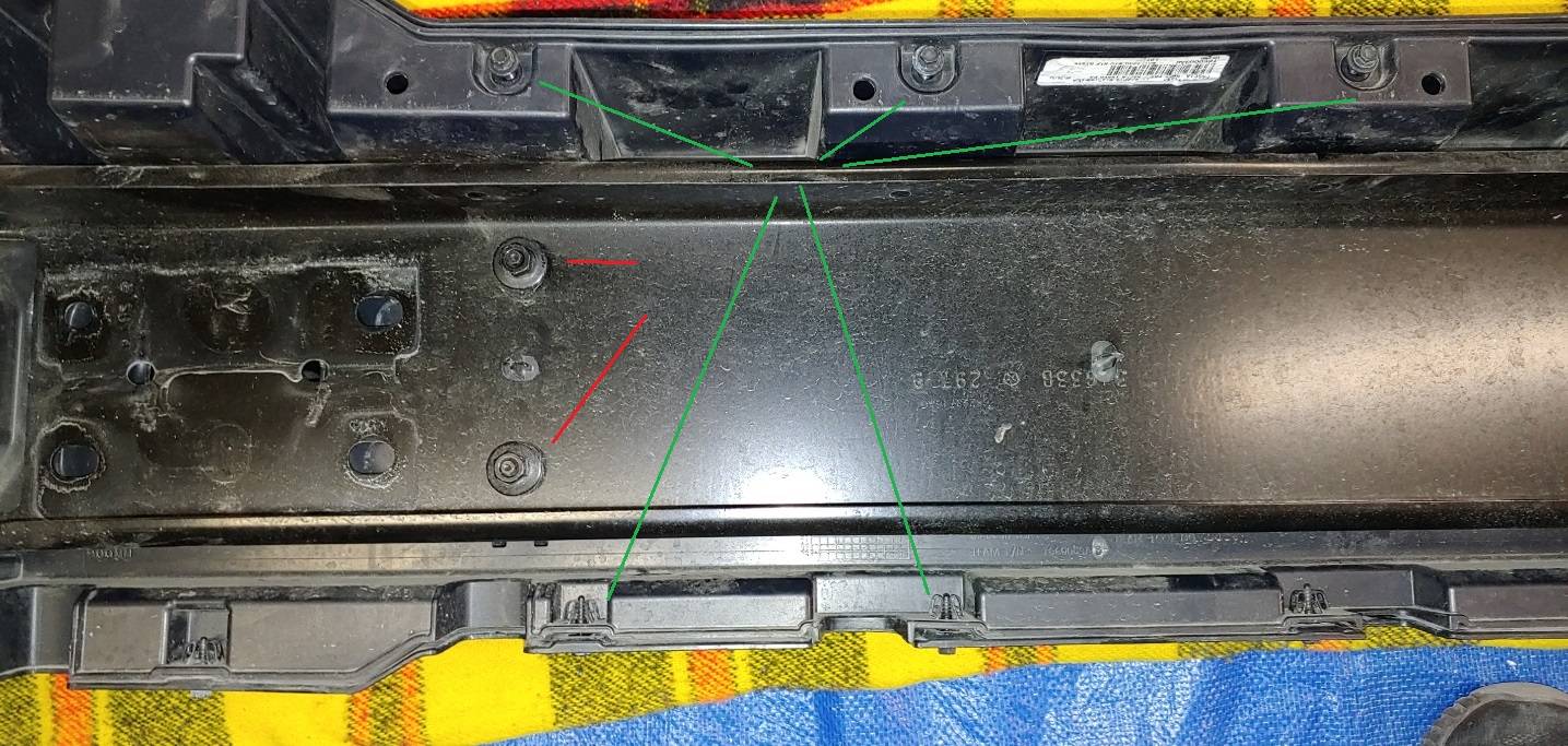

Overland bumper has something in the teens for the number of screws. It's a time-consuming process.

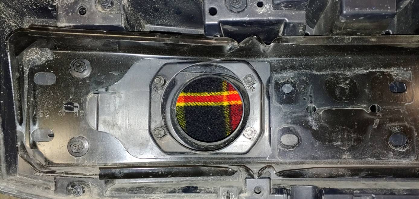

Not only that, but the retainers or clips are very different between the Overland harness and the steel MOPAR bumper. When I installed the correct harness in my steel bumper things clipped right into place just like factory. Holes lined up and the harness sits and is secured like factory. With the Overland harness in the steel bumper I used a number of straps - ugh.
Not to hijack the thread but after I get a lift, next on list is a bumper... if I can wait. Might be safe to assume this is the harness, Mopar 68336460AD, but want to make sure.
This is what Benny of Allmoparparts here in the forum sent me -
steel specific harness part # 68336460AD
So that matches. It was a perfect fit in my eBay steel MOPAR copy bumper.

Install complete. I think the biggest hassle was popping the clips for the plastic air dam underneath, they didn't want to come. Also, had to trim some of the plastic off the OEM fog light frames, they were preventing the new bumper from seating on the bolts. And I did buy a new wiring harness instead of disassembling the old bumper completely. Overall just under 2 hours with an assist from a friend.
