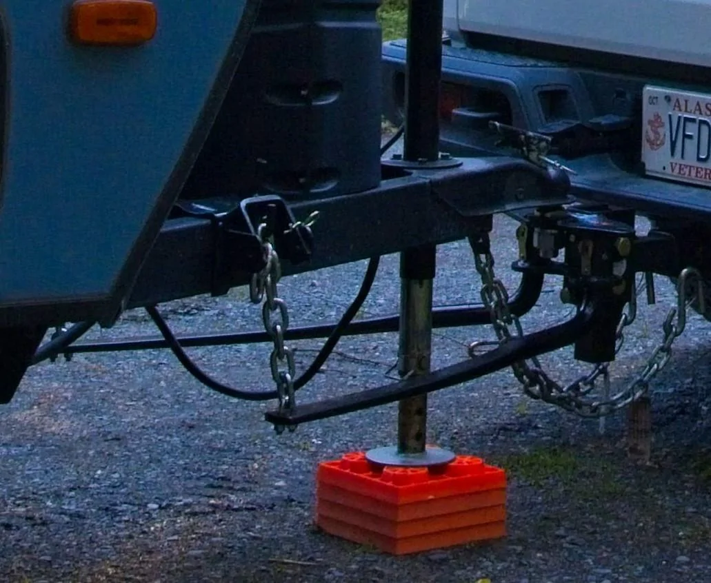

Getting a wdh is a big improvement. It got rid of the squat and ride quality was definitely less bouncy and more stable. Due to my limited options up here in AK, I went with the Curt rated for 6000#'s which is just right for my rpod. It does have the option to add anti-sway later down the road.

Looks like the same setup I had on my camper when we owned it........ it trailed really nice and no bounce or sway.
I like those pads - the orange - are those available at RV stores? or perhaps online?

Amazon TriLynx blocks

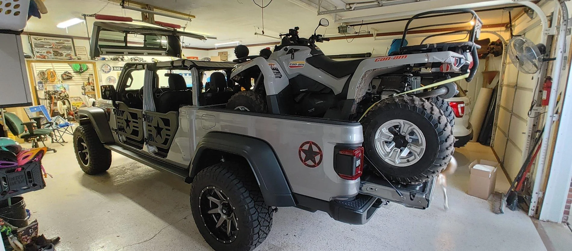

Just turned 14,000 miles and I absolutely love my Gladiator. Have had plenty of Jeeps in the past, most notably the JK I sold to buy this one. It took about 5 minutes on the road to realize, regardless of any small nuisances (ummm...it's a Jeep), it rides better than a Jeep should off the lot. What's really crazy, they seem to ride even better lifted. I did the simple Mopar 2" with a Synergy adjustable track bar just to get the belly up a bit while I decide on what I really want to do. Quite frankly, I love it. Especially as this is not just a trail rig, but a daily driver for me. Its everything I love about a Jeep with some nice luxury upgrades and a whole hell of a lot of utility. A lot of complaints I hear honestly are folks that might be better off with a Grand Cherokee instead. If you want Tacoma-like utility and Jeep fun factor and capability, this is it!
Thanks - those would be handy for my car hauler when switching from rear receiver hitch to front receiver on my weird ground. Could keep right in the tool box.

I had a few Jeeps in the past myself but my favorite was my 04 TJ.
I'd still have it but the frame was way too rusted, cracked and broken to maintain so I traded it on my new love, the 2020 Gladiator sport to personalize.
Since I'm in my late 50s, the most I'll go on lift is 2" because I'm too sore for the lifted vehicle climb.
You are correct on the ride and complaints. Nice ride!
