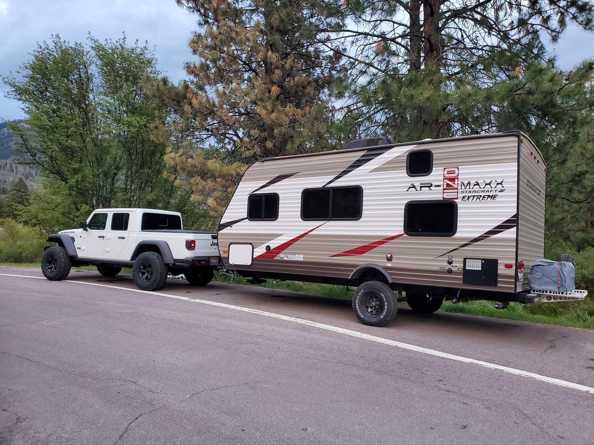

It has 37s, 5.13s and tow from 2,500~7,000 feet. It is a workout over 65mph running a higher RPM. Camper weighs in around 4,000lbs at 19feet.

Totally happy I went 5.13s when it comes to towing. The gears and the transmission make strong work of some of the passes out here. I was running a JKU with 5.13s with the same camper. I would have never been able to drive the JKU the way I drive the JT.
Open out west Interstates - It runs most efficiently at high RPMs which equals manual shifting and running in 4th or 5th. I get it up to 6th/7th when at lower elevations running on flat sections. I keep it around 65 for someone is going to run me down. Think of a screaming goat and this is what it is like for 6-8 hours. Up around 75 your hair starts getting wiry and standing up with your knuckles turning white.
Two Lanes - at sub 65 is darned manageable.
Again, this is at 2,000-7,000 feet. I would bet at lower levels and less windy areas, it would be just fine. The 3.6 needs some torque when towing.
Around town, I love it! I only tow about 6-12 times a year.

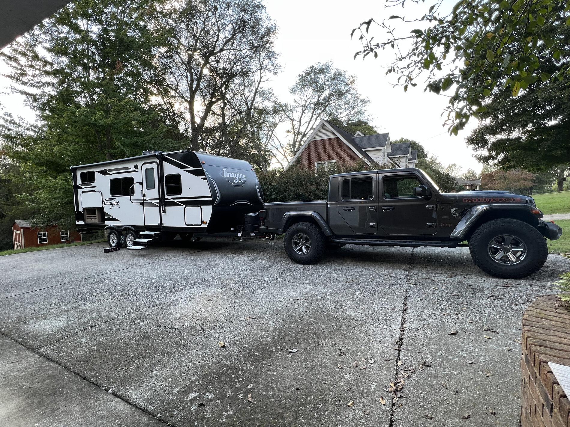

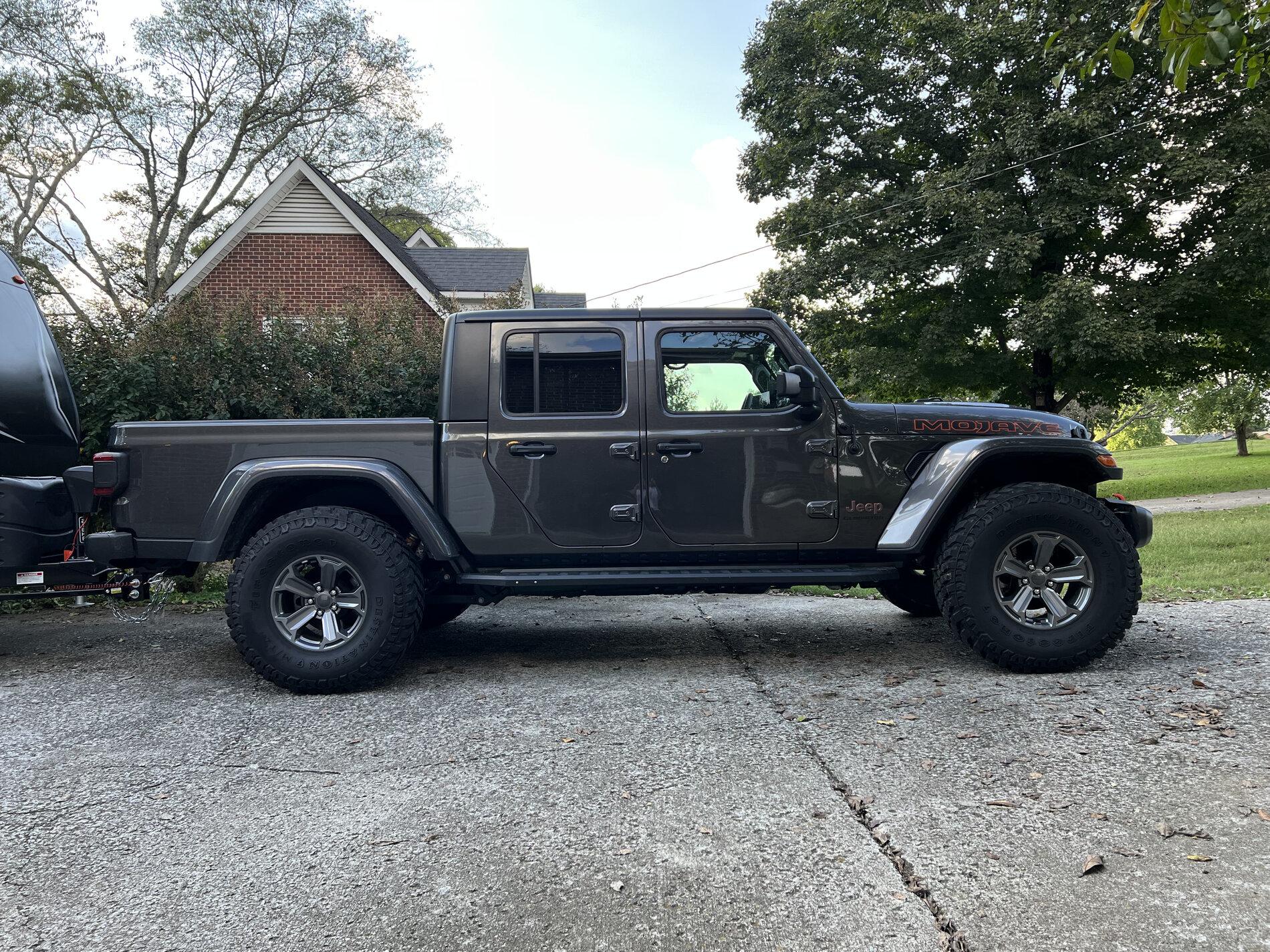

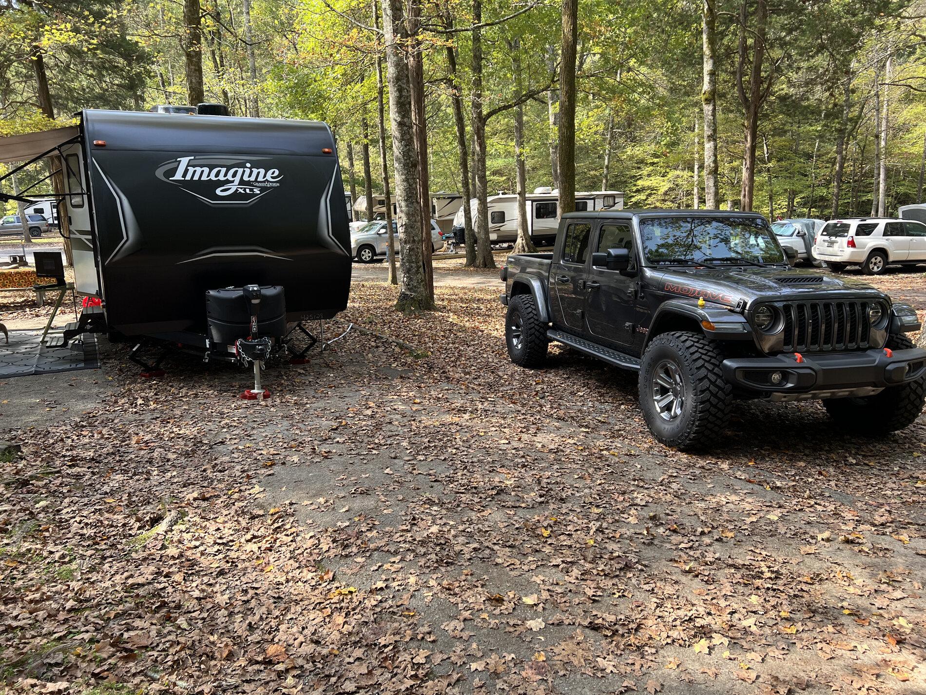

A well-setup WDH helps with the mush the previous poster commented on. I am thinking about trying bags as well, not for squat, but for helping absorb some of the bounce over bumps while towing. Everybody has opinions about what "works" and what doesn't. Sometimes, people get very passionate about their opinions and feel that because that is "truth" to them, it must apply to everyone the same...
When changing axle ratio, there will be a slight improvement in available torque multiplication, though it is not a very discernible change at road speed. Ultimately, engine RPM at load will be based on a somewhat "peaky" torque curve from the Pstar V6. Changing axle ratio will allow you to ride in gear 7 instead of 5, but engine RPM will stay closely the same. Combined (transmission, axle, tire diameter) ratio is what determines engine RPM, for a given load, relative to vehicle speed. The real drawback when running larger tires is the added unsprung weight. This will add load to an engine that doesn't have a ton of surplus capacity to begin with.
My "truth" is that the engine isn't great for towing, suspension isn't amazing for pulling a moderate load, but the SAE certifications say it is safe, and I roll at my own pace based on comfort/experience/etc... Is it a compromise? Yes. Just as driving a JT is a compromise vs a JL 2-door for crawling, or even my RZR Turbo S...
Disclaimer: As this is a journey for most of us, all at different stages in the journey, I will likely grow into a bigger, dedicated tow rig as my family chooses a larger camper. However, what I have now works for me/mine, and we have a blast doing it together as a family. If your choice is to listen to someone who encourages you to live and learn, or listen to someone who infers that towing a 5k load on 37's is going to explode into a pile of molten metal, I'd recommend experimenting for yourself.. but ultimately don't live life based on fear.
No bags and my truck sits level with 5k lb load w/EQ4 WDH (driveway is a slight incline.)
