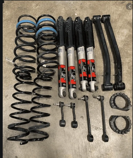

so I bought a rubicon take off suspension, sold it without really looking at it to a buddy and the shop he took it to said hes missing bump stops and bushings and had to order them?
I'm pretty sure the crate i bought had everything pictured here, except maybe the black circular things on the lower right. Those aren't bump stops are they?
Jeep Gladiator Is anything missing from this rubicon take off? 1607722022779
this photo was taken from somebody else, just so i could see if anybody noticed something missing. Thanks.

Only parts really needed for the swap are the springs and shocks. I'm not even sure the bumpstops are different between models.
If he is going wheelin, going to want front sway bar disconnects anyway.
yeah i thought i read about many people only changing out the shocks/springs, leaving the links and LCAs cuz they were the same.

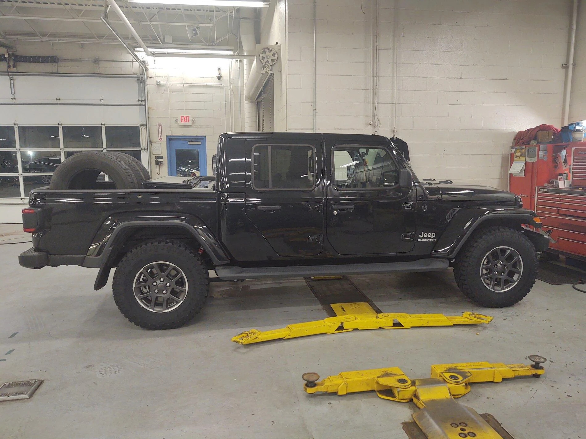

Jeep Gladiator Is anything missing from this rubicon take off? IMG_20201112_173146817
The black round things are spring seats. All that is needed are the springs and shocks. The spring seats from his truck will fit. No need to change bump stops. I just put Rubicon take off springs and shocks on my Overland 4 weeks ago. If you look close you can see the shocks.

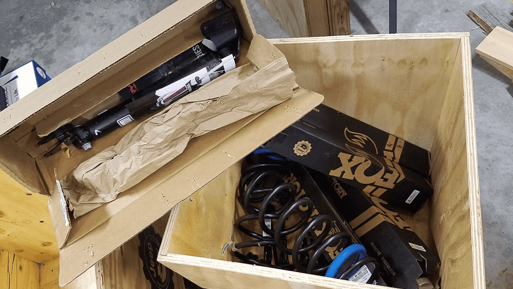

I guess no one read my write-up about swapping springs and shocks on my Overland and how I said no need for the other parts as they are all the same, even the part numbers matched.
Jeep Gladiator Is anything missing from this rubicon take off? rubicon-suspension-1
I may have seen that. Now you're going to make me search for it eh?

The only reason the sway bar links and lower control arms are in there is because the were replaced on the Rubicon being lifted.
180
29,506
35,117
Like a Mopar 2" or larger lift.......
