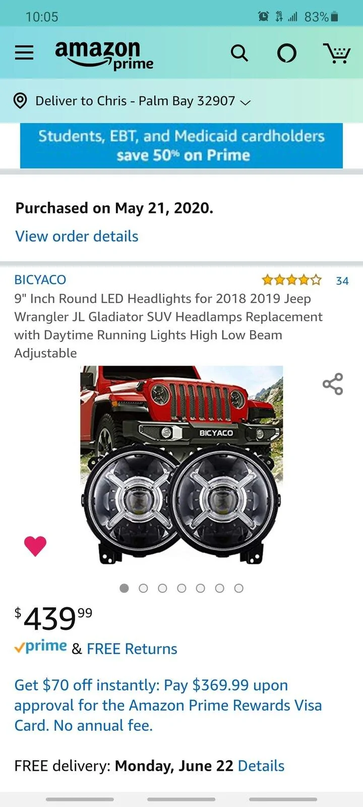

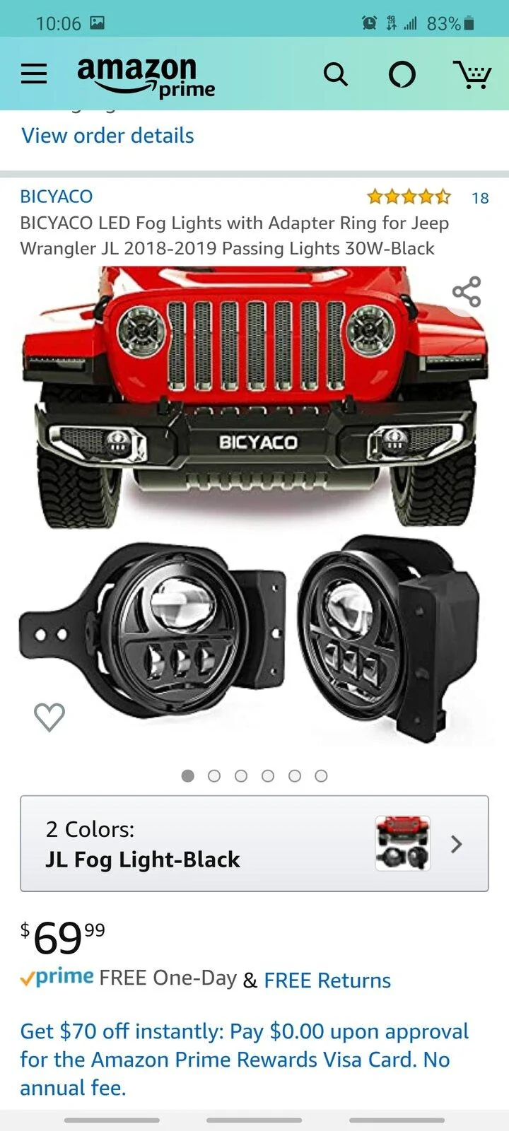

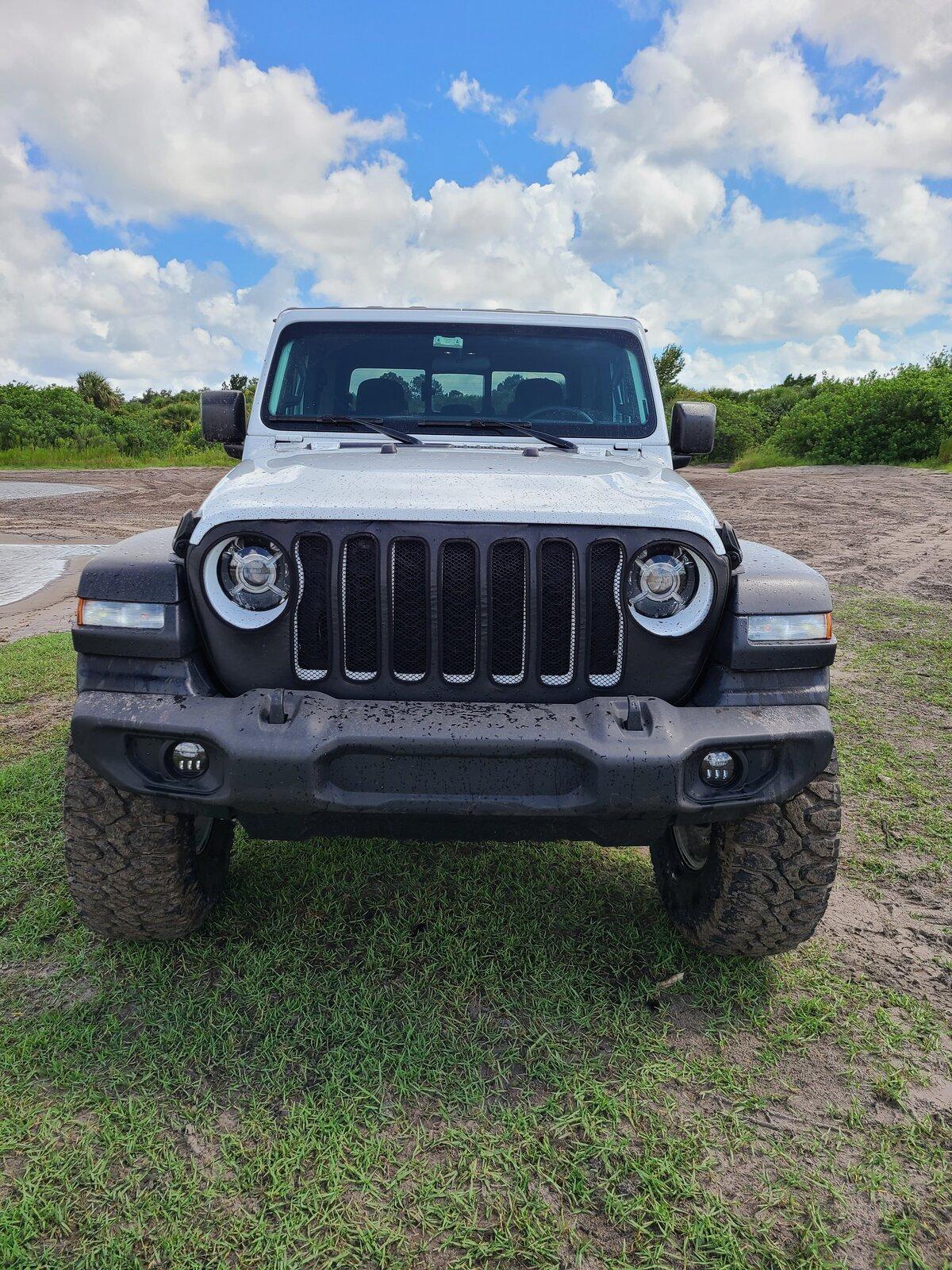

Personally way to much, but if u wanna stay oem, then theyre ur only option. I spent half as much and love the outcome. Sorry, no night shot. And u don't have to hook up the x-halo if u no want. Cutoff, beam, output are perfect, easy install and adjust, and I feel no need for a light bar.
