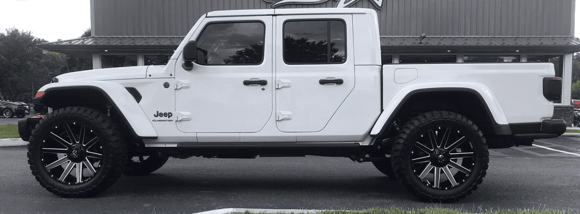

I have found a few pics of Gladiators with 22" wrapped with 35's. I'm curious if you can tell whether this Gladiator is actually lifted, or is it just a leveling kit? The specs where I found the pic didn't state. I am considering a Rubicon Express 2.5 lift kit, as I was advised, with same size wheels. I'm wondering though if that will be higher than what I see here. I kinda like this spacing. Anyone have an idea?

Doesnt look like either to me. Just looks like a gladiator rubicon on 35s.

Agreed... still quite a bit of rake and doesn't look like that much clearance from a lift/level

35's are 35's, doesn't matter what size wheel they're on.
The picture you have up is a Rubicon, I can attest that 35's fit on a Rubicon with no lift, no level kit, no rubbing.

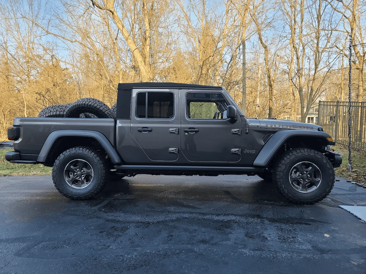

For reference, this is a Rubicon on 35's with stock suspension:

If you plan on keeping those wheels and tires, I would not lift it any further. Those are certainly street pavement wheels and tires and you will get better performance for a road truck keeping it lower.

its leveled as the fender lines are even and that's a non rubi/mojave so it has the lower front fender line. Definitely not lifted though.

I wondered about it being a Rubi, and therefore higher. I'm not planning on the same wheel, but was considering the same overall size, 35's. This is more for street than off-road - I have a completely different "toy" for that. Just debating between the Rubicon Express 2.5/3.5 lift with Twins or the 2" spacer with Fox shocks.... ergh
It's not leveled, it has a rake. Most people make the mistake by looking at the fenders and tire gap. Look at the frame compared to the ground.
Also, it's a Rubi. The front fenders are on the hood line, the bumper is the steel one, Rubi tow hooks, and the rock rails in the back; for some reason the previous owner dumped the main Rubi rails for some other weirdness.
Oh, you can also see the Fox shocks.

I like the stance of the Nahleens Rapper. For the OP they will need to keep in mind this truck has Rubicon fenders and to replicate this look Rubicon front fenders are required.
You are totally right, saw no rubi sticker and no rails and jumped to conclusions, yeah just a strange gladiator on 35's with awful rims. That's one odd rig.
